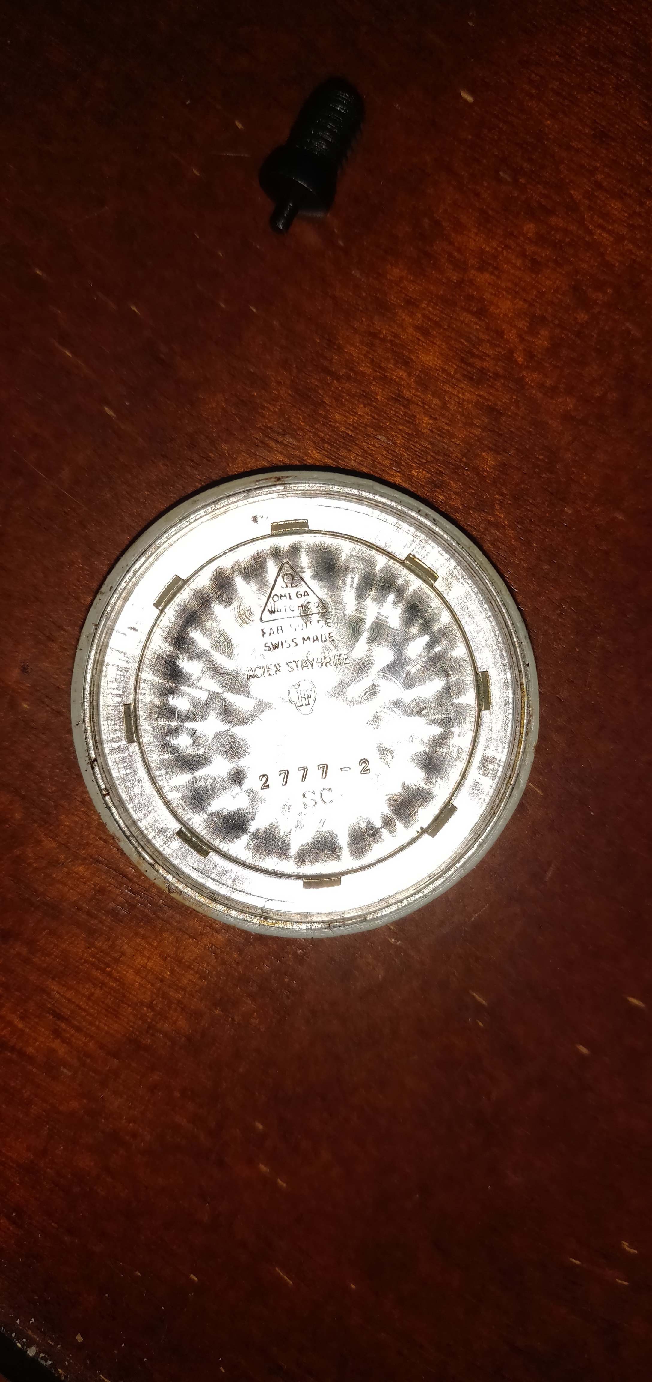

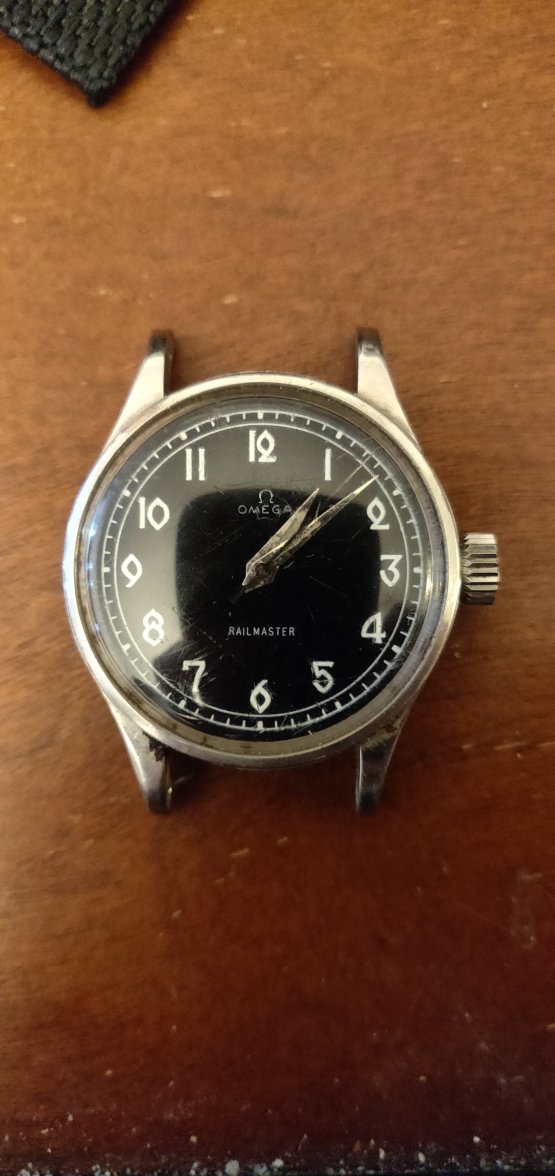

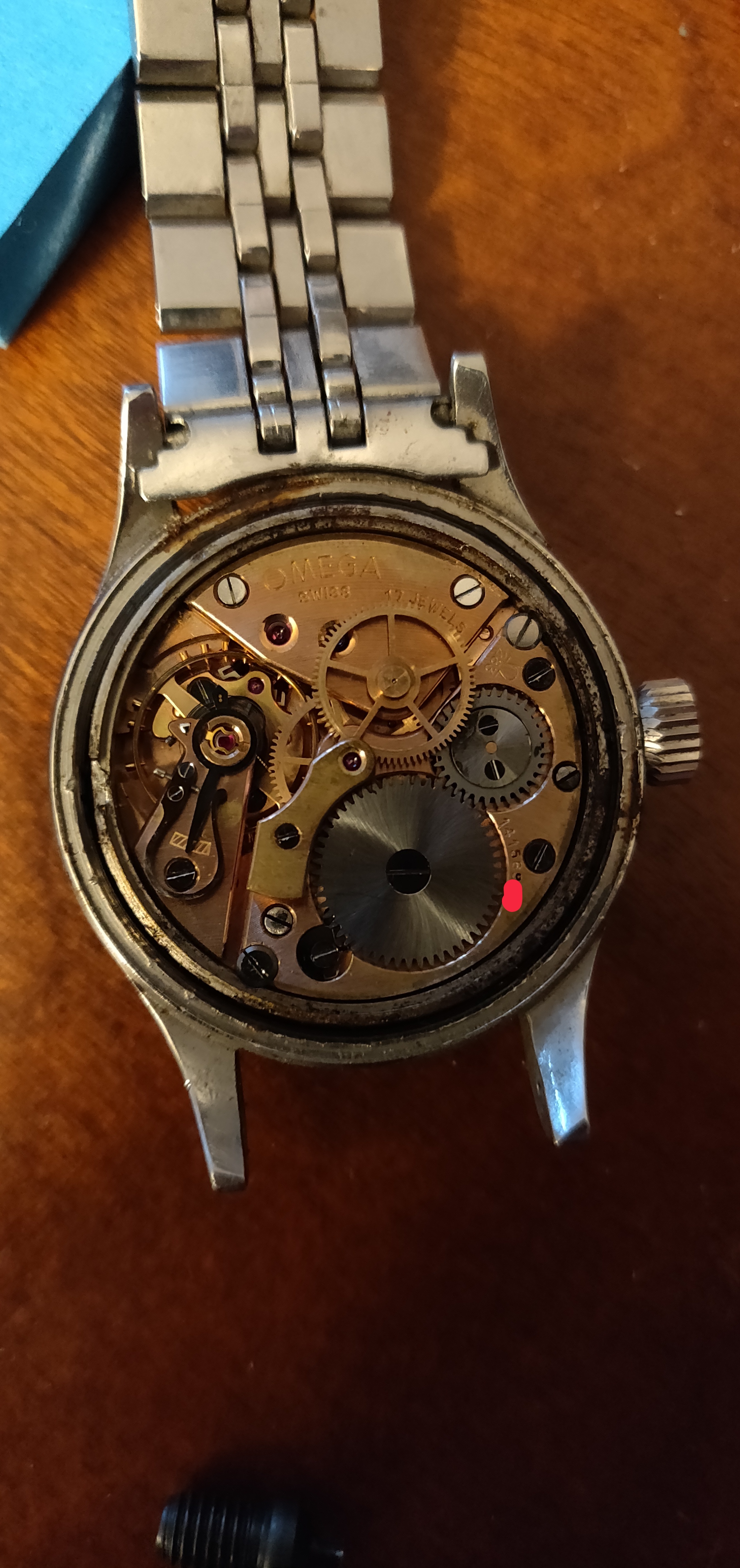

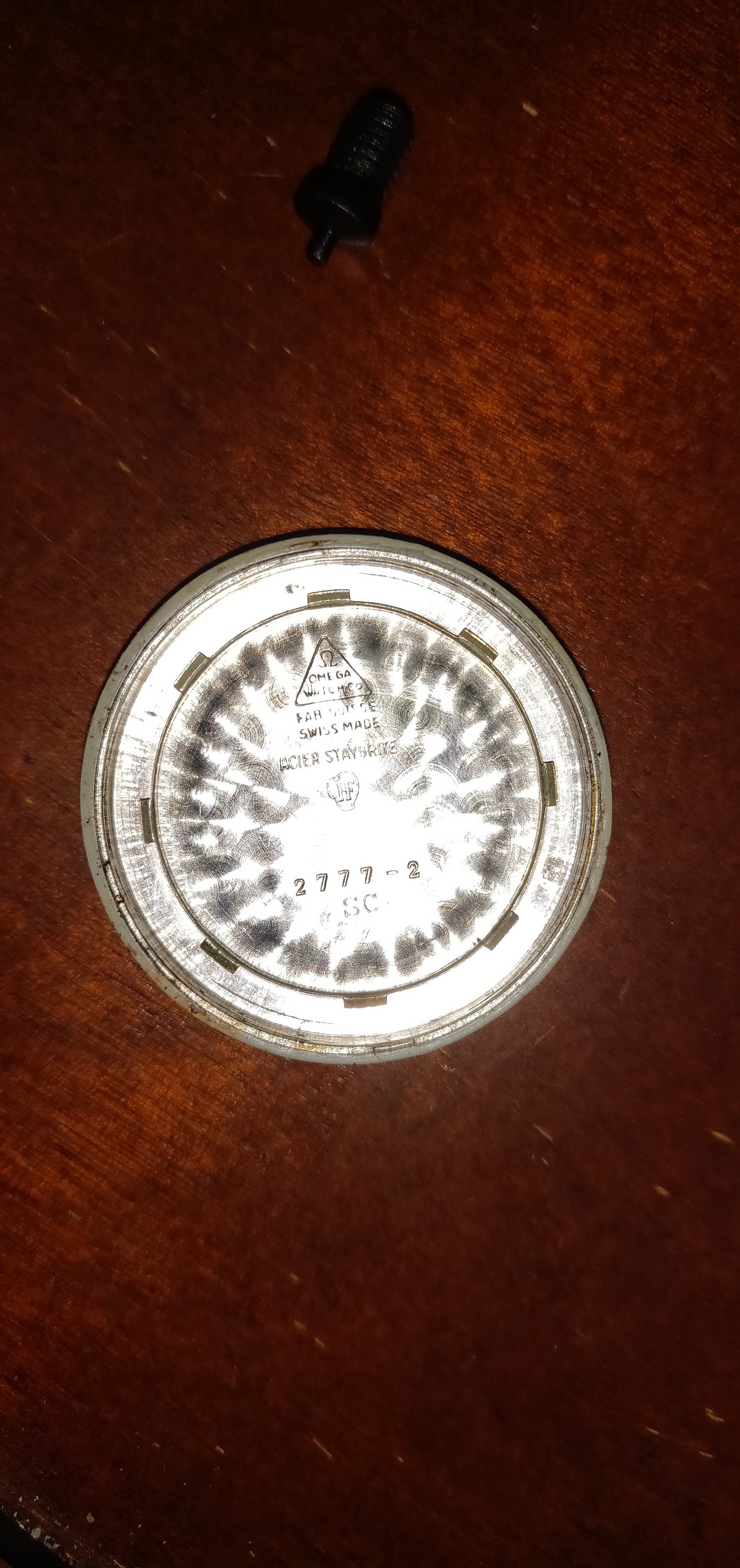

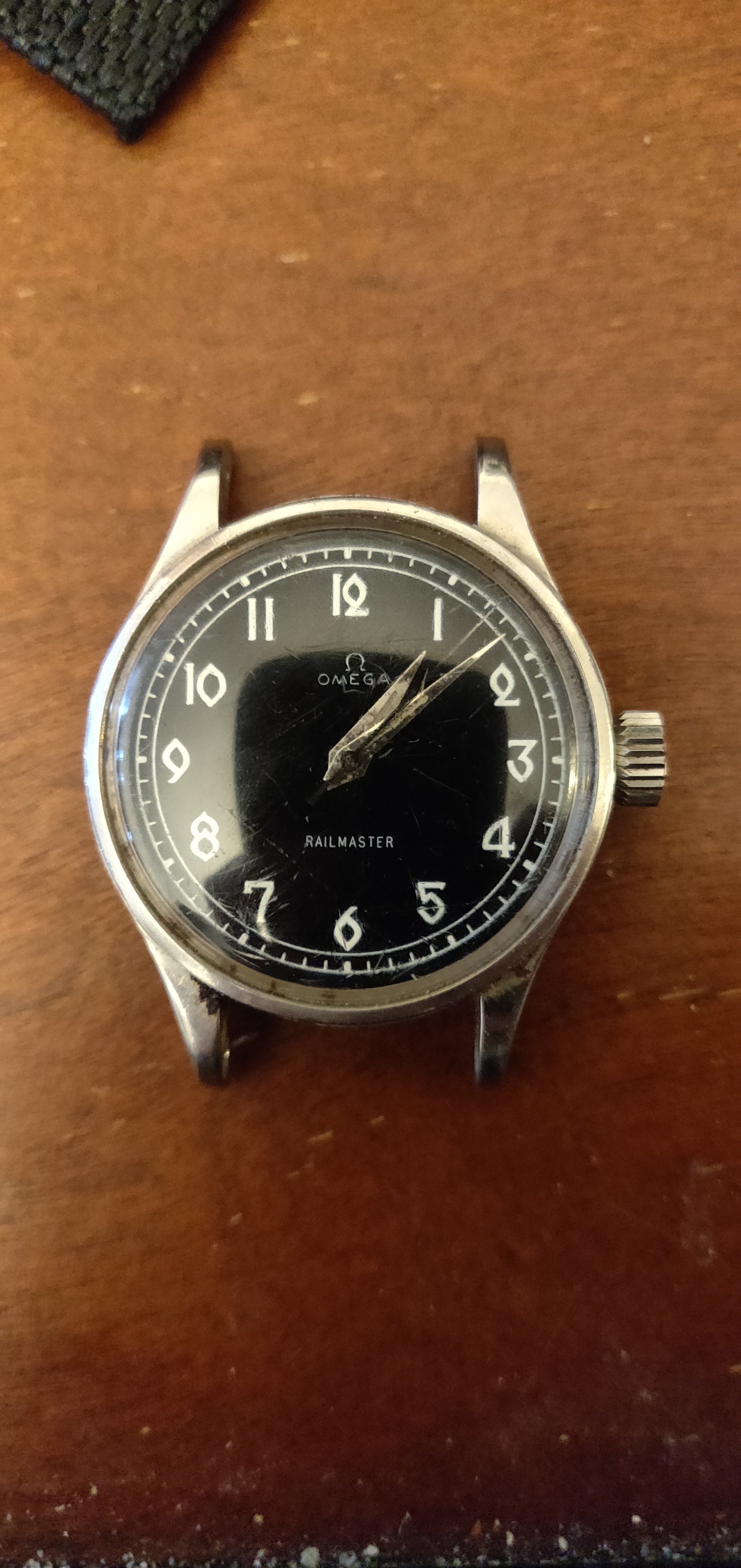

Found this yesterday at Goodwill while visiting my dad over the weekend. Reference number is 277-2sc with a Calabar 283 movement. I can't find anything online that looks similar to the face. Looking to see if I found the real McCoy or if it's a dud.
Let me know your thoughts

I would call this a good candidate to send off the dial and have it re-redone.
4,453
11,355
Great find! The dial has been refinished which is why you can't find a similar one but it's a real and uncommon one!

I rarely advocate it, but I'd say this could be a candidate for a true, proper restoration. Nice snag!

Omega watch.
Bad redial.
Are the hands wrong as well then? And perhaps the crown too?

Hands are wrong but I think the crown is OK.
Best part is the movement, the case is a bit corroded. If the dial is original it could be restored, but it would still be a redial.
It'd look much nicer than the current dial though.

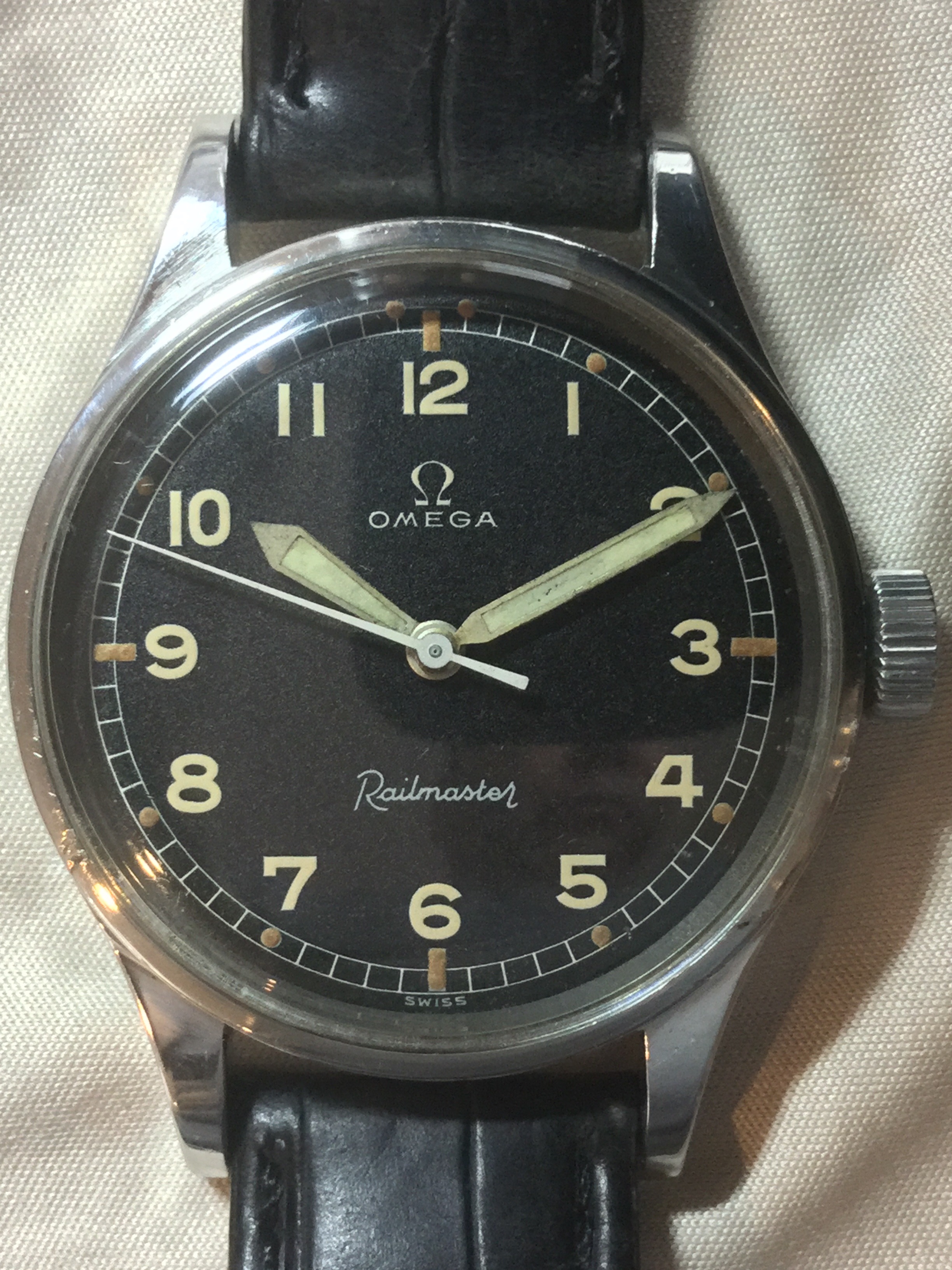

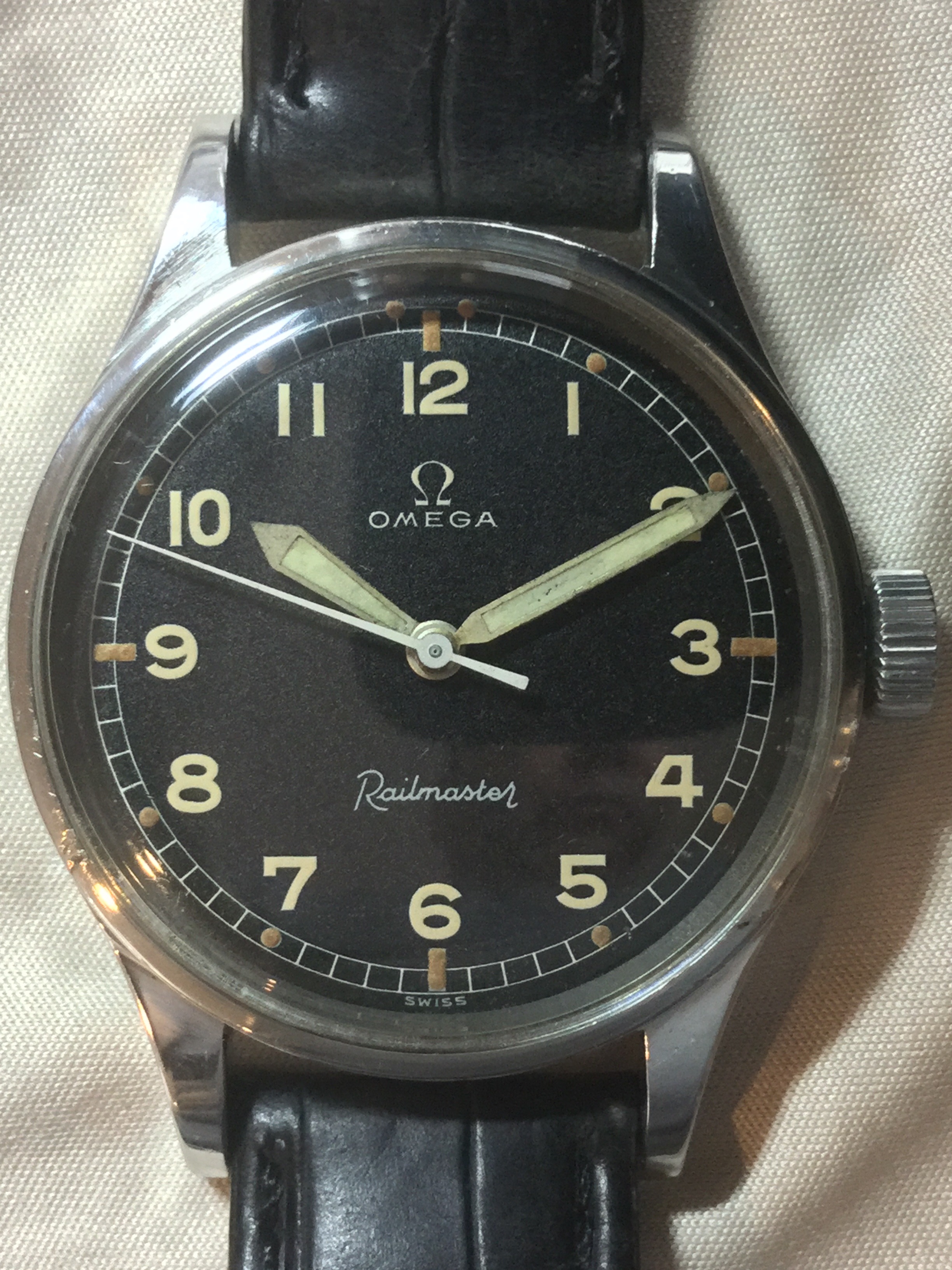

Here is an original 2777-2 Railmaster (circa 1955) example

What do you think of the serial number?
Close to yours?
5,861
16,802
I was just going to tag you.
Close to yours?
Yes

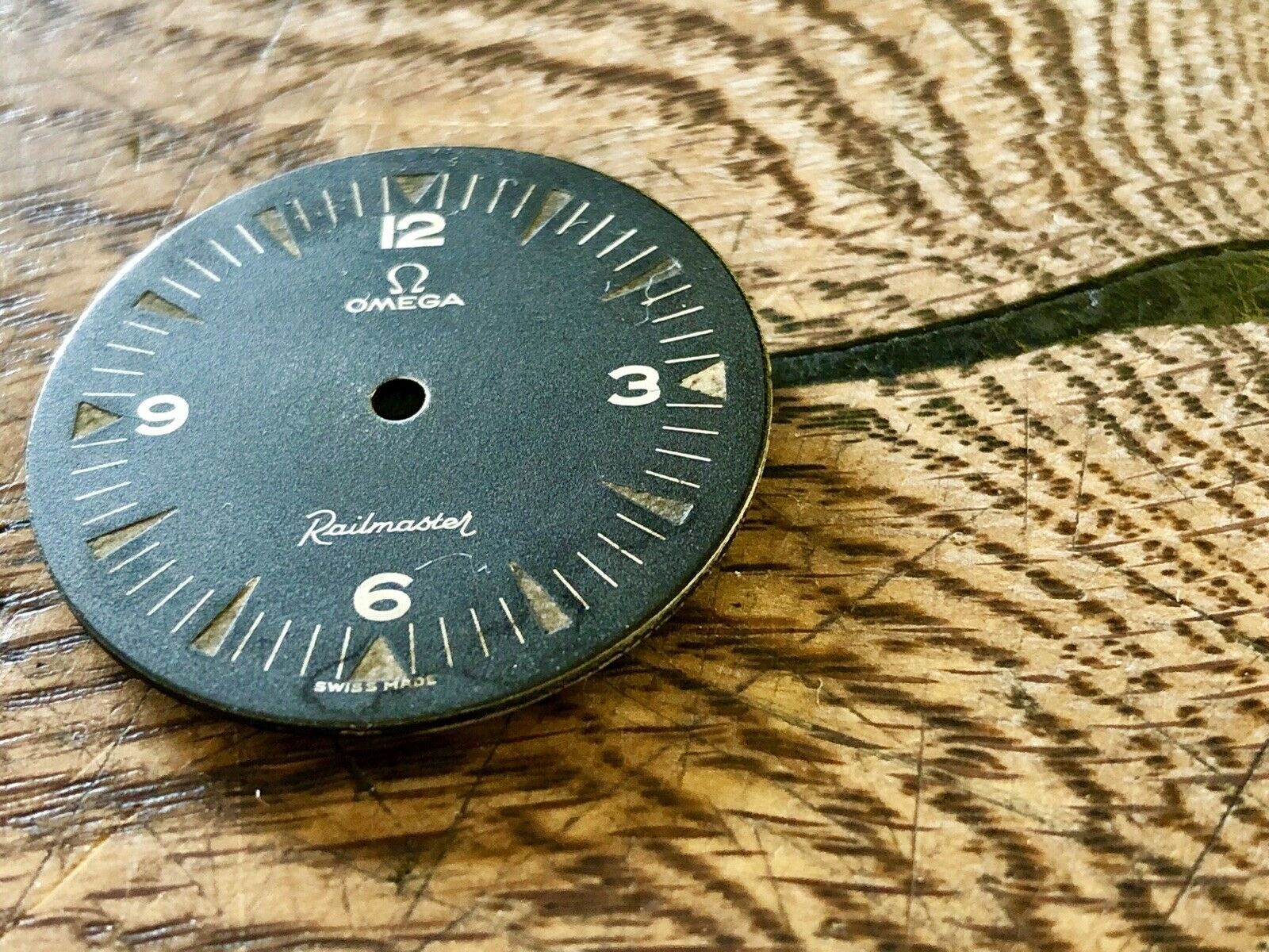

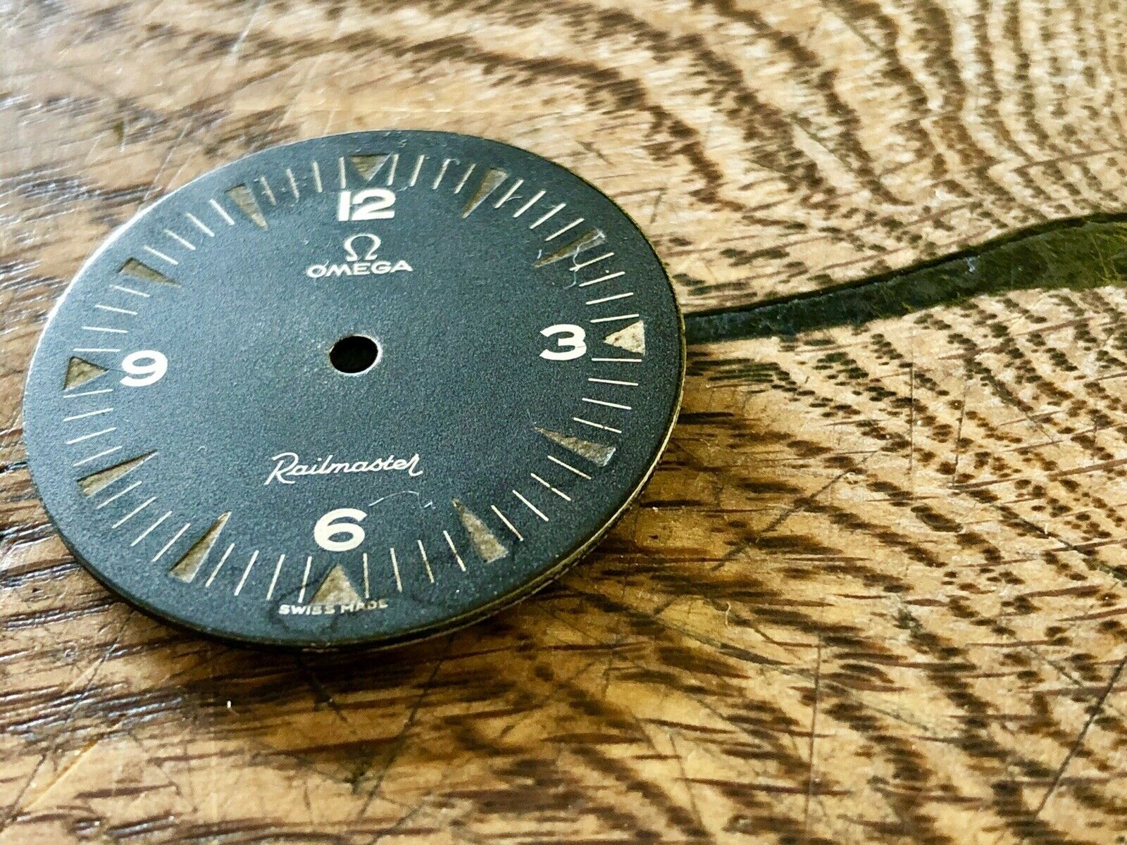

The 2777-2 Railmaster has, I believe, the same antimagnetic, thick, 1 mm dial also found in the 2777-1 53 RAF. Similar to this 2914 Railmaster dial. You should have the OP dial removed and compared. A normal dial is much thinner, 0.4mm.

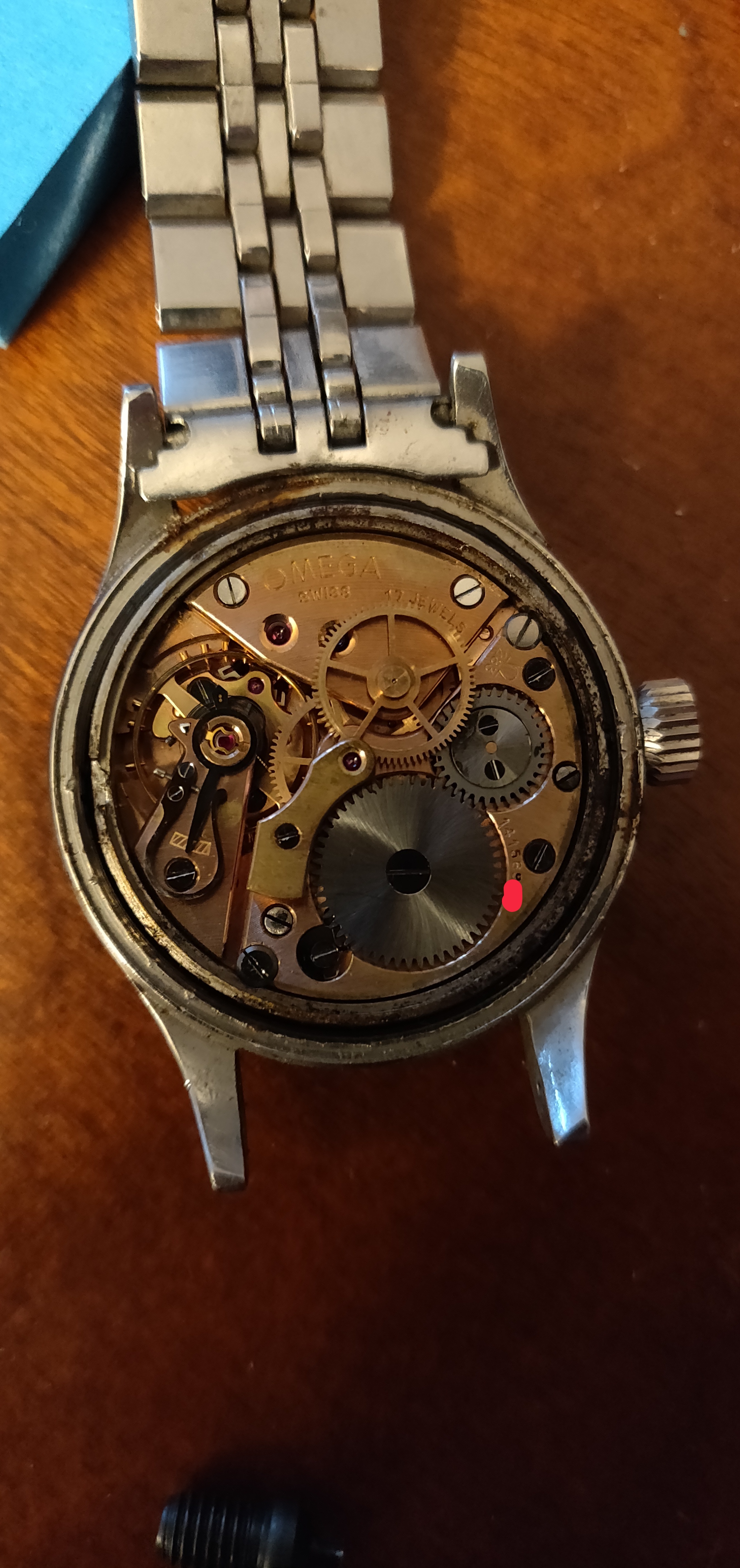

So, today I went to Omega in Manhattan to get an evaluation of the statues of the watch and what the overhaul of this watch would entail. I was informed that given the state of the watch case and pictures of the movement they Omega servicing center will almost 100% replace the original movement. Obviously, I am very concerned with with replacing the caliber 283.
Can anyone give any recommendations for trusted vintage repair shop in Manhattan?
I want to pursue the restoration but obviously trying to keep the original movement if possible.

You should send it to a good trusted watch repair shop that is accustomed to working with vintage Omega. We have been through this numerous times on the forum, and there is nothing like that in Manhattan.

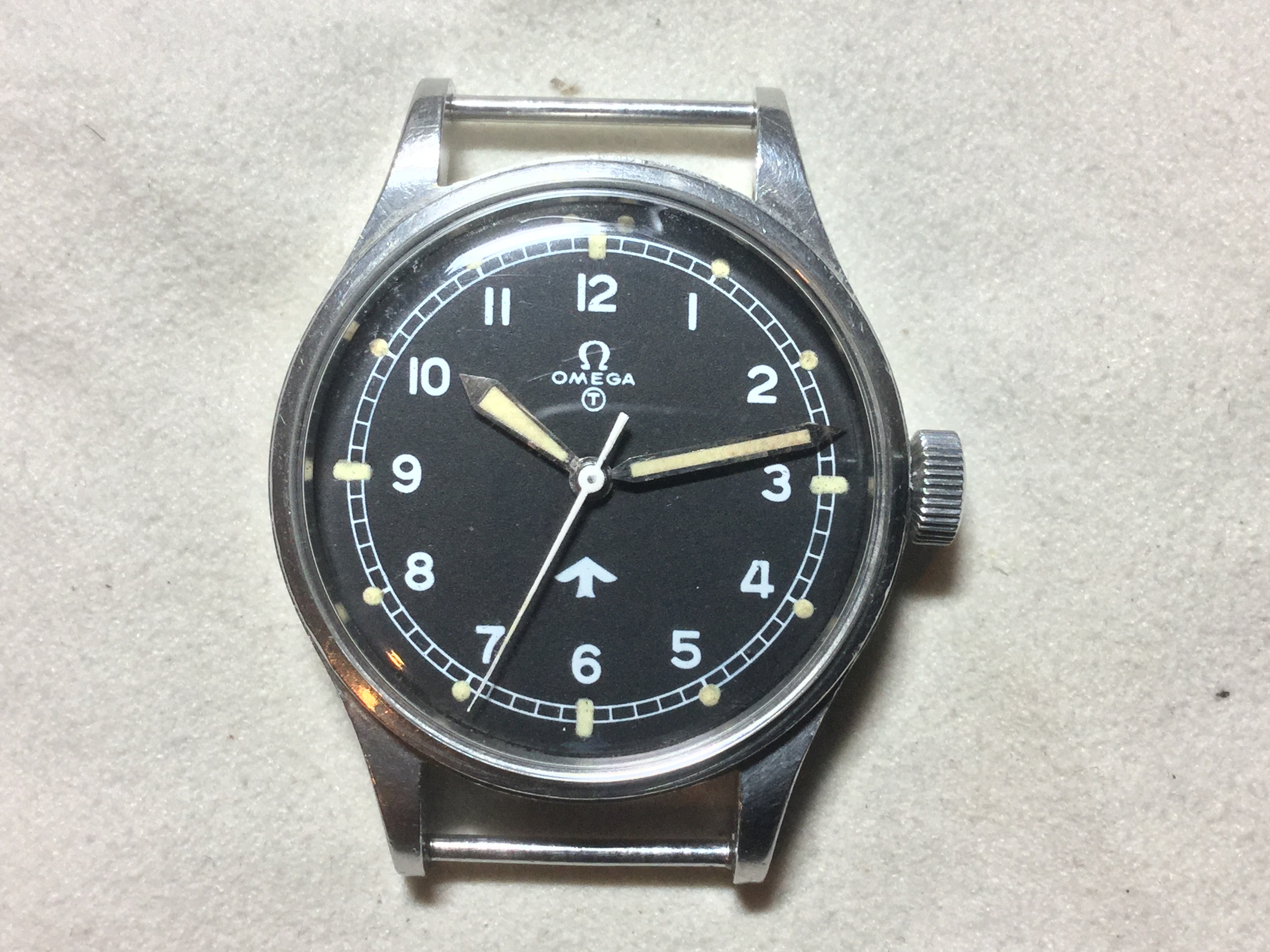

The 2777-2 RM contains a caliber 283 goose neck regulated movement that was only used in this very very limited reference. It is so rare that Omega did not know of its existence. Only through years of detective effort by @Bill Sohne, see my thread https://omegaforums.net/threads/a-g...rototype-black-dial-pristine-condition.47137/ did Omega finally locate the 2777-2 and 283 Goose Neck in the Omega archives.

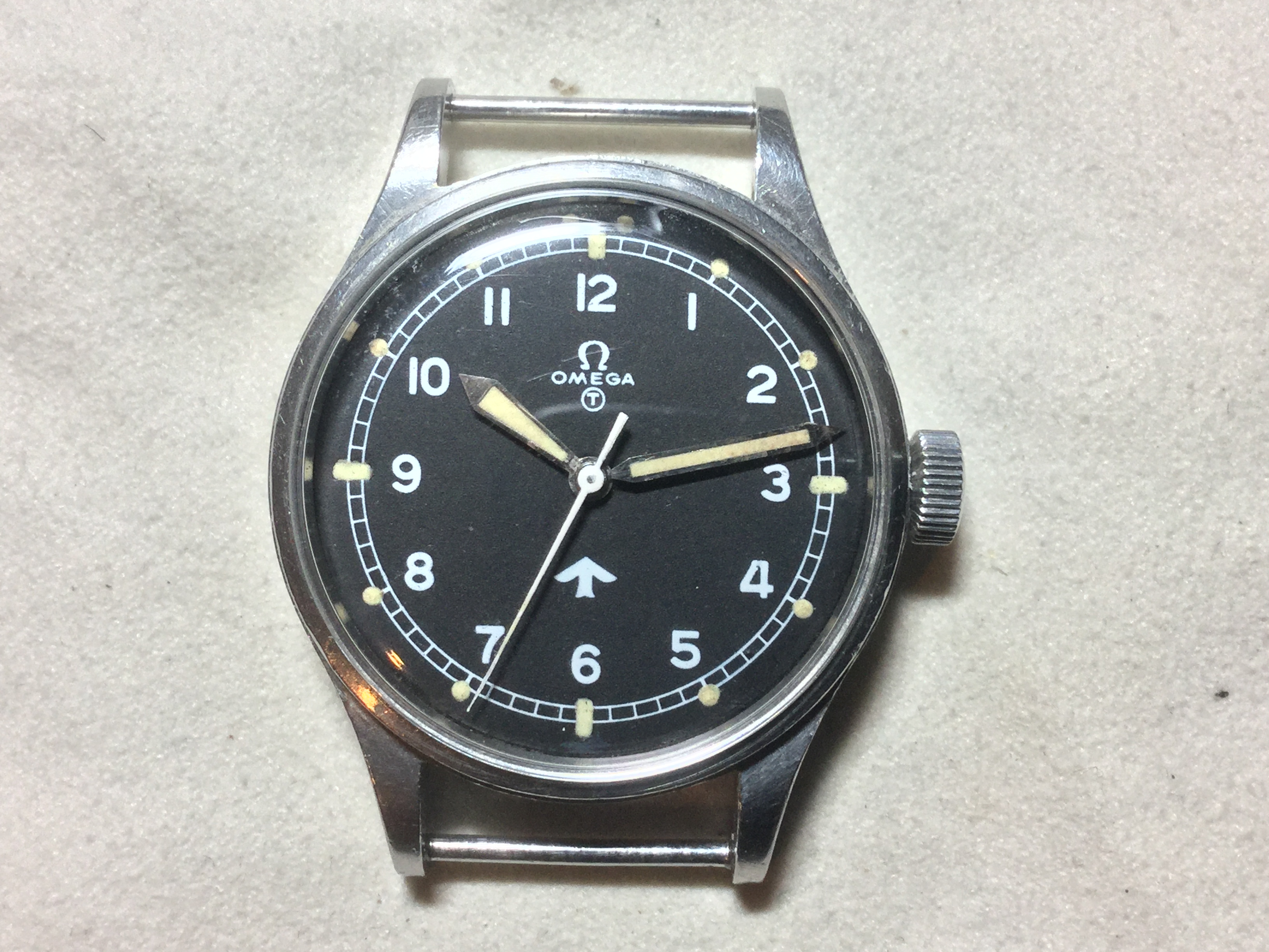

As far as a restoration, the movement is not the issue. For certain, Omega Service should not be allowed to touch the watch as they will completely ruin it. Other vintage WM can service it with donor parts from a normal 283. The major hurdle is the dial. It is IMPOSSIBLE to find a replacement RM 2777-2 dial and this OP watch will never be a complete 2777-2, unfortunately. To me, the best alternative is using a 2777-1 RAF as a donor, approx $3,000 for a fat arrow version. A 2777-1 is the best place to find a workable antimagnetic dial to refinish, hands and movement parts.
1953 2777-1 “Fat Arrow” RAF
