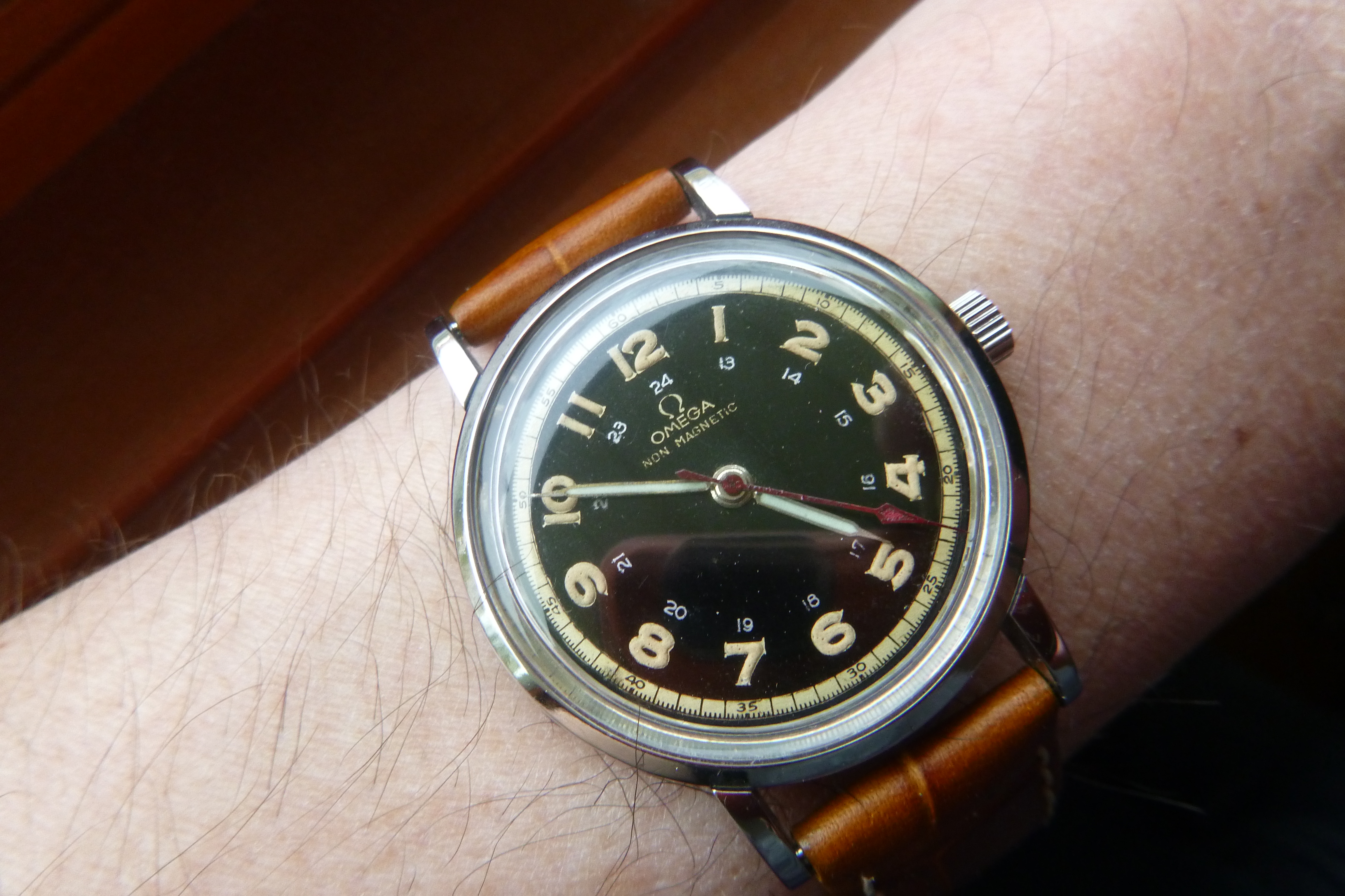

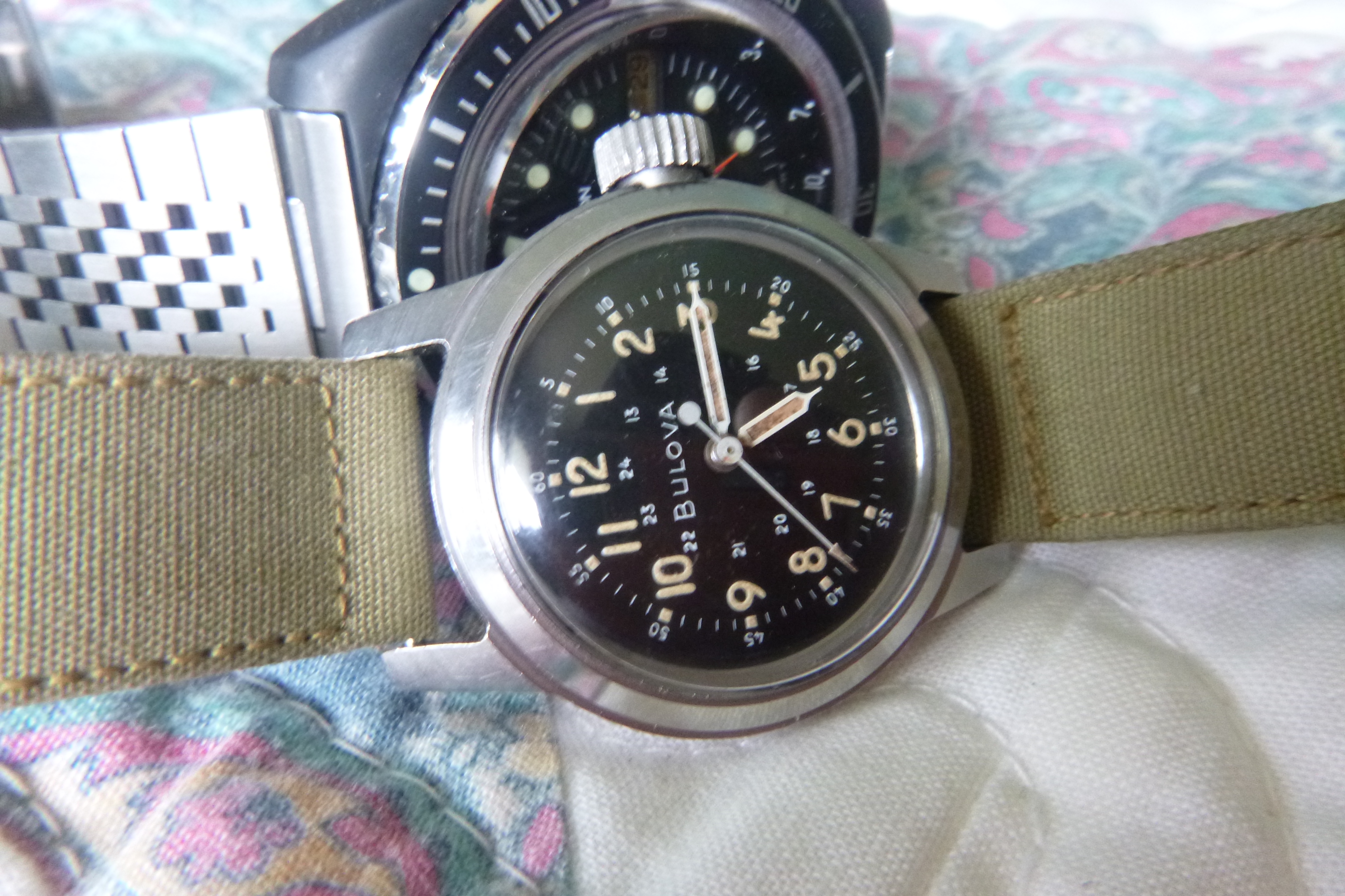

I have a small Geiger counter that I like to bring to meet ups. It’s true that the concentration matters. I’ve observed that military watches are way more radioactive than they look
3,819
16,168
I've read quite a bit on this subject and the amount of radium used in the dials of my watches is pretty small. The fact that there's a metal case, often double walled in the case of military pieces, means that its not exactly dumping a ton of radiation into my body. The risk lays in the residue from the broken down radium paint which is floating around inside the watch. So open them up damn little and do it in a well ventilated area if you have to. Both of the watchmakers I've used over the years have serviced dozens of these things and somehow not grown flippers or had their nuts drop off.
I think the hazard is low enough that there's a lot of other things in the world I should worry about first.

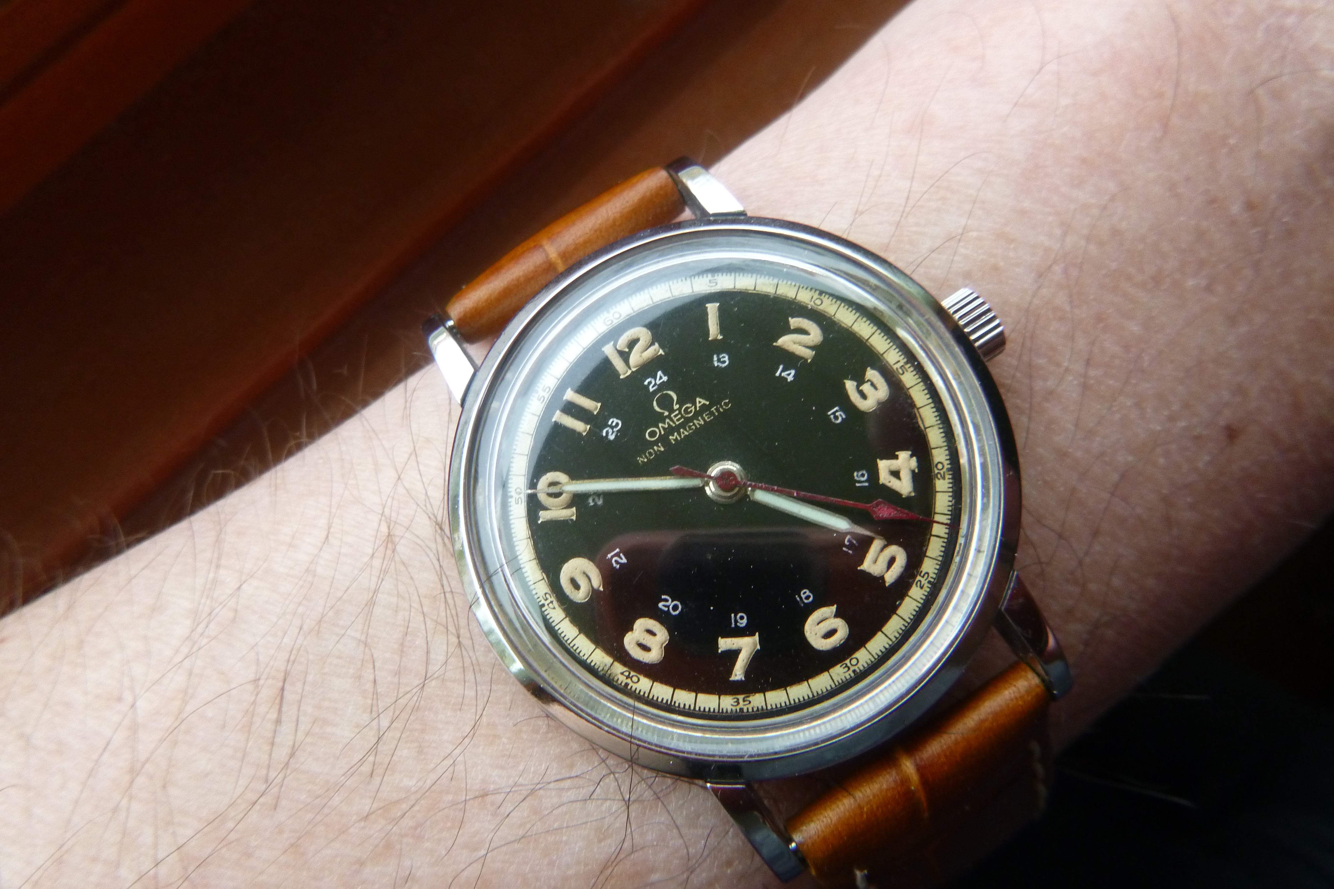

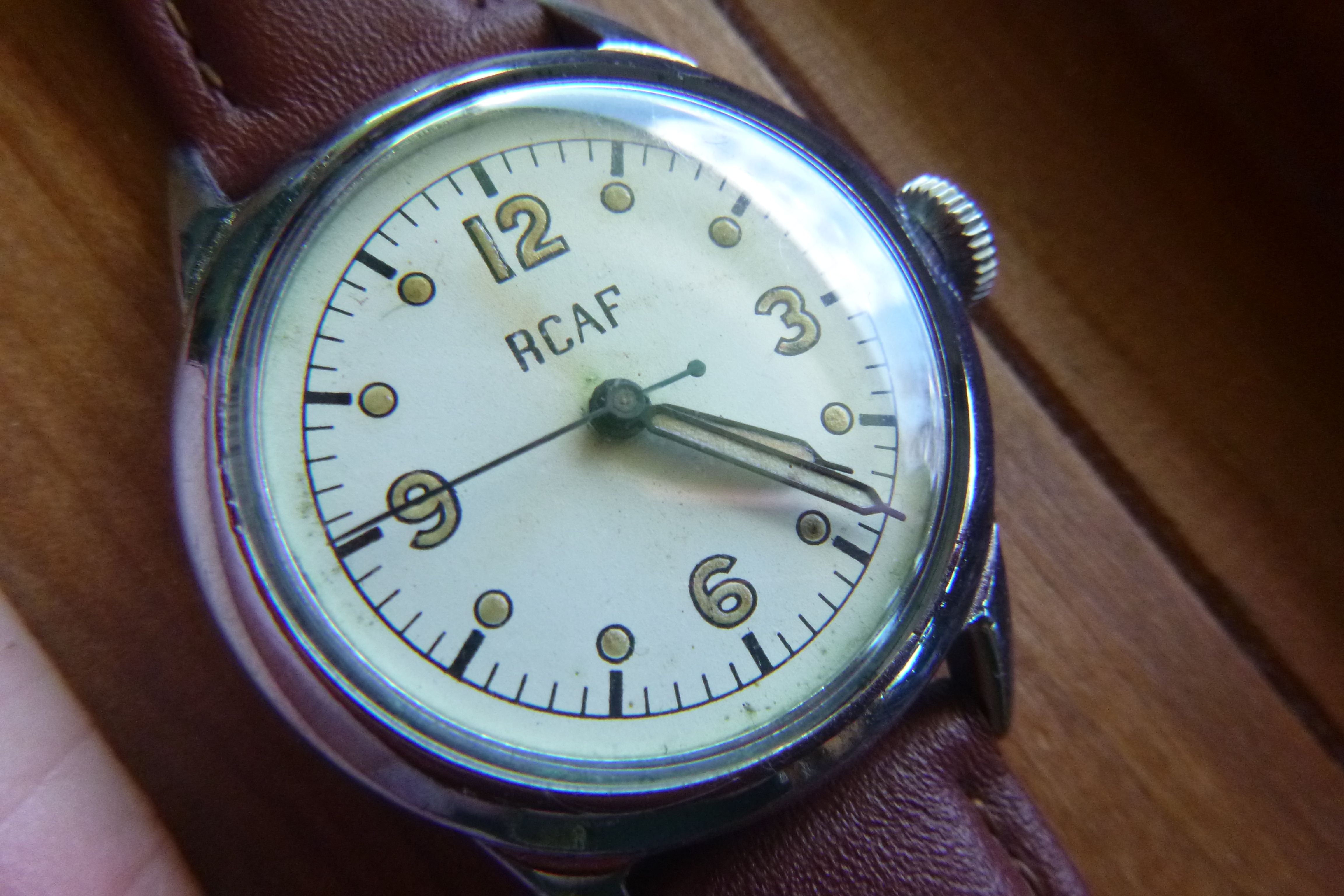

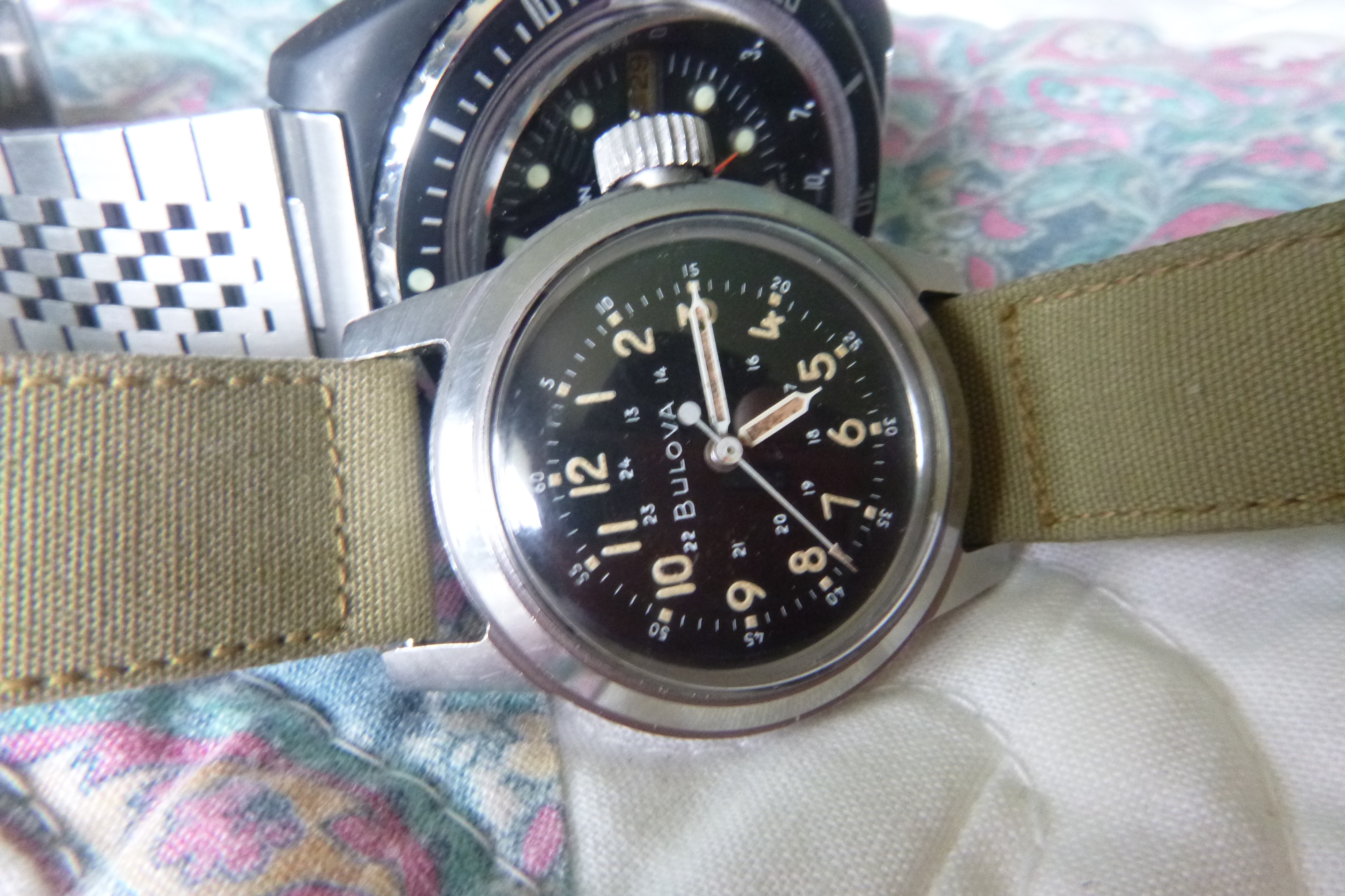

Thanks for these pics, too - the whole time I was reading I was imagining what they might have been painting!
