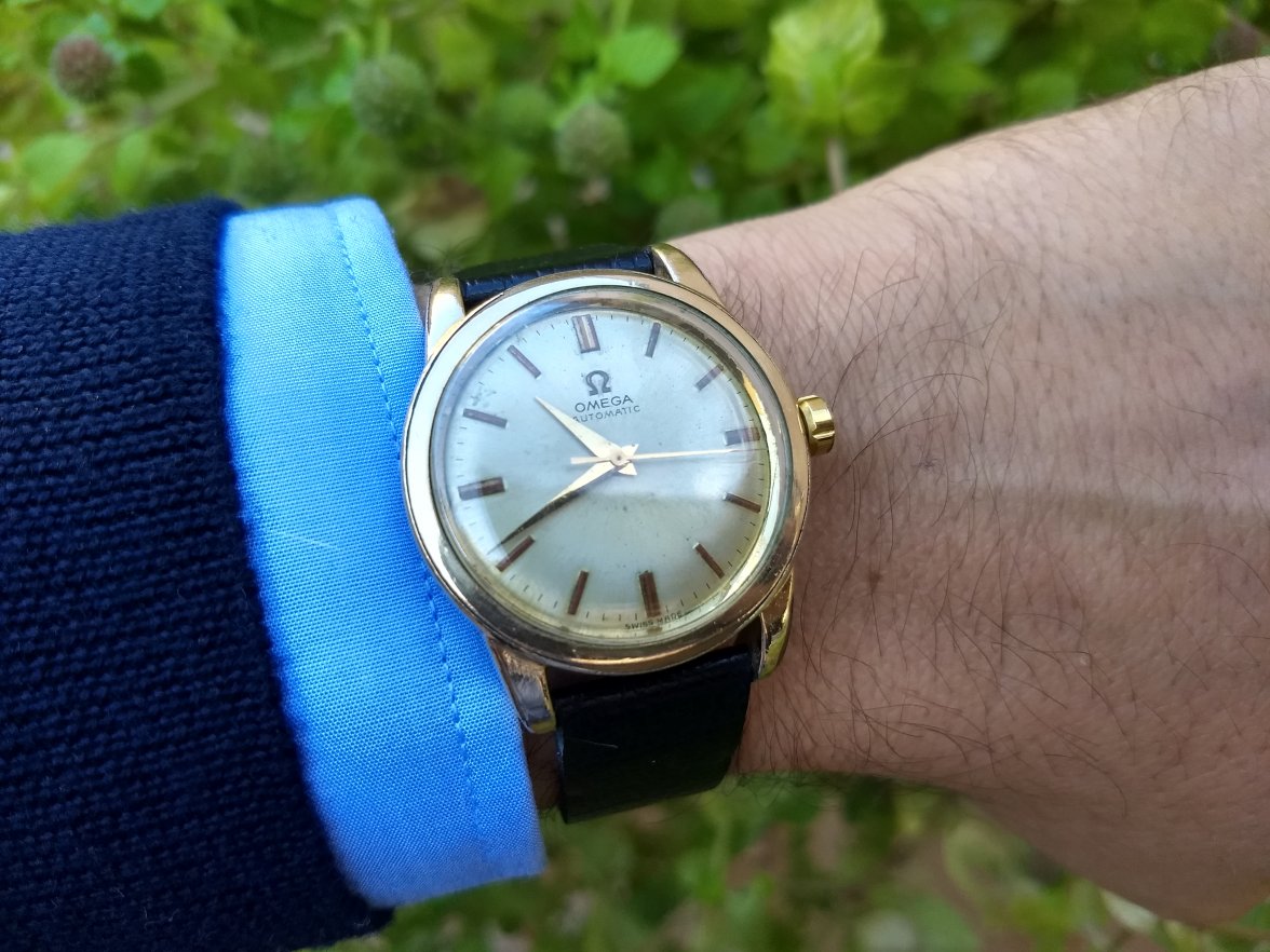

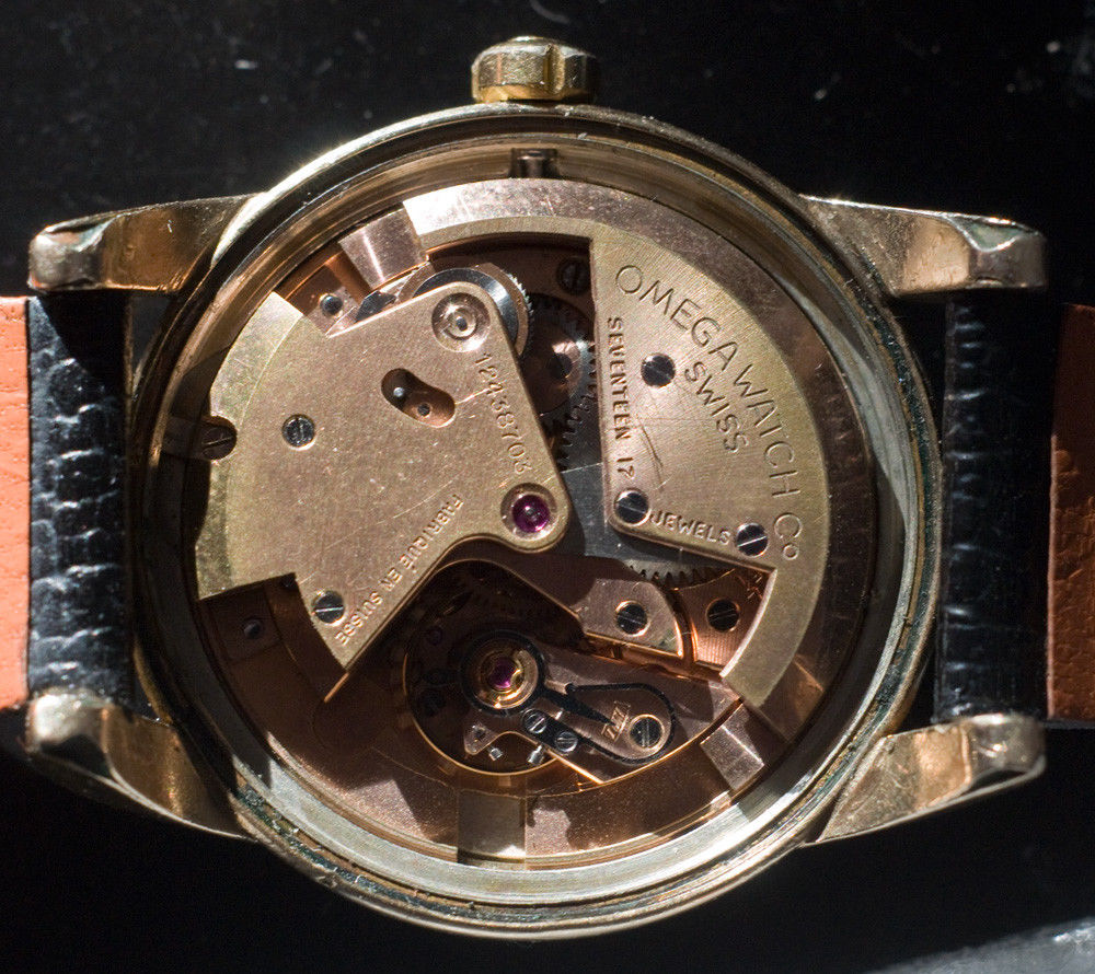

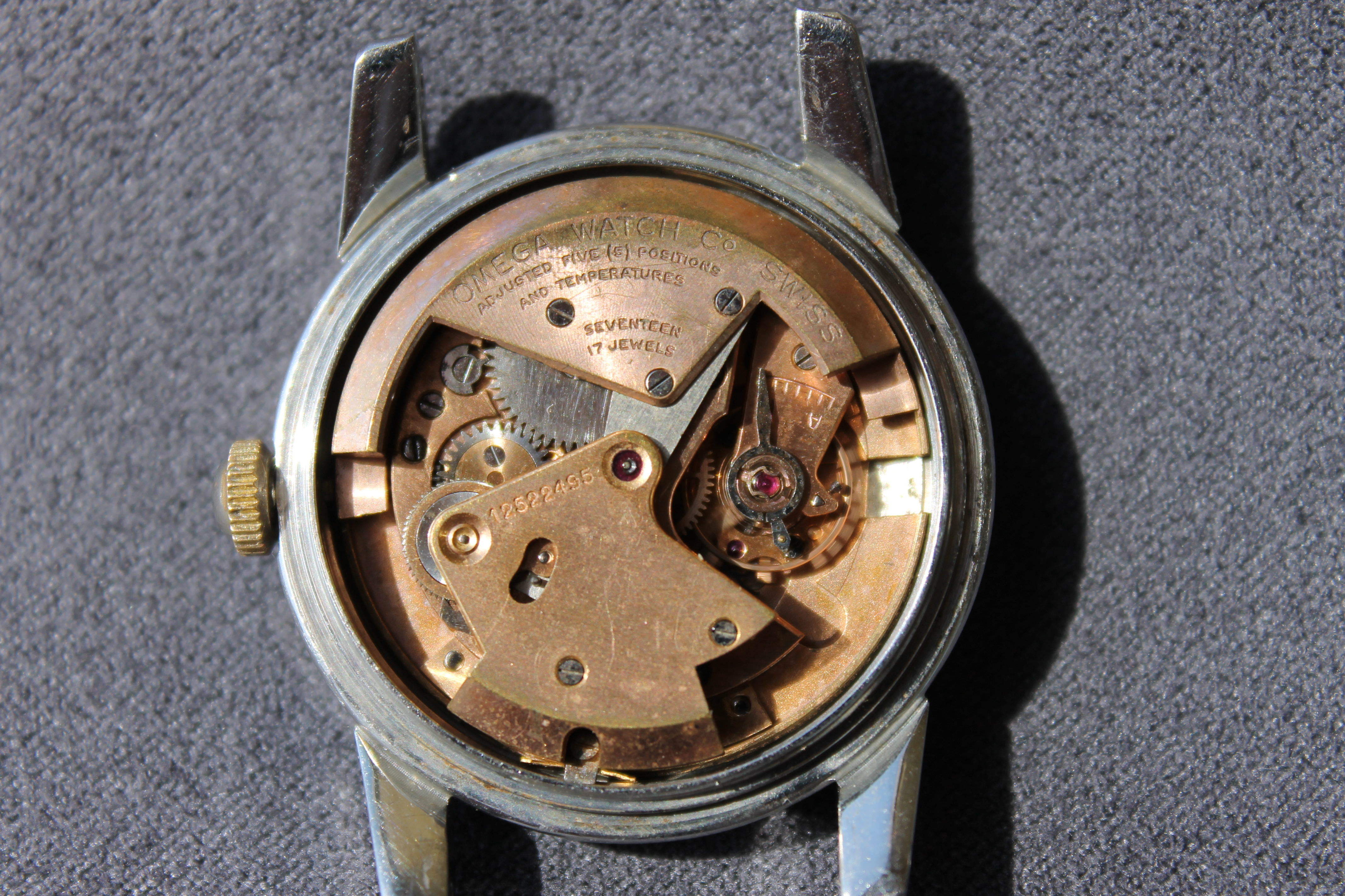

Good for you for considering sampling bumpers. Only two live here and both were inexpensive Ebay finds. Neither of them were very costly to have rehab'ed by my dependable watchmaker.
Since that time both have proven to be trouble free and among the most accurate of the watches in the menagerie here. Mind you, they don't frequently see daily wear, but only occasional wear for enjoyment. It's fun to feel them occasional "bump." They have proven to remain adequately wound if subjected to wearing over several days' time. It's been 3-4 years since they were serviced and they proved reliable.
A 1949 caliber 351 (top) and a 1954 caliber 344 (bottom)
The 1940s/1950s Omega bumper automatics aren't quite as inexpensive to acquire as they were only a few years back.

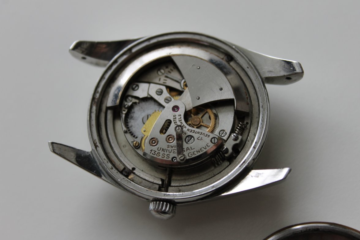

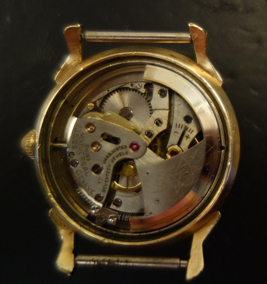

Early UG Polerouters with the cal. 138SS movement should also be in your list.
92d4541f-8d7a-41c5-9dd2-3a07ff11b00f-jpeg.641348
https://omegaforums.net/threads/sas-polarouter-auction-at-sotheby´s.83786/#post-1077245
Well, not necessarily that particular example. 😀

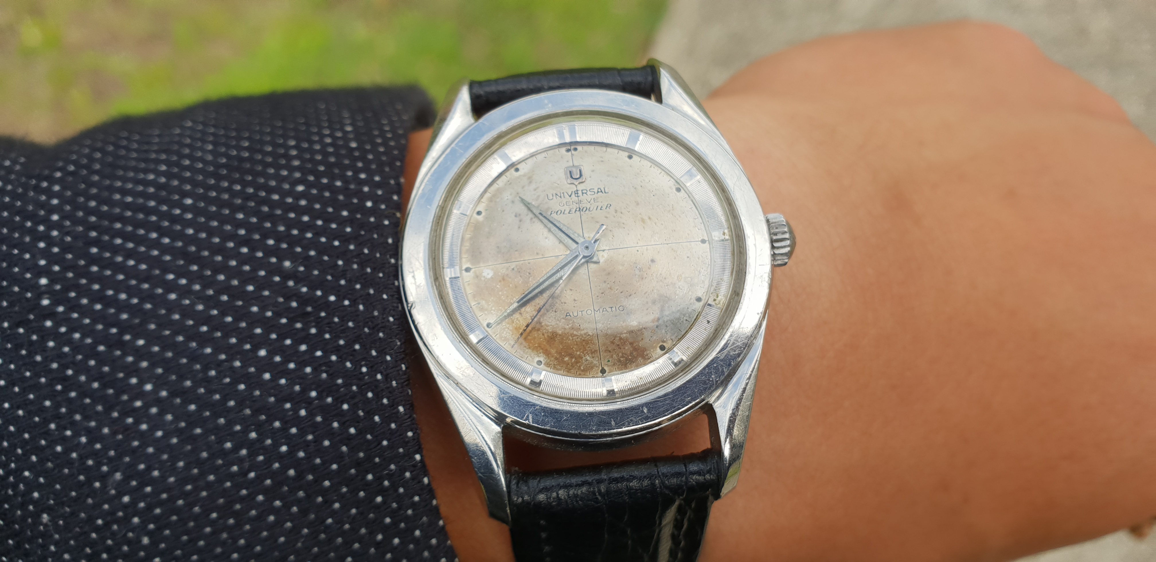

My 1967 Universal is the best example(and I can't find the other one at the moment), yes you'll hear it and feel it. In fact, just putting it on now....you'll hear it more than feel it. It swings around and hits the stops hard as you move your arm up and down....like when picking something up. Feels like something is loose inside. In fact, when I came across this watch again after several years, I literally thought it was broken.
It's an acquired taste. A quirk of the vintage era.

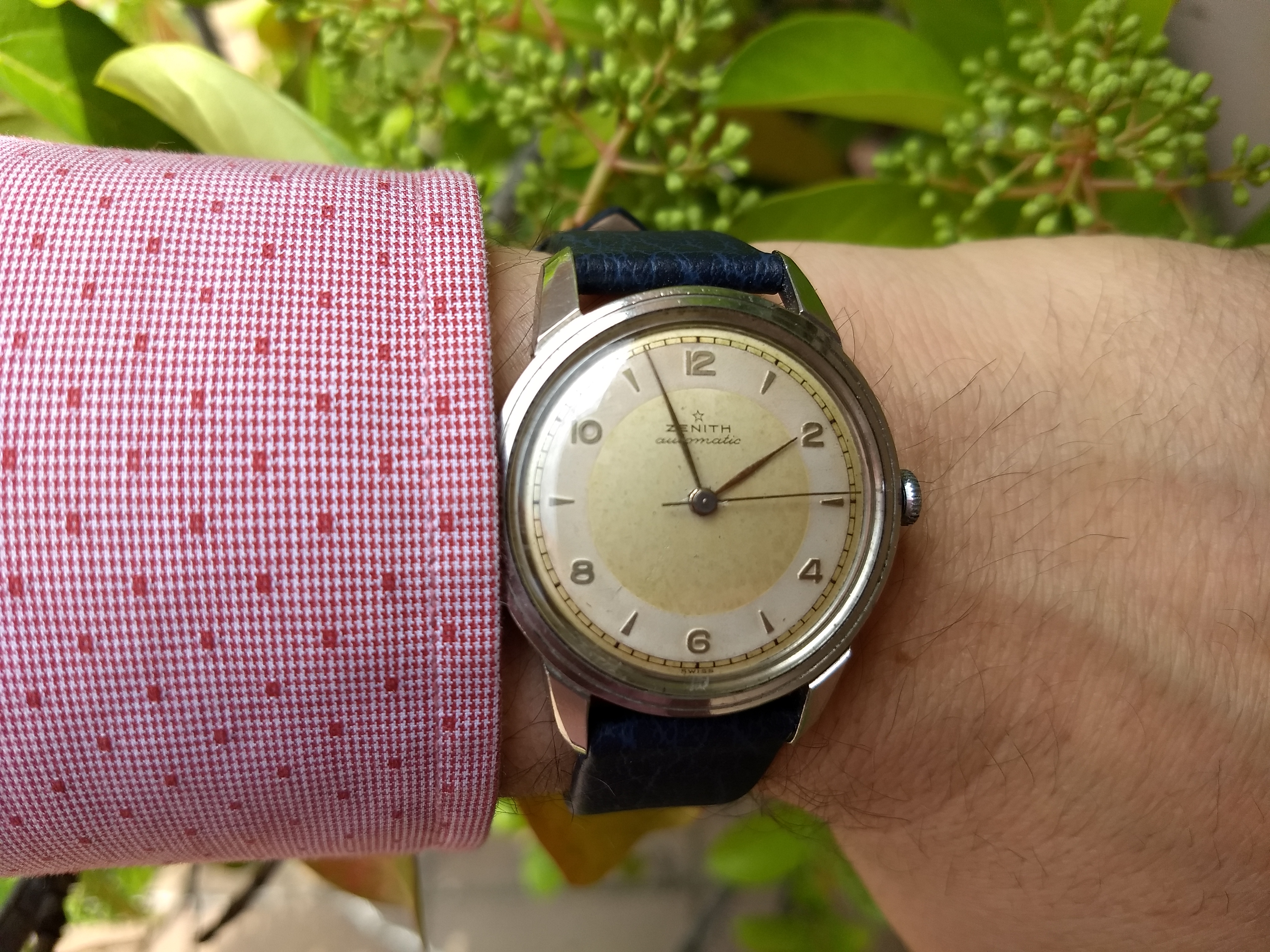

Zenith bumper, lucky you......

UG 138SS movement, 1967

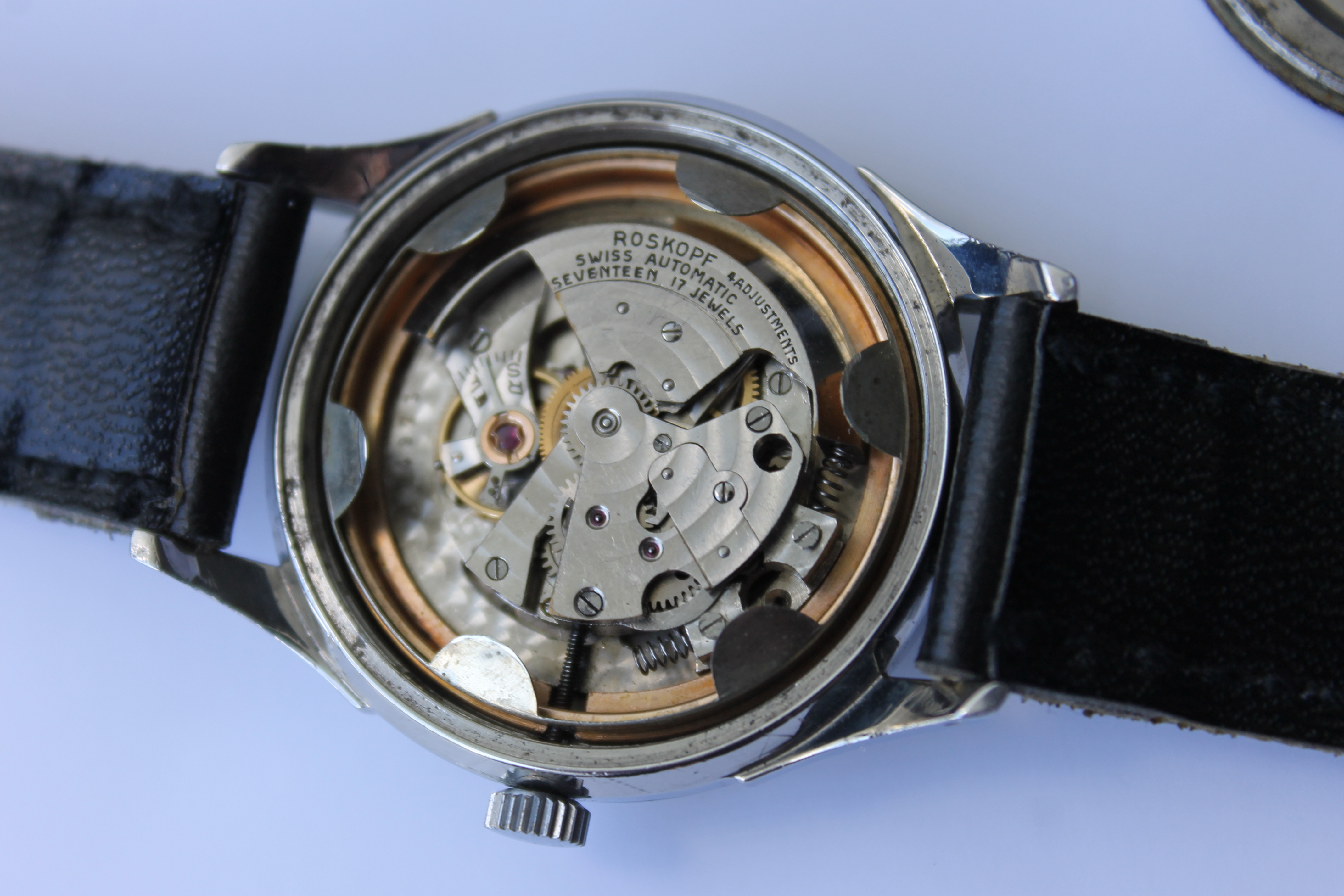

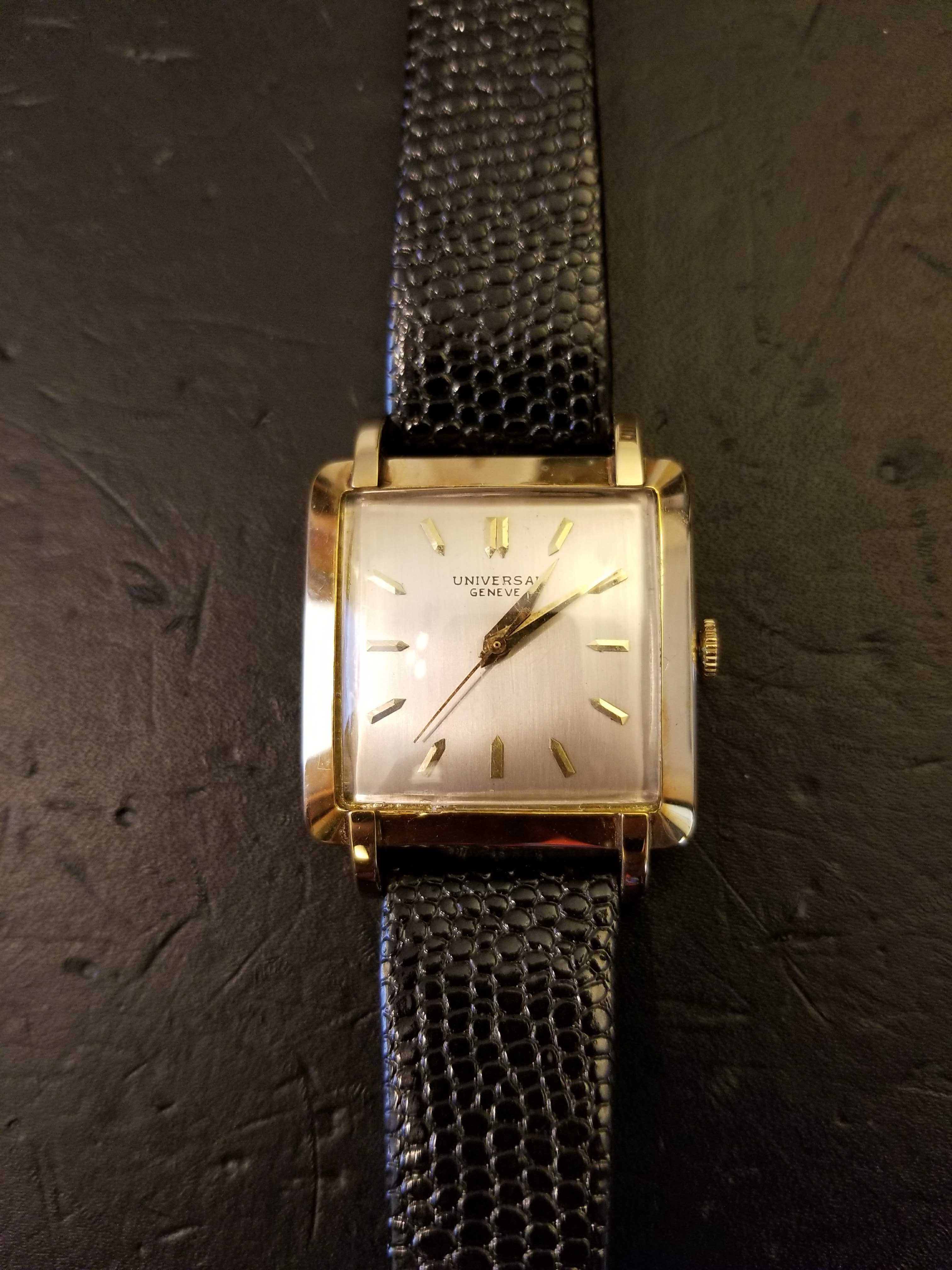

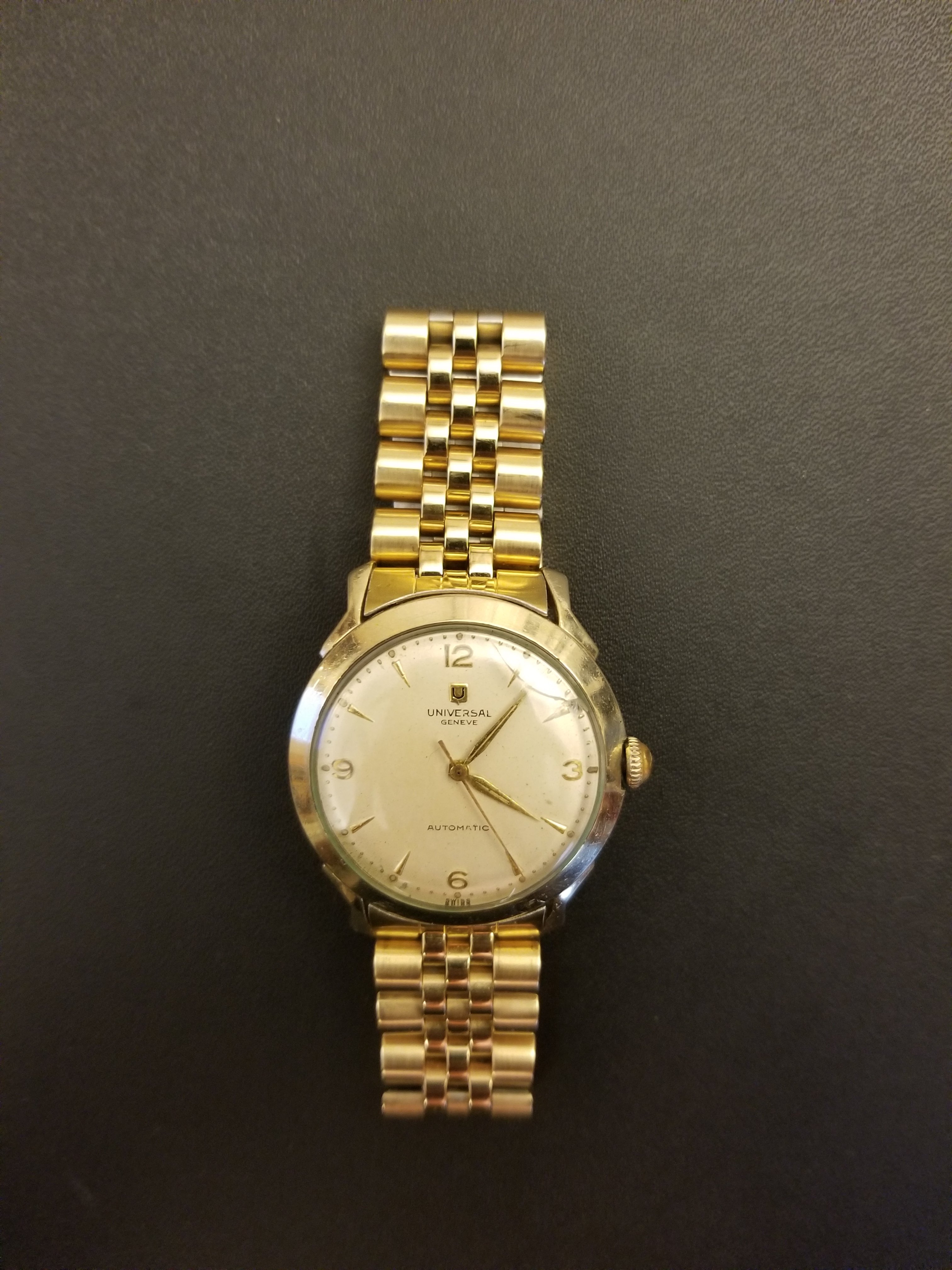

UG 139 Movement, 1952 (crap, don't have movement pic but its a very attractive watch.) Noisy but still holds 5sec/day.
