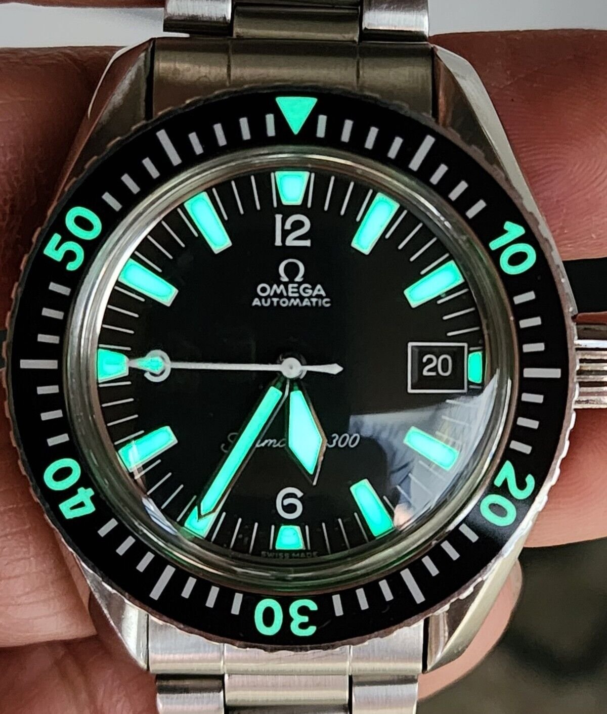

From what I've seen, the hand-matching issue isn't very noticible in most lights. The picture I attached to the original post was the most obvious example I could find via my searches on the web.
I've also noticed that the bezel seems to be whiter than the C3 hands and dial, so one way or another, you're looking at some kind of mismatch 😉

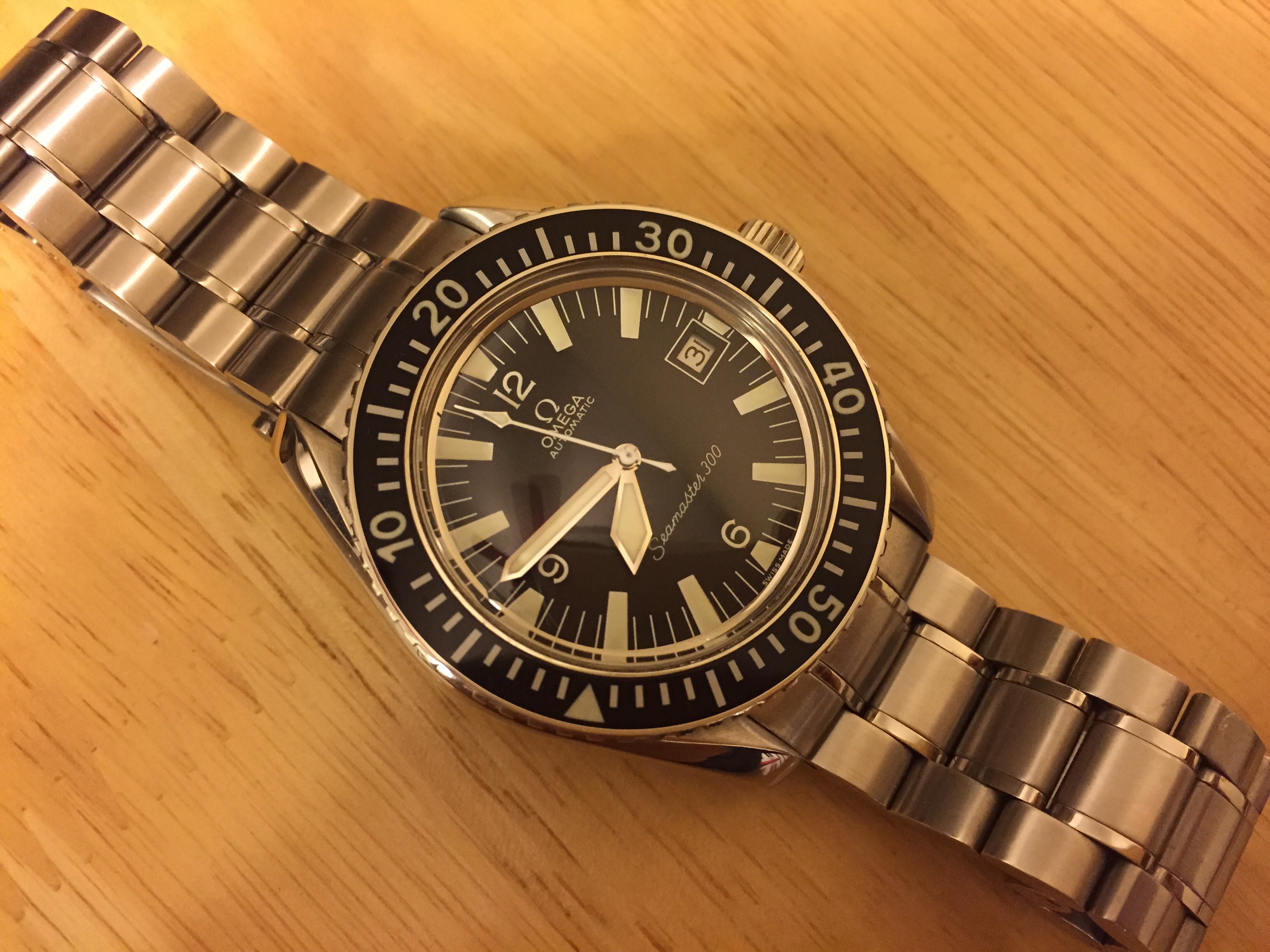

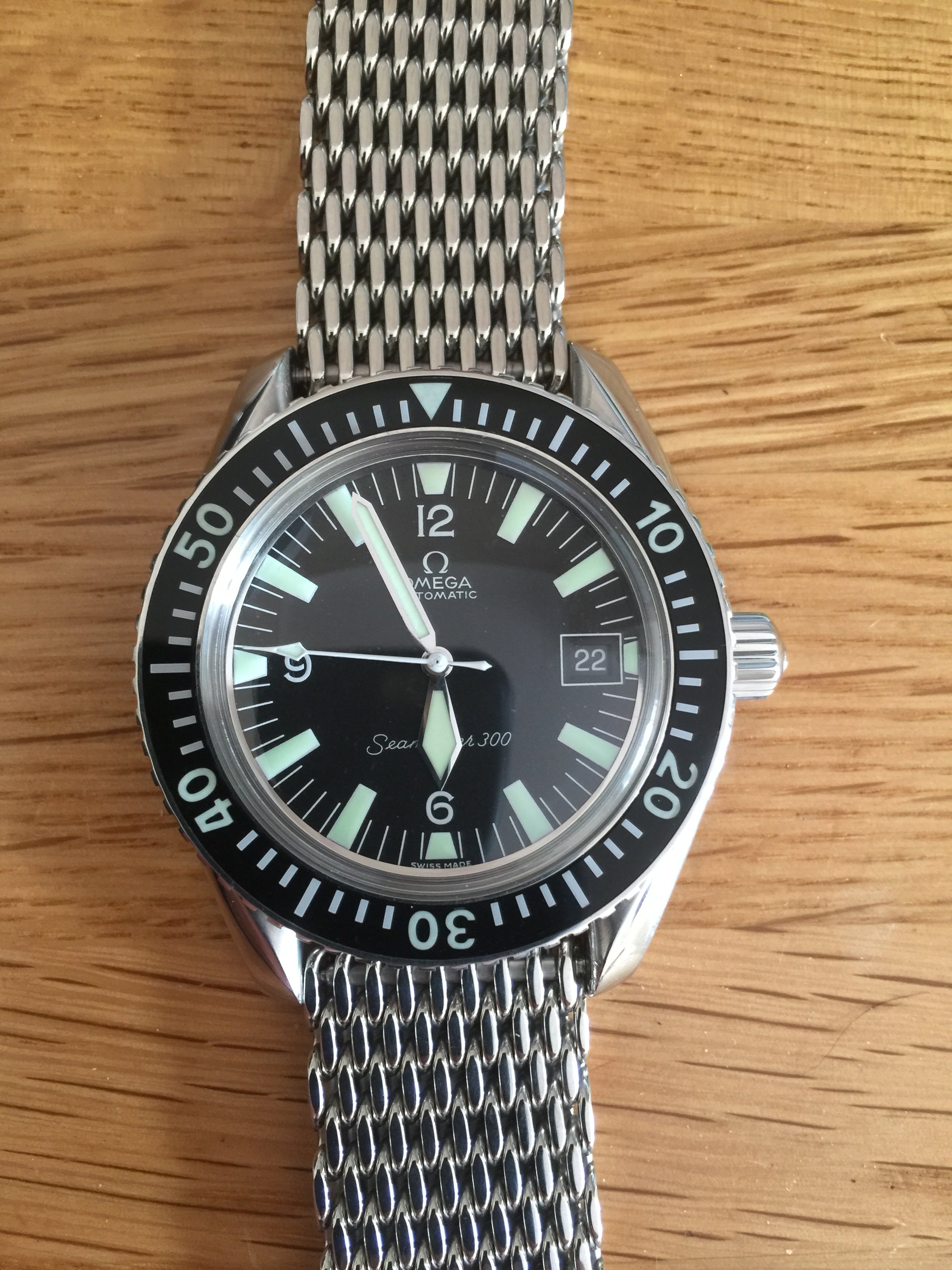

I noticed difference in luminova too, I'll have to take a picture of the 4 I currently own (parts from 5-10 years ago).
Here is the last one I got... made out of 2017 replacement dial/hands : same color, same green luminova under UV light:
Thanks for posting this! Did you buy the last one direct from Watchco? Marcus indicated to me that the more recent dial/hand replacements have been made uniform and it's no longer an issue.
If mine on order ends up looking the same as yours, I'll be a very happy camper 👍

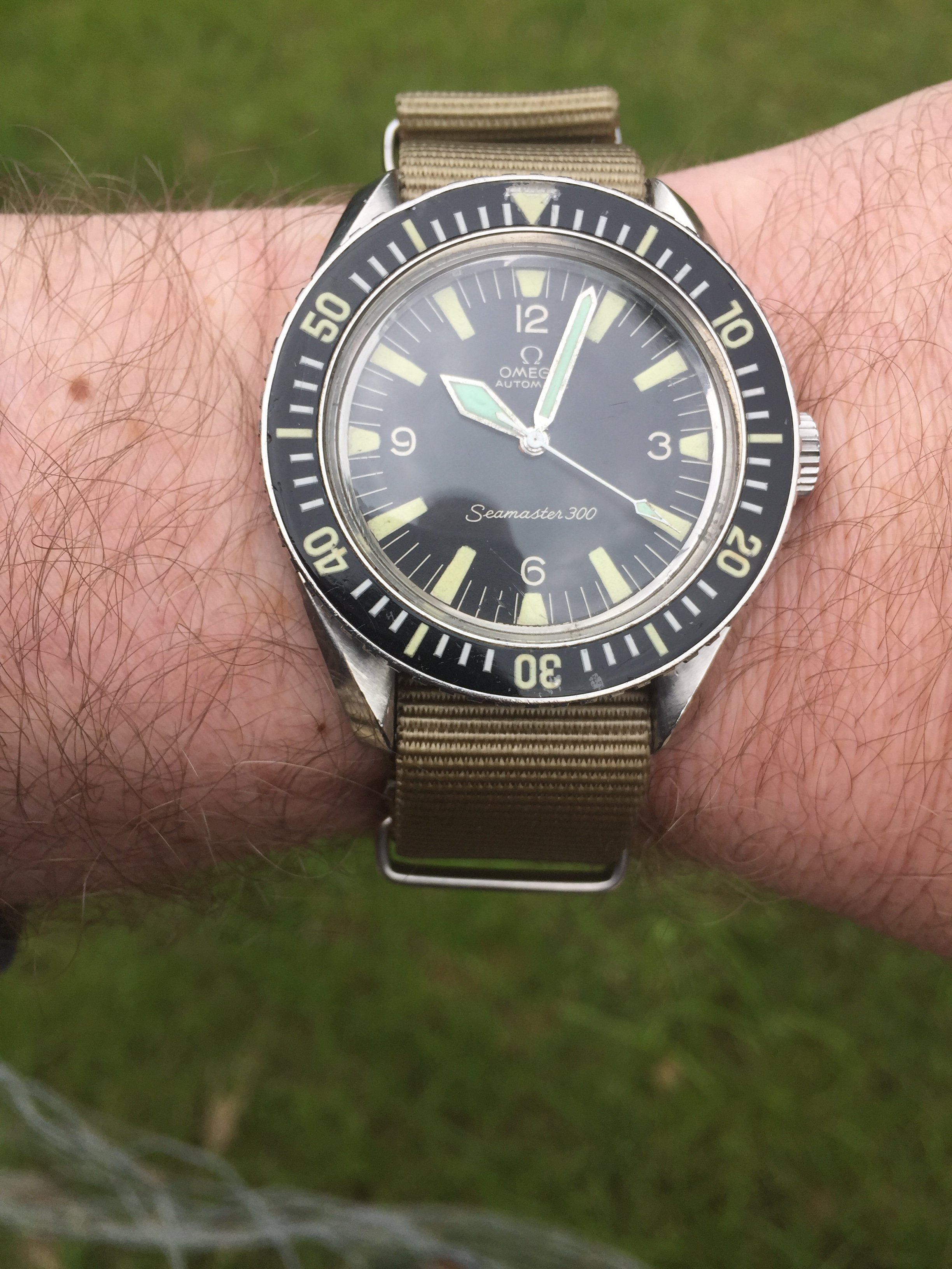

Interestingly, the mismatch might be historically correct given that many of the genuine, vintage SM300's I've seen seem to have developed very different hand and dial colour/patina combinations over the years.

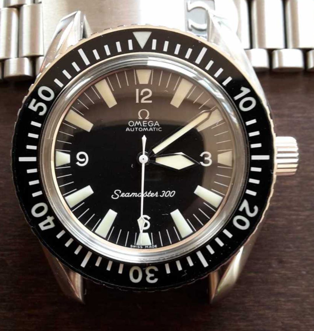

I just had one made (dial & hands ordered in 2019). I'm under the impression that the slight difference in color is the lume-application thickness, given that the seconds hand matches the markers whereas the hr/min hands appear a bit "richer". My guess is C3 all around, but I'm open to opinions 👍

Old thread but interesting content so I've risked bringing it back up 😗
Wow, I really like that photo. As well as considering the lume-application thickness, the question makes me think of this theory:
"Simultaneous contrast refers to the way in which two different colors affect each other. The theory is that one color can change how we perceive the tone and hue of another when the two are placed side by side. The actual colors themselves don't change, but we see them as altered."
Clearly this is not always going to be the case but possibly something to consider at times? In the photo above could the lume on the hour and minute hands appear different to the seconds hand simply because they're not painted white? I don't know, I'm not an expert on color theory. I find it interesting though that there could be times colors appear one way simply because of the surrounding colors.

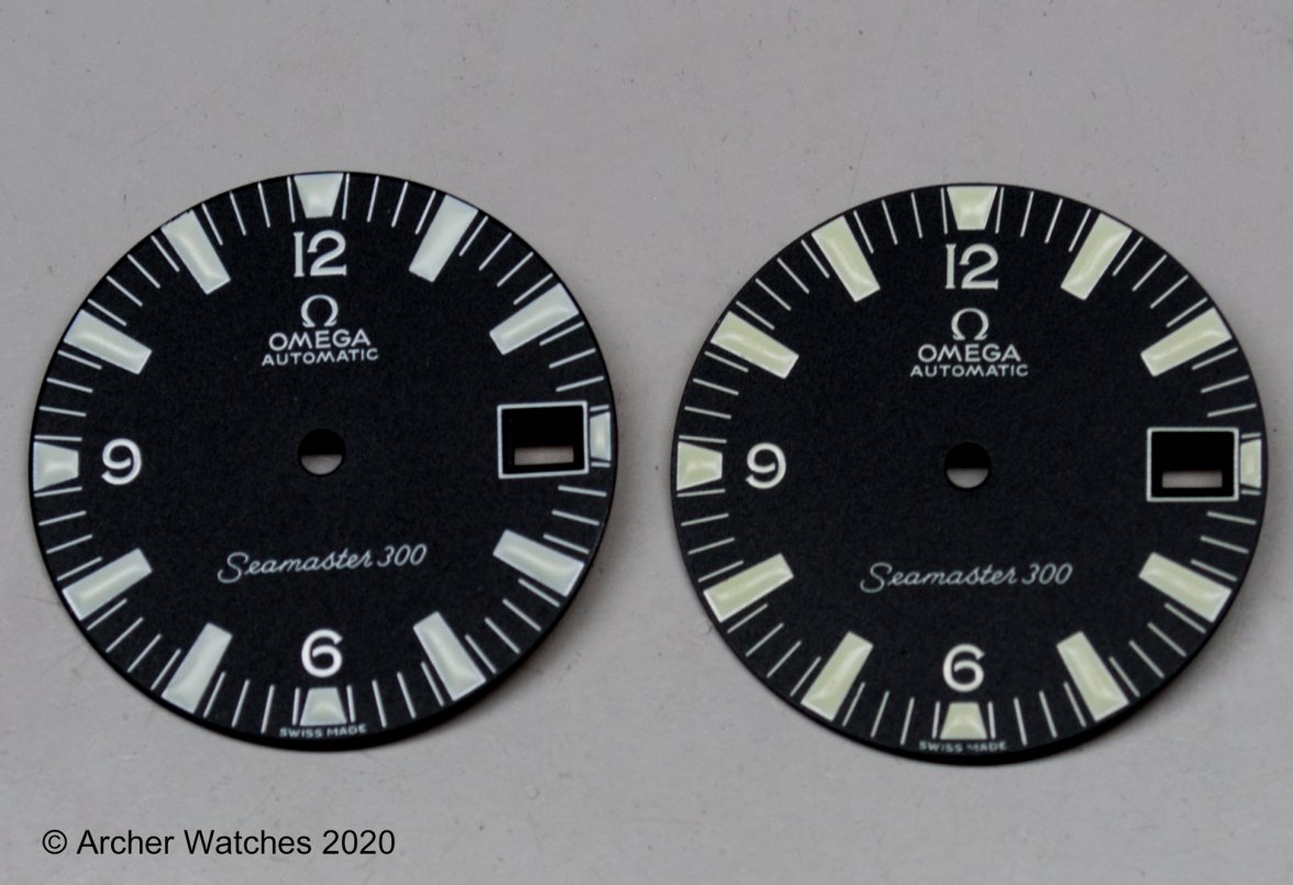

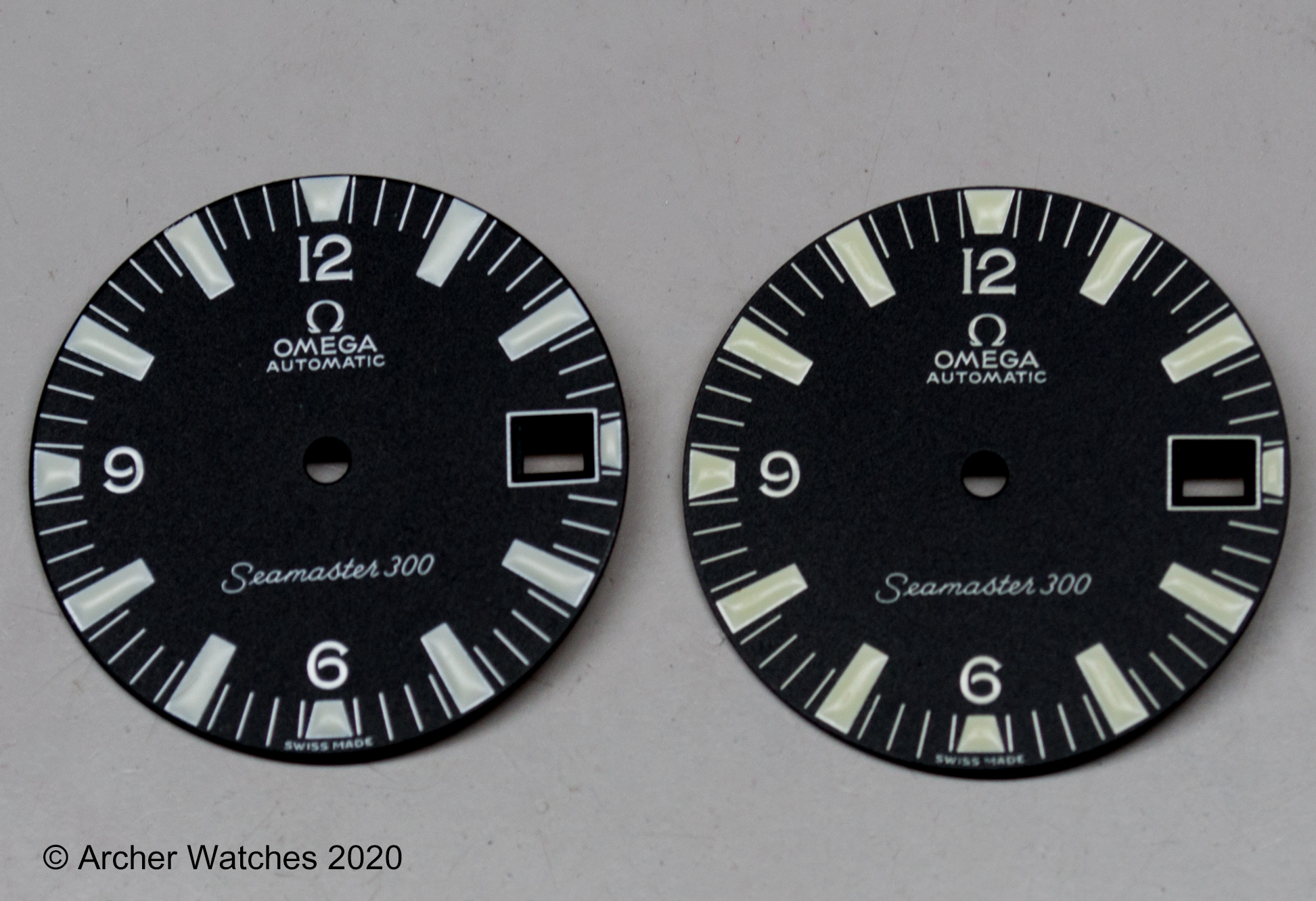

Hello...
Well let's compare the two dials side by side...and tell me if you think your theory is still correct. Note that I took this photo just minutes ago, and the only thing I have done is to increase the black level in this photo - if even slightly overexposed, the colours wash out and look very much alike. I can tell you that this is what they really look like side by side in real life, and the difference is stark to say the least.
There is no difference at all in the amount of lume applied to either dial. If you wish, I can take shots of the dials on edge to prove this, but I think even in this photo you can clearly see the height of the lume on each dial is the same.
The idea that it's the thickness of the lume, or colours surrounding the lume influencing your eye are quickly dispelled when you see these in person next to each other.
Cheers, Al
29,675
76,836
And just because I know someone will doubt that I didn't doctor the photos, here's a video as well...
Cheers, Al

...Well let's compare the two dials side by side...and tell me if you think your theory is still correct. ... There is no difference at all in the amount of lume applied to either dial...
Hi Al, thx very much for your feedback & imagery 👍
I wrote "given that the seconds hand matches the markers whereas the hr/min hands appear a bit richer" because in my pic (of my watch) only the hour and minute hands look to be darker / greener and thus I suggested the hands have more (layers of) paint.
Your two dials are for sure very different - no question about it. Which Superluminova would you say my dial has? C3 is my guess, despite the variation between the (two) hands and dial... 🤔
Last but certainly not least, my macro photos are generally done with long exposure-times (>1s) which allows for "richer" exposures when it comes to stuff like lume 😉

Thanks for the reply. You suggested that you believed the colour differences were due to different thicknesses of paint, and used hands as an example of that. If you are saying that your comments were not at all related to the dials, then it was odd that you quoted my previous post, which was specifically about the dials. So if you were only referring to hands, then that certainly wasn't clear to me.
The colour of lume in your hands is the same (as are all the hands for these), so there really is no colour "difference" and as you say, the colour is richer (more concentrated) but not actually a different colour. This of course is related to thickness of the lume, what background colour, if any, may be behind the lume, etc.
As I have mentioned the C1 dials were only found in date models, and all the no date models were C3. Over the last maybe 18-24 months (not keeping track really so it's a guess) all the date dials I have received have been C3 dials. I was sort of expecting that these dials were made by different makers, and possibly that would account for the lume difference but both are the same maker, made at different times...
So I would expect that yours is C3 based on your photos. As for the colour of the date indicator, that has been debated before and I'm not sure there has been any solid conclusion. I think nearly all of the originals sold by Watchco has silver date indicators with black lettering, but they also often used the wrong shape of date indicator (curved rather than the flat style that should be used here), so I don't think that is any real indication that black on silver is correct.
Cheers, Al

...the colour is richer (more concentrated) but not actually a different colour. This of course is related to thickness of the lume, what background colour, if any, may be behind the lume, etc. ...
...Over the last maybe 18-24 months (not keeping track really so it's a guess) all the date dials I have received have been C3 dials.

Al, apologies for any confusion I may have caused and thank you once more for the additional feedback on the dials 👍
Re. Datewheel... I've seen a few (vintage & "WatchCo") with black background, white lettering like the following example - (one of) your own... 😁

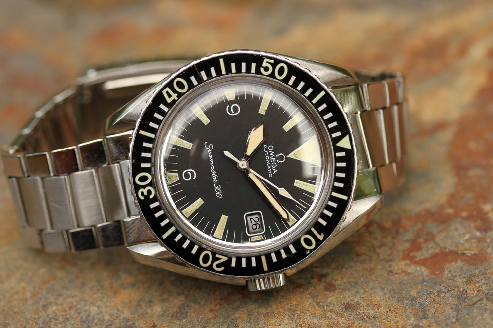

Whoever Omega farmed out manufacturing replacement date dials to in the modern era underperformed on the historical accuracy front.
The original 1960s date dials had a stunning curved beveling around the date aperture. But, unfortunately, the modern era luminova date dials have a squared off date aperture window which doesn't maintain the classic original look.
Or perhaps the modern era dials have original curved beveling but it's just the printed white square frame border that is incorrect?
