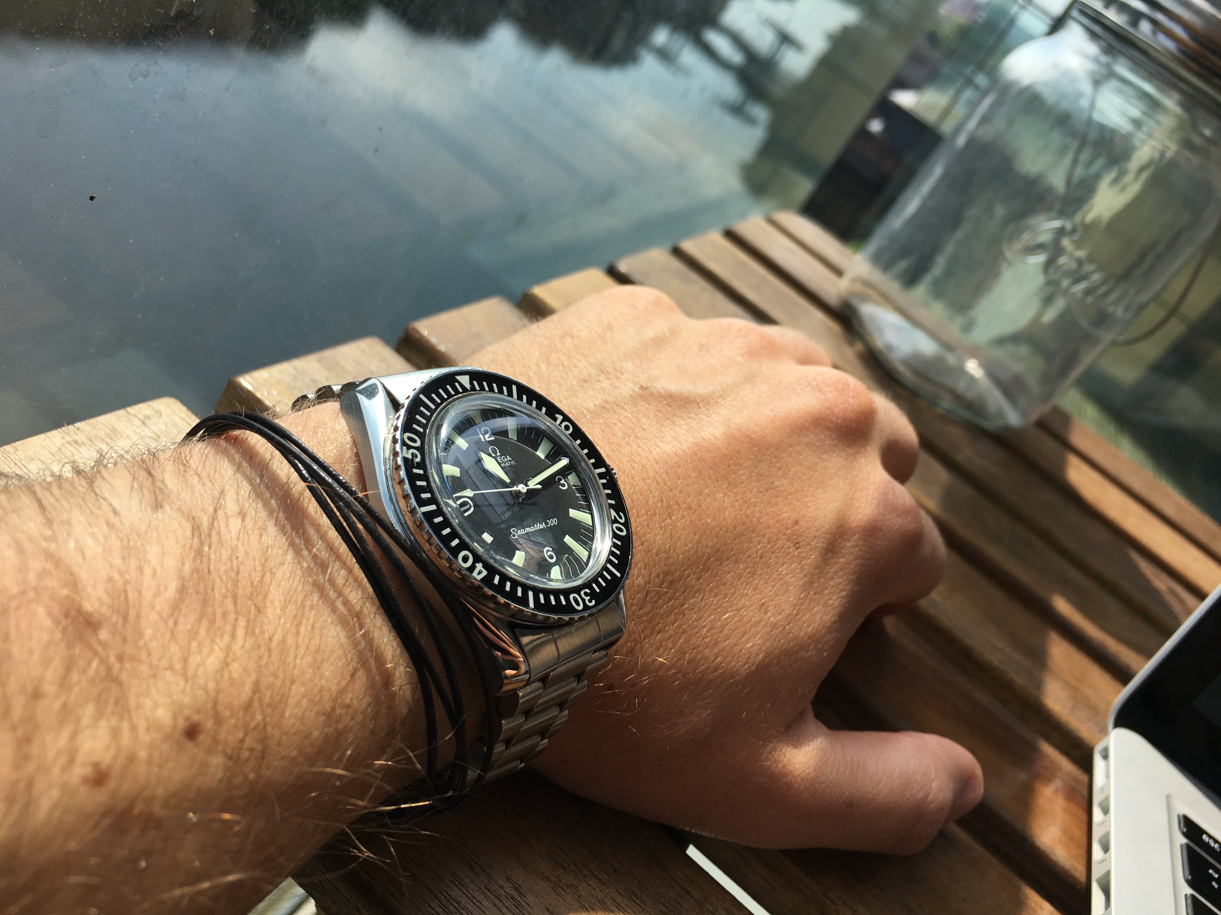

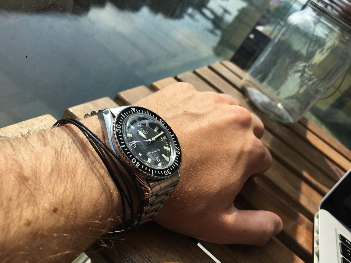

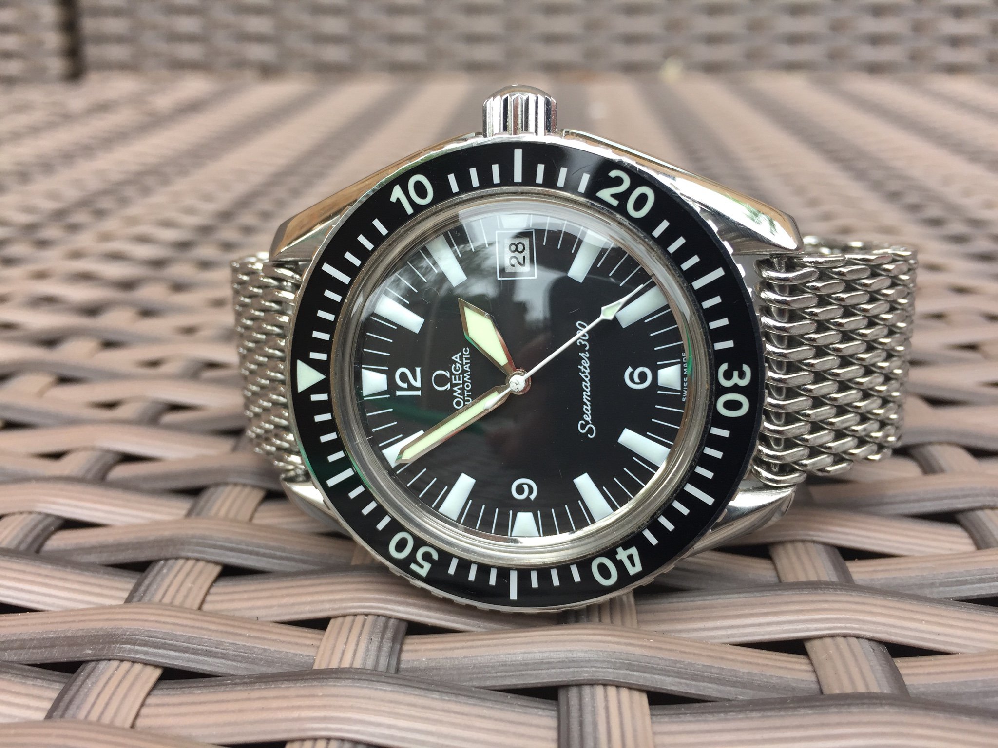

    1. I've noticed in some pictures that the super-luminova on the dial of these watches doesn't always match the lume on the hands... the hands often appear greener, like so:
    Is this just a function of the hands being more charged up in some of these photos? If this is a real thing, are all Watcho's like this?

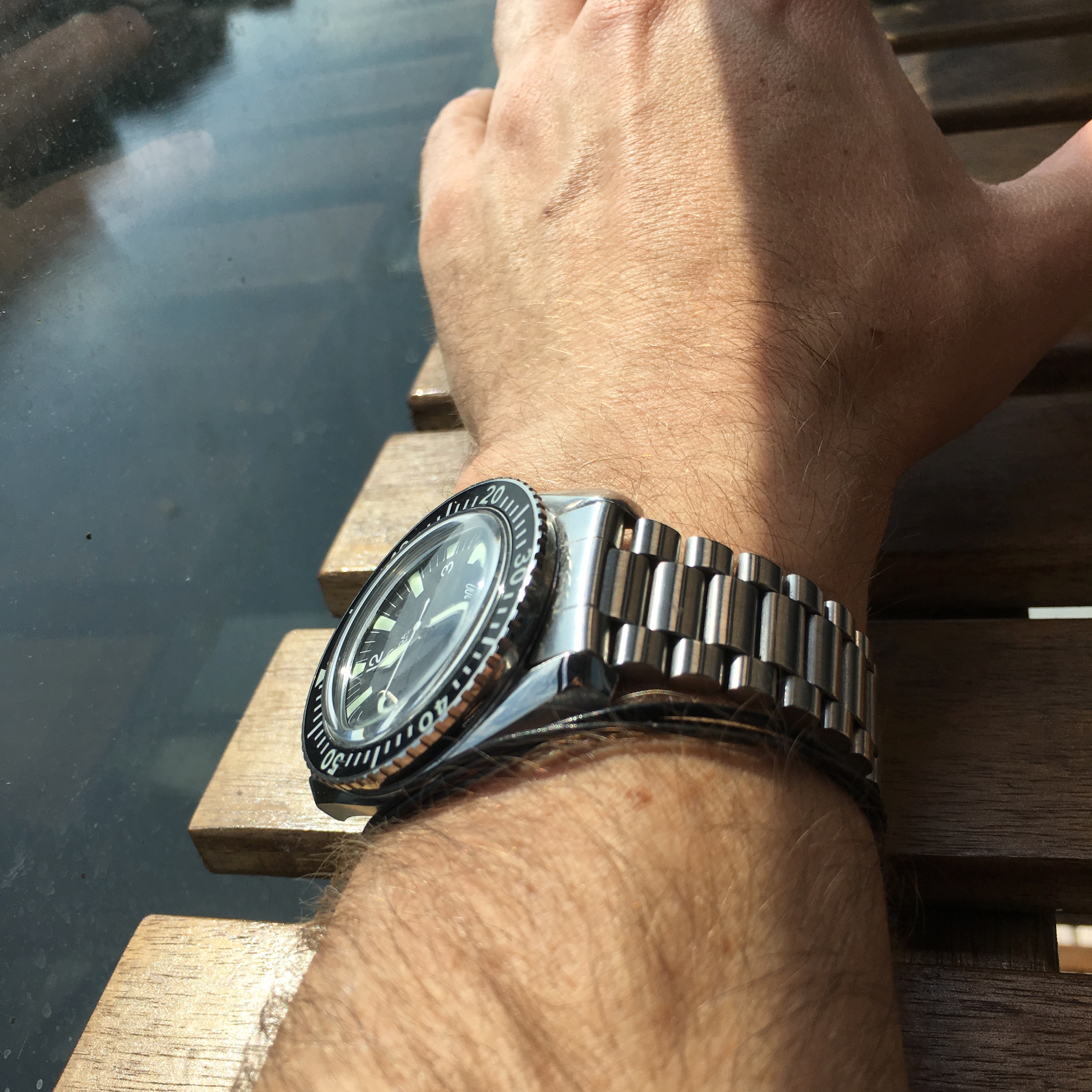

    3. The case seems very, very similar to the case of the modern Speedmaster Pro. If anyone owns both watches, I'd love to see a side-by-side comparison of each watch from various angles.

  3. Archer Omega Qualified Watchmaker May 28, 2017
    26,343
    65,053
    1-there are two dials for the date version. One has C1 lume that is more white, and the othe is C3 that is more green. The hands are C3, so what you are seeing is a mismatch. These dials aren't different part numbers, so when I have ordered dials it's a crap shoot which one I'll get. All the no date dials I've ever seen are the more green C3 version.

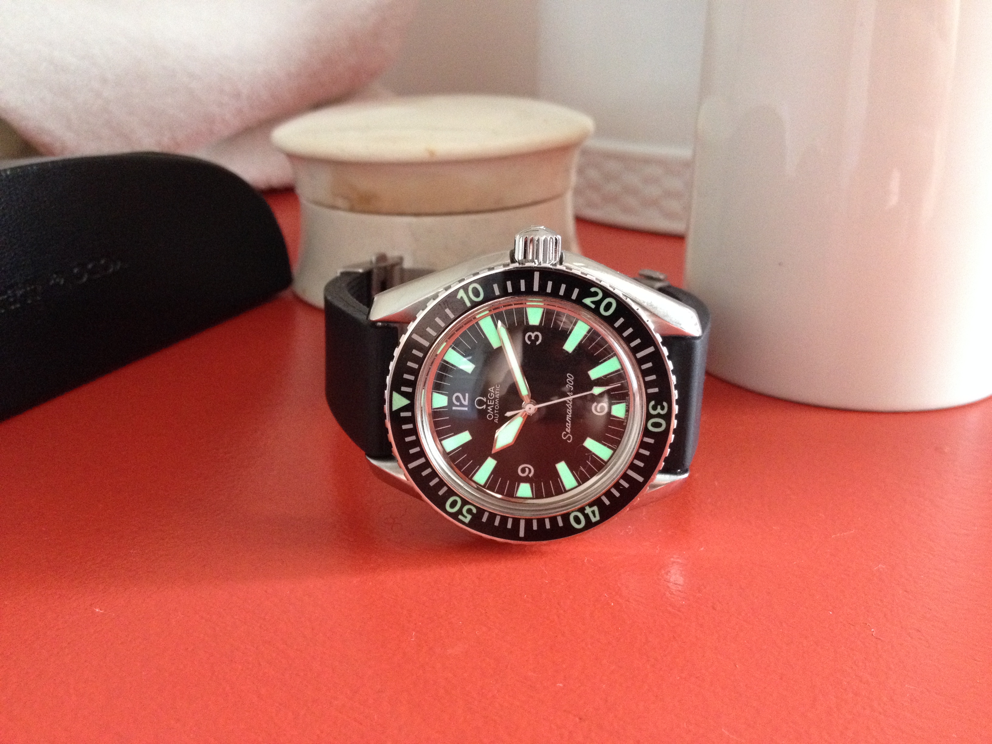

  5. micampe May 28, 2017
    1,626
    6,171
    Here’s my favorite strap, a dark green cordovan by @jankoxxx.
    My crown is not sticky and I do take it in water.

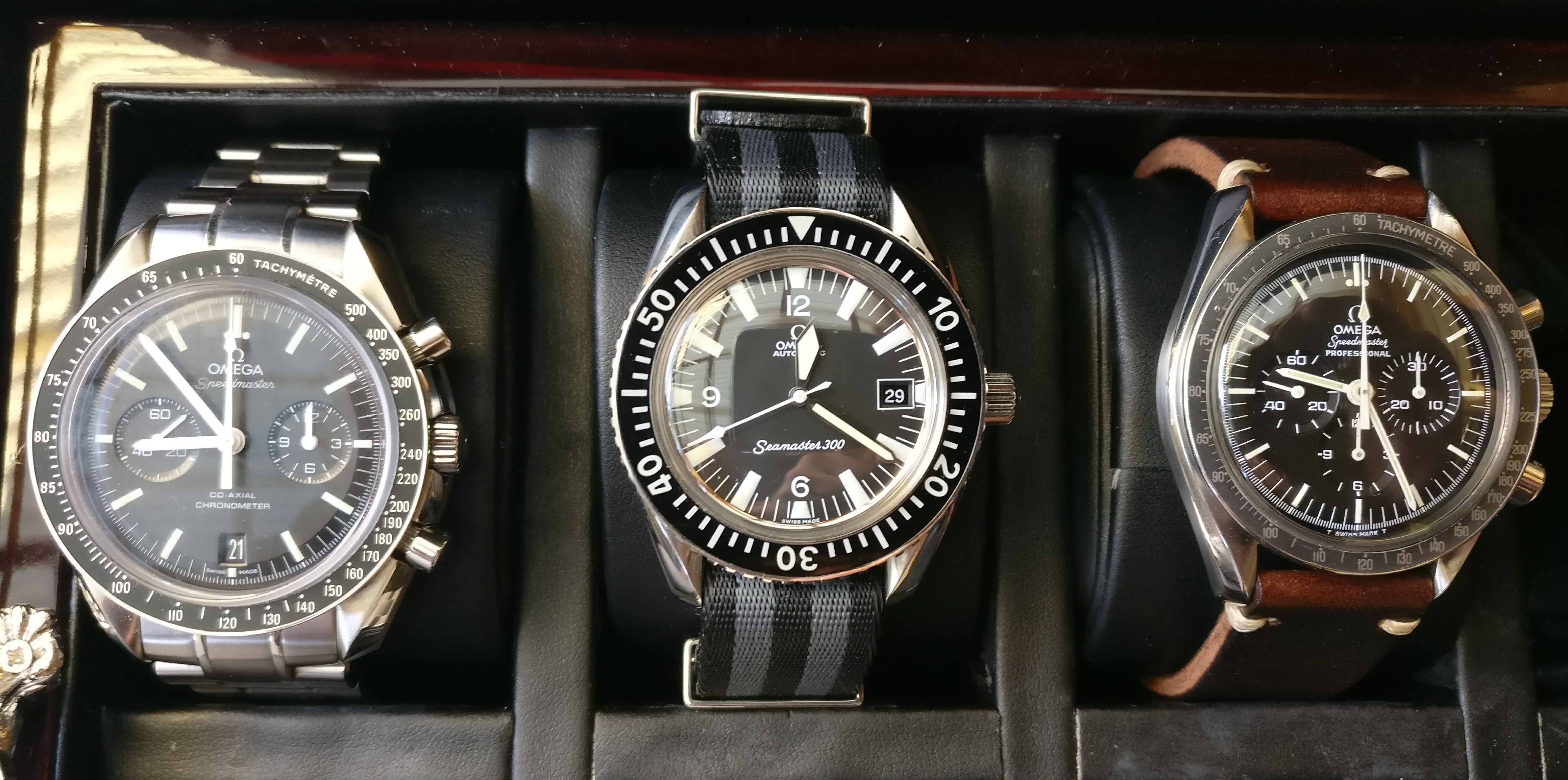

  7. WurstEver May 28, 2017
    435
    1,581

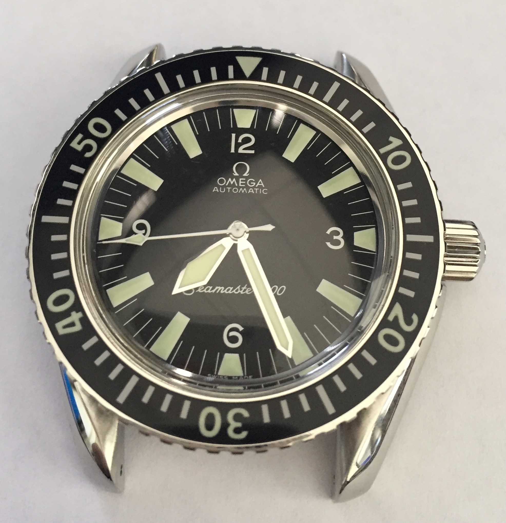

    Just the one angle here, flanked by a relatively old speedy and a relatively new one. You're right, the shape of the lugs in particular is quite similar to the speedmaster.
    I tend to keep mine on the Omega Bond NATO, although I have also had it on the bracelet and quite enjoyed that look. The lume on the hands and dial on mine are different colours, just like in your photo above. But as you can see from this photo, the contrast appears different under different lighting. I've never had any stickiness in the crown. While I haven't been swimming with it yet, I had it pressure tested last week with the intention of taking it swimming soon.
    I like that this watch combines classic design with wearability. I'd be hesitant to wear a vintage model for fear of damaging it. Interestingly, I have had more compliments on this watch than anything else I own.

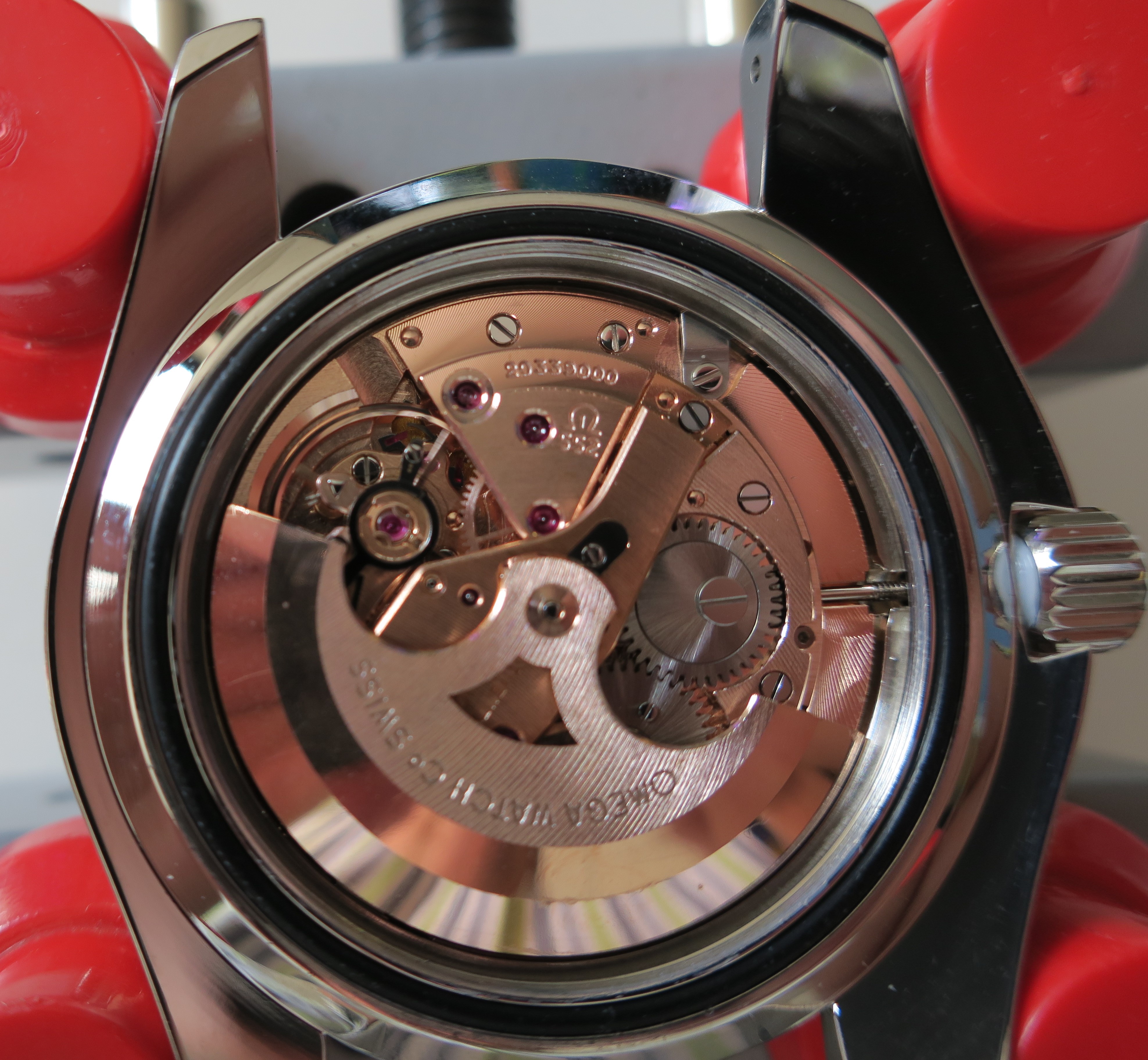

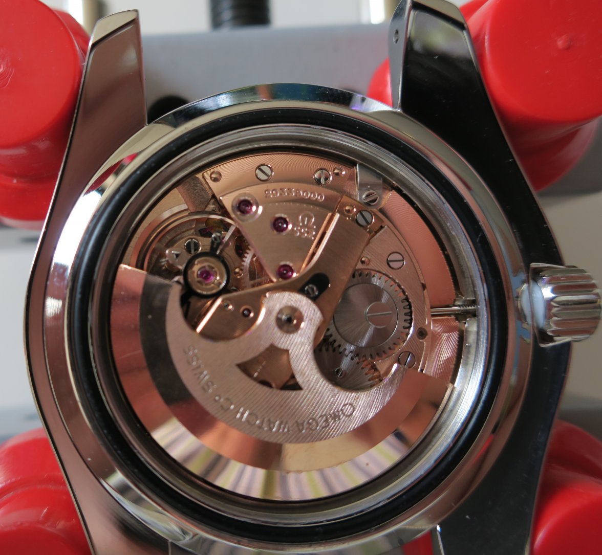

  11. davidswiss May 29, 2017
    1,078
    1,807

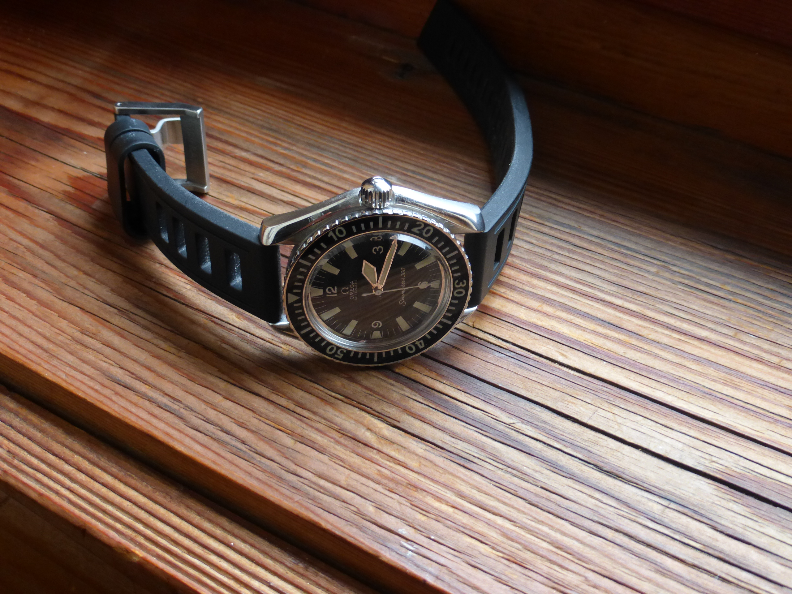

    I've a watchco built version. It needed a replacement crown on receipt as it wasn't waterproof when it arrived. Since then it's been fine and I use it when swimming. The movement was described as in a basic service condition, not adjusted and my local watchmaker confirmed all was well.
    I've attached a movement picture and one on it's isofrane strap which I find very comfortable. Lume seems the same for hands and dial to me. IMG_2468.jpg IMG_2672.jpg P1050162.JPG

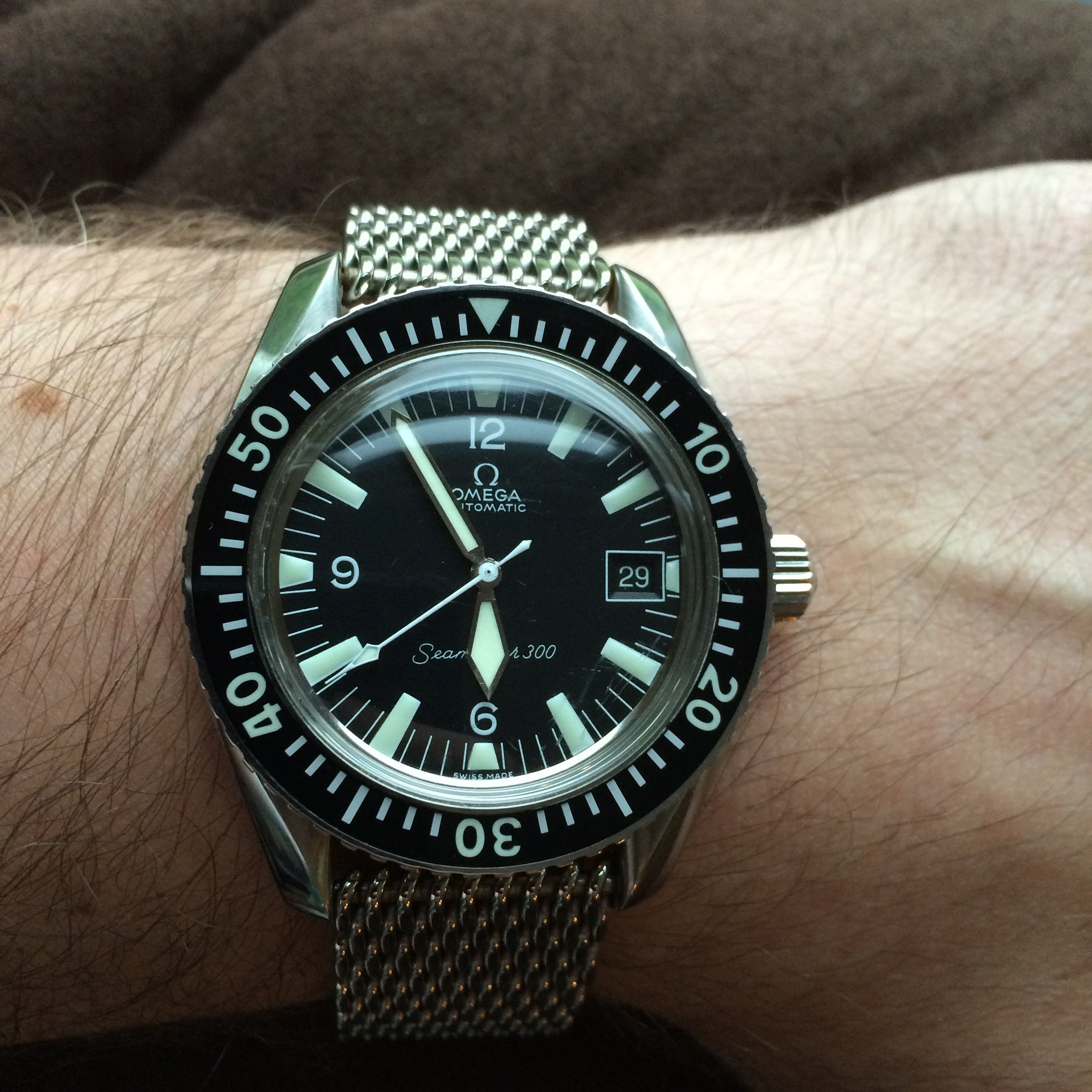

    I'm wearing my Seamaster 300 today. I built mine with parts sourced from watchco. The lume on the dial and hands match well. I never had stem issues and I take it swimming. I really held my breath the first time I did swim with it though. It is also the watch I wear while coaching my kids' Tee ball team. Last week while placing the ball on the tee a child swung early and connected with my watch. I played it cool and didn't check for damage immediately. When I glanced down it was still ticking but there was orange paint on the bezel from the aluminum bat! By the time the game was over the orange paint had fallen off and the damage was limited to a scuffed Crystal. I was lucky that they didn't swing hard or really connect with it. I wear it on Omega mesh. I may also build a non date version in the future as it is a great balanced look. I enjoy my "WatchCo" and It's vintage counterpart! image.jpeg Photo snapped right now. The bat hit it at about the 25 minute marker. I have no plans to wear it around kids that swing hard!
