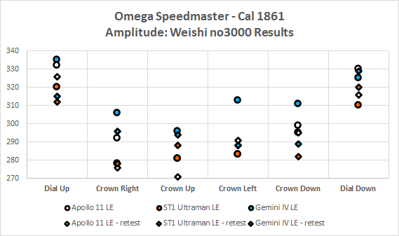

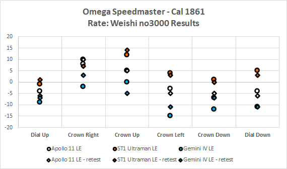

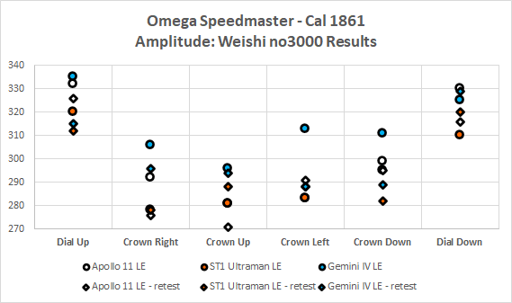

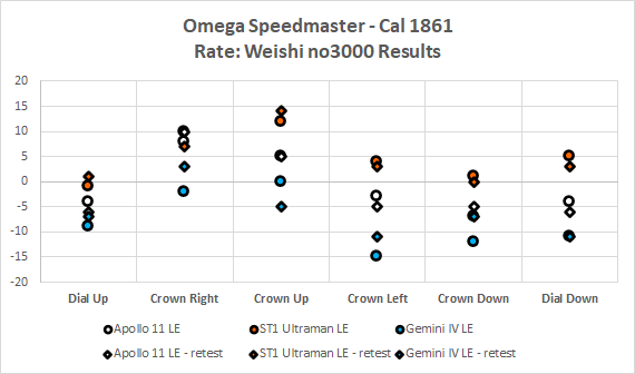

Simply try resting crown up or down yourself and see what you get out of it.
That's probably the best advice.
Generally speaking, dial up or down where the balance is in the horizontal plane will yield faster timekeeping whilst the other positions usually slow the watch up a bit👍
I have a simple Weishi no3000 tester that I used to measure 3 of my Speedies on. I saw a bit of a pattern so I repeated for each, with the similar pattern holding true. For my 3 Cal 1861's, they were fastest with the crown to the right or up. By no means are my results reliable (cheap tester) but they gave me some interesting data points.

The reason I asked is I wondered if you had some specific theory why this would be so, or if it was just anecdotal.
There’s no technical reason why what you have described would be typical. In fact since amplitude is higher in horizontal positions, the opposite would be more likely (depending on the level of isochronism). There’s no direction I’ve ever seen from watch companies, or given to watchmakers in school or anywhere else, to intentionally adjust a watch in this manner. What positions run fastest or slowest is actually pretty random.
