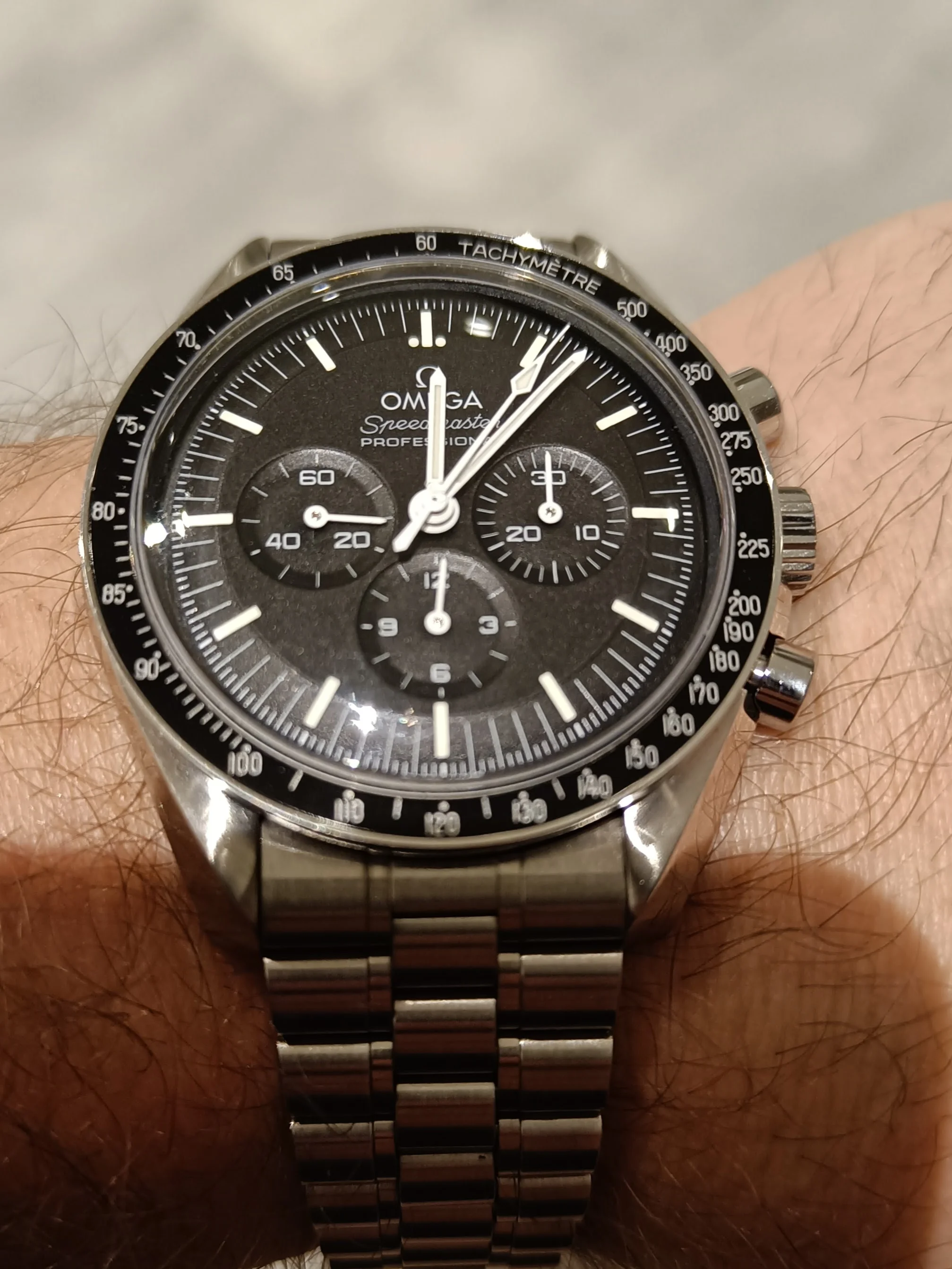

Hi everyone,
I'm looking for some advice regarding my 2024 Speedmaster. I've noticed that the chronograph hour hand moves faster than expected—after a full 12-hour rotation, it's off by about 10 minutes.
I sent it to Omega for repair through my AD, but as far as I can tell, they only performed a general service. There was no documentation acknowledging or addressing the specific issue, and the problem persists.
Is this kind of deviation something to be expected with a new Speedmaster? Am I expecting too much in terms of accuracy? I'd appreciate any insights from the community on whether this is normal and how I should proceed. I've attached an image showing the misalignment for reference. Note the chronograph hour- and seconds hand.

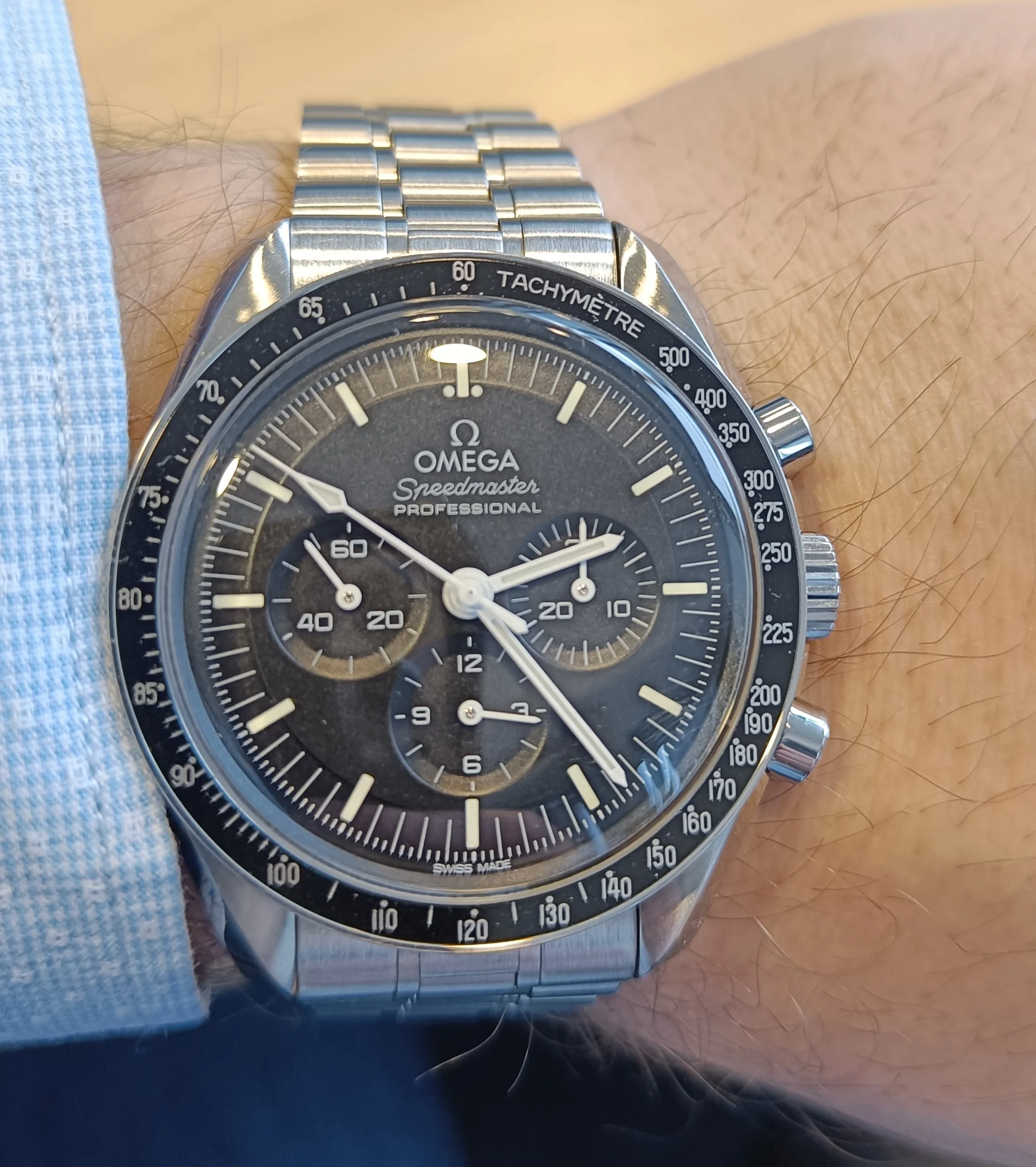

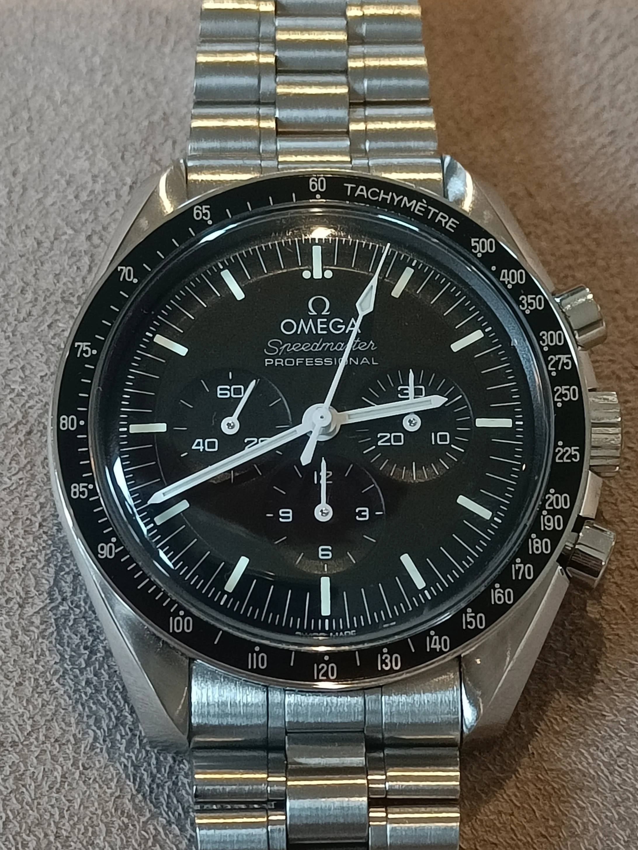

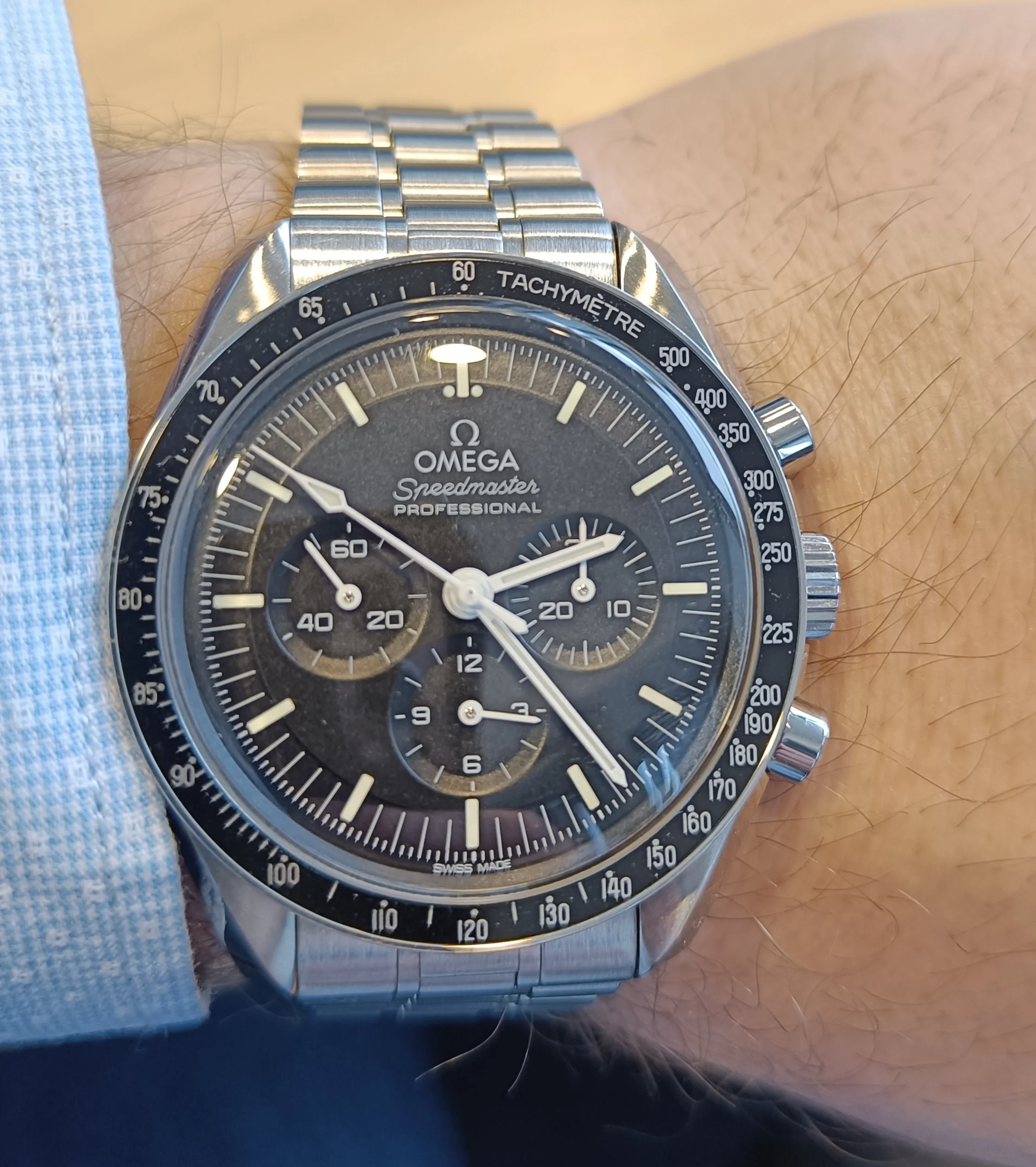

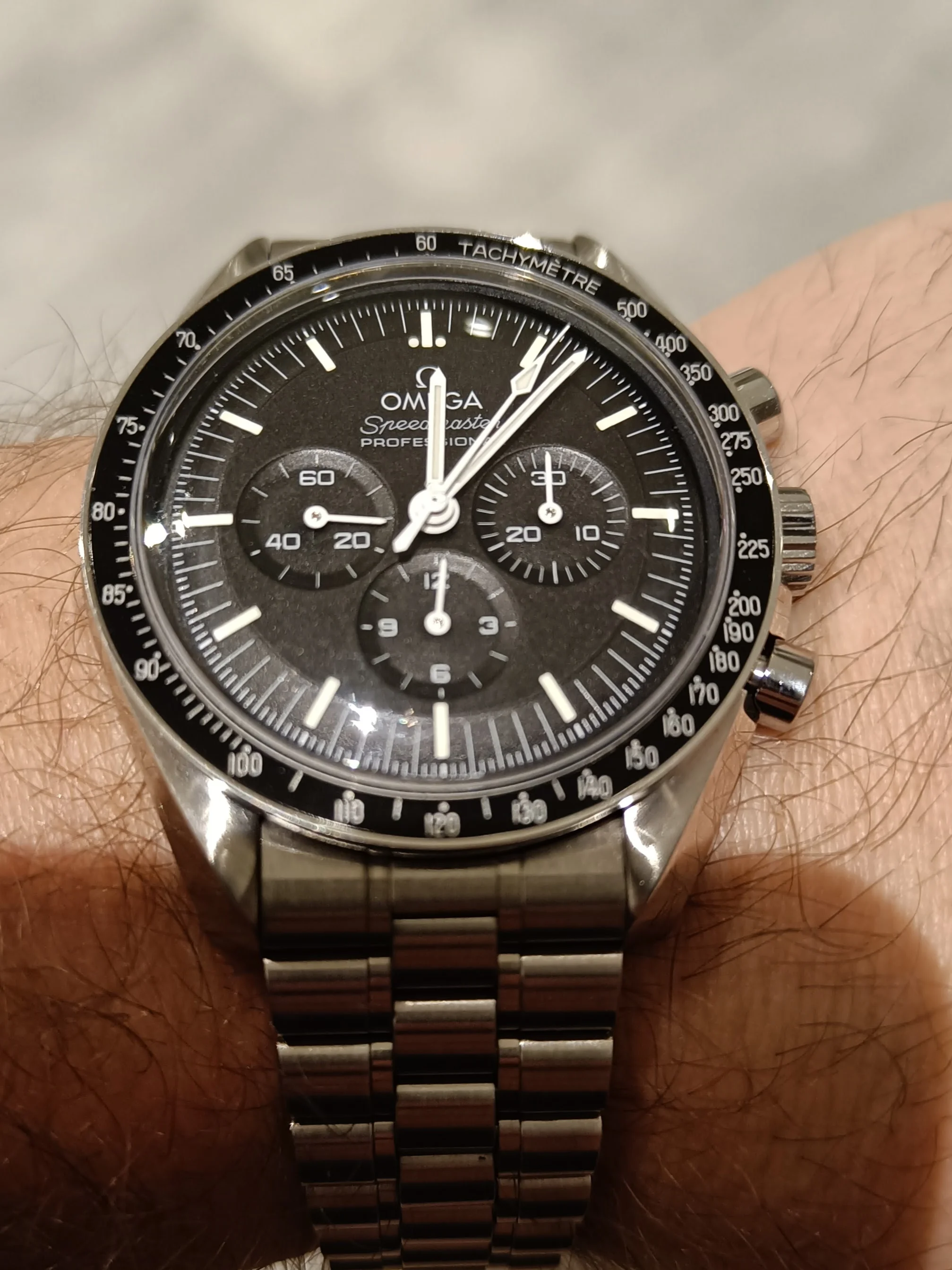

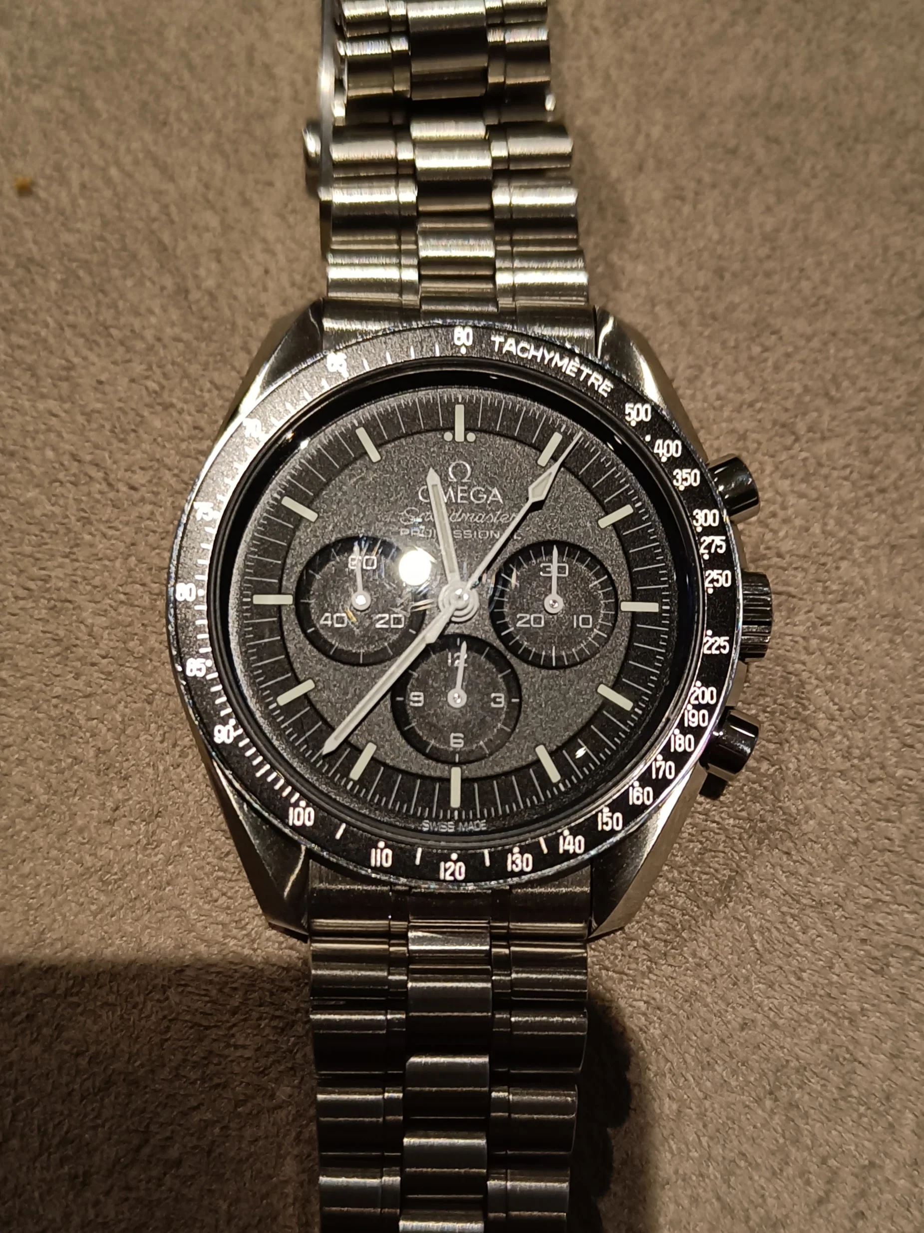

Yes. The chrono second hand and the chrono hours hand should be synced at 12.On the pictures above, the chrono is stopped 6 seconds after the 12 hour mark.
I attached a picture where I stopped it 3 hours later. The hour marker should have lined up at 3.
Note that the hands start synced at 0. So they are aligned on reset.

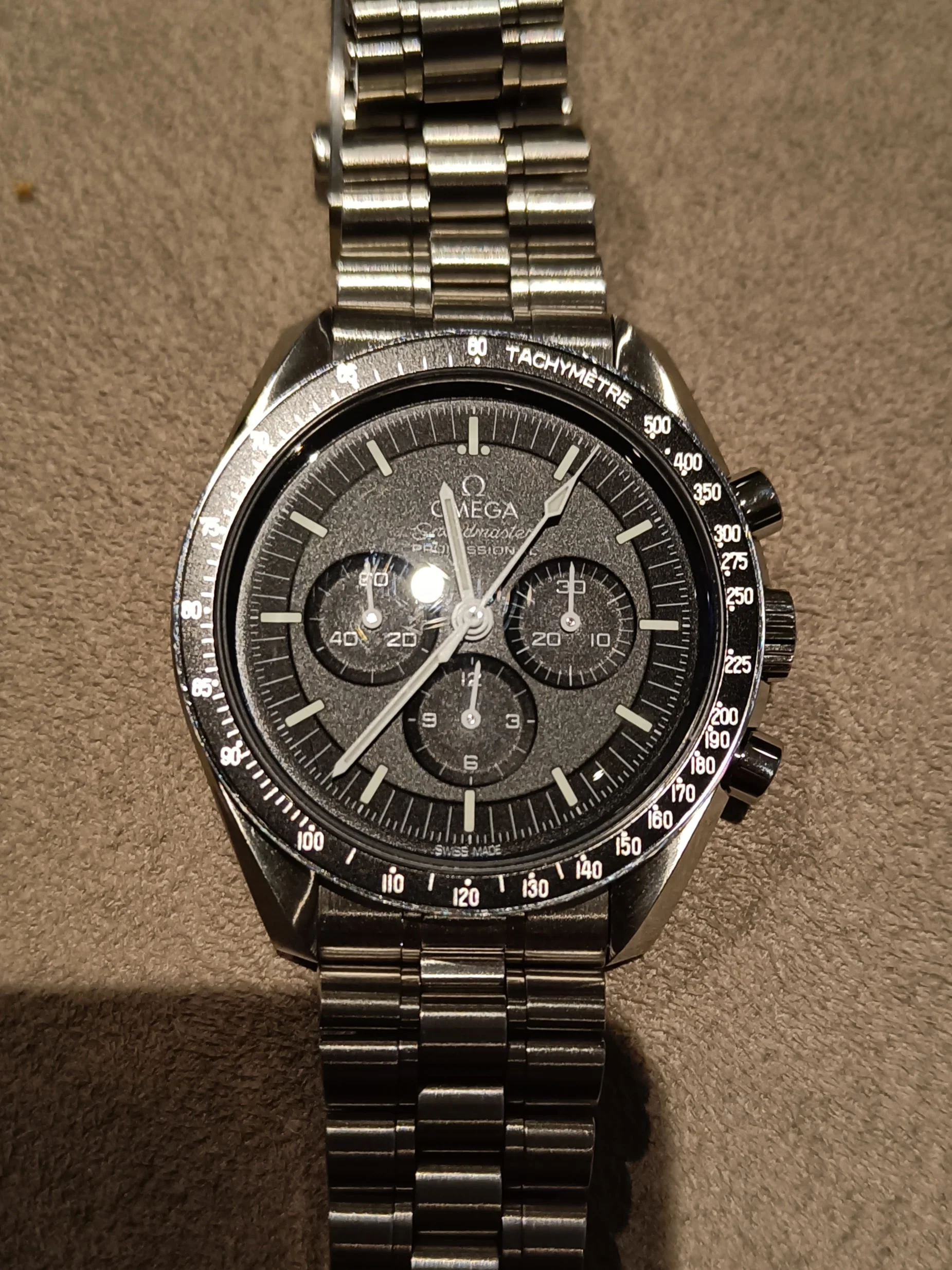

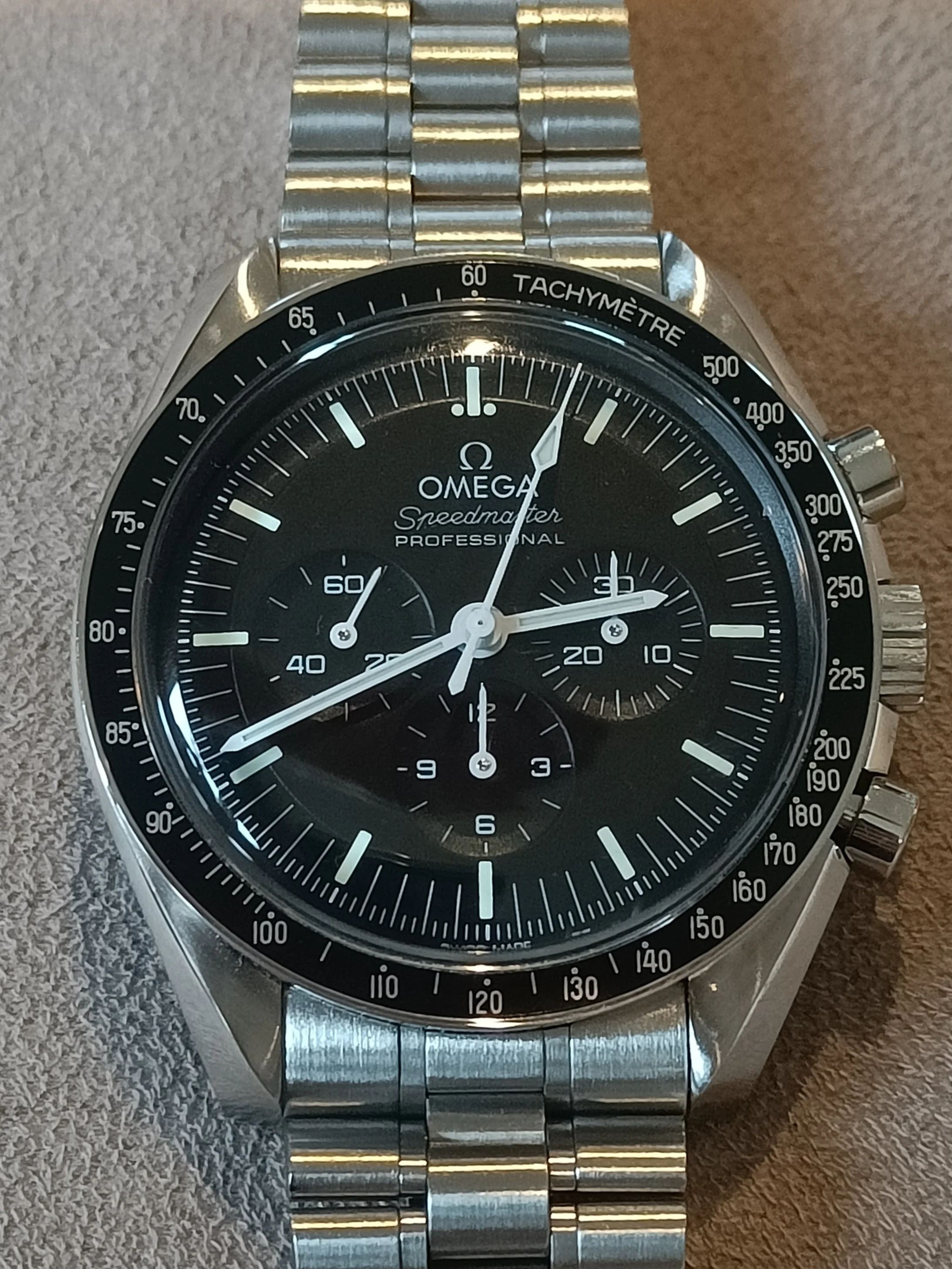

I was wearing it when this happens. On your suggestions, I tried to let it run dial up without being moved - and surprised to see that the hands then stays in sync. So the issue only occurs when the watch is being worn.
The attached image shows the hands after 12 hours.

That's what I thought would happen. So, there are two possibilities here...
1 - The hour counting hand is getting moved forwards by the movements of your arms or some small shocks, causing it to read fast.
2 - The minute counting hand is getting moved backwards by the movement of your arms or some small shocks, causing the hour counter to appear to be fast.
So a question - did you measure the 12 hours by the chronograph, or by the main hour and minute hands? If exactly 12 hours goes by on the main hands that just tell the time, and the hour counter is moving ahead as you wear it, the problem is #1. To me, this is less likely given the design of the hour counter mechanism.
What has already been observed on some 3861's is that the minute counter can be moved quite easily. It was a complaint that I saw a few times when this movement first went into wide circulation, but the complaints have died off in recent times. So my gut tells me that this is actually the minute counter hand getting moved, and the hour counting hand is actually working fine.
As far as what to do about it, Omega needs to fix this so I would take it back and describe the testing you have done, which will help them nail down the actual problem.
Both issues can be fixed - the hour counter moving too easily is from the friction spring on the mainspring barrel for the pinion that drives the hour counting wheel - it can be tightened to provide more friction so it doesn't slip.
For the minute counter the spring for the minute counter jumper needs to be adjusted to that is has a little more tension. There is balance here because too much tension can cause the watch to stop when the minute counter is tripped, but it should be a big deal to adjust this properly. The design of both of these things is the same as on the 1861 and 861 by the way, so this should be routine for any watchmaker who works on these calibers regularly.
Hope this helps.
Cheers, Al
