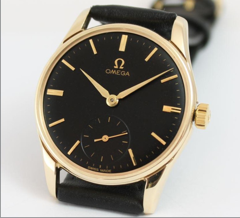

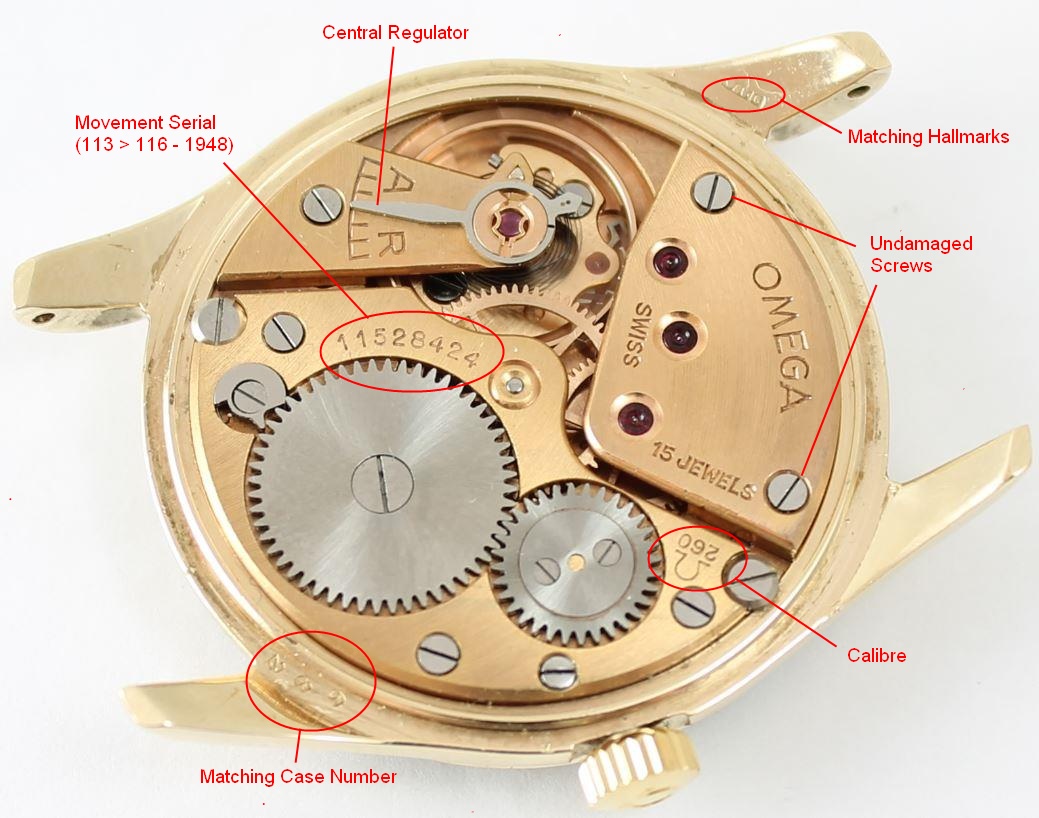

The black dial is a Dennison 13322, probably in 9K gold, made in Birmingham as you say based on the serial number 1948-49. There should be a year letter on the hallmark, likely it'll be X-Y. As you say, the dial has definitely been replaced at some point. That Omega font is later than the rest of the watch. This is not uncommon with black dial Omegas, most have been repainted it seems. It looks nice but isn't mega valuable, think £300-400 bearing in mind it hasn't been serviced and has replacement parts.

The black dial watch is perhaps a redial, I'd need to see better face-on photos to say for certain, but as a gold watch with 30mm movement, it has value.

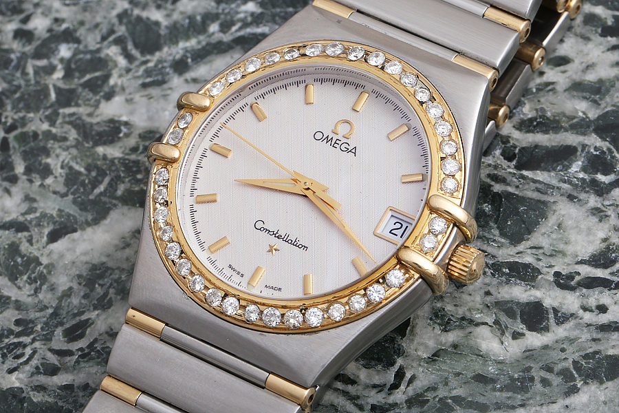

No idea what the quartz constellation would go for, but certainly not 6k.

A watch he referred to as a Sheik Special! Mid 90's quartz.
I have a document that stated the diamonds are 0.84 carat. The whole watch at a somewhat unrealistic $6550. Surely not the new price?

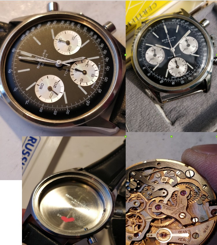

Plus a Breitling Chronograph (810)

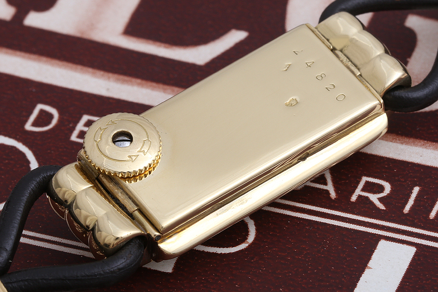

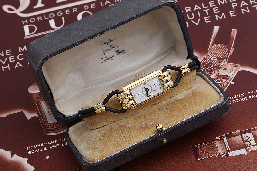

And a 1933 Ladies Jaeger LeCoultre. (Cocktail watch)

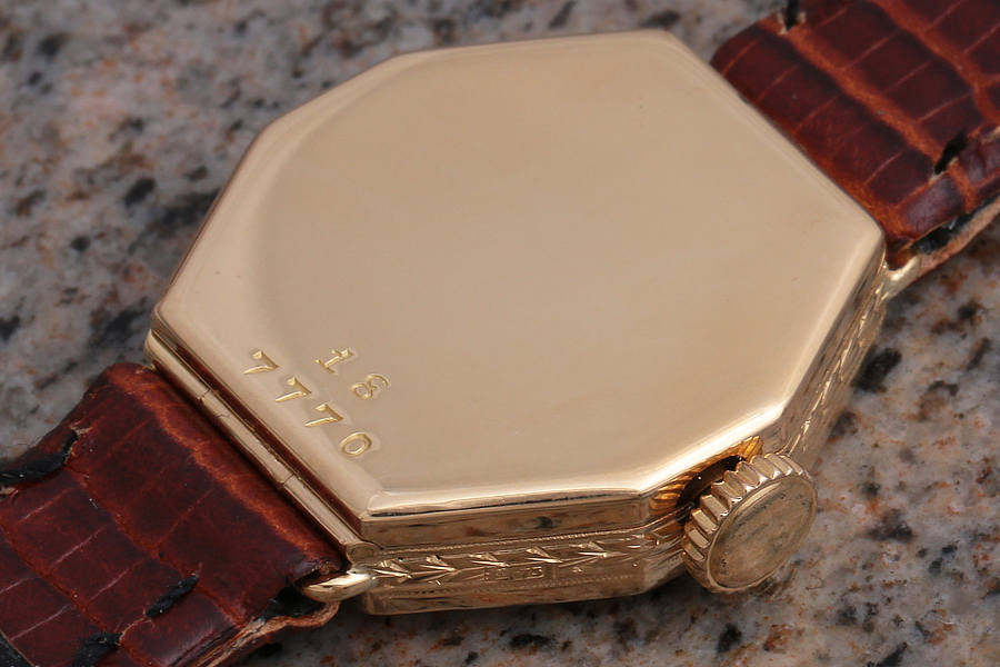

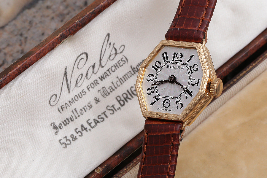

And a 1923 Ladies Rolex.(Cocktail watch)

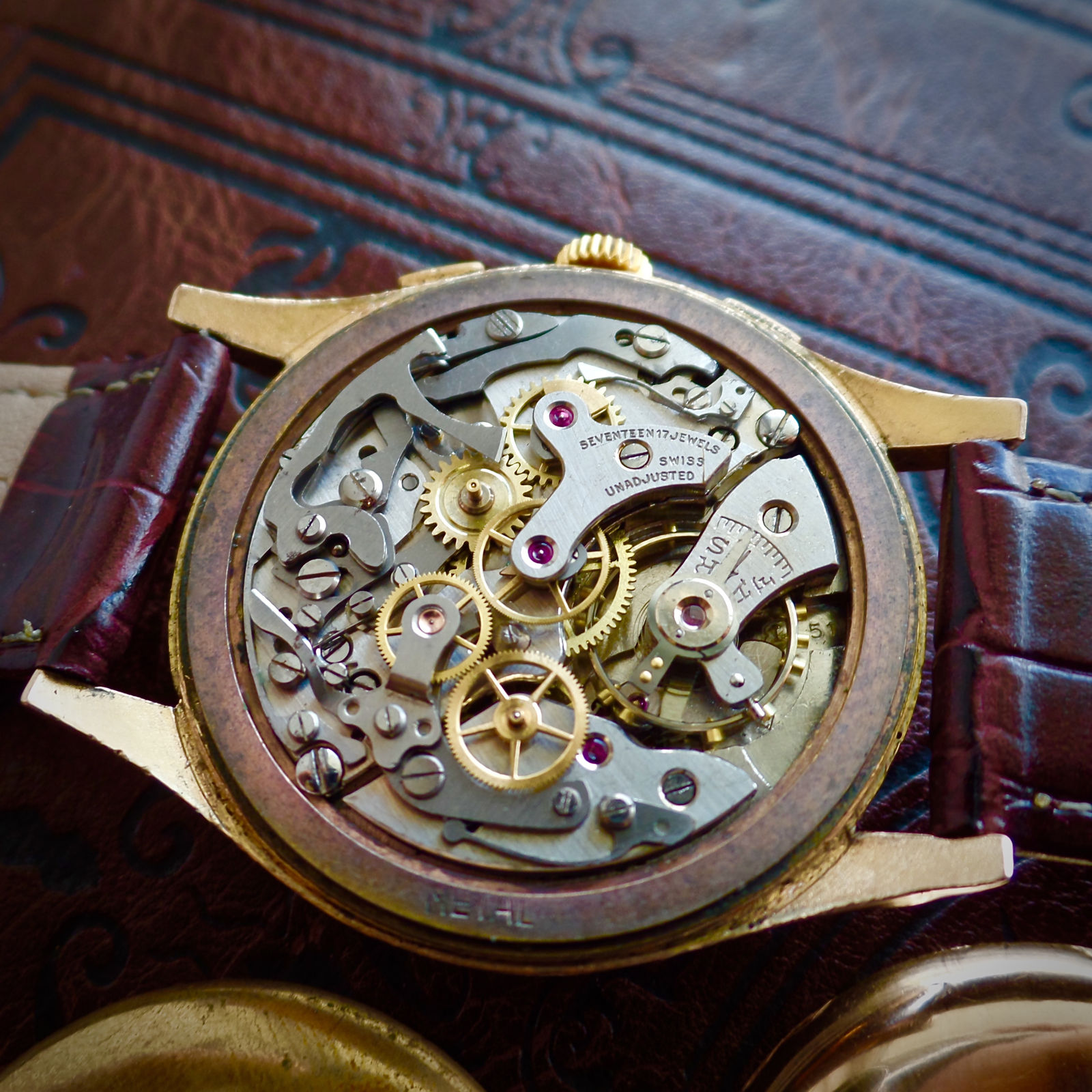

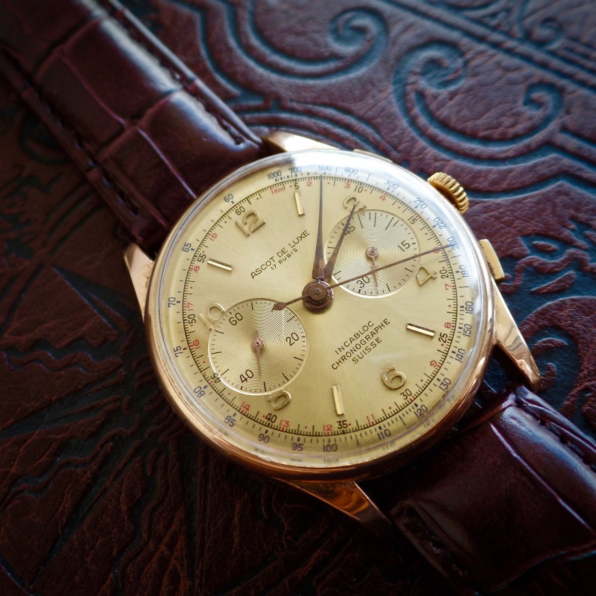

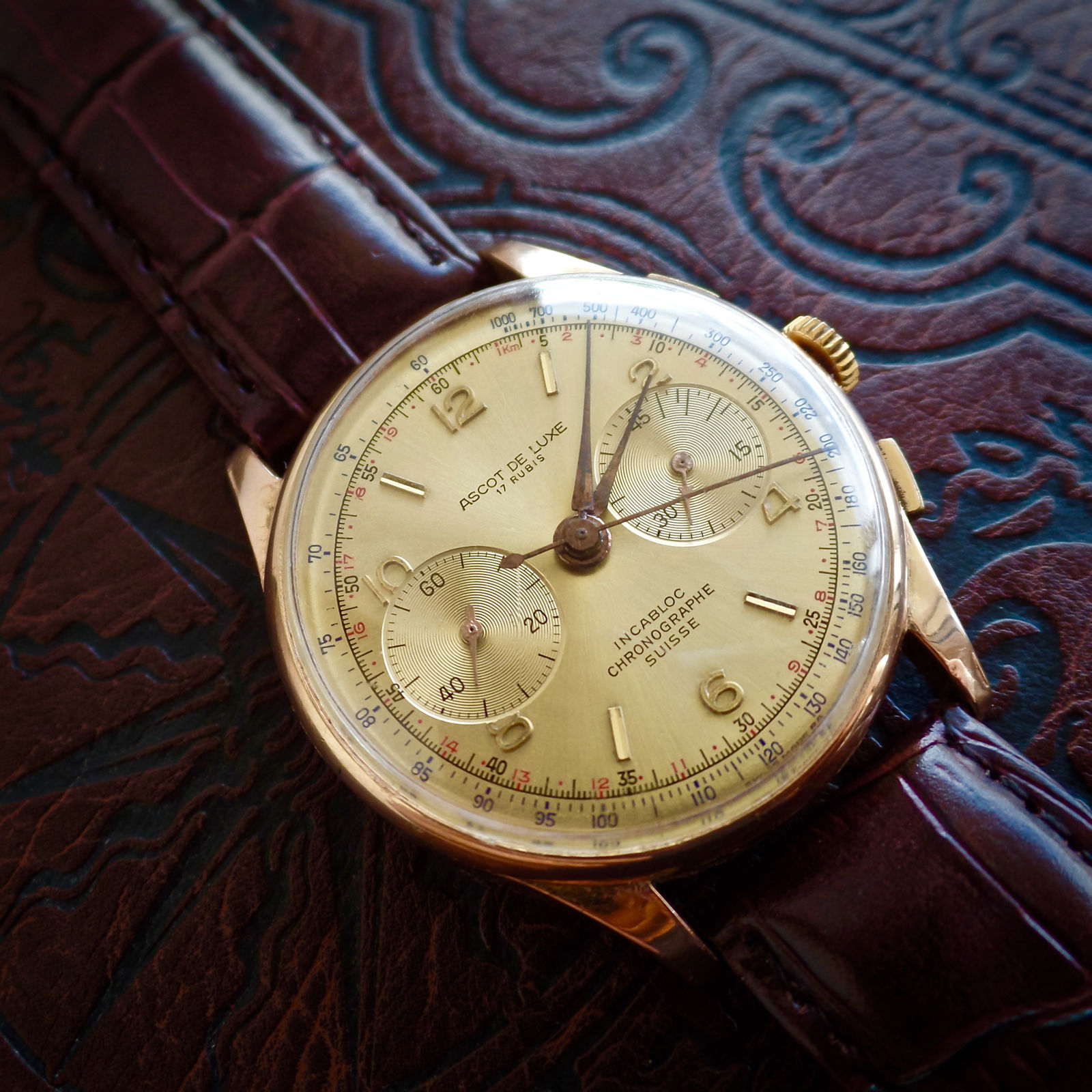

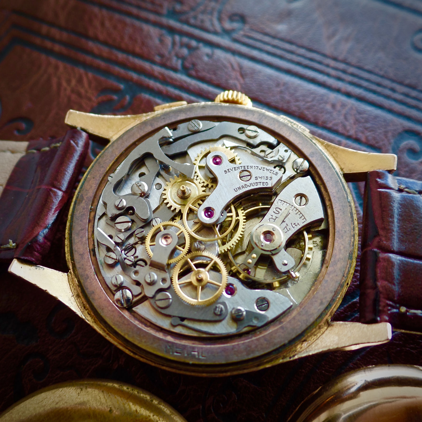

And a 50's 18ct Chronograph. It shows "Ascot De Luxe" and "Incabloc Chronographe Suisse" on the dial.
Quite a varied collection!

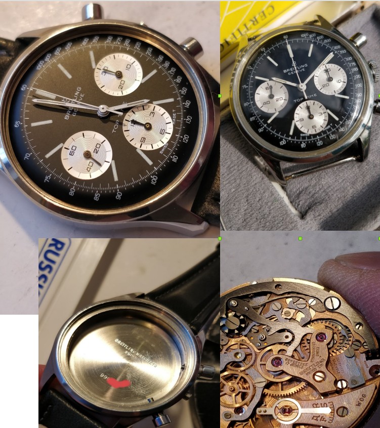

The Breitling Top Time could potentially be the most valuable of all depending on the variant, if it's stainless, original and in good condition.

Being an Omega site I thought it would be a bit rude to show others!
Reading from the info - a Breitling 810 1.1 1966 Made for approx 1 year. Monocoque case. Movement fitted from the front.
Included case and warranty. How do they get the front off?
Apparently quite rare - https://www.fratellowatches.com/tbt-breitling-top-time-810

Thanks for showing such a nice Top Time! There's nothing rude about showing other brands here, the reason we have this Other Watch Brands Forum

The Top Time is a Mk1 and with that dial variant in that condition is IMO worth £3500-4000.

The Breitling is the best one you've shown so far in terms of value and collectibility. They are quite desirable, at the moment at least, and based on what I can see in those photos, the condition looks original and very good.

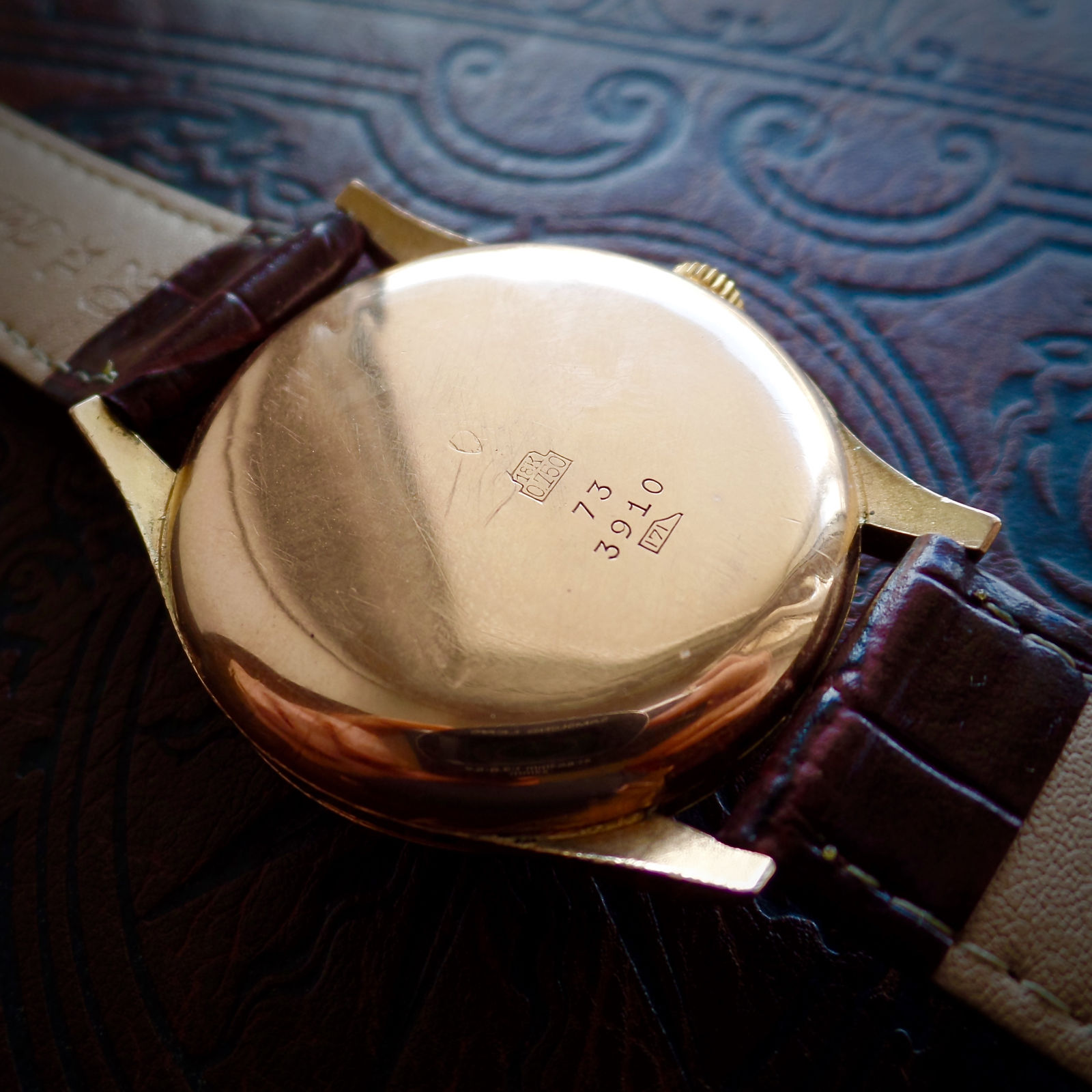

A 18ct Rose Gold Chronograph which is described once as 50's and later as 60's.

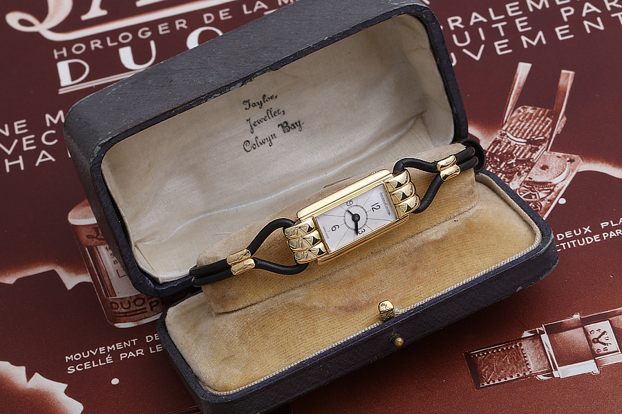

A 18ct Jaeger LeCoultre DuoPlan Ladies Watch circa 1933. Allegedly another, more famous, E.R. wore one at her Coronation!

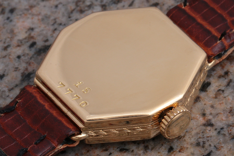

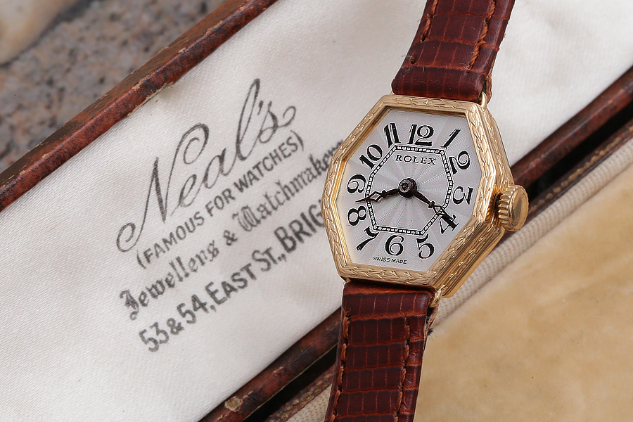

Rolex 18ct Ladies Watch circa 1923 !! Seems hardly worn.

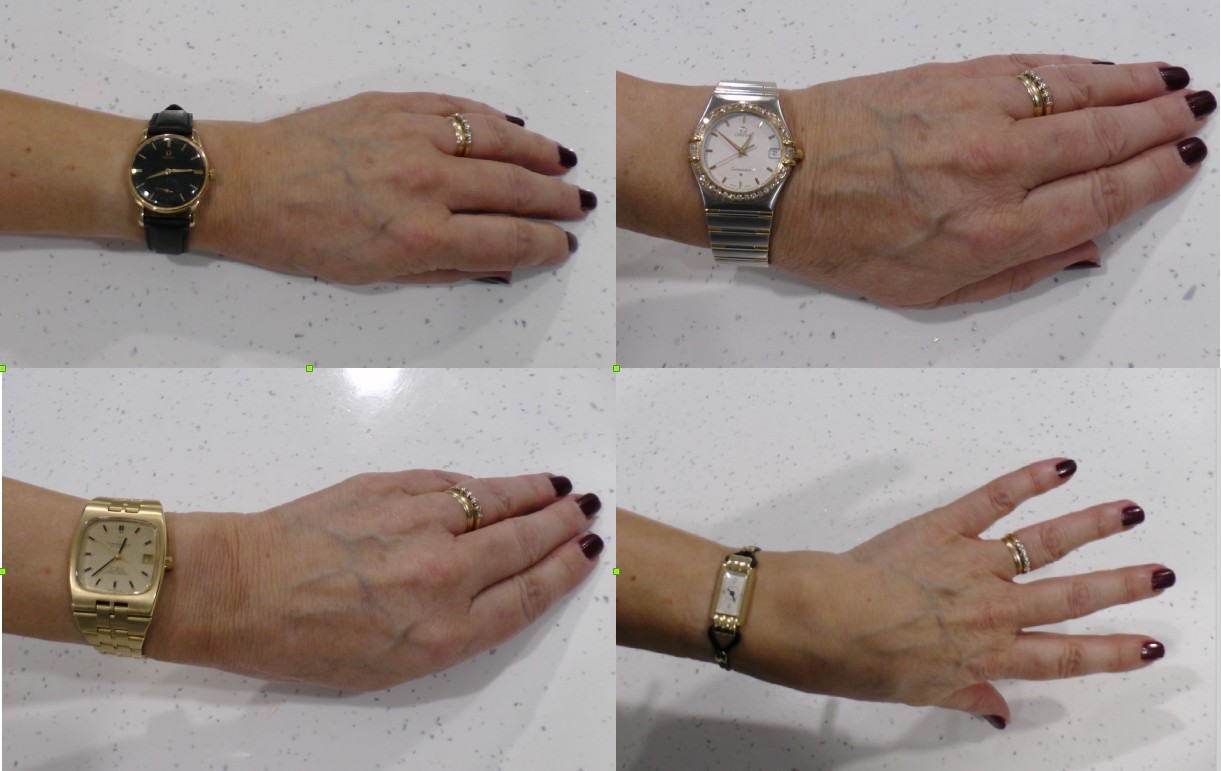

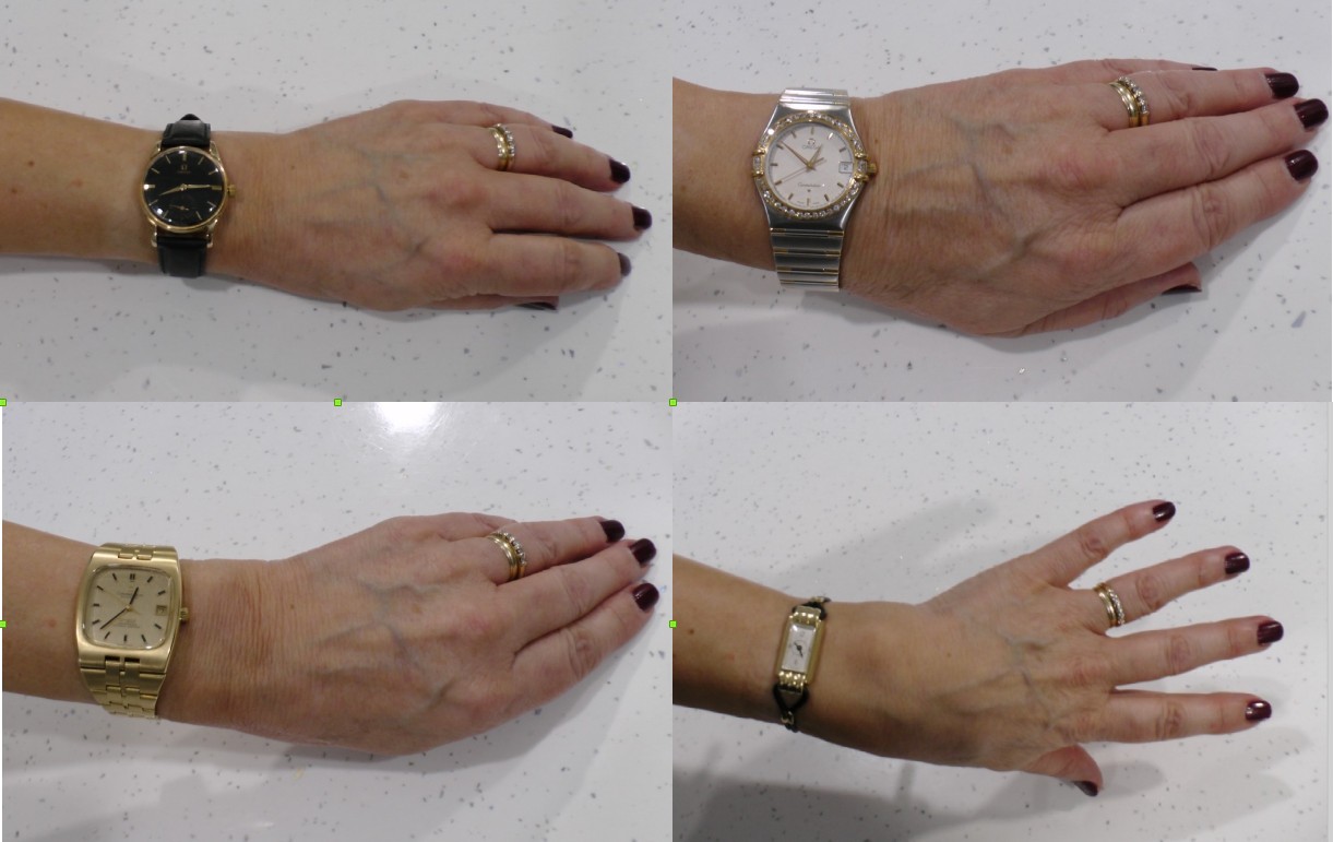

Such is modern fashion that the watches do not look that out of place on me! Except the metal straps will probably not shorten sufficiently.

Rolex 18ct Cocktail watch -- £1600 !! An auction house had valued it at £800 > £900.
Omega Diamond Quartz - £1550.

Sadly I "broke", and had to withdraw, the LeCoultre.
