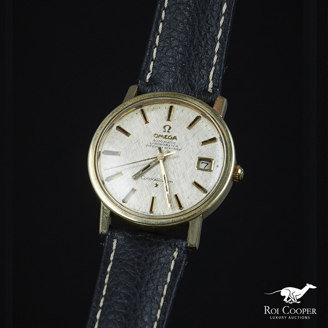

I am new in world of Omega! I don’t have experience whit this watches!
Yesterday I buy this Constellation What you think?
Hope everything is fine and don’t have replica
8,880
62,876
Nice linen dial and not a replica.
Larger, face-on, hi-res pix can help us help you

Yesterday my watch is delivered, but I think crystal and crown is replaced...
Crystal don’t have Omega signs and crown look different for model
So what you think This parts is changed on the past or is genuine?

If the glass doesn’t have the omega logo on the center, it means it isn’t an original part and isn’t genuine for the reference. The same applies to the crown.
9,588
27,706
The crown in the photos looks incorrect for the model, but it could well be impossible to find one matching the one originally on the watch, as more generic replacements have been introduced.

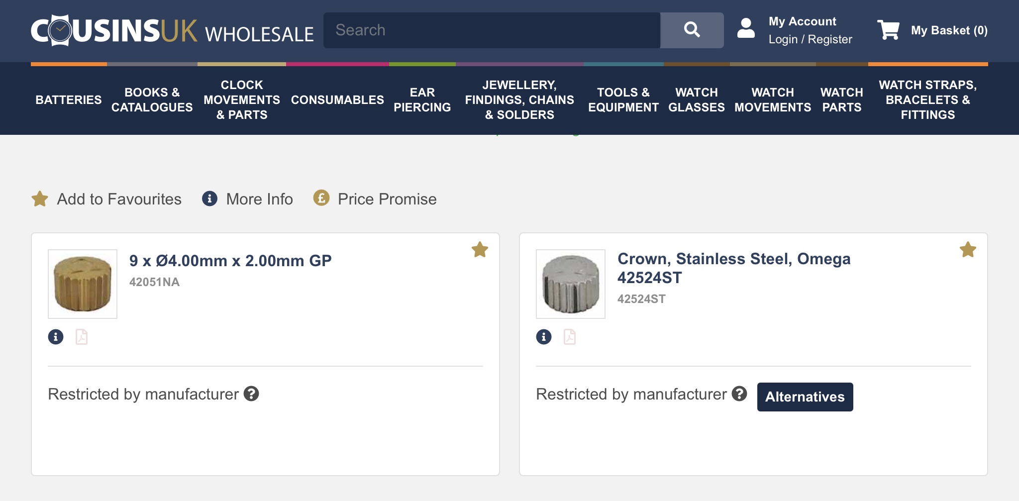

the Omega logo on the crystal can be very very feint but if it’s definitely not there it’s not an original Omega part.
I believe the crown should look like this, as listed by Cousins - but as you can see, it is a part that you would need to get via so someone with an Omega parts account.
