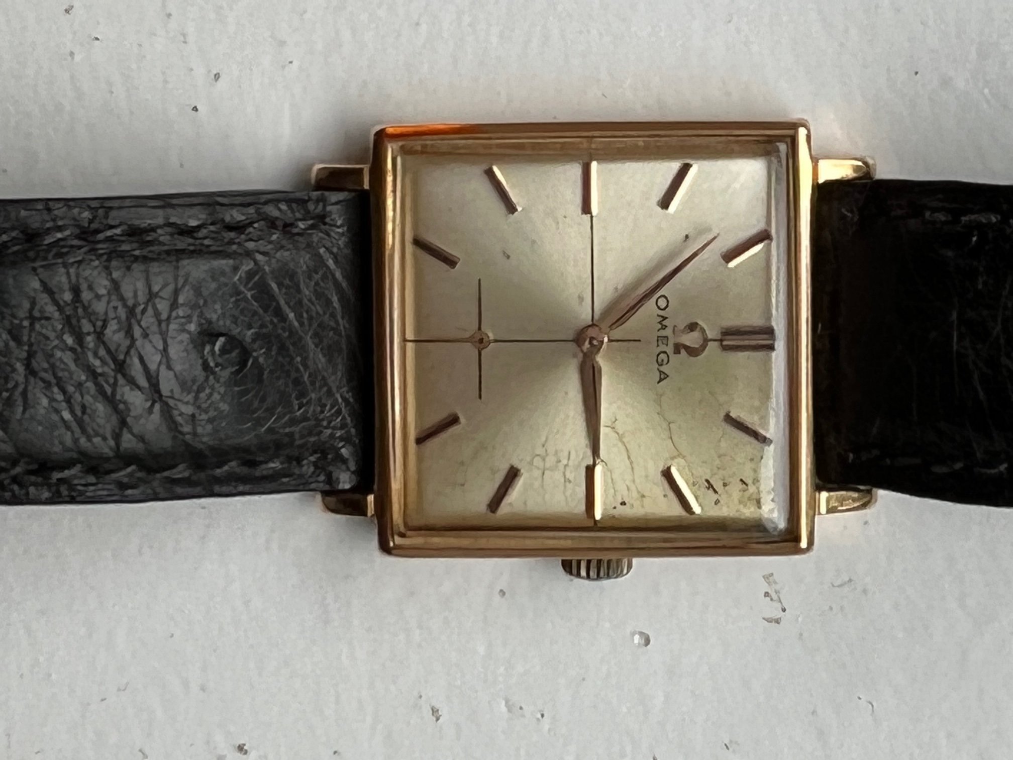

Hi All,
i was wondering if anybody has any suggestion about this vintage omega. i inherited it from an uncle long time ago and i am just now starting to understanding vintage watches (and omegas). I think it is gold (14k?) and in untouched conditions (it came to me directly from the uncle). I don't feel comfortable opening the back to find relevant information, and i hope that one of the knowledgeable collectors can point me in the right direction. My intention is to sell it to raise funds for a speedmaster (date or reduced).
Thank you very much
16,012
48,216
We really need to see the inside of the case back and the mechanism to give you any information. Not to rain on your parade, but if the watch is solid karat gold, you might find purchase offers of about scrap gold value, plus perhaps a bit for the movement, IF the movement appears to be in decent condition. The dial appears to have been WET, and there are chances there may be rust in the mechanism. Consider keeping it for the sentimental value. It is not a highly sought after model by collectors.
3,604
13,579

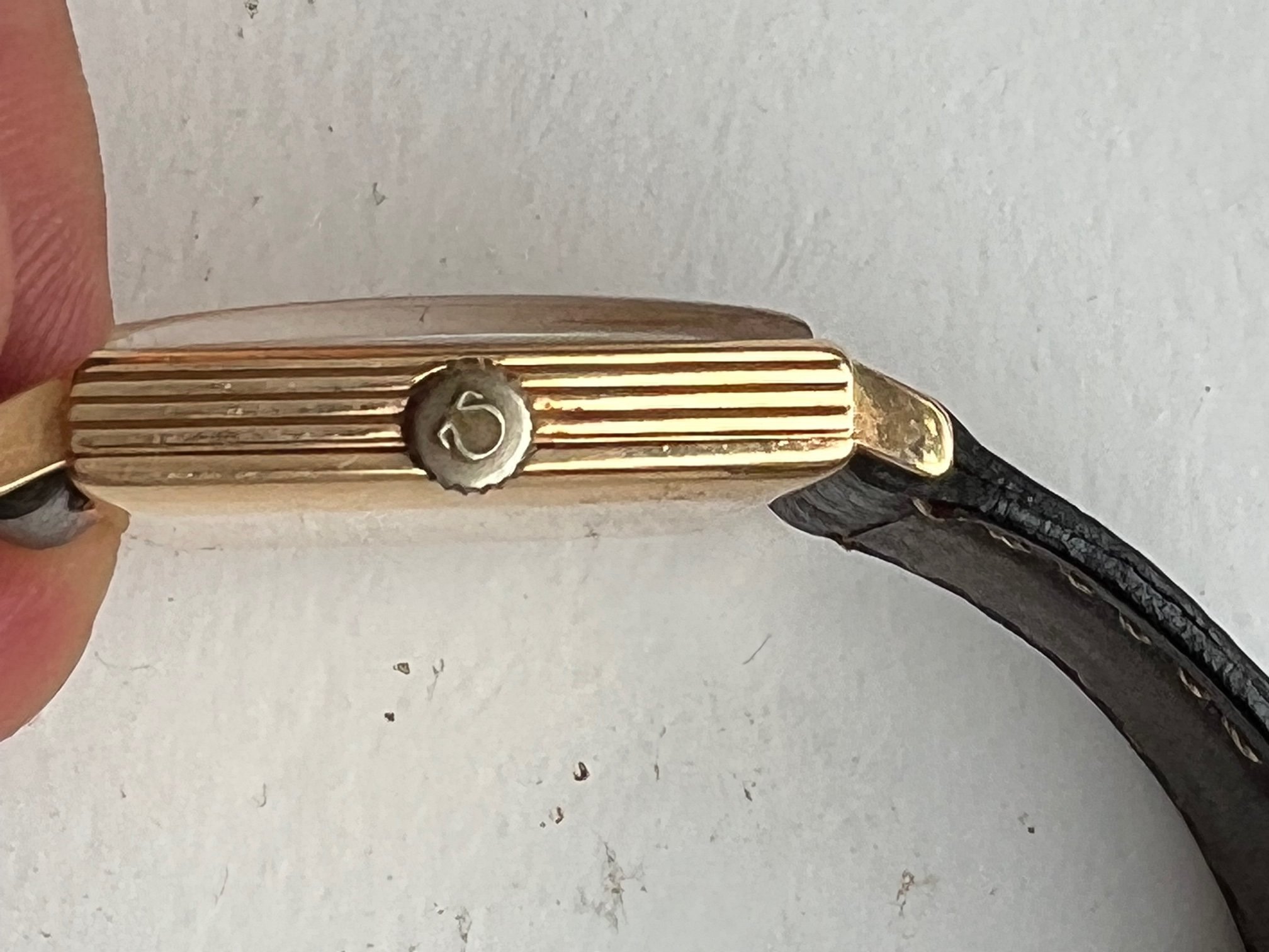

Are there hallmarks (indicating it’s solid gold) somewhere, on the back of the lugs or the sides?
13,571
23,558
If it’s gold it’s worth the scrap value of the gold.
If it’s plated maybe £/€/$200
13,690
19,067
1. My guess is that this is a US cased model. Which means either 14K solid gold or gold-filled. Hallmarks will be inside the case and/or between the lugs.
2. I also think this is a non-original dial. There is no “Swiss” or “Swiss Made” at the bottom.
I otherwise agree with @Davidt assessment.
gatorcpa
2,351
1,479
Probably a caliber 625 and worth more than scrap gold as it's a restorable watch.
I bought one back in 2002 for $150.00 Can. off my watchmaker in 14kt white gold and flipped it for $350US the following week.
Dial condition is average and case is on the small side compared to todays watches, but it's supposed to be discreet.
You can sell as is or have the dial refinished to improve it's looks.
Do a search on 14kt square Omega watch and see the condition of others and asking prices. Normal to absurd. Ignore the latter crazy prices or they'll bury you with it as you won't sell it.

Thank you so much. Much appreciated and helpful.
