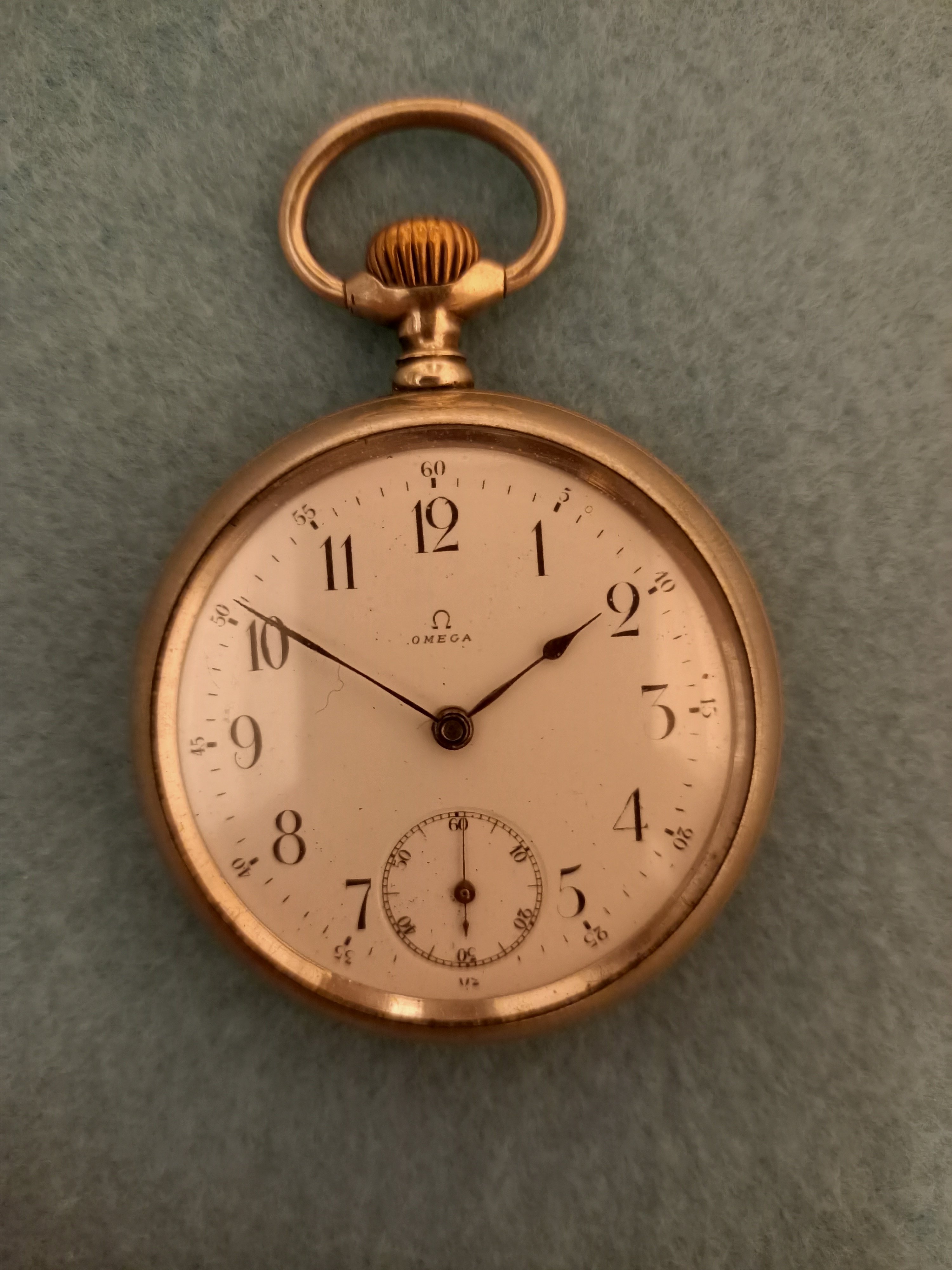

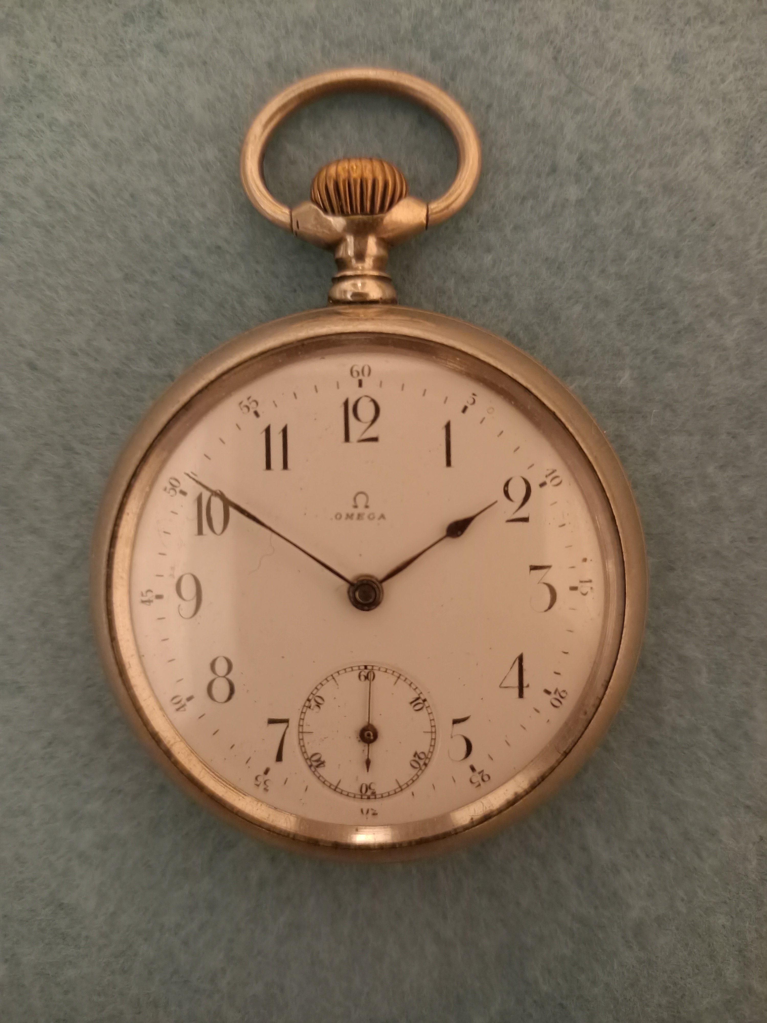

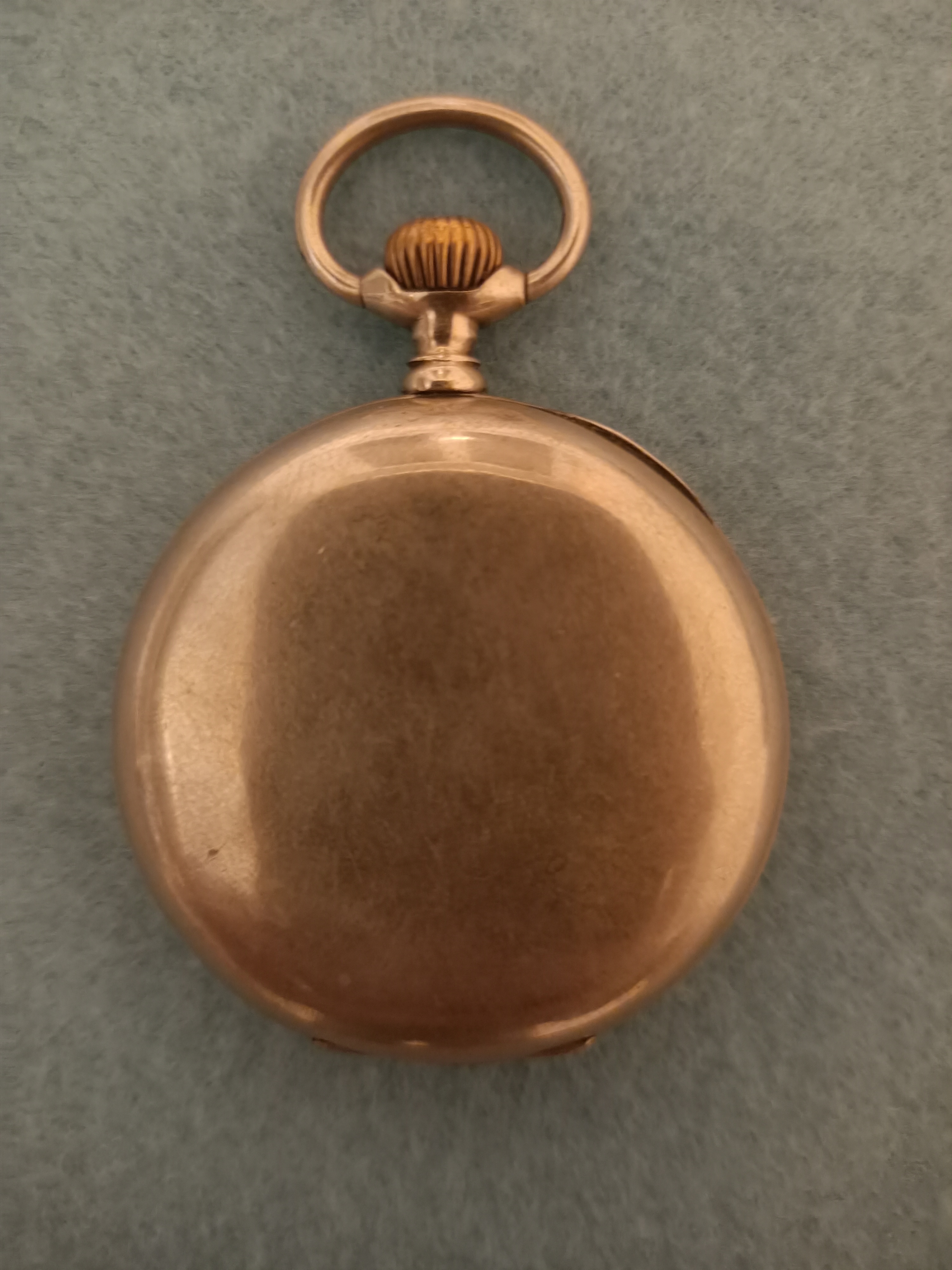

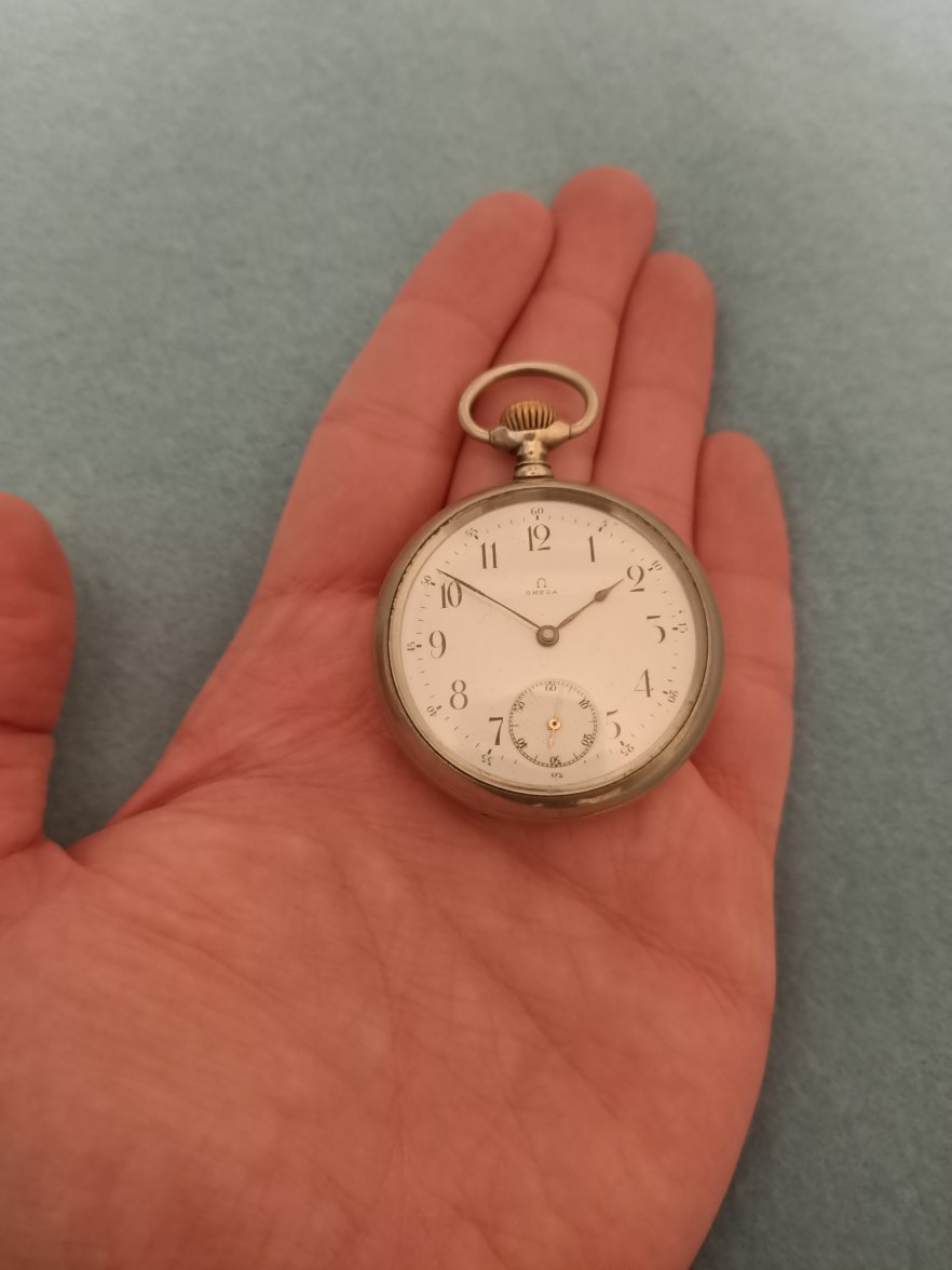

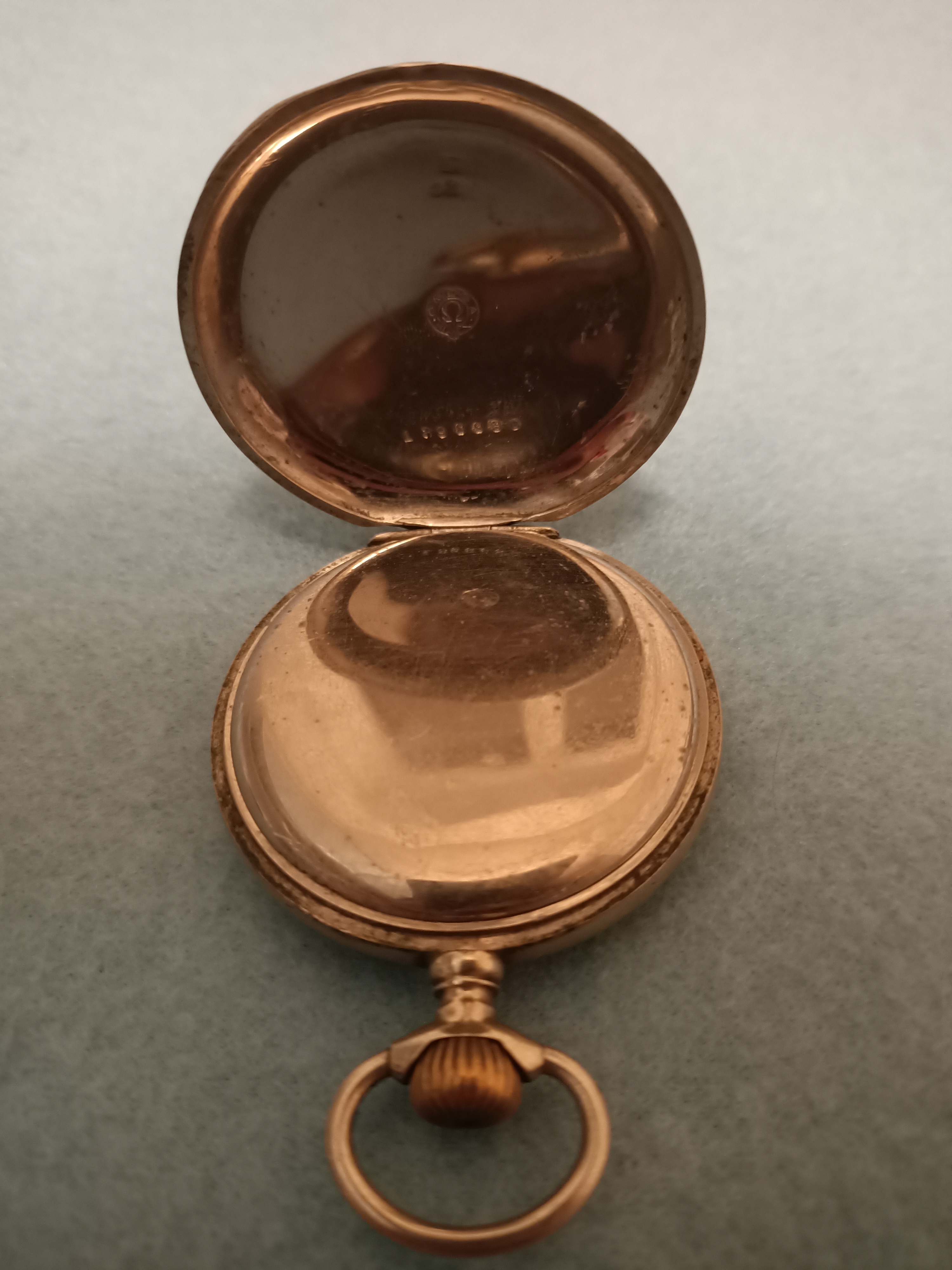

Dear collegues,

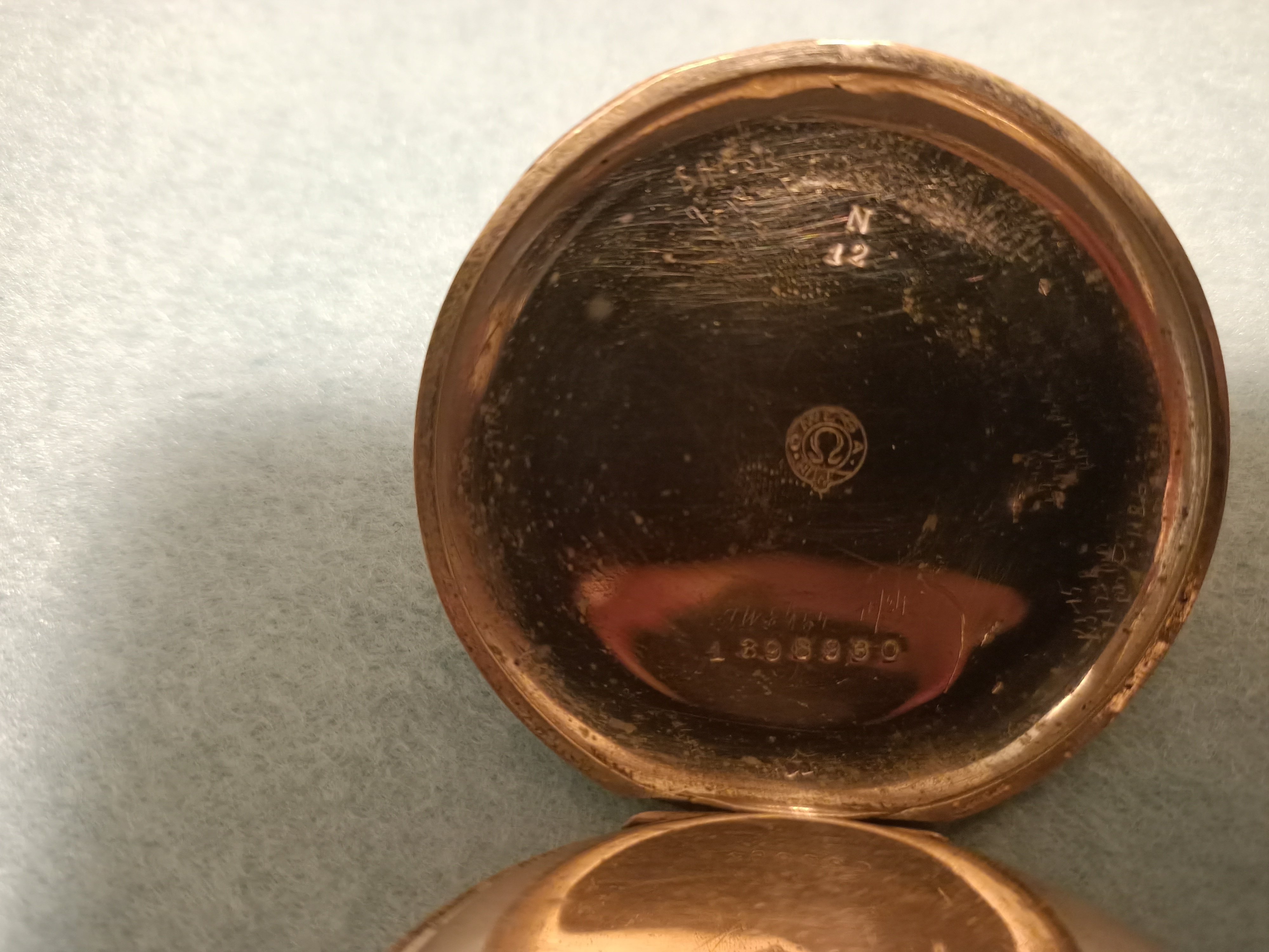

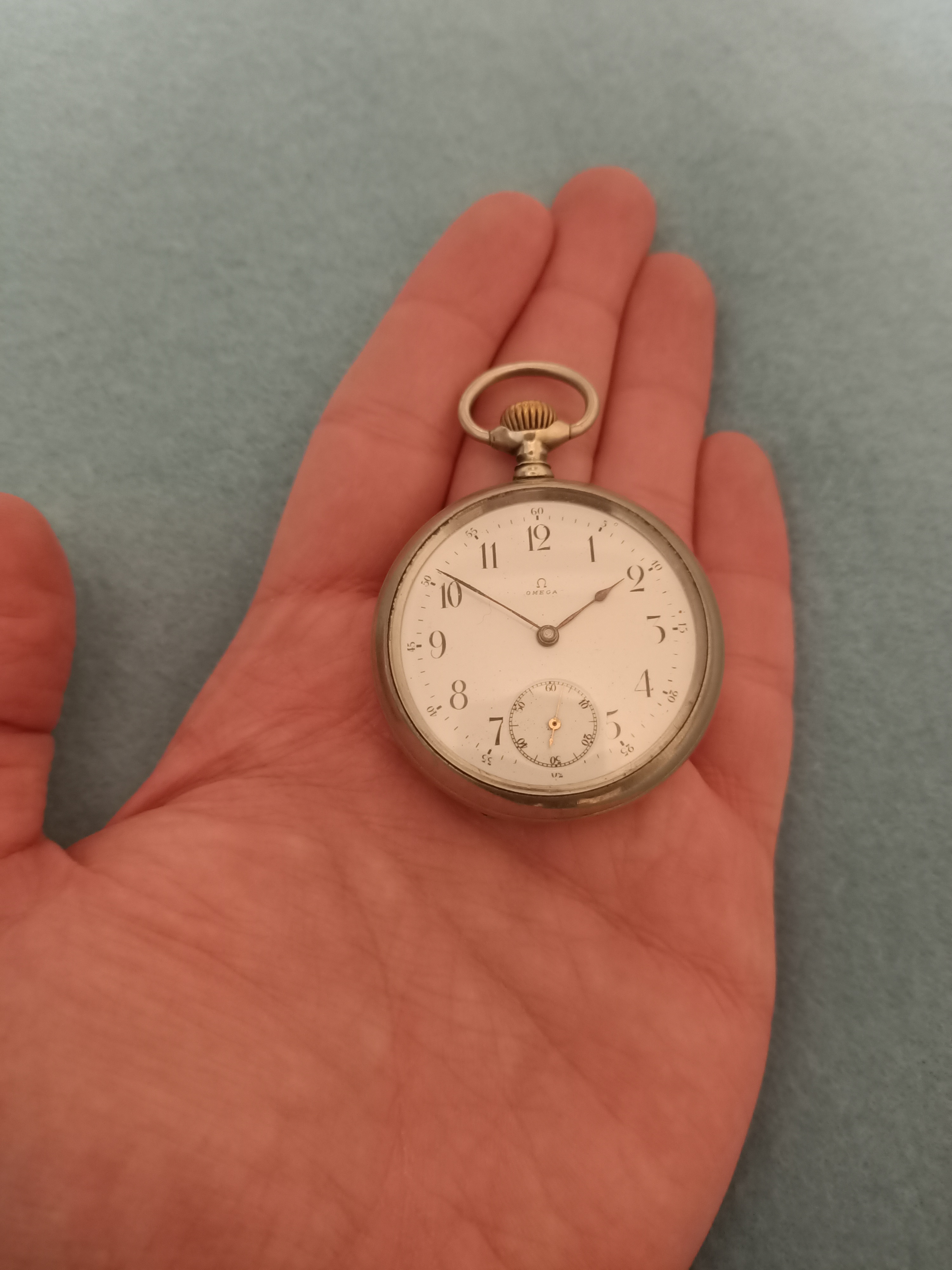

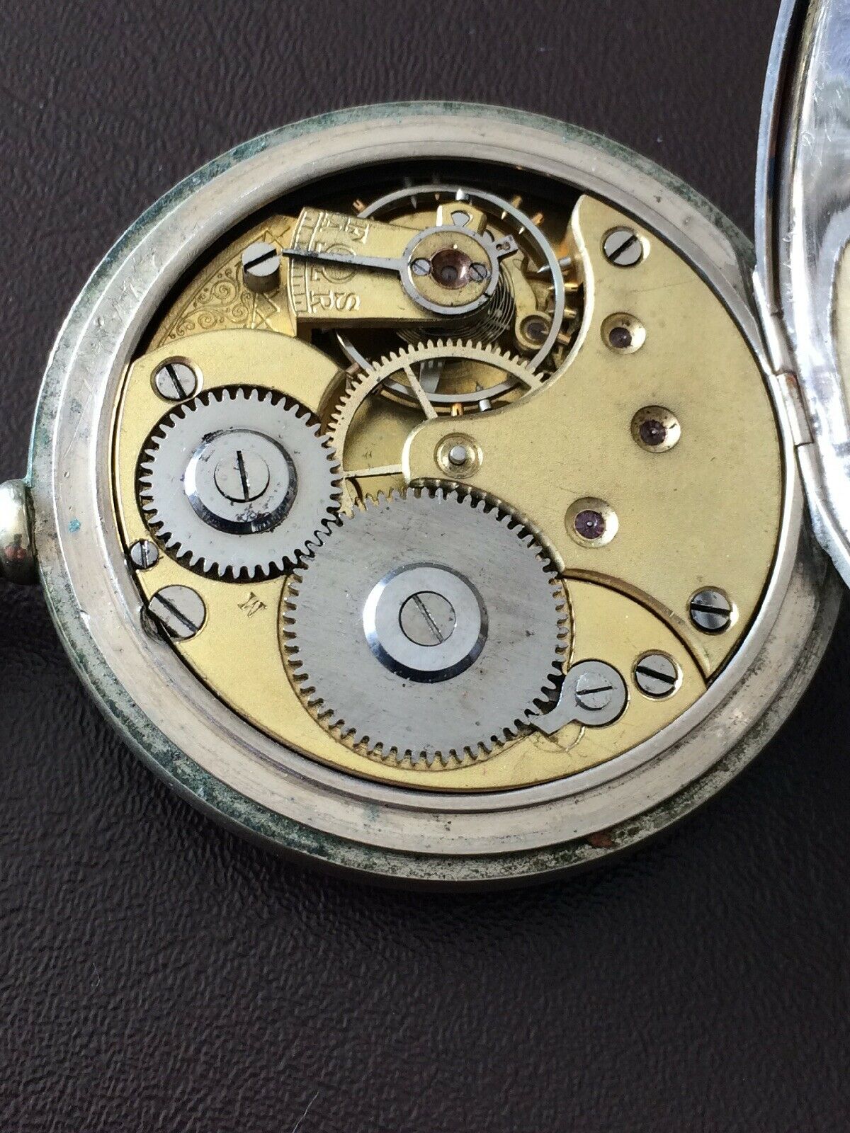

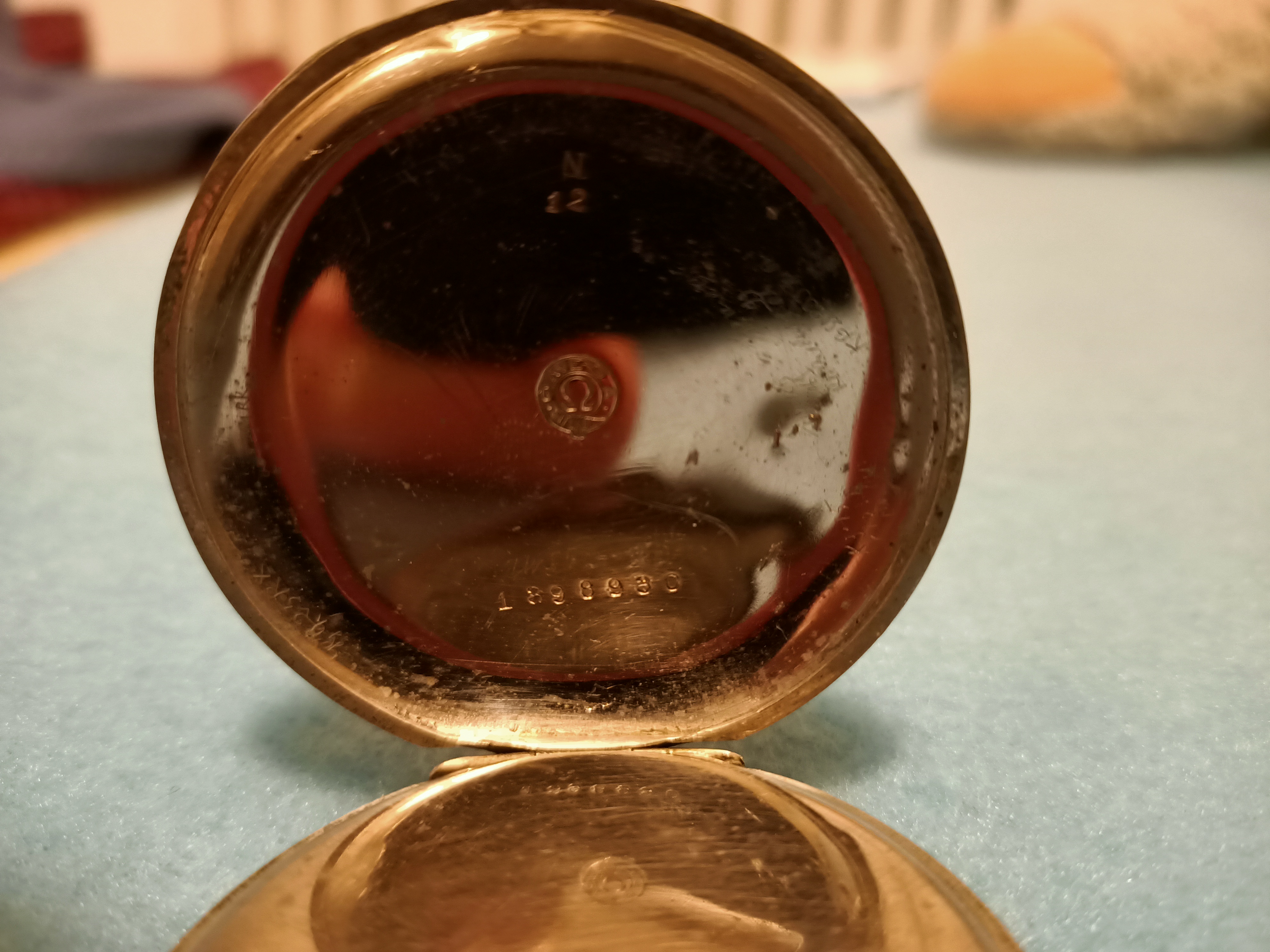

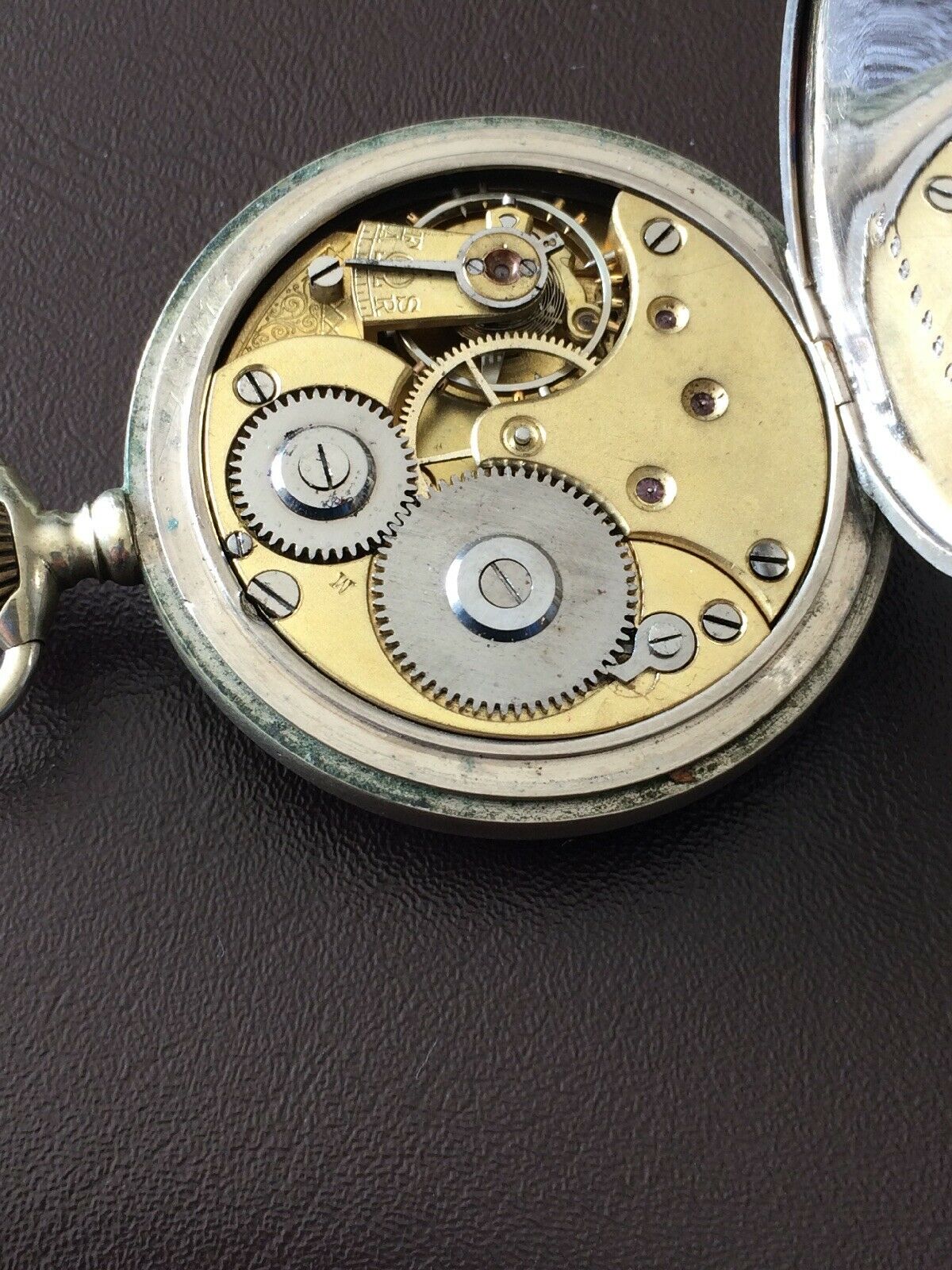

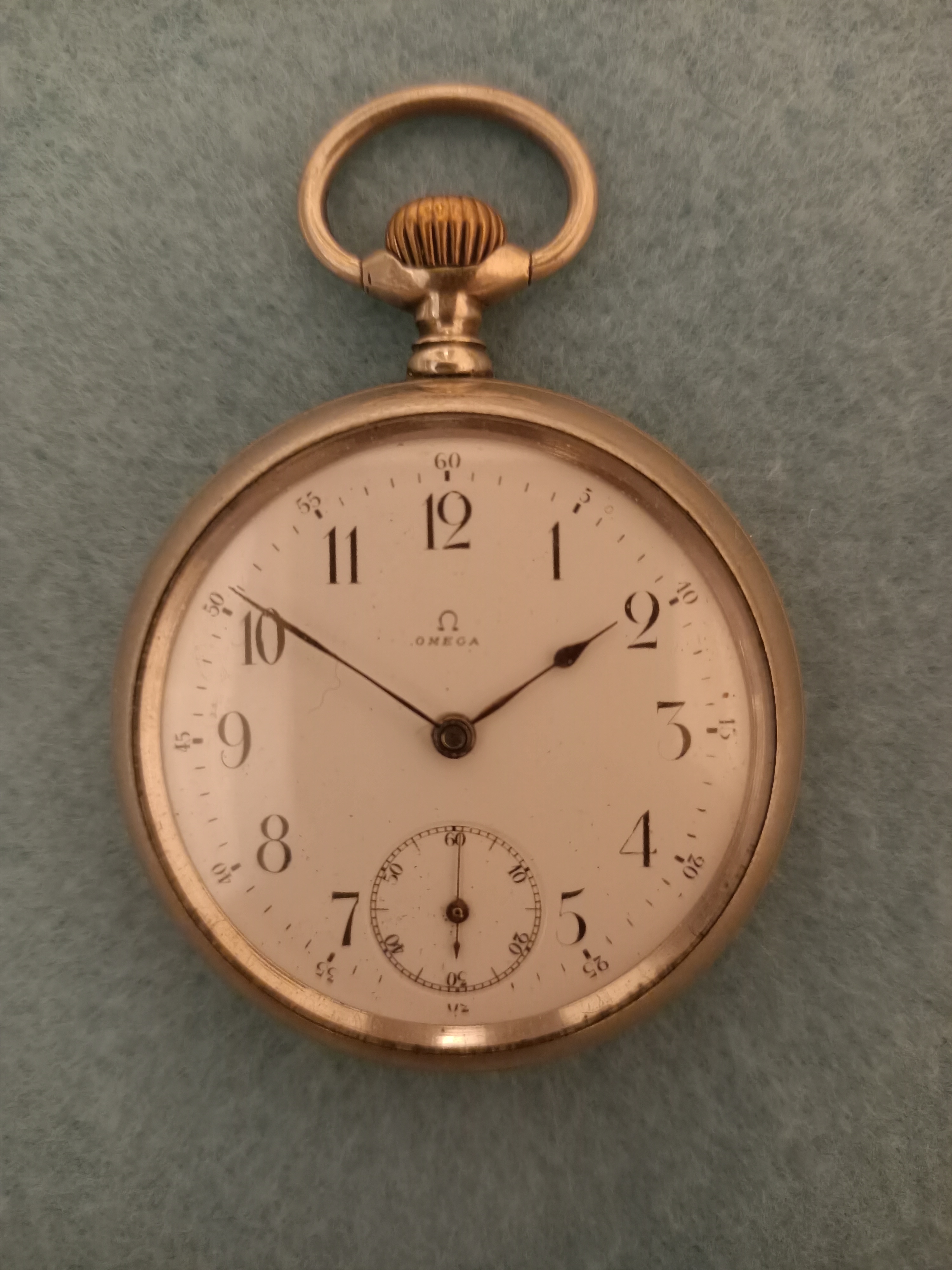

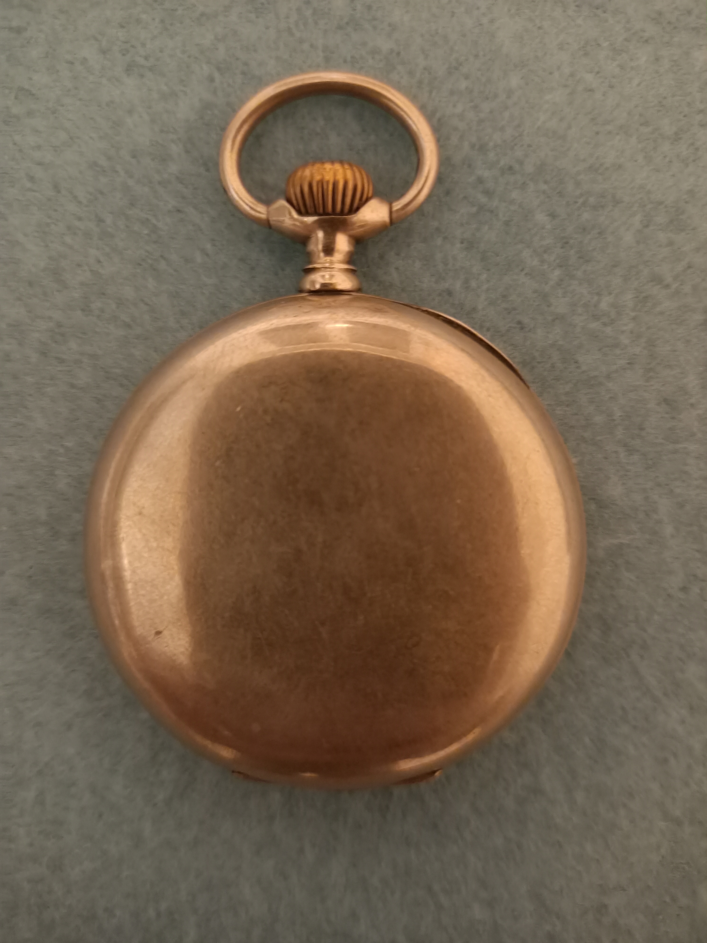

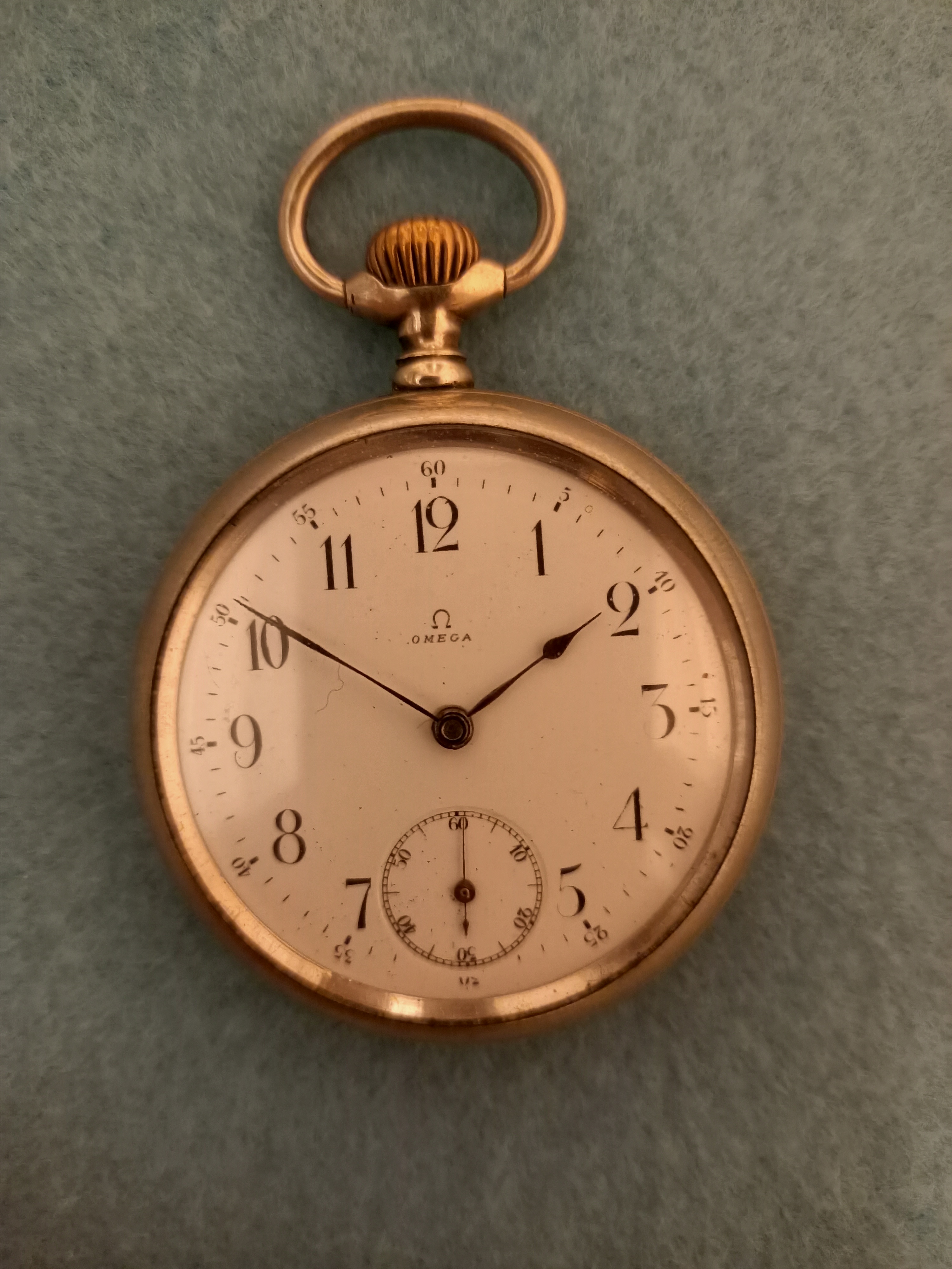

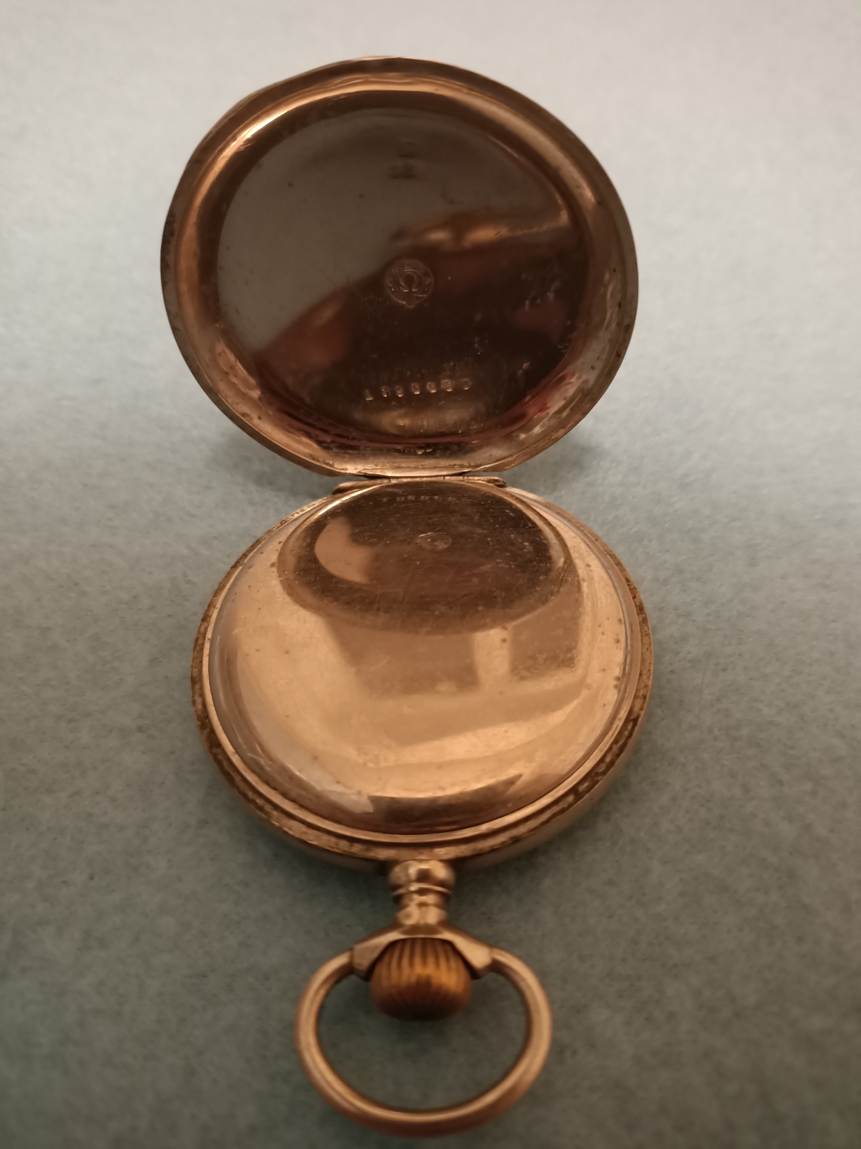

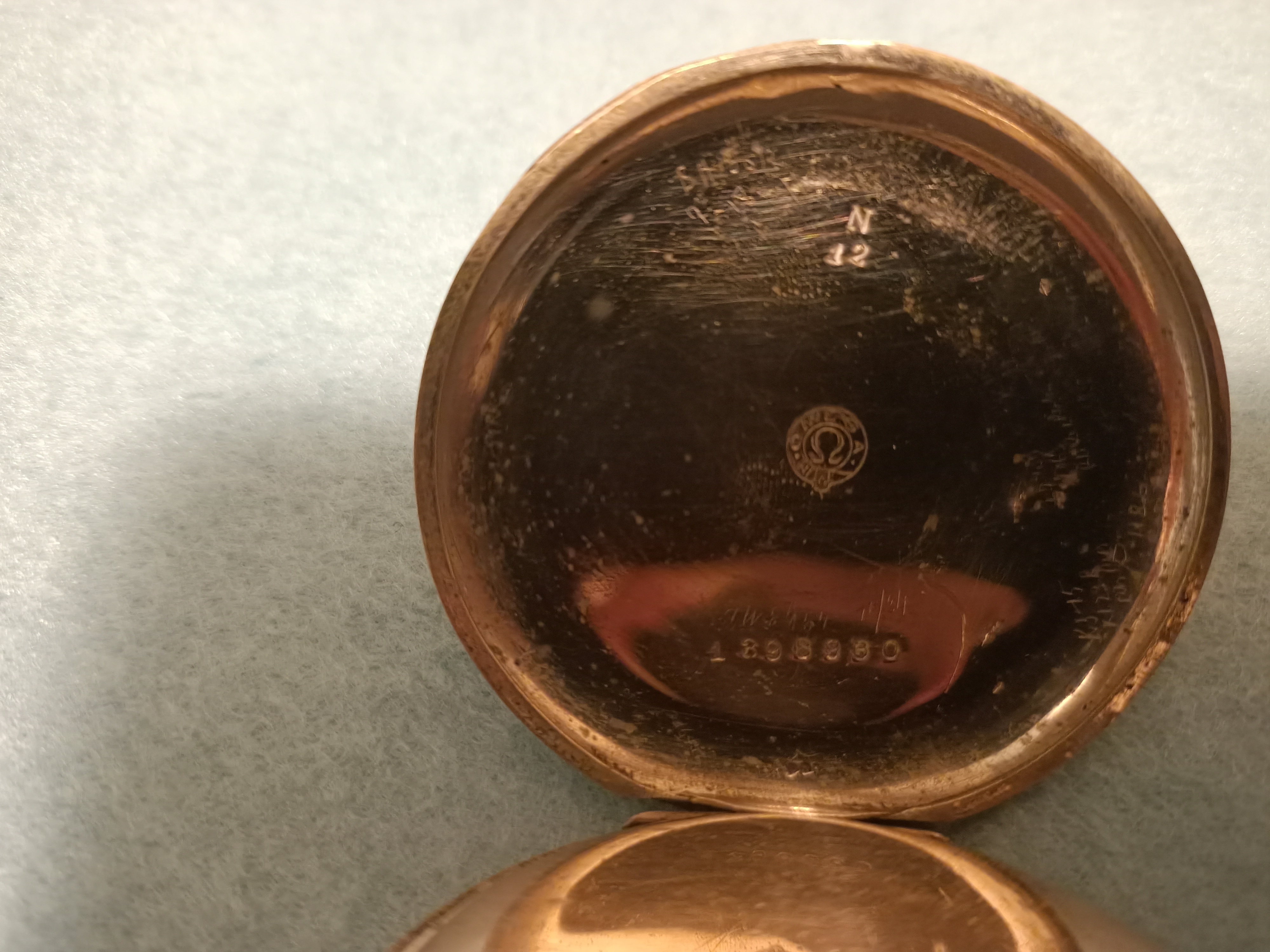

I am new in this forum and i want to thanks alle to accept me on this incredible forum. Now let me show you the decision to write in this website: i found my granpa's pocket watch. It is an Omega but i don't know anything about It. Could you help me to discover all the characteristics of this watch? Year? Cohevity of the spare parts? Type of movement? Value of this watch.
Thank you to all who can help me
Know some photos:
3,653
7,770
An early watch, I guess around 1900, case is nickel, not silver - so the financial value is very low - the sentimental value as a heritage and memento of your grandpa is what counts here.

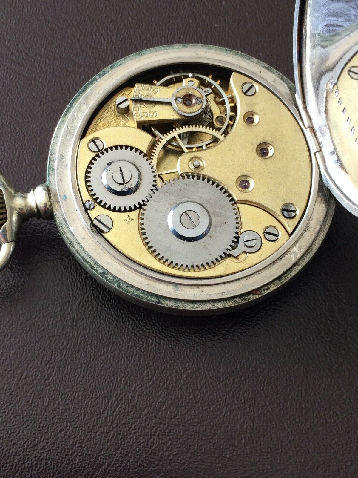

The little "M" on the movement stands for metal, and indicates that the watch was originally sold in France. At the time, movements of watches that went to France were often marked to denote the case material: "O" stands for or, "A" stands for argent, and "M" for metal.
