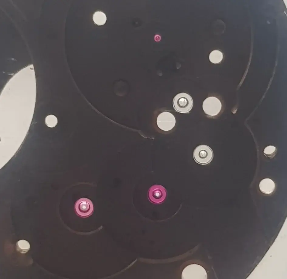

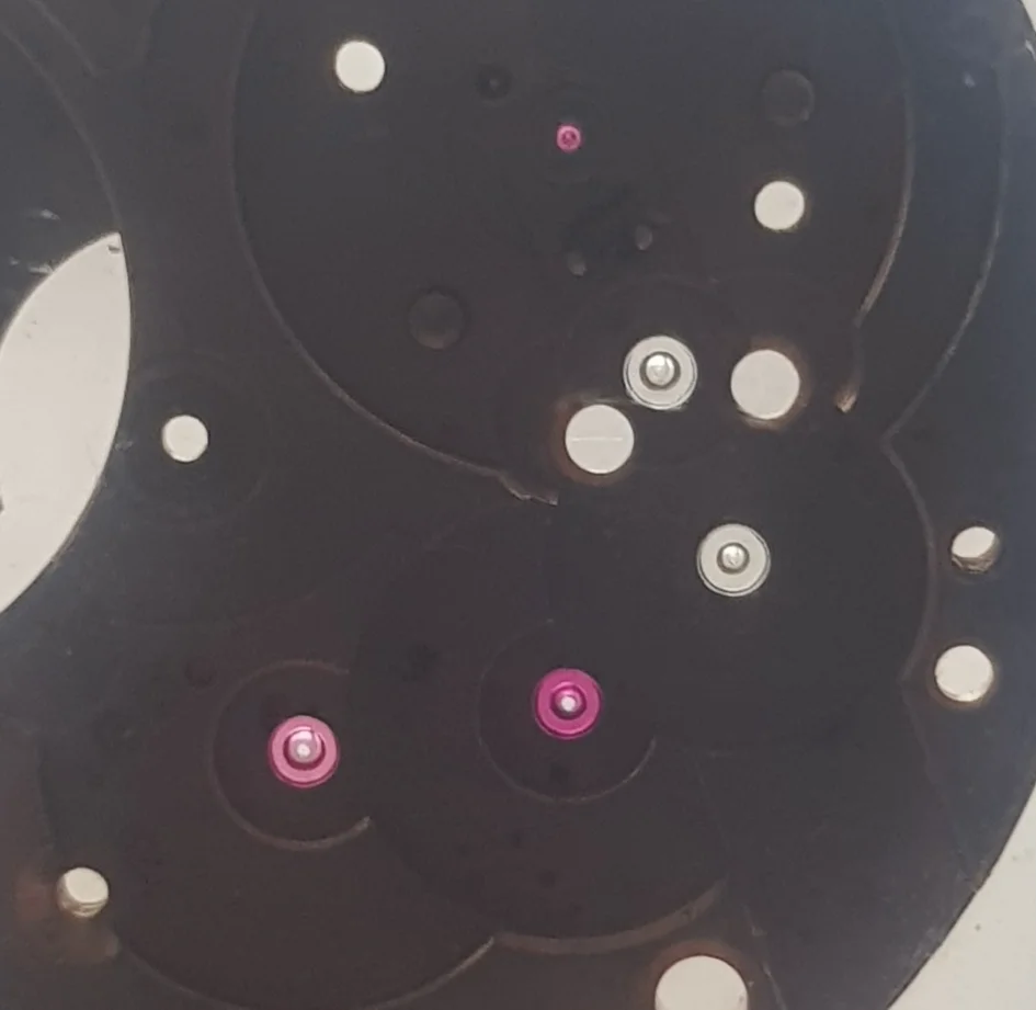

It's a bit hard to see in the picture, but the stone looks to me it was replaced with a bushing.
What stone are you referring to? central bezel without stone, this movement has 15 stones.
The one where you show a close-up of the pallet bridge. Is it a clear stone (i.e. jewel) or a (silver color metal bushing like my photo below)?
images
It's a clear jewel...
This is a pure stone, just not a ruby, but a sapphire or some other colorless transparent stone. There was a discussion on the previous page about why this stone was made transparent.

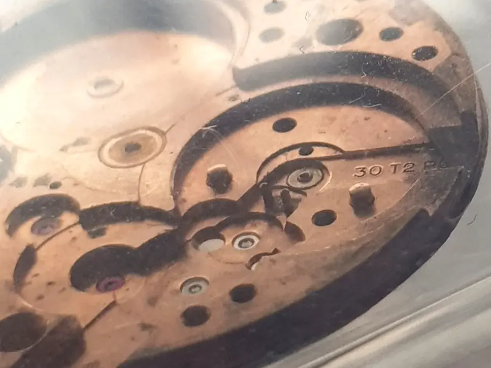

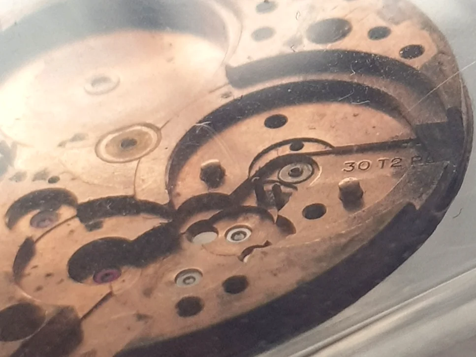

I got a movement with such a dial. And what is this star? Joint release of a model with zenith?
The movement itself is 30t2 PC

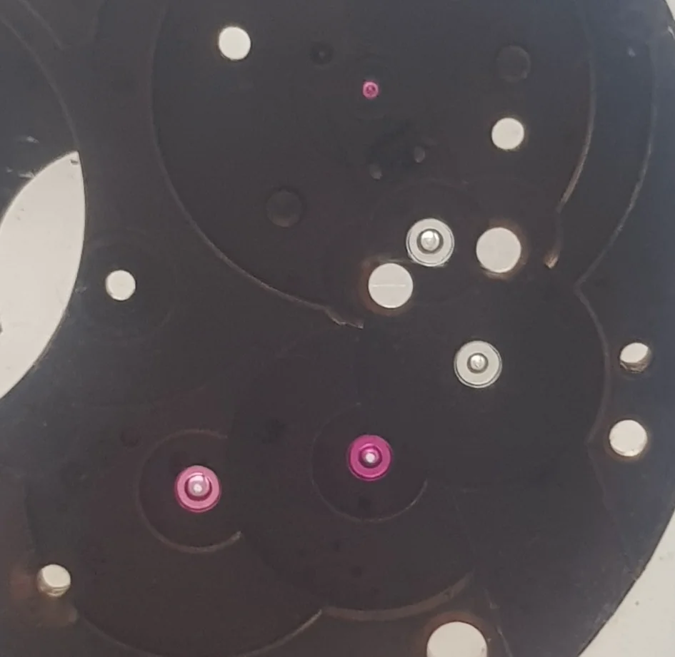

By the way, I was disassembling another omega 30t2 pc movement, where 2 of the 5 platinum stones are also white.
