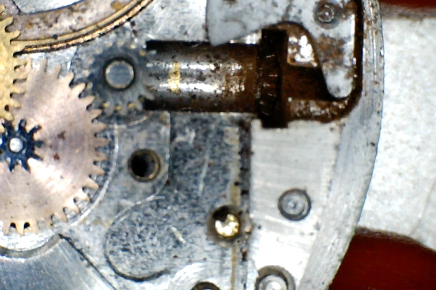

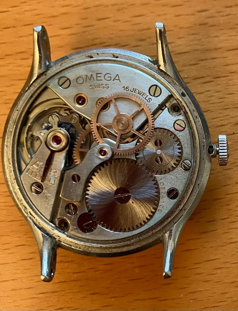

Hi folks, this is my second post to this forum. The first post was to identify the watch - thanks to those that helped.
This post is asking for opinion on whether this case is repairable.
There are two issues: the first is that the stem tube is broken (see photo) and the second is that corrosion has damaged the case in that area (see photo).
I'm an amateur watch-fettler. I've put new movements into dead Seiko's and taken apart a few movements, but not an expert. But this is a simple movement and I would like to fix it if I can. It's a friend's heirloom and he's very fond of it but doesnt have the money to get it done professionally, even it it were feasible.
Thanks in advance for your advice.

Case tube is not a problem. Removing the old one could be fun. It will take some work to get the rust clear. There will probably other corrosion issues (set lever, clutch, mainspring, etc). If it's an heirloom, clean, oil, adjust. Enjoy the history. Heavy polishing on the lugs left 50% of the metal. Still functional. Not going to be as robust.

How is the case tube fitted in? How would one extract it? TIA.
4,517
11,119
Pressed in. Extracting a rusty tube is going to be messy. 100% chance it will break off if you try and pull it from the outside. Soak the (empty) case in some rust busting oil. There are some videos out there. I always try to press it out from the inside. Careful not to nick things up.
