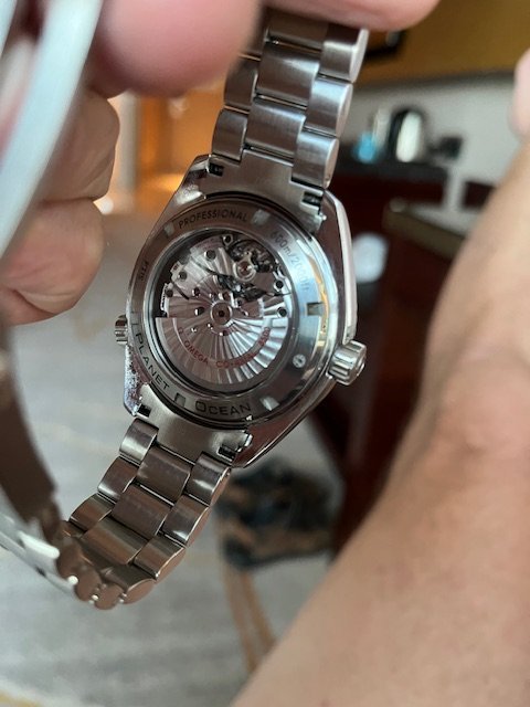

You wont be able to tell authenticity from the barrels since you can't see or feel them moving. Better is to look at the balance wheel and if you can see it escapement. The the real one has a free sprung balance and is regulated by screws on the wheel, the fake stuff has the old school regulator but disguised and the additions on the wheel if present are clearly not for regulation. When you look it's pretty obvious really. Otherwise they do look similar and can fool the unwary.

Unfortunately I am not sure what to look for as I don't have the watch in front me, so I don't know hos it is supposed to look.
I only have this picture but not sure it helps for anything:
s!AjETnoHUZiARyf9txHbK6NlilPbH5A
Thanks a lot
