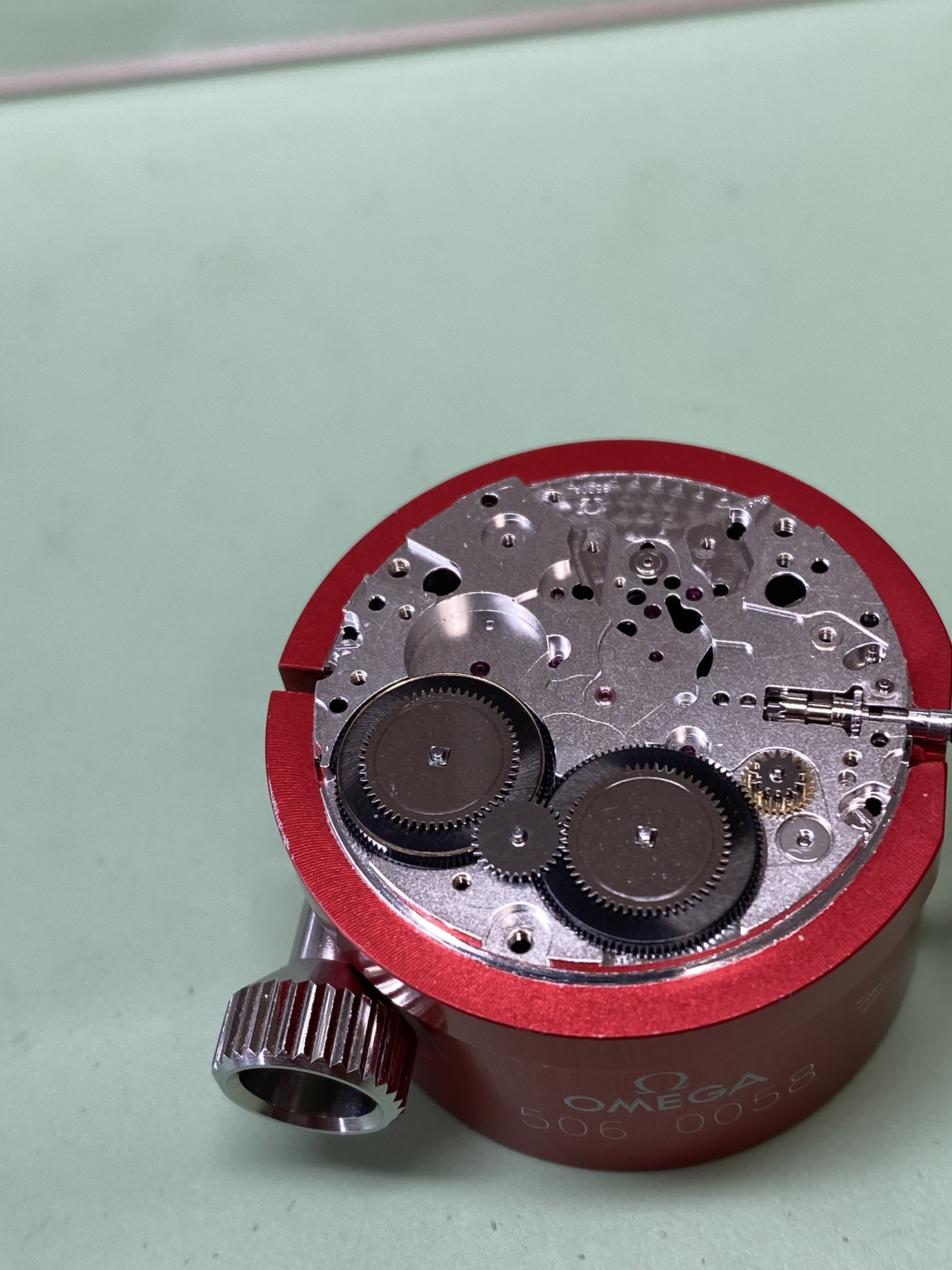

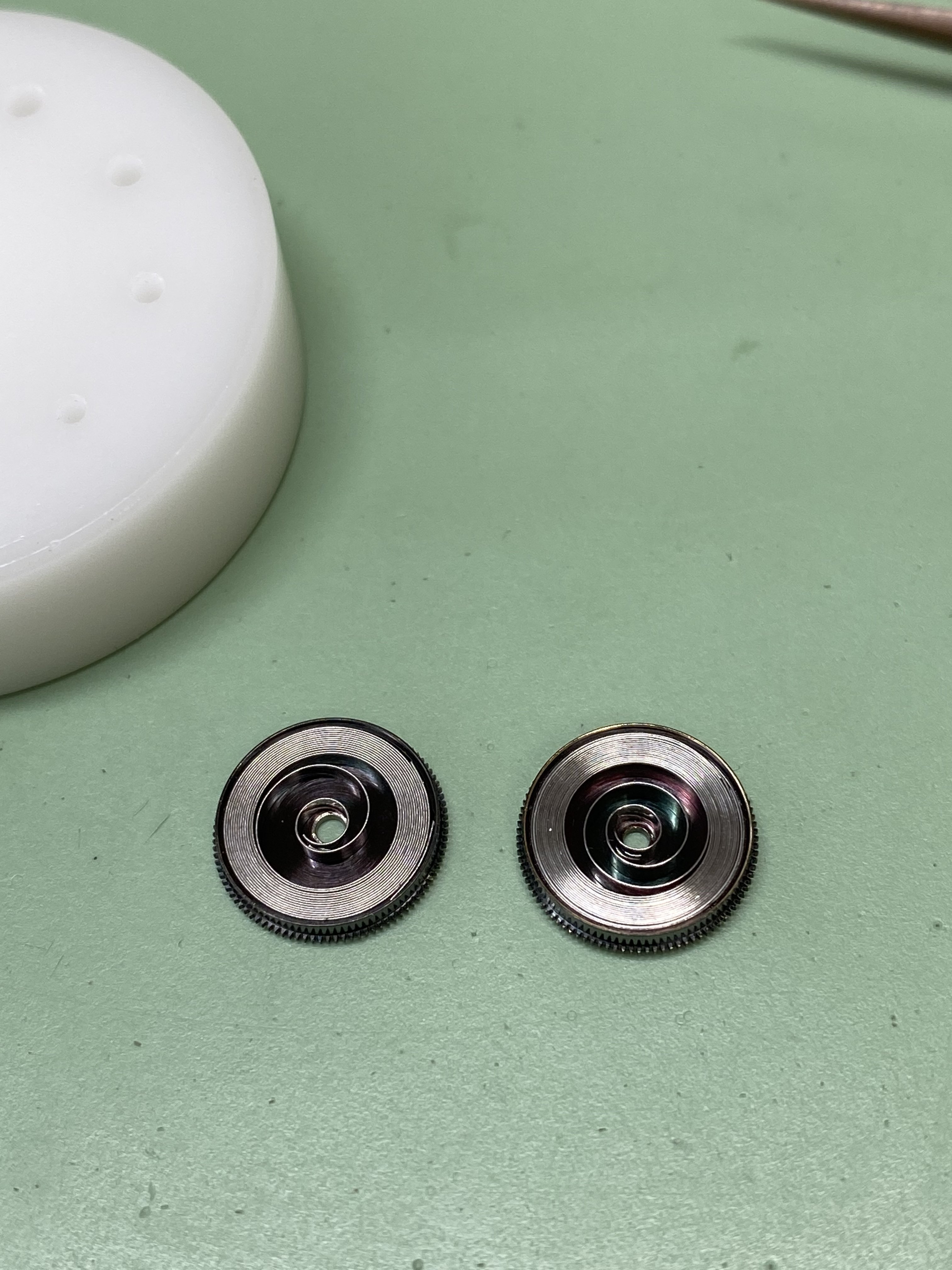

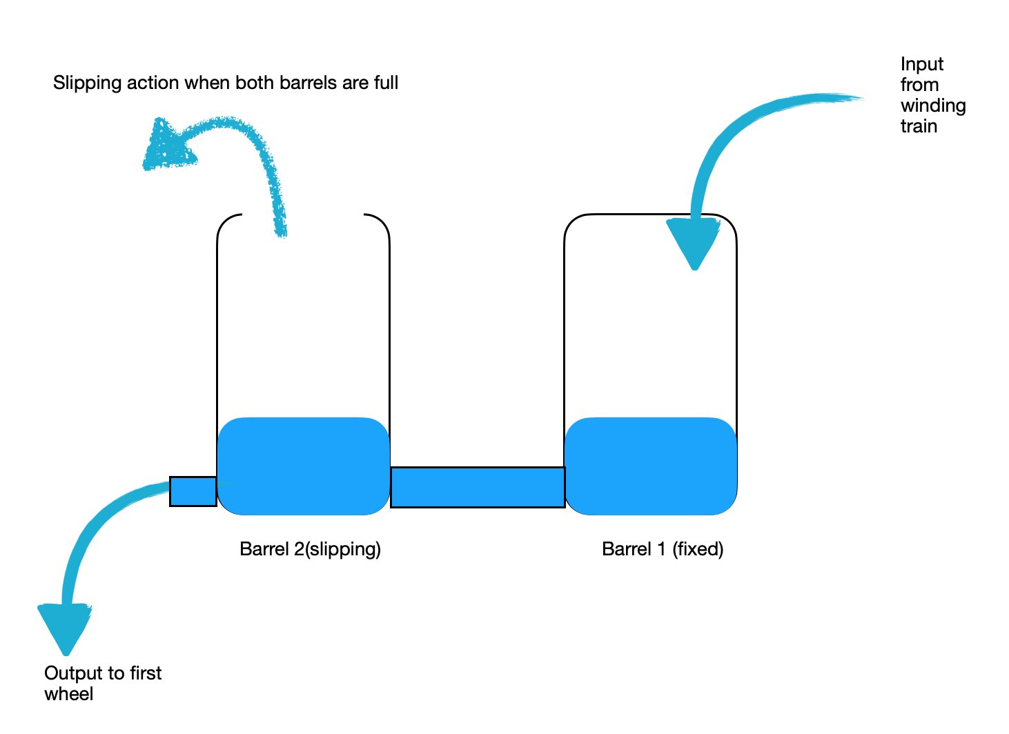

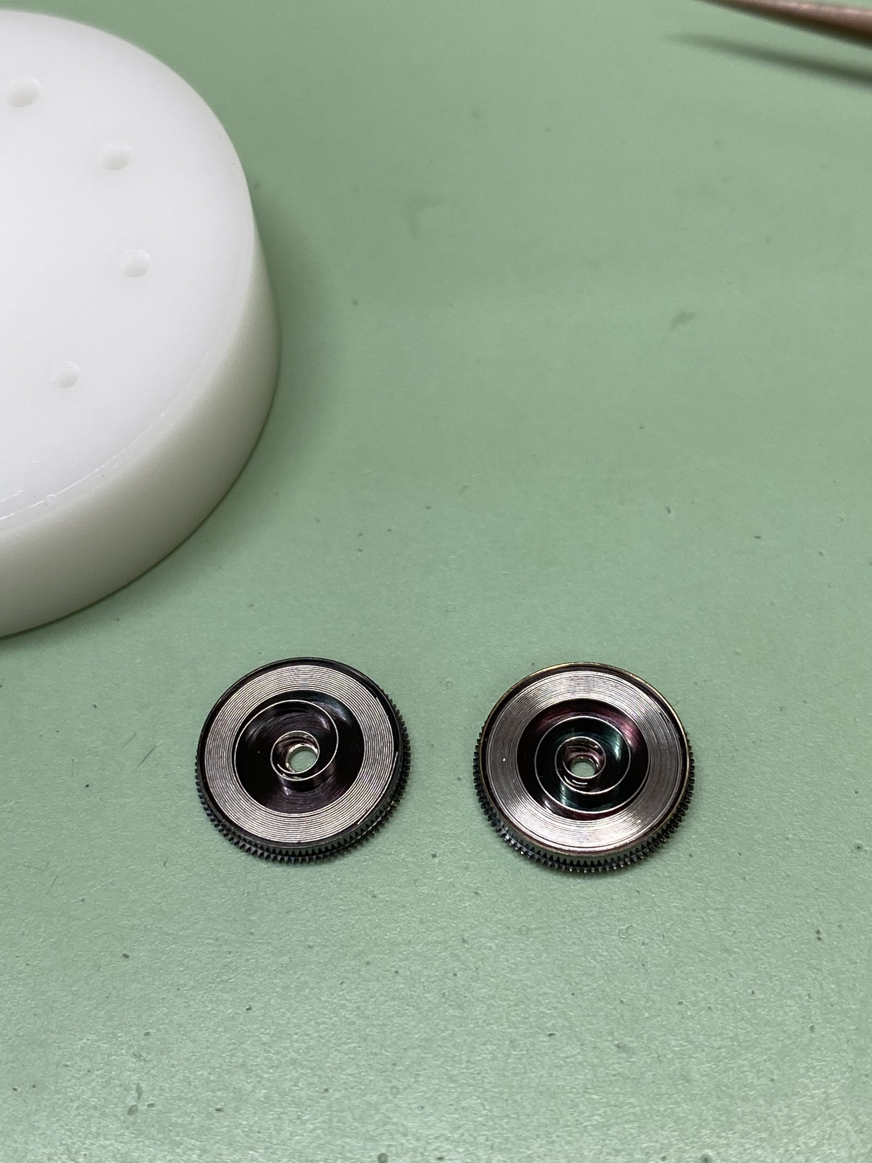

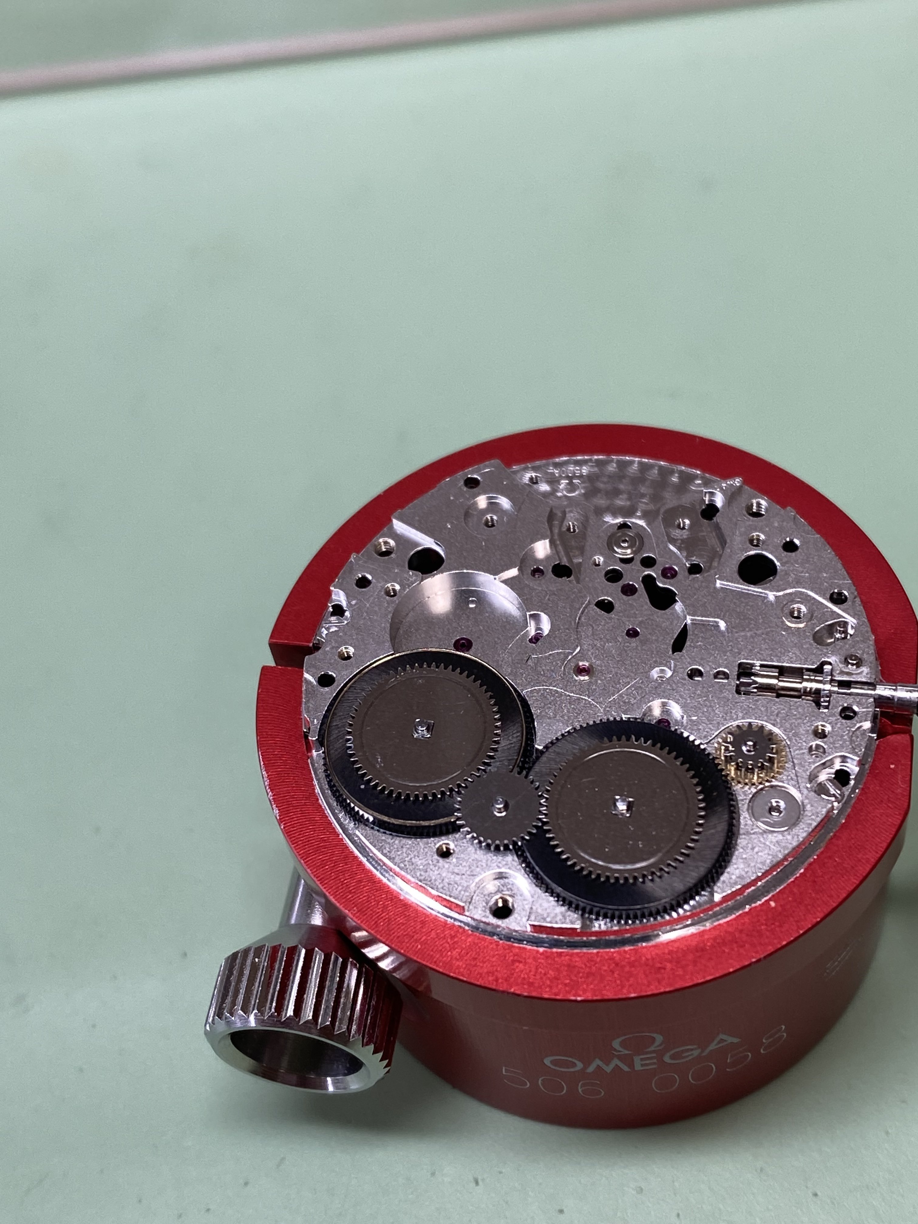

Both barrels wind and unwind together. Barrel 1 is where the input winding is and the fixed spring. Barrel two contains the slipping spring. The first wheel is driven off barrel 2 which then drives the rest of the train. In training it was explained like having two water jugs linked together at the bottom. If you pour water into jug 1, jug two will fill more or less at the same rate. The outlet is on jug 2, both jugs would empty more or less at the same rate.

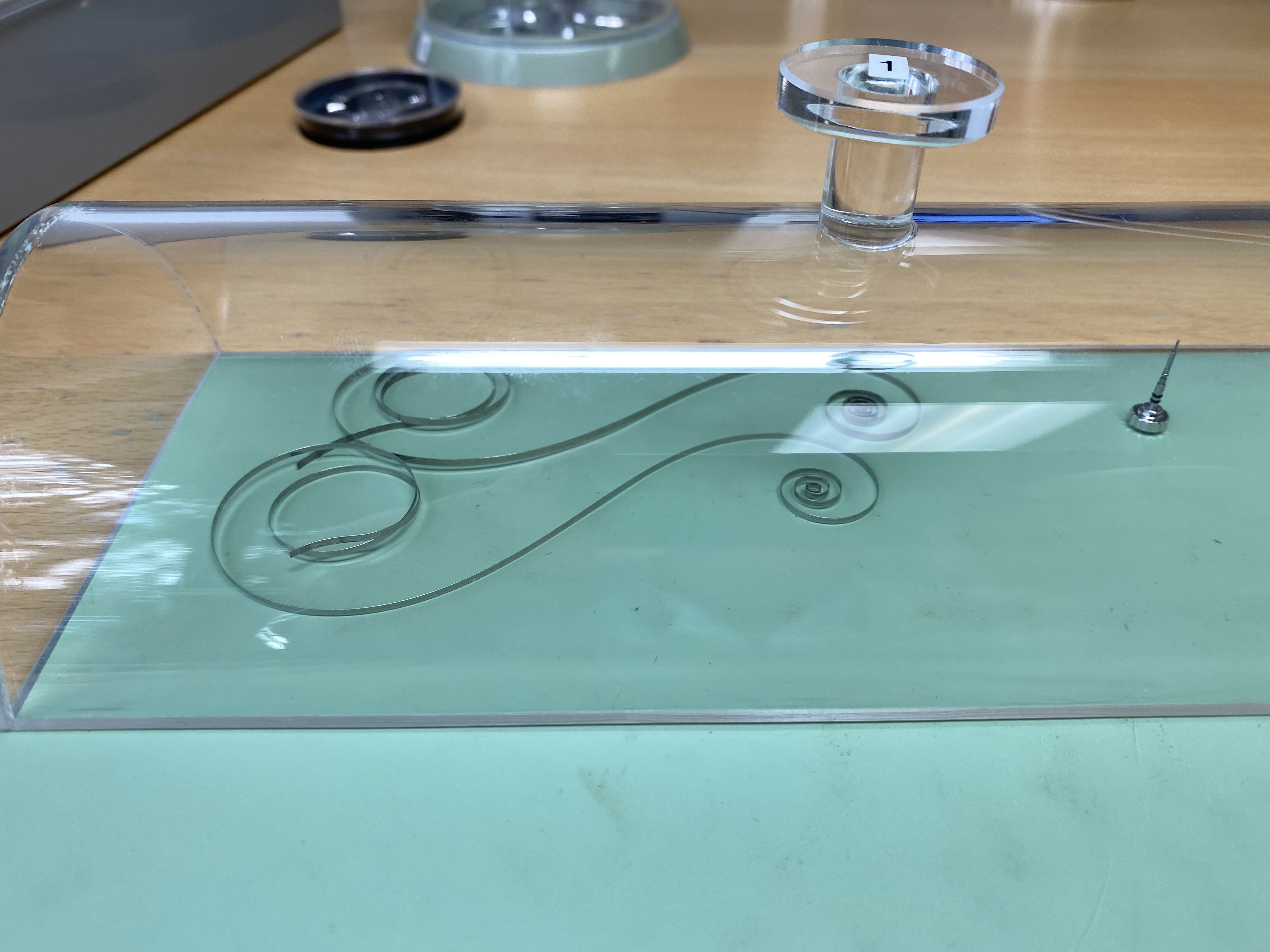

In class at Omega they used this analogy to describe how it works:
16
Outstanding, thank-you very much for that explanation 😀
