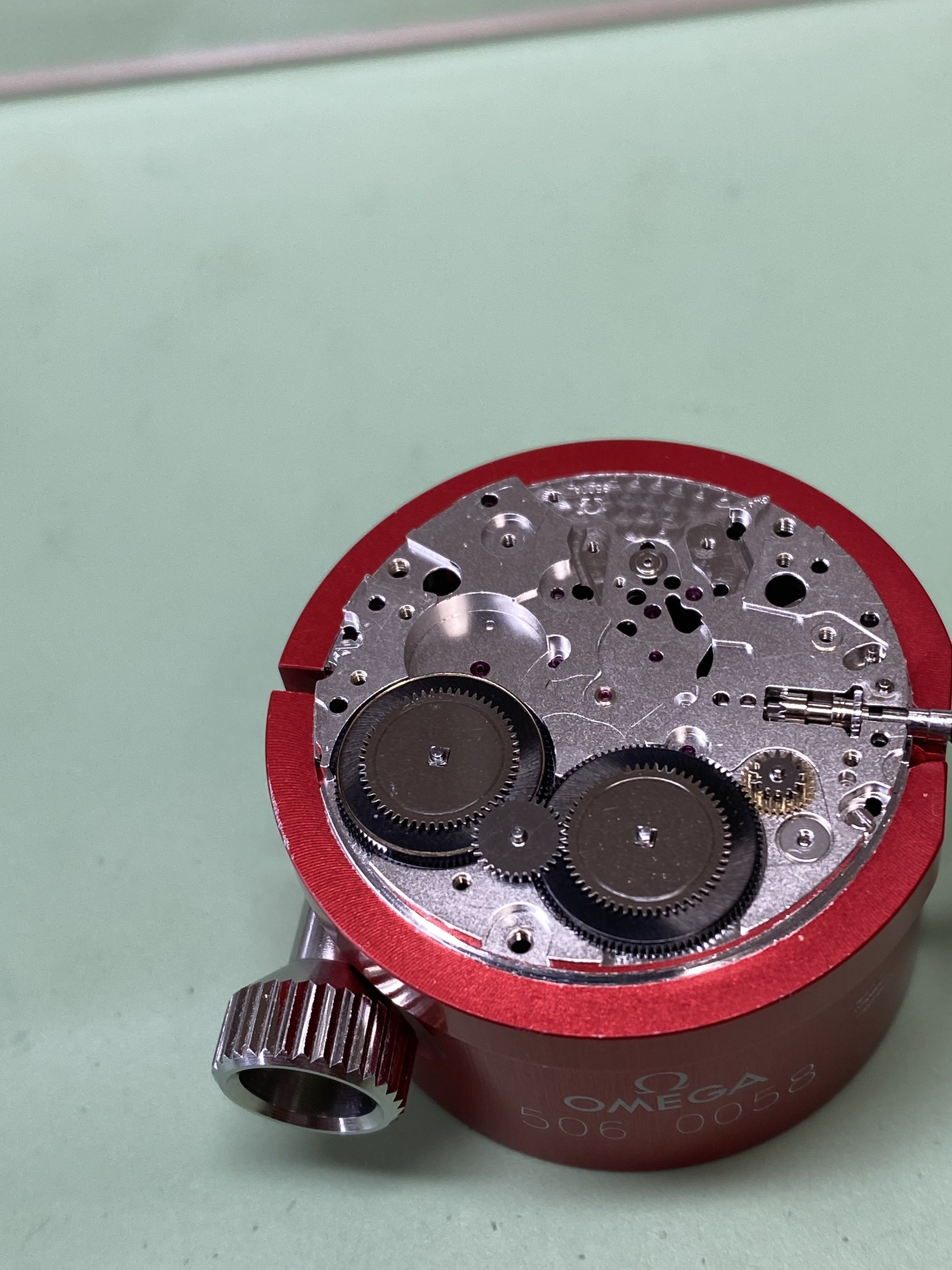

Both barrels wind and unwind together. Barrel 1 is where the input winding is and the fixed spring. Barrel two contains the slipping spring. The first wheel is driven off barrel 2 which then drives the rest of the train. In training it was explained like having two water jugs linked together at the bottom. If you pour water into jug 1, jug two will fill more or less at the same rate. The outlet is on jug 2, both jugs would empty more or less at the same rate.

I made up a quick diagram. Hopefully this makes sense. Omega's main intent with double barrels was not to obtain longer run times. The design intent was to provide more consistent torque across the entire run time.
Ah, this helps a lot, thank you. So even though the spring in the first barrel is fixed and cannot "accept" any more winding, the outer visible barrel will still be spinning when the crown is turned (or presumably when the rotor spins) and this direct connection goes to the second barrel which in turn has the ability to slip internally. Is that correct?
Yes, that is correct.
