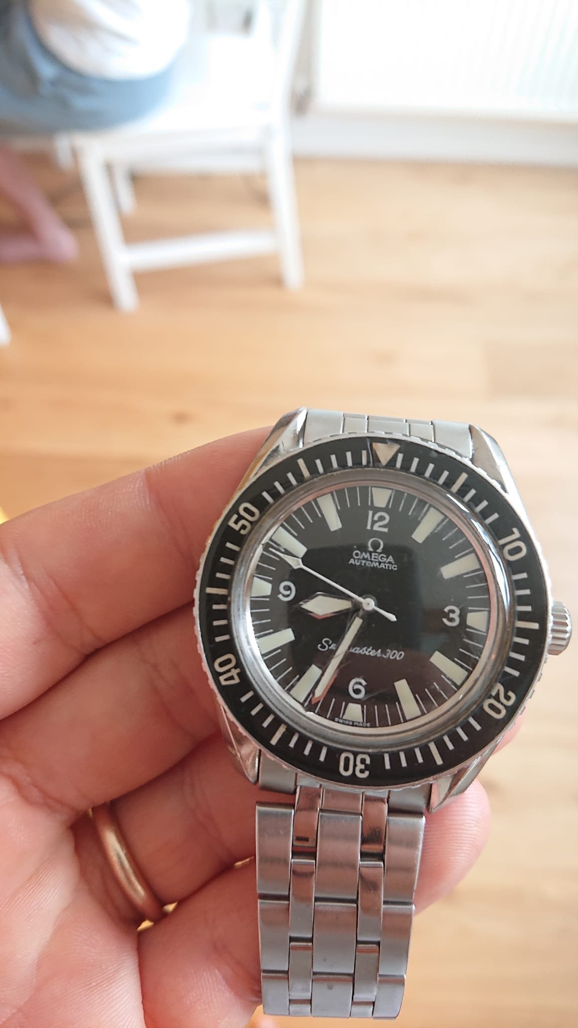

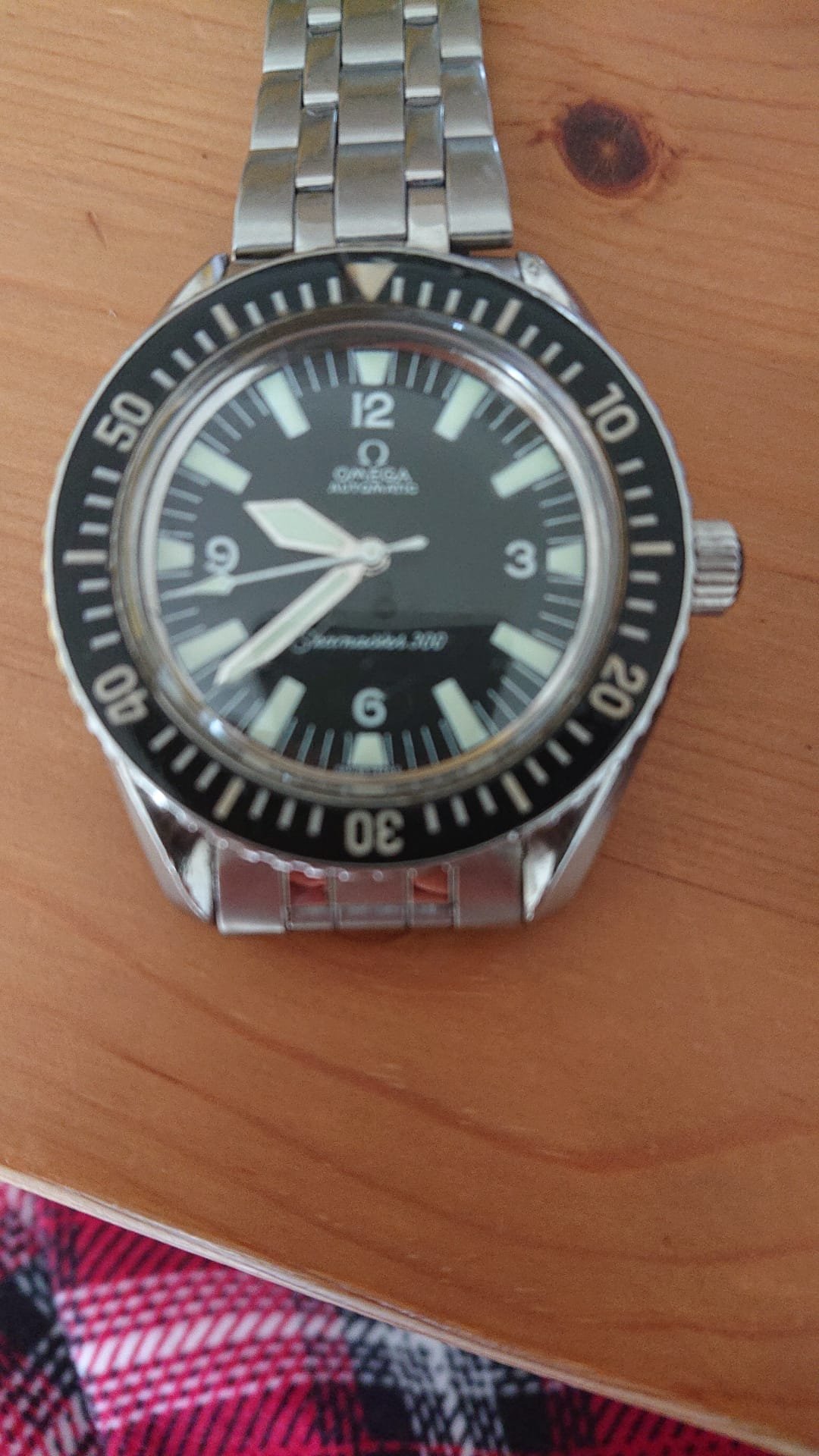

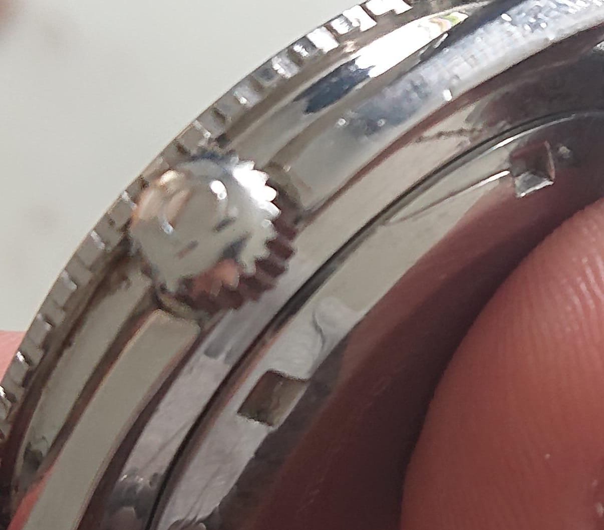

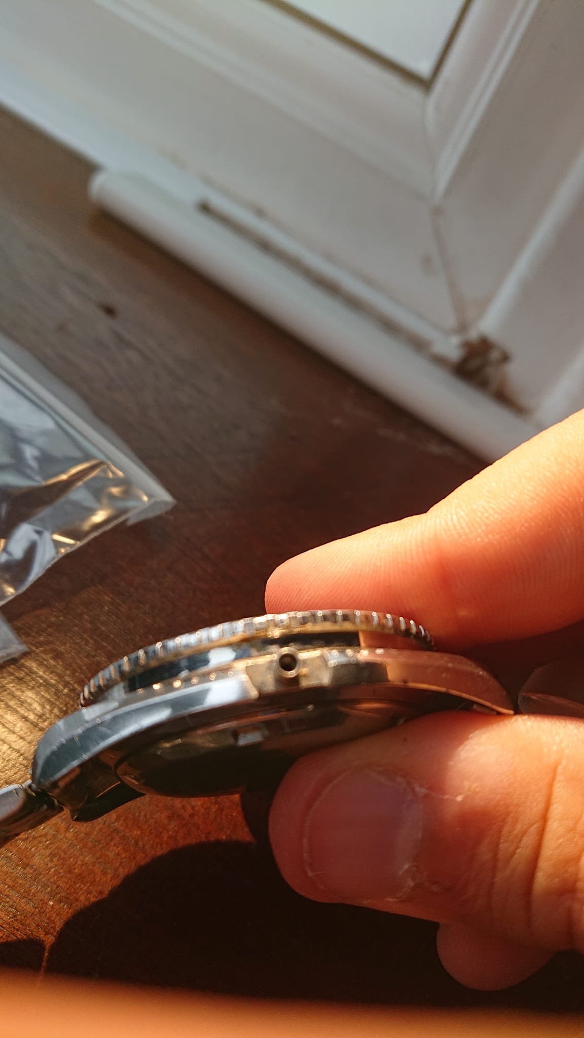

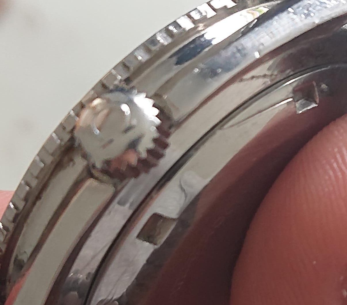

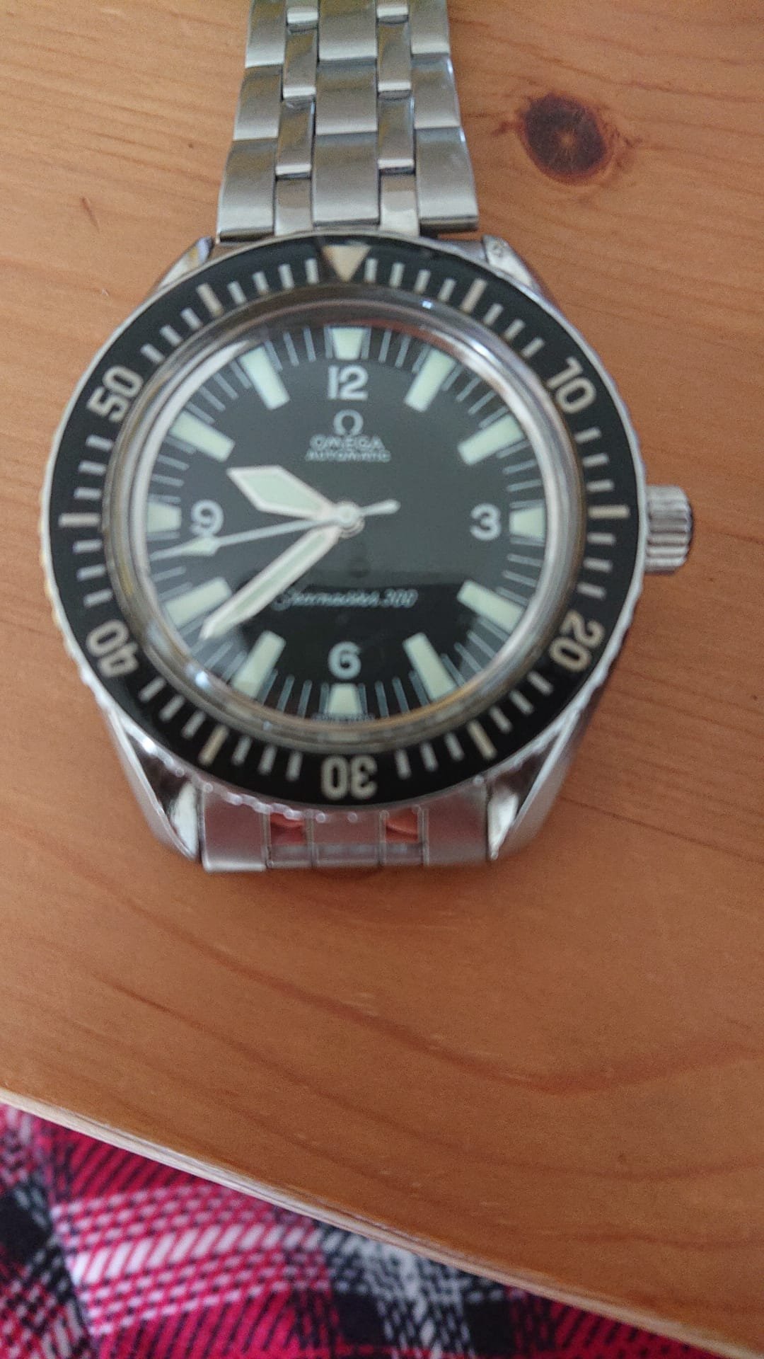

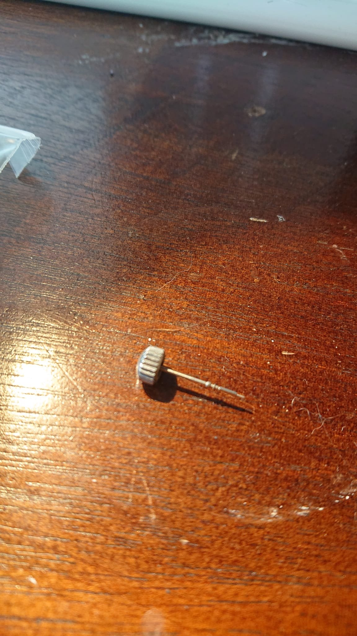

Hi David! thanks for the the reply - Photos attached - I know on this forum there was some doubts as to whether this was the correct crown - but the watchmaker says it was when i took it in? (maybe he doesn't know too much about it) - But I did ask him to confirm that it was and said it was.
5,668
9,497
If you have a screw in crown, screw it in..... The seals are different to the push in only crown.

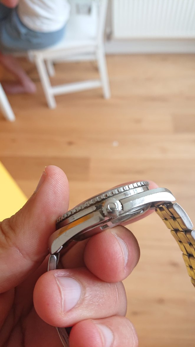

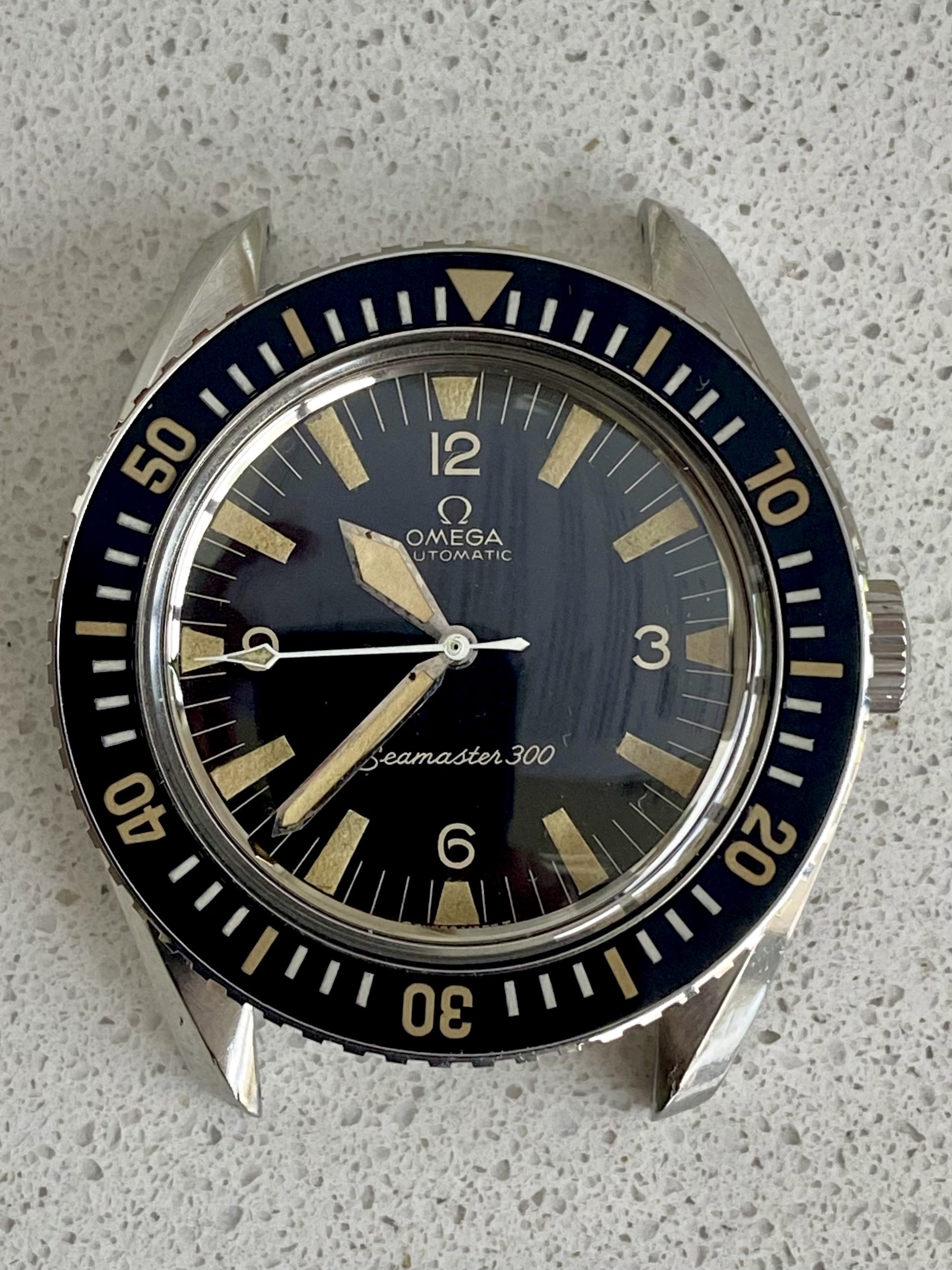

Looks like the dial and hands at least have been replaced by modern service items. Perhaps the case has too.

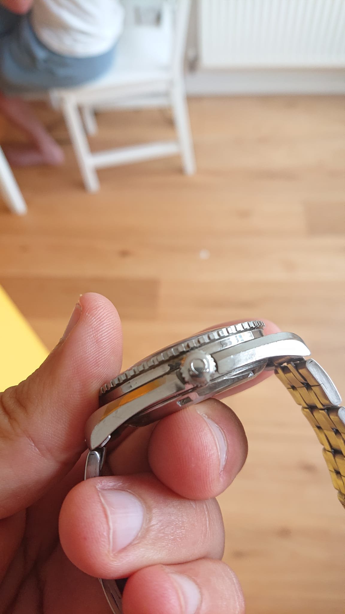

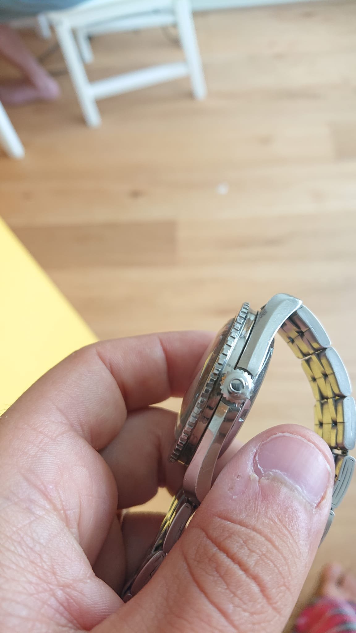

can you show a picture of the crown take from above. It’s hard to see from your photos.
39
13

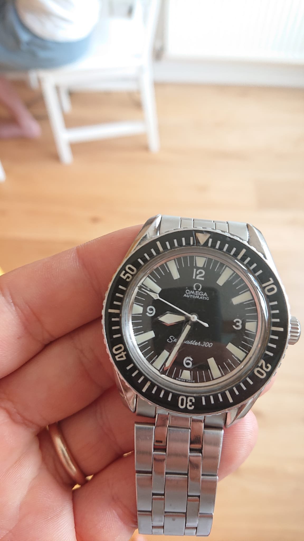

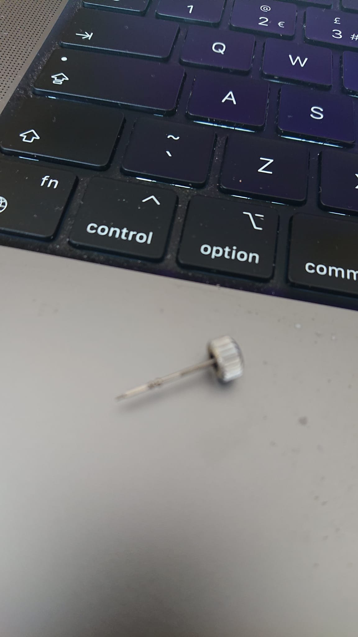

There you go! any better?
Yes, hands and dial are service parts, the bezel is original AFAIK. I think the case was the same too

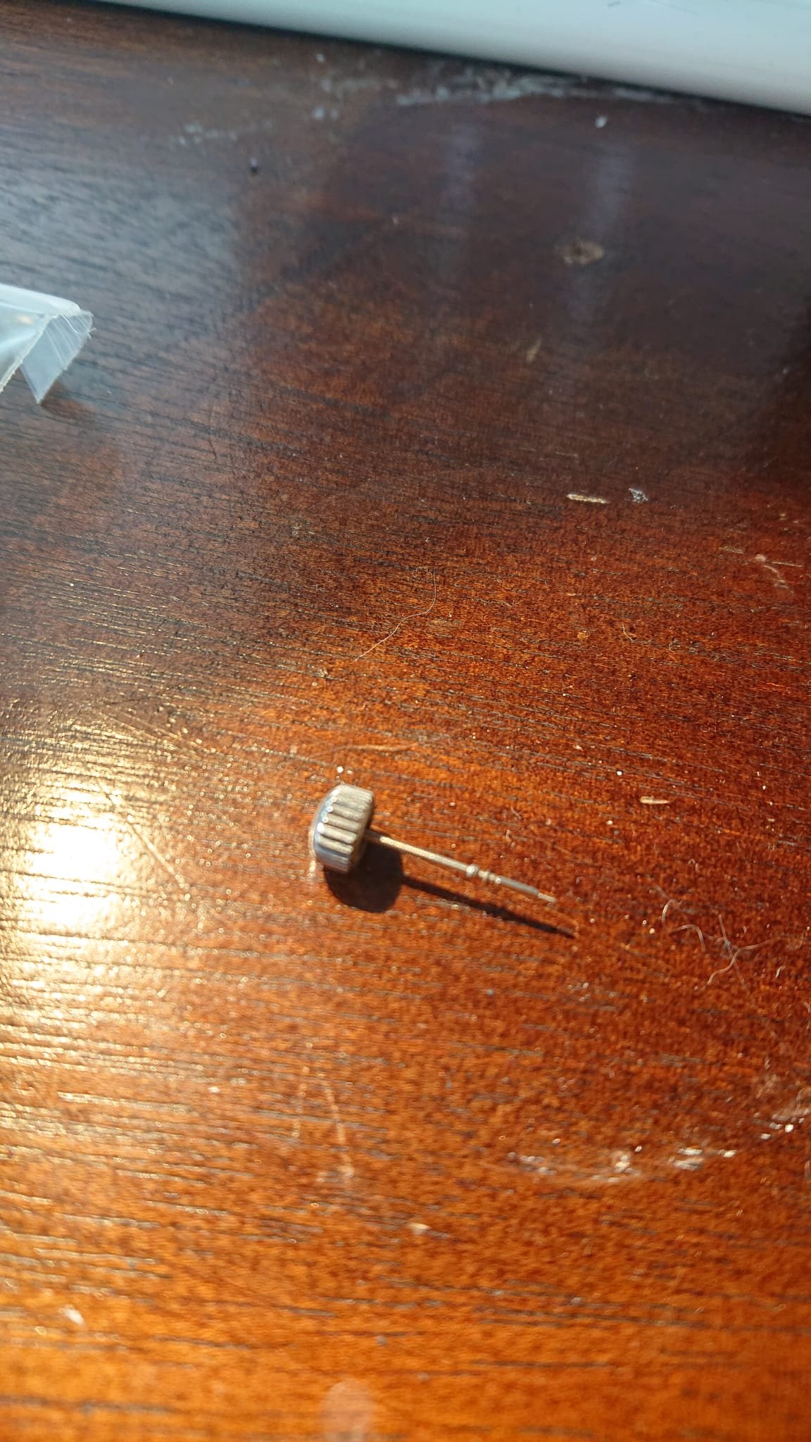

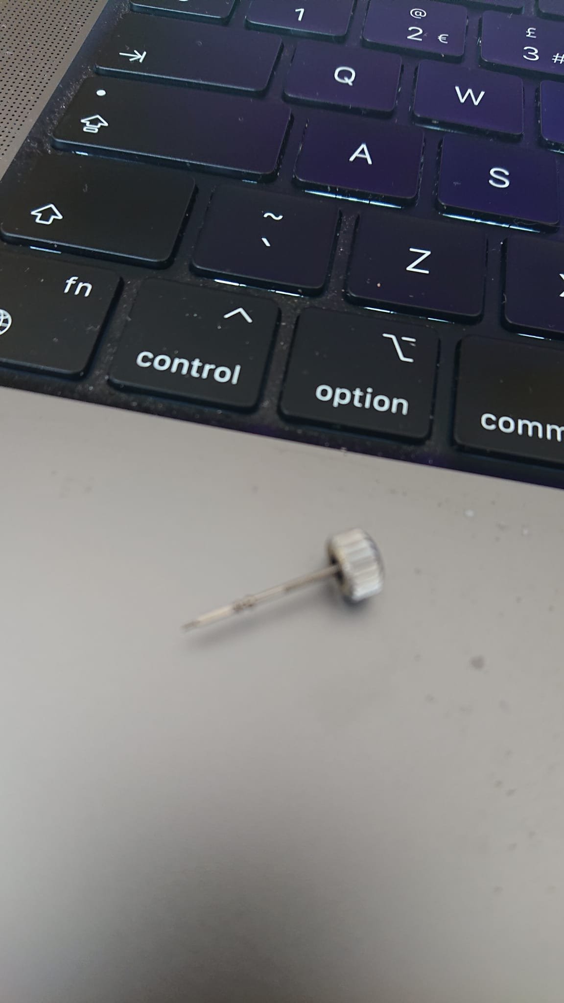

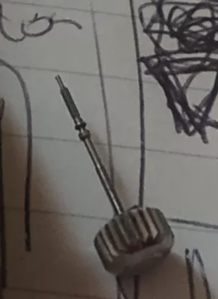

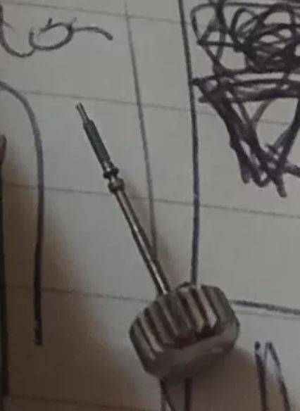

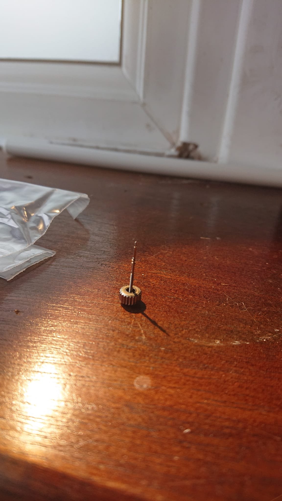

This is the crown when fully pulled out when it was all coming out!
39
13

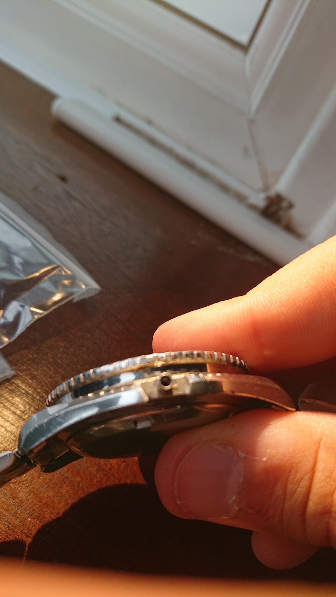

In fairness, I didn't check how it looks inside the case....

Dial and hans are service replacements, bezel is original part.
It seems like the crown is not from this model.
Would give it to somebody, who is able to get the correct part.
Btw, the SD case tube has internal thread, so you wont see anything when crown is pulled.

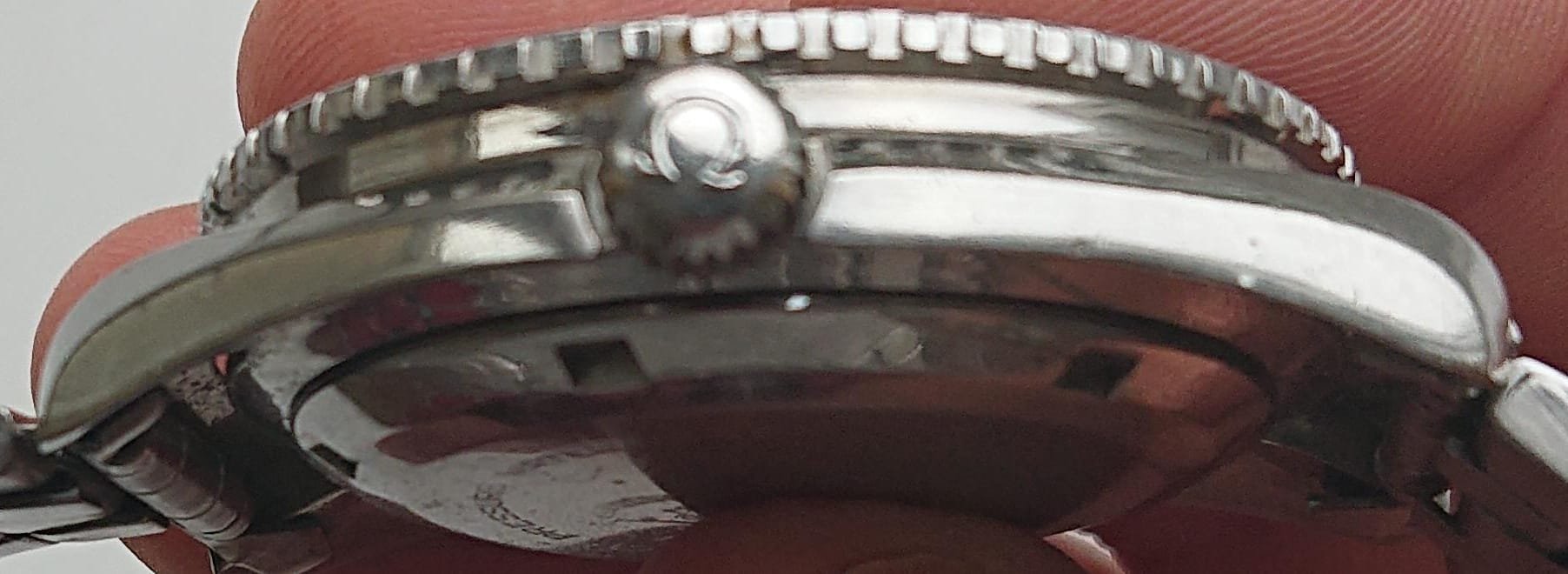

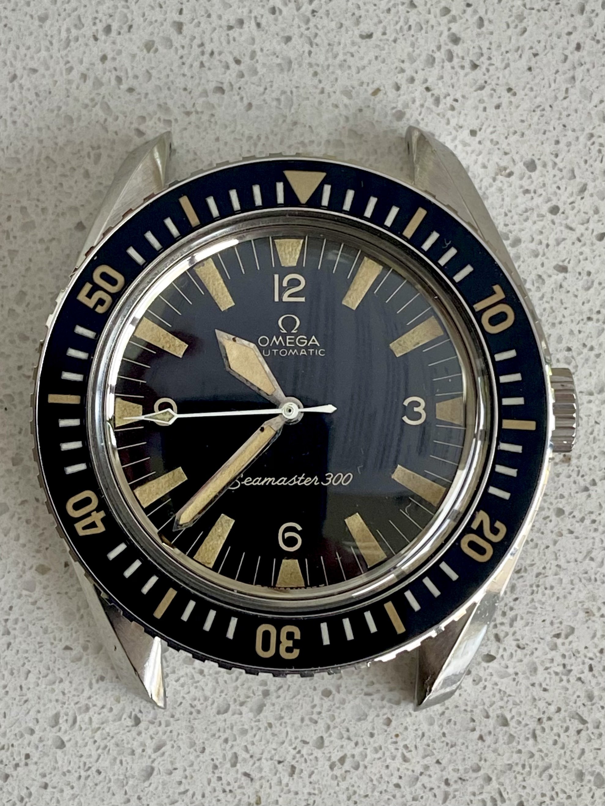

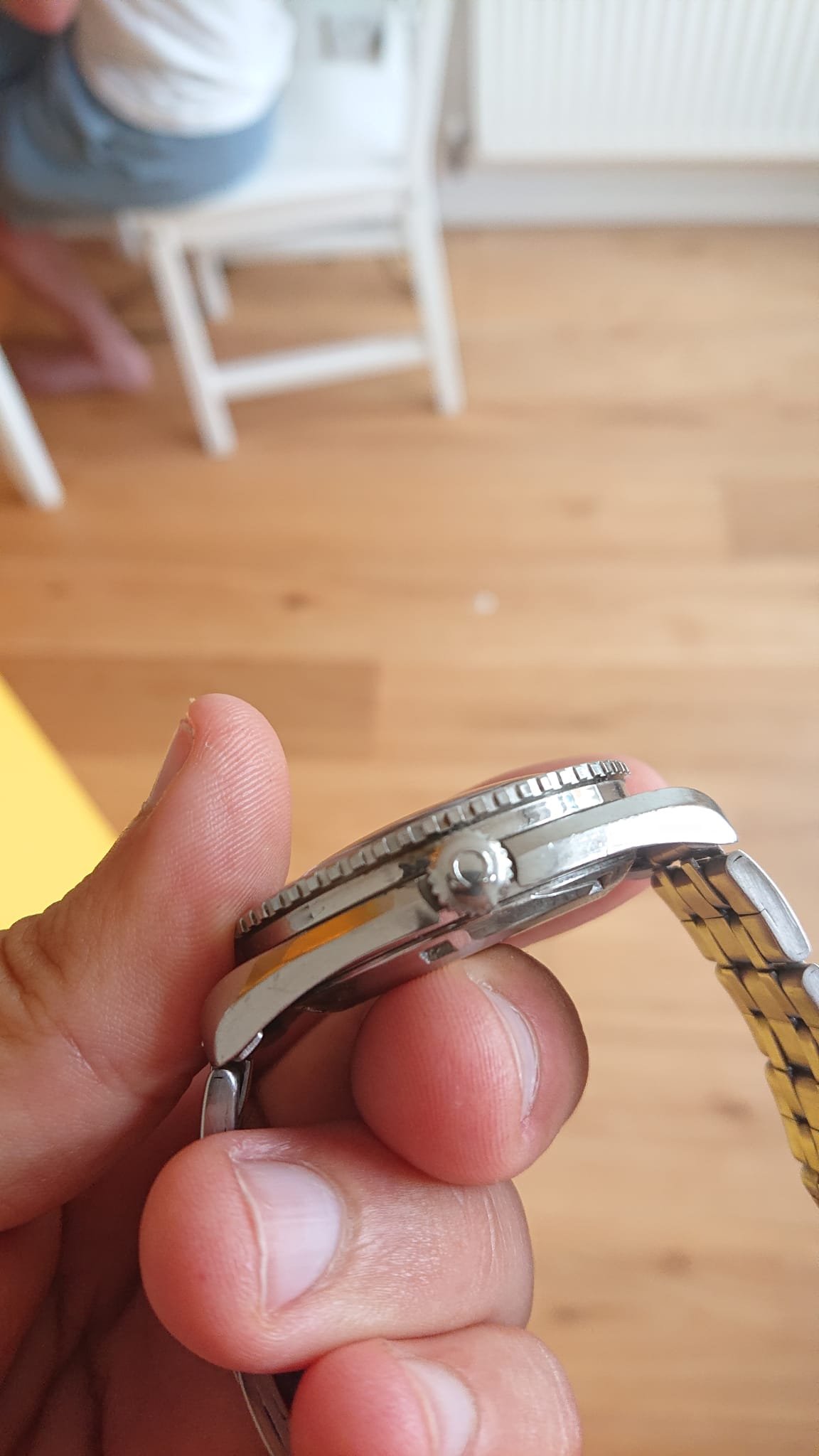

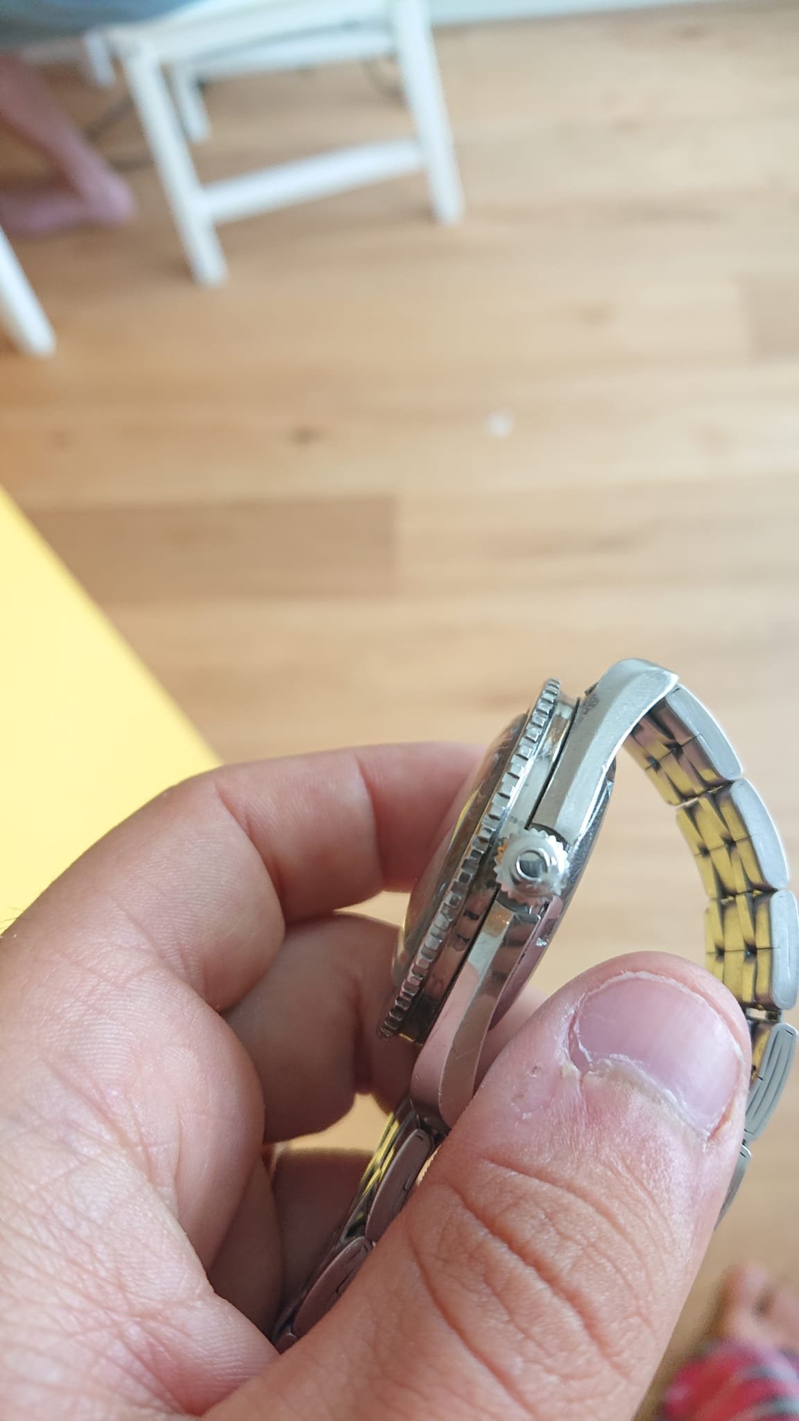

Sorry I meant a plan view of the crown.

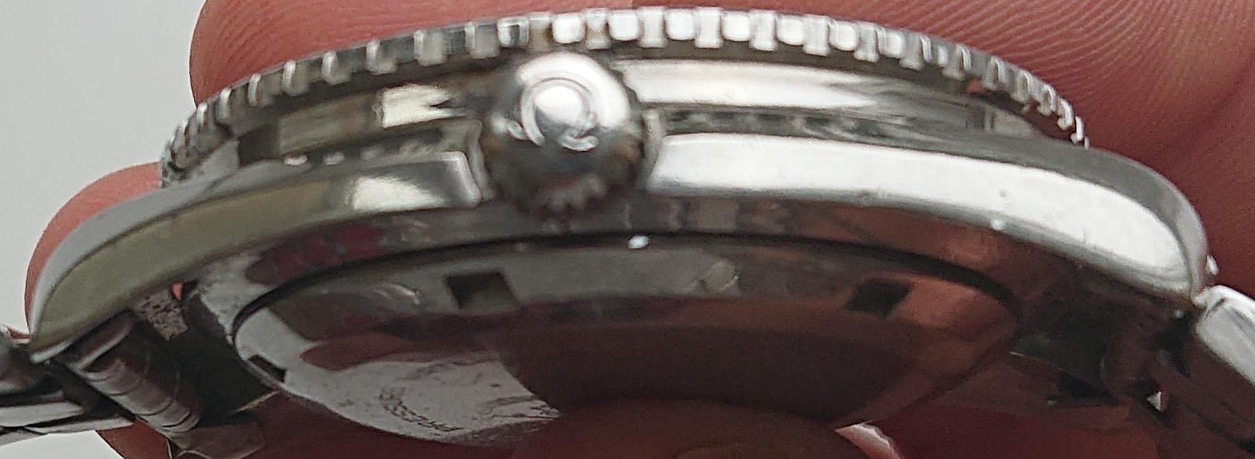

The pictures below show push in (naiad - top) and screw in (bottom). You crown initially looked like a screw in but now I’m thinking it’s just an incorrect push in version.

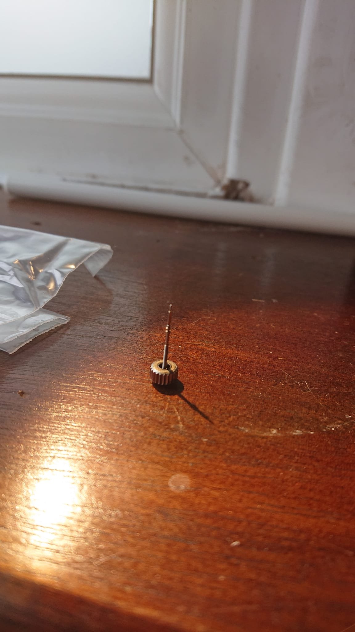

Thanks - I have been trying to take better pictures but my phone seems to not want to cooperate - although actually i just tried to pull out the crown very gently and the crown completely came out, meaning that the repair has failed in a record 2 days
Apologies David! attaching now

It’s not the correct crown for the model, but it’s hard to tell from the photos if your case tube is for a screw down crown or naiad crown. You’ll need to ascertain that before you can get the correct crown.
Can you see a thread on the inside of the case tube?
