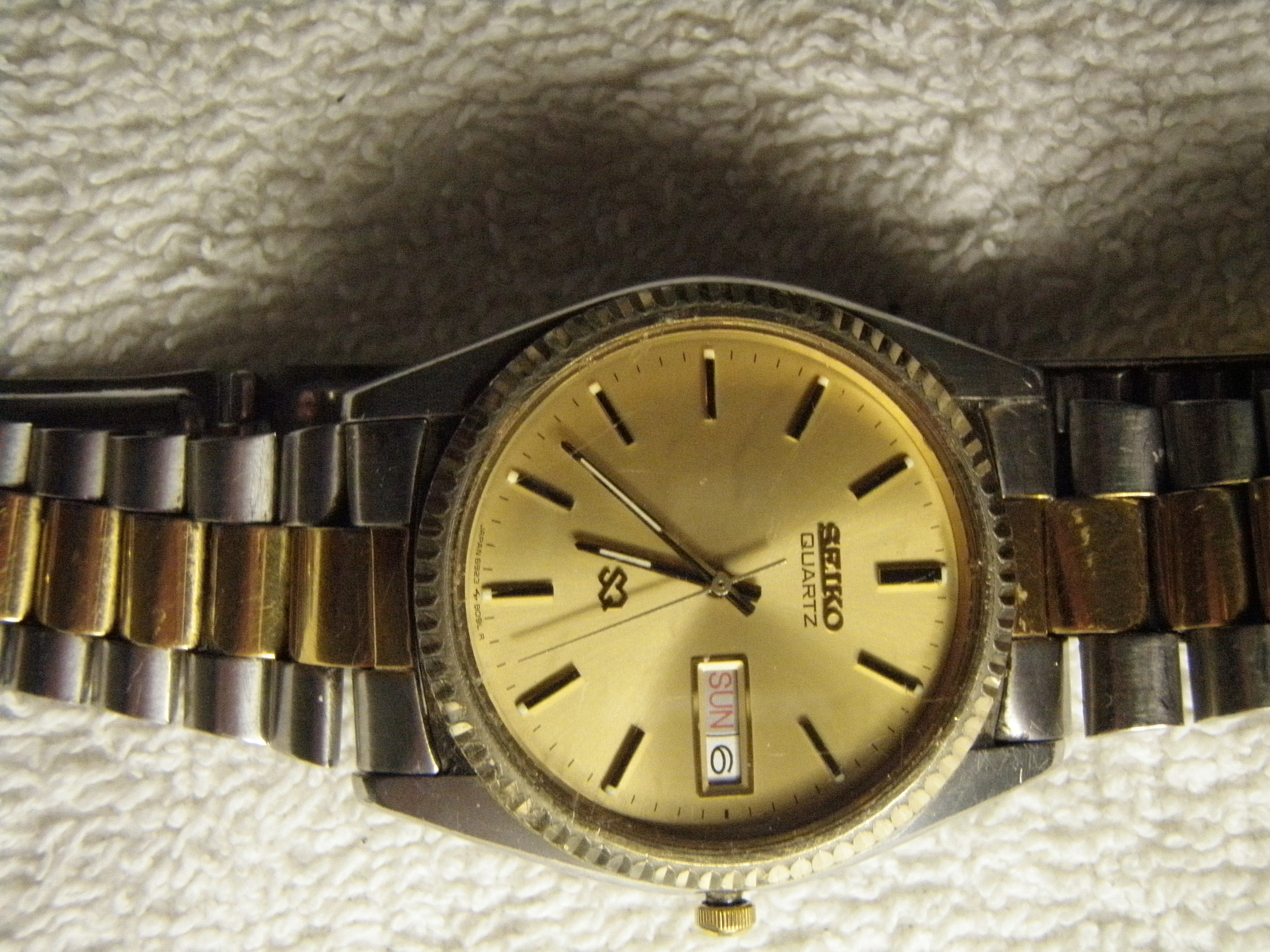

My dad's Seiko 6923-808a, known as the A View To A Kill watch (worn by Roger Moore in that film) has started to lose time. It will be fine for two days and then he will look at it and suddenly it is an hour behind. The watch is mint (original band long gone but the head looks brand new), however at nearly three decades old I wonder if this is it. The battery was changed about four months ago.
This is a very uncommon watch, but by no means a collectors item. But it has real sentimental value. I'd really like to keep it going for him. Any ideas what this issue might be? I certainly can try a new battery for starters.
Must be the twin to yours, only still on original bracelet.

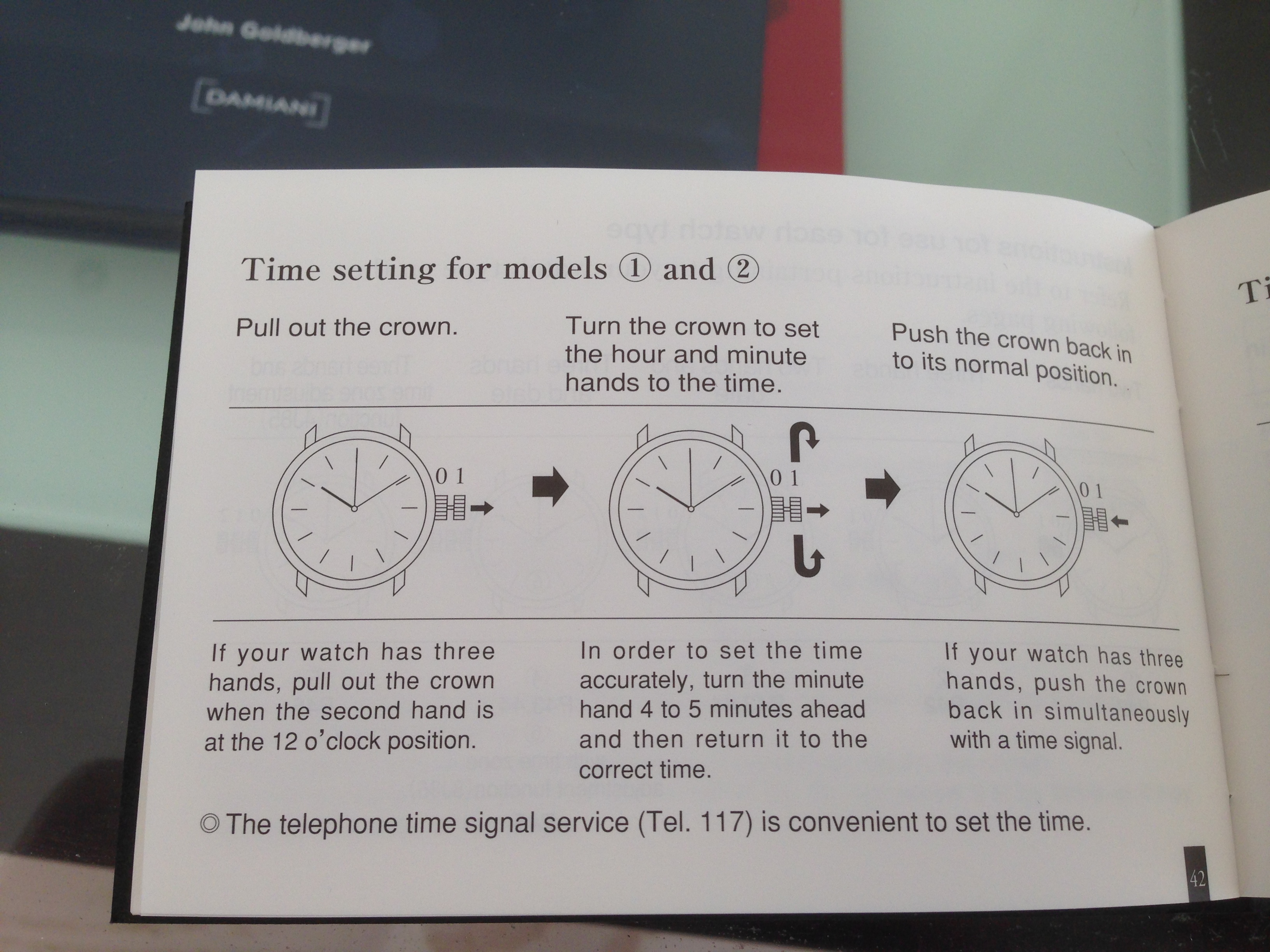

I have a Credor quartz as my work watch for the last 10 months, adjusted the time twice a year for daylight savings plus a couple more times due to travelling across time zones, and it has never been off more than 1 second. According to the manual, "in order to set the time accurately, turn the minute hand 4 to 5 minutes ahead and then return it to the correct time". I am just curious, what would be the reason(s) for that instructions?
Sorry been meaning to add some information to this thread, but first your question....the direction you turn the crown to adjust the time depends on the gearing for the setting parts and time train. The reason for adjusting it past the time and then setting it backwards I can only assumer is to take up the slack in the gears. If you don't do this, the hands will appear to drift off because they won't start moving again right after you push the crown in, since the slack is being taken up first.
It's not specifically because it's a quartz watch - mechanical watches can have this as well. For example when setting the time on an ETA 7750, I always go past the time and back up to the minute I want to take up the slack.
