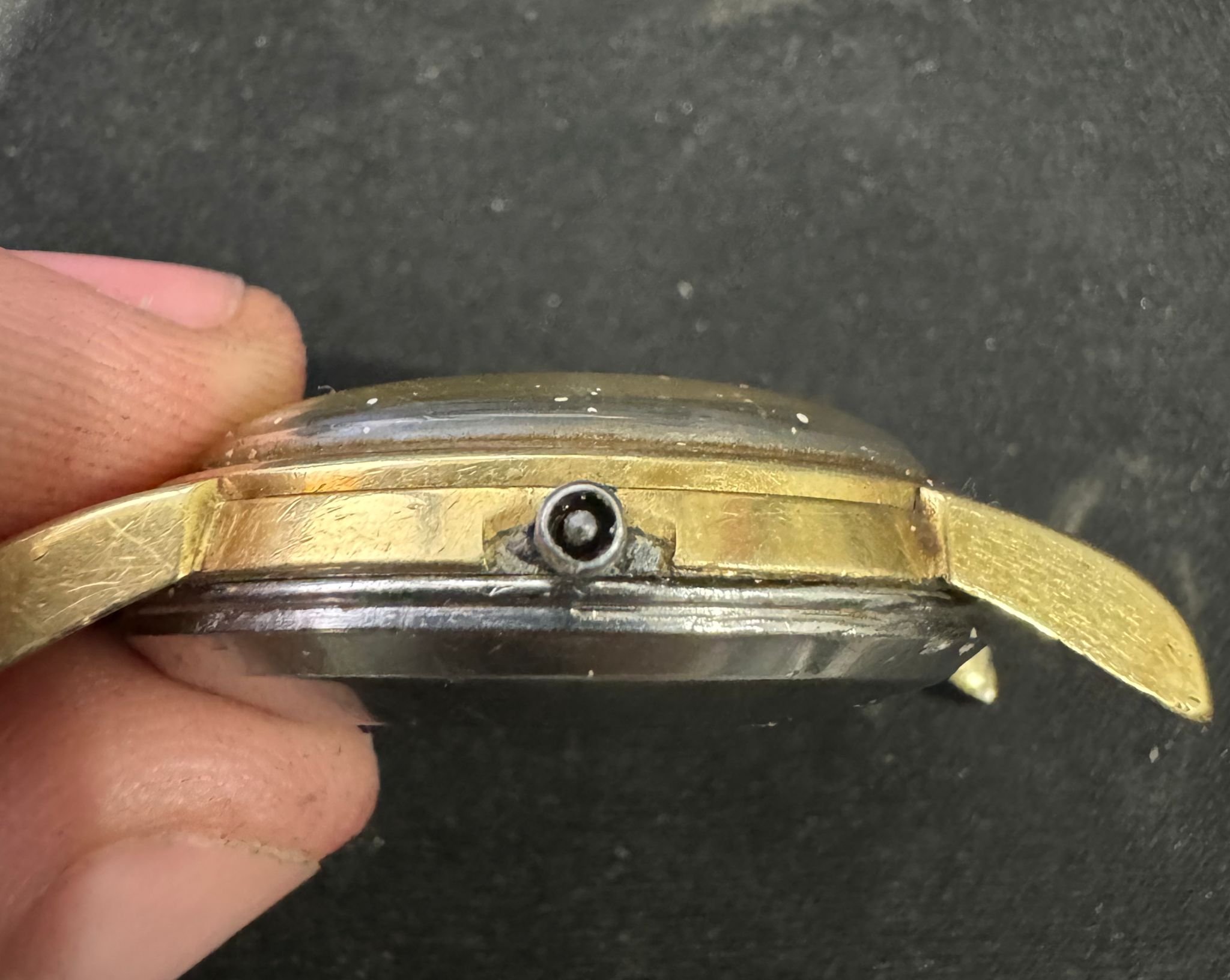

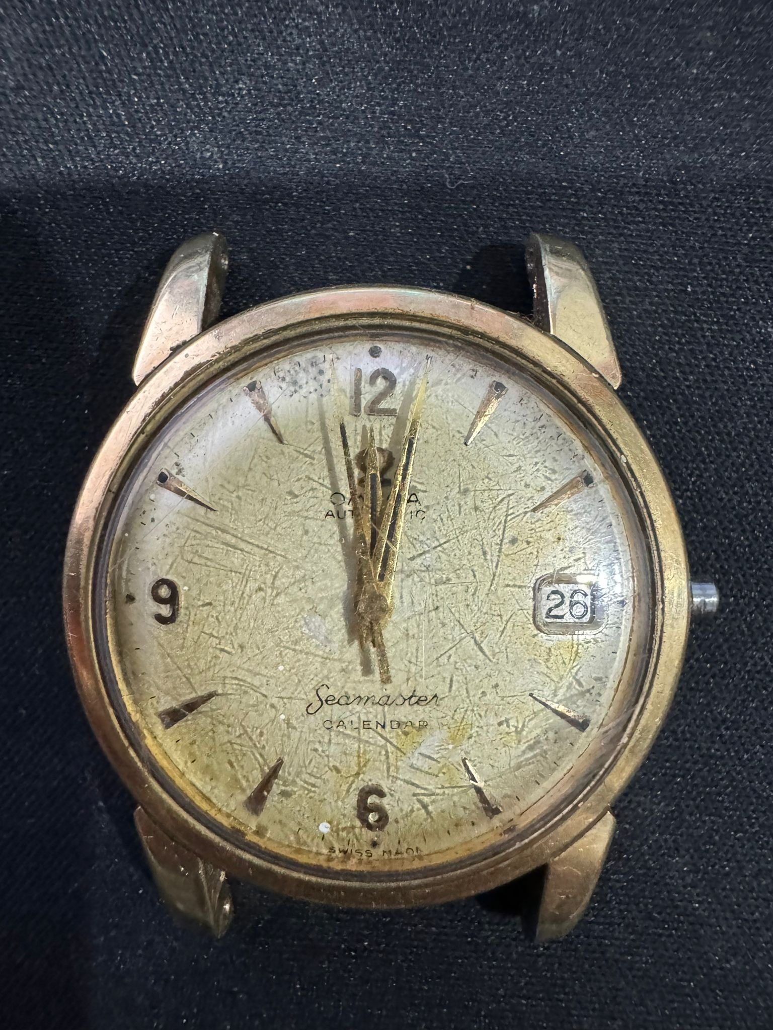

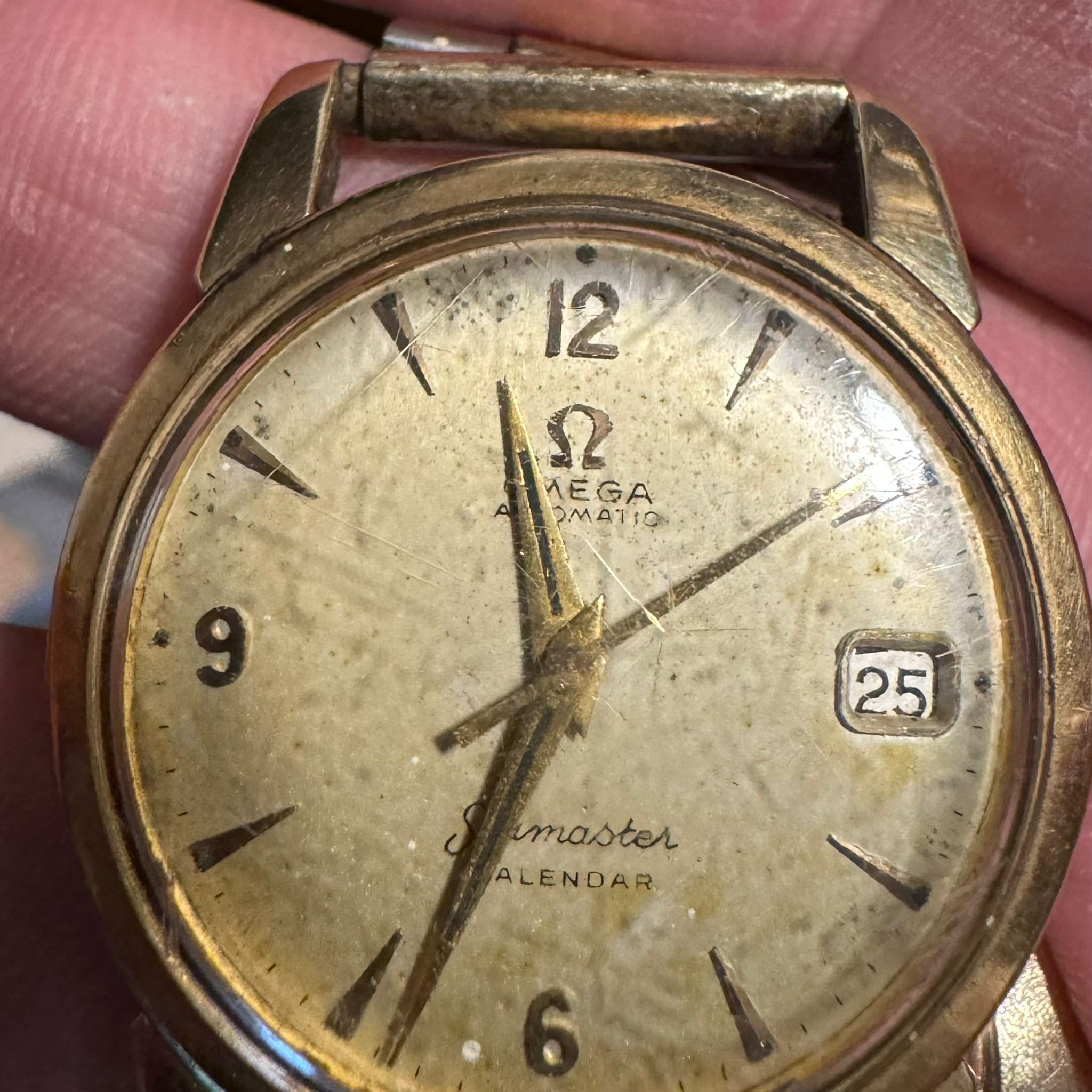

The watch needs work like a new strap, new crown.

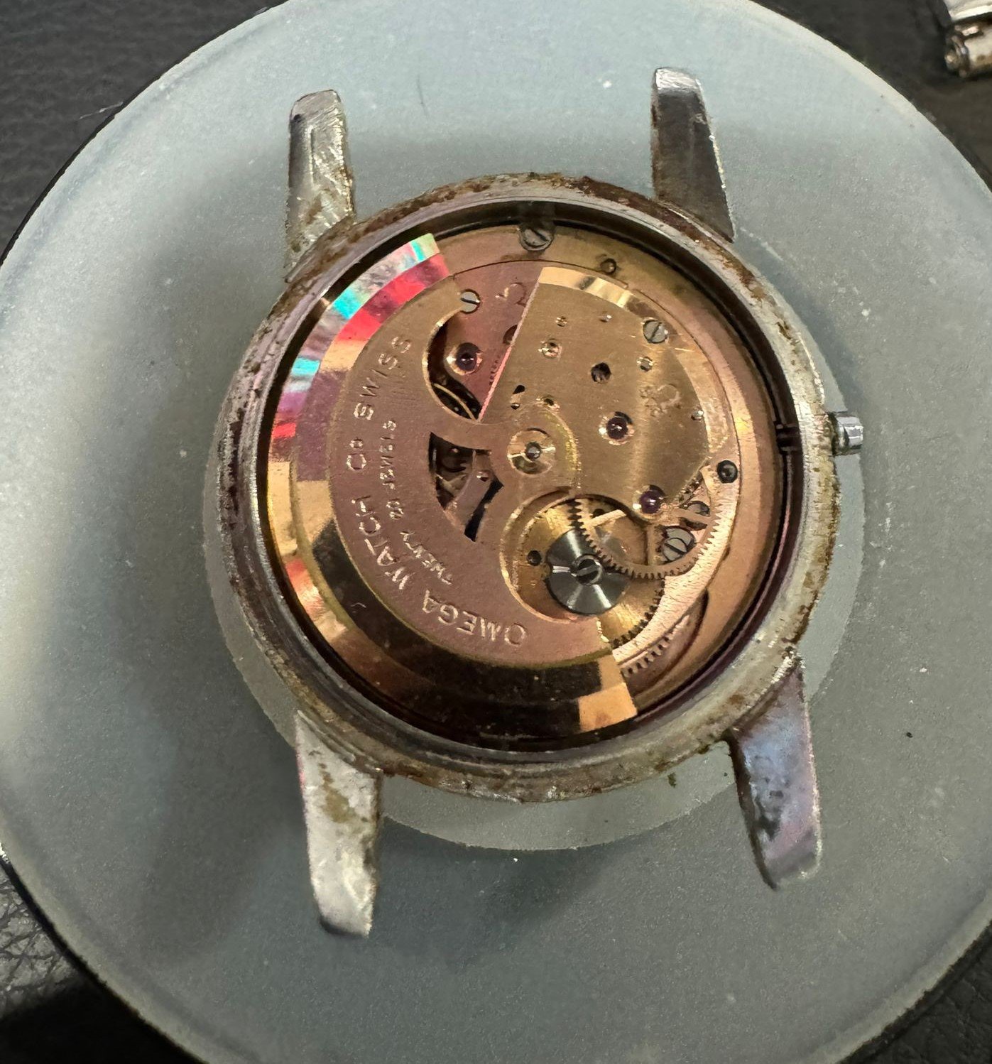

the mechanism is working which is fantastic from closer inspection the details i have are:

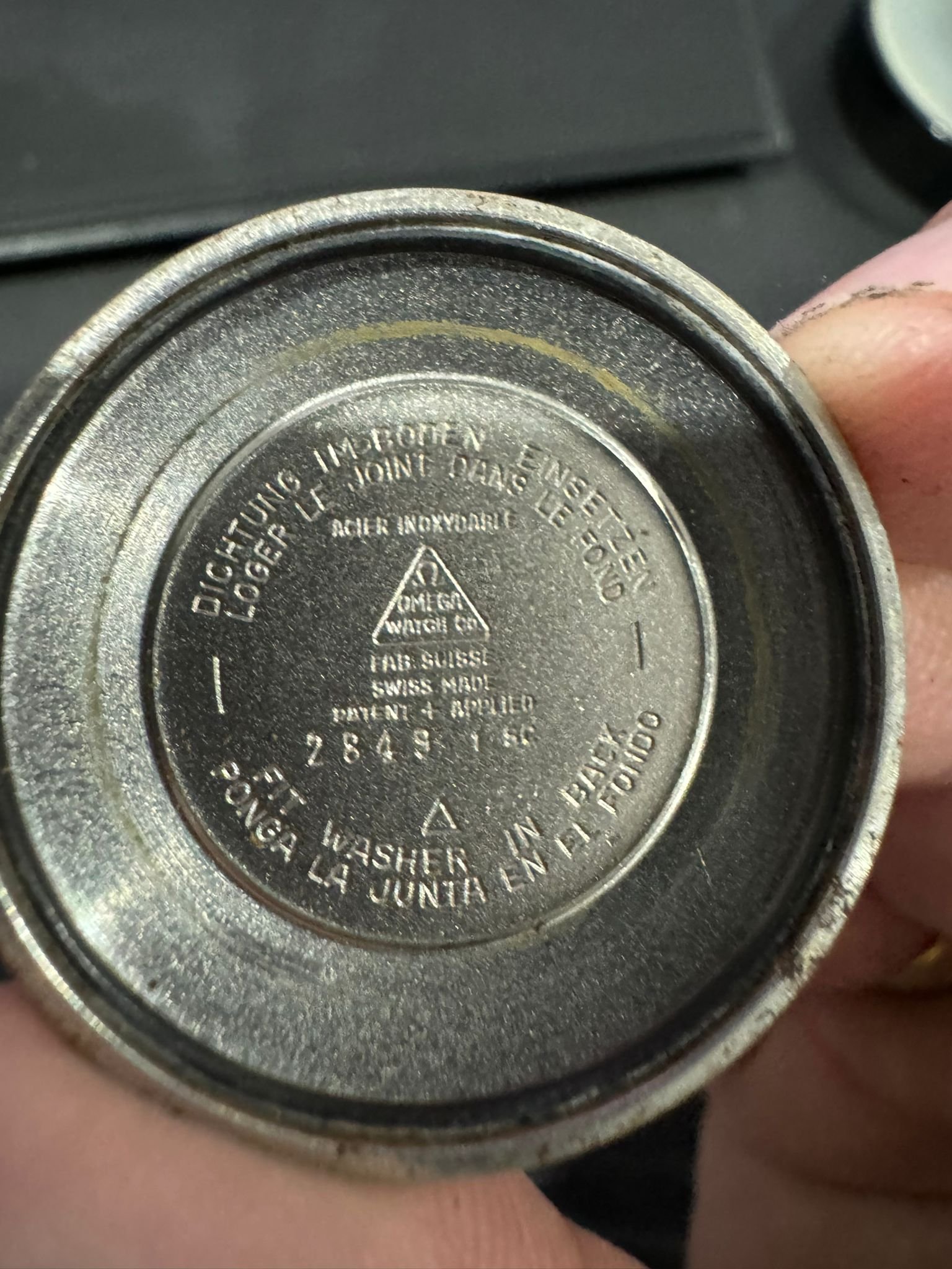

It is an Omega Seamaster 2849 1SC and the cal i saw on the mechanism was 503

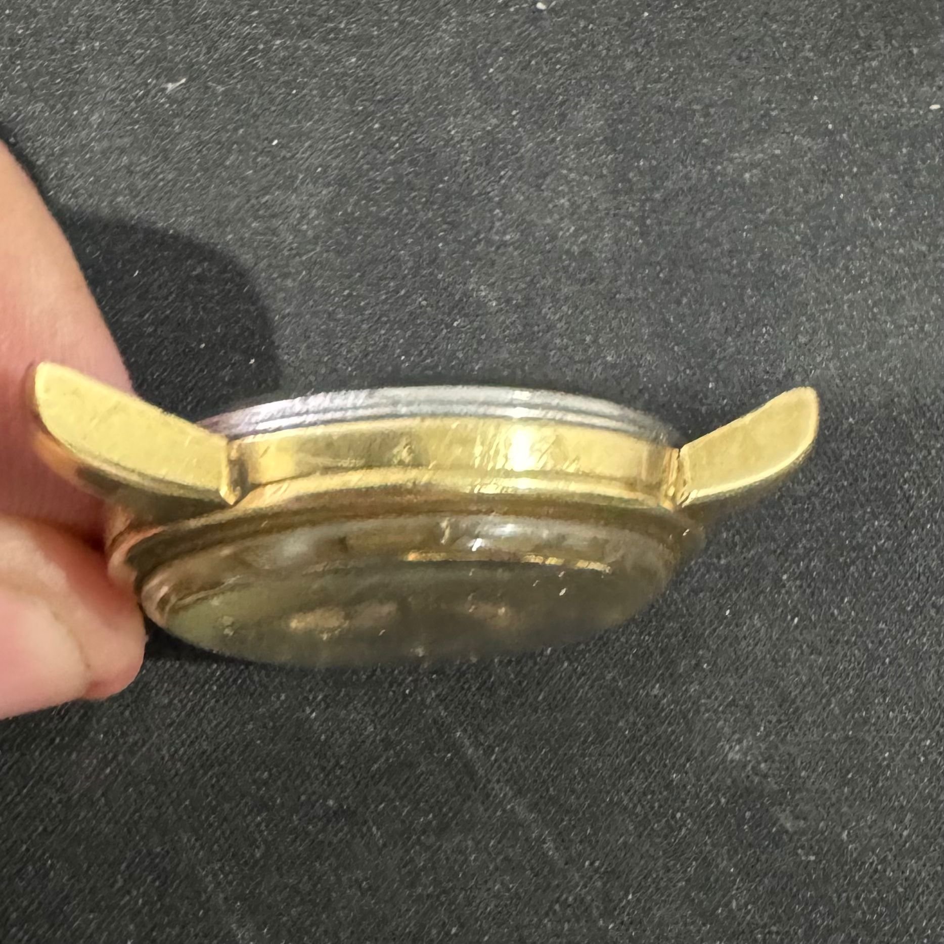

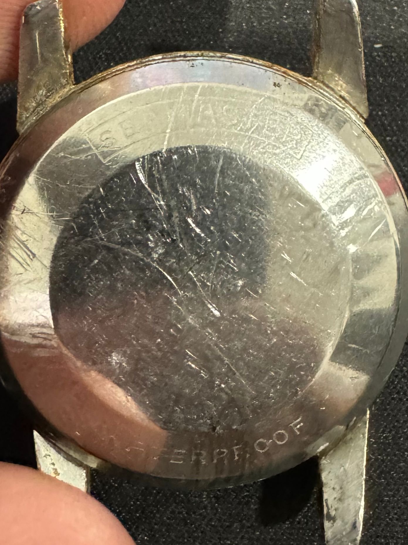

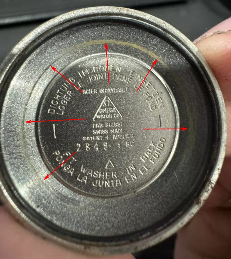

here are some images i took:

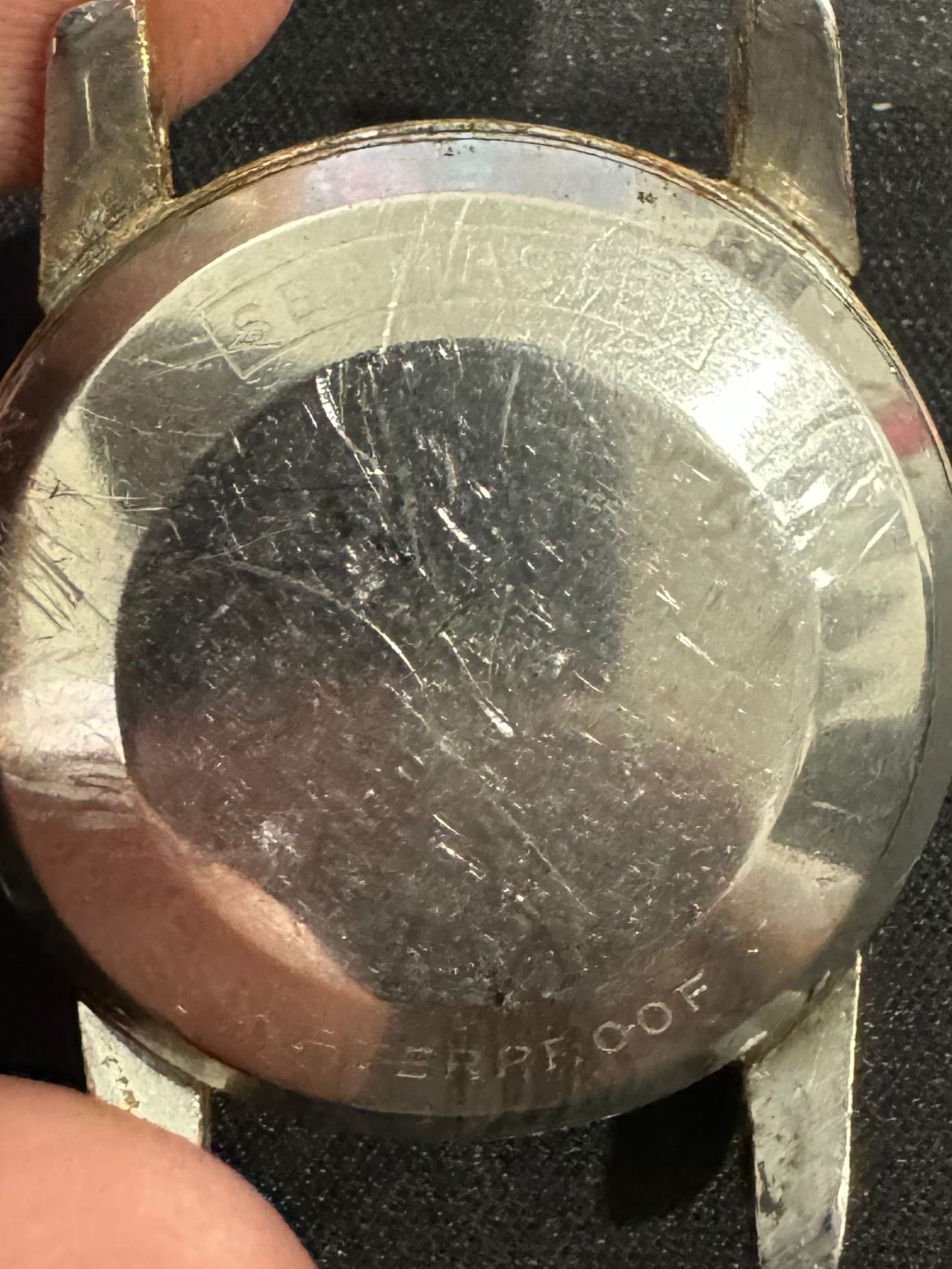

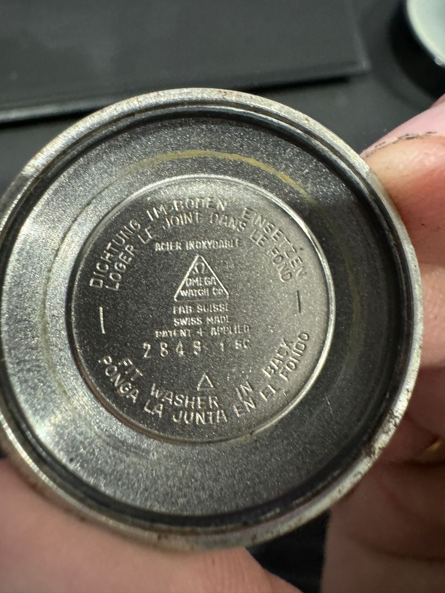

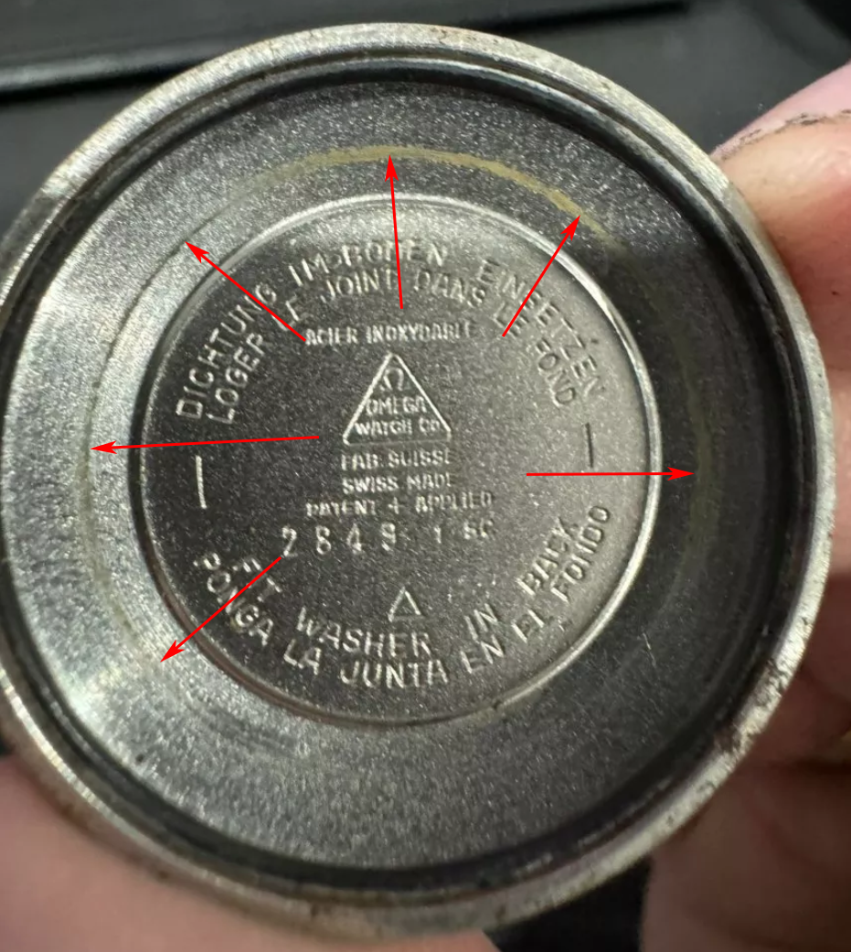

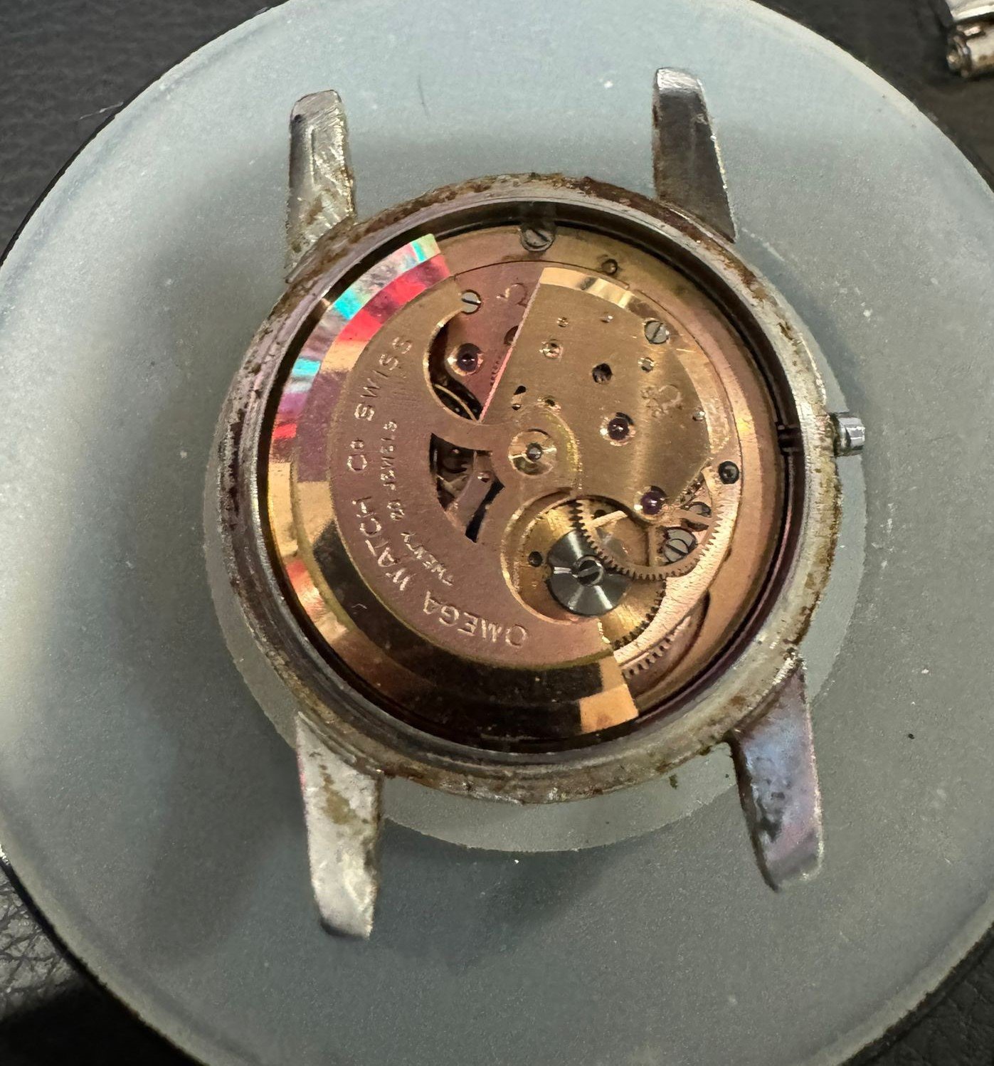

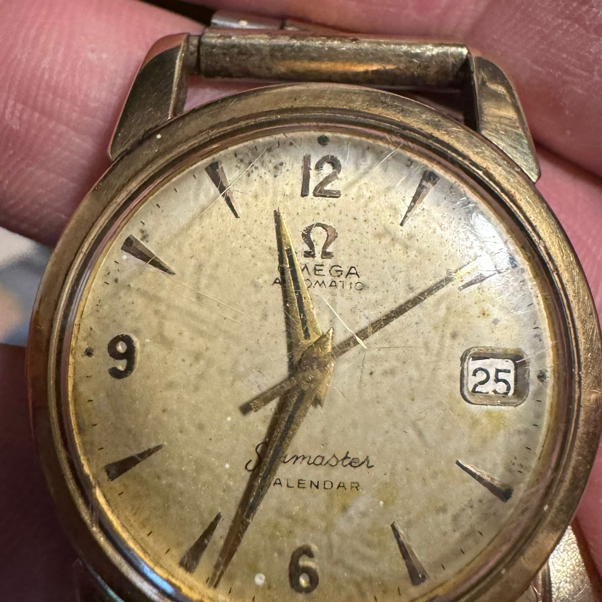

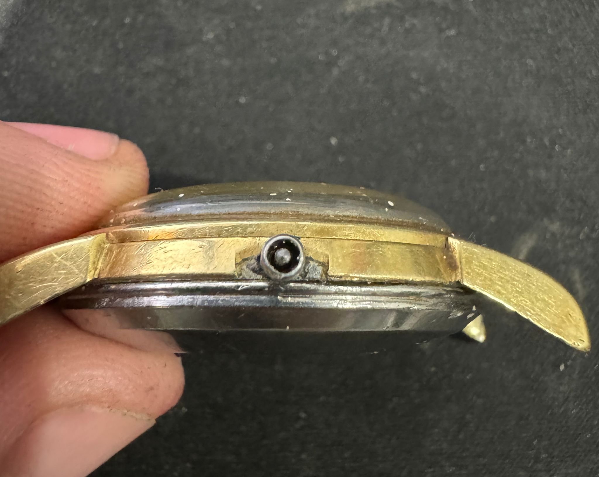

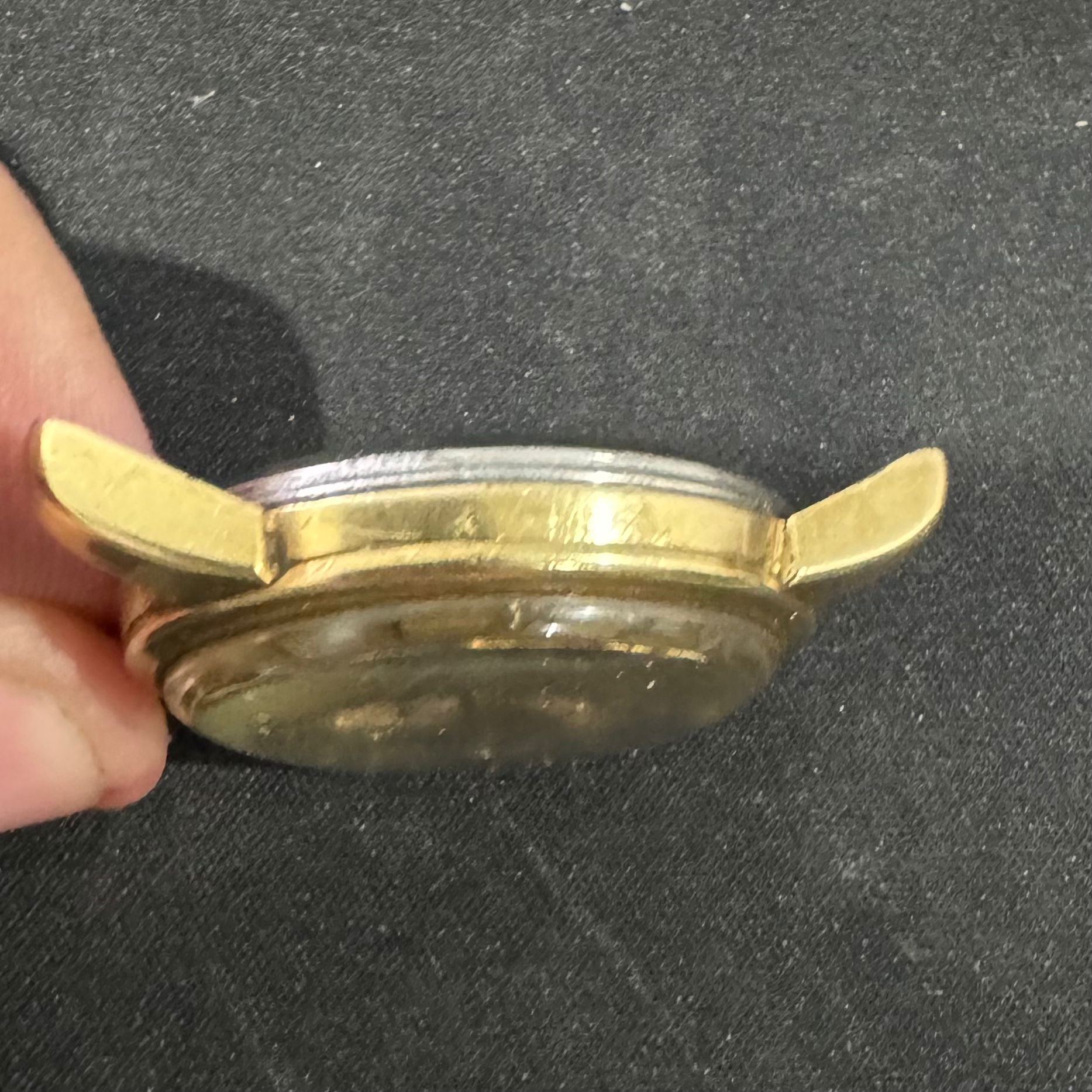

Hey and welcome to the forum. The model number is on the inside of the case back. The reference, or numbered code that it is referred to, is 2849. It is an Omega Seamaster from the around 1956 or so. To get an exact date of production we need the serial number of the watch. That is on the movement but in the picture you attached it is covered by the rotor (the thing that spins around and powers the watch.) The dial looks original. The crystal was replaced sometime in the past and its obviously missing the crown. With a service and new crystal it should look 100x better. The gold capping on the steel case has worn away in some spots. That is fixable as well but wont be cheap. There are a number of service options available especially if your willing to ship. Where are you located?

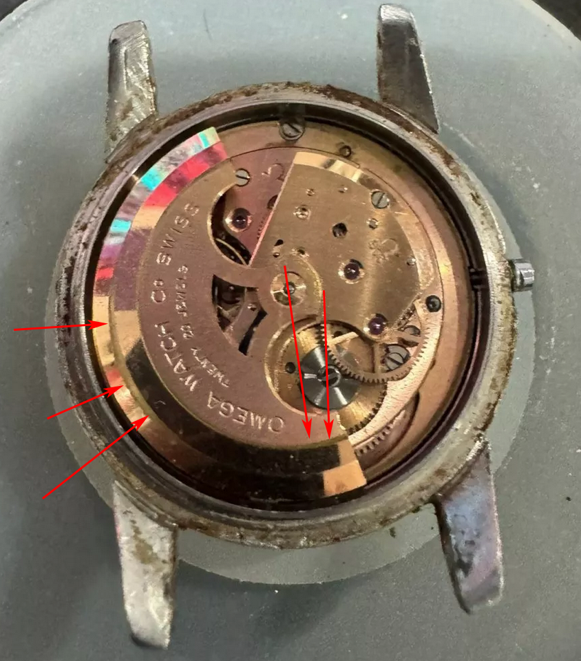

It is in desperate need of service and repair. The rotor is badly rubbing on the case back and appears to have been for years.

Wow thanks for that insight, i found the serial number it is in the 15 XXX XXX range im not sure if i am meant to post the exact serial number incase it's a unique number or can be duplicated (forgive me if i am wrong). This stuff has opened a whole new window of watch interest that is for sure.
Looking up that number, i learned the year is 1956.
Thank you 😀 and thank you for your help with this!
wow i would not of noticed that, I don't think my grandfather would have either.
after a service does that prevent the rubbing? i am still learning about mechanisms

Any proper watchmaker will resolve the rotar rub during a service. The post by Archer in this thread shows the repair:
https://omegaforums.net/threads/rotor-scratches-on-the-case-back-how-to-avoid-them.93322/
