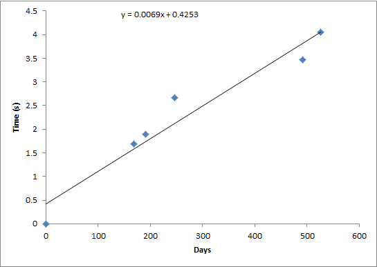

Update 2021: Long term performance
I've been taking measurements on occasional basis of my Polaris since I changed the battery in September 2019. The way I now do this is to take a video of the movement of the seconds hand use an iPhone with an app that overlays a precision timestamp. Here's a graph of the results. So over a period of 526 days the watch accumulated an error a smidgen over 4 seconds. This corresponds to 6.9 ms/day or 2.5 seconds/year.

Geeky, and amazing timekeeping. Your Polaris beats the pants of a Constellation Marine Chronometer operating perfectly within specs.
2,399
6,935
That's true, which shows that there was significant improvement in technology between the Marine Chronometer, which was probably the best of its day, circa 1974, and this Polaris (1988).
