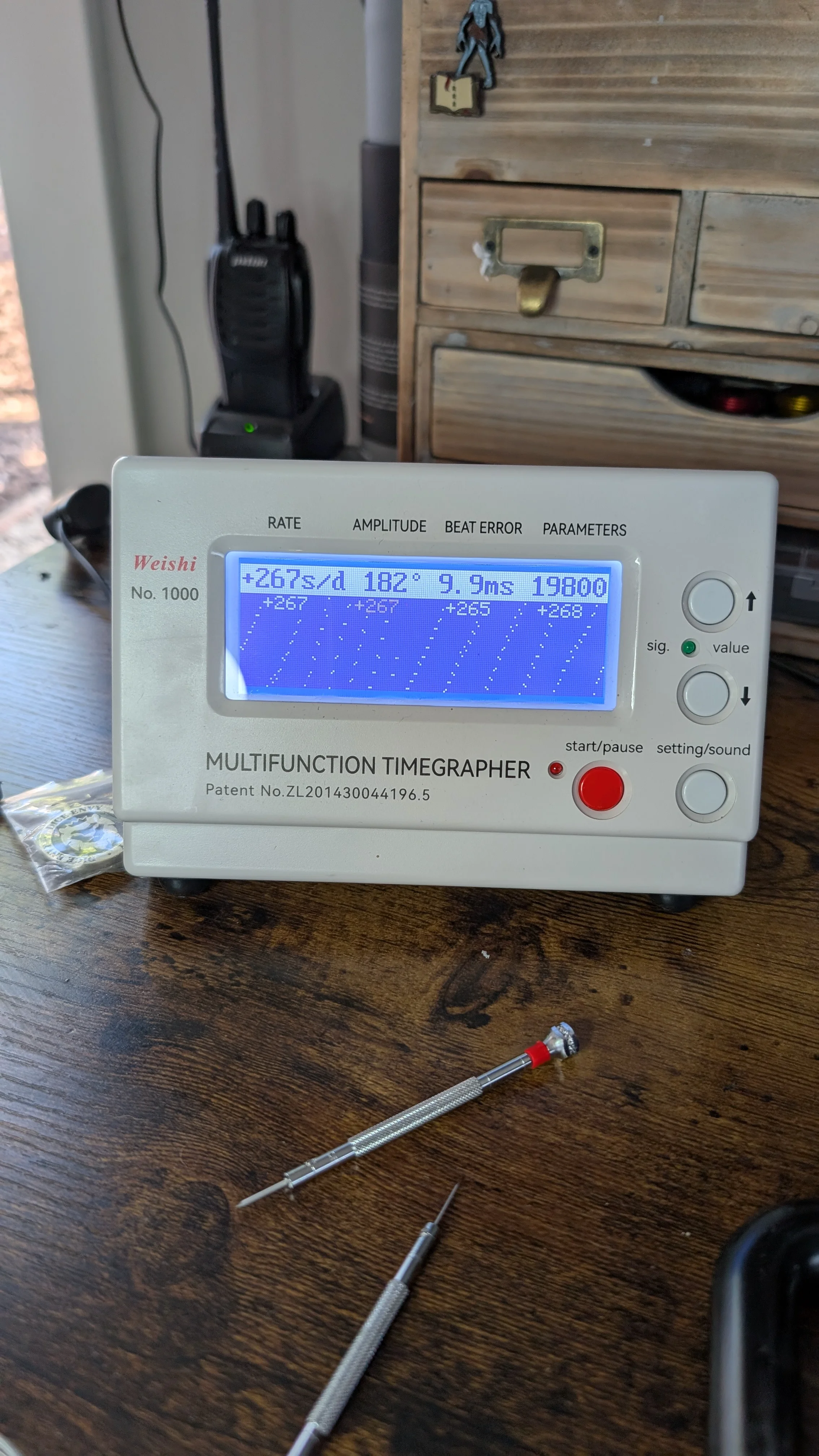

Ok. I've been fighting with 2 Omegas (552 and 565) both of which I have posted here. I just cannot seem to get the regulation part down. I can get the Beat Error Rater to near 0.0, but then it has low amp, or the +/- is +200 or -60. I can post a slew of videos and pictures I've taken (when i get home, at work currently), but I'm looking for any tips, or tricks, or videos/posts you all have used to get better at this process. I have slowly gotten a science down for how to speed it up, or slow it down, but there is zero middle ground. I'm about to take the watch apart (again) rewash everything and ensure I did over (or under) lube anything. It's not magnetized and everything is working seamlessly. New balances also, (that cost a pretty penny for 2 new balance and bridge). I very much am open to suggestions and thoughts.

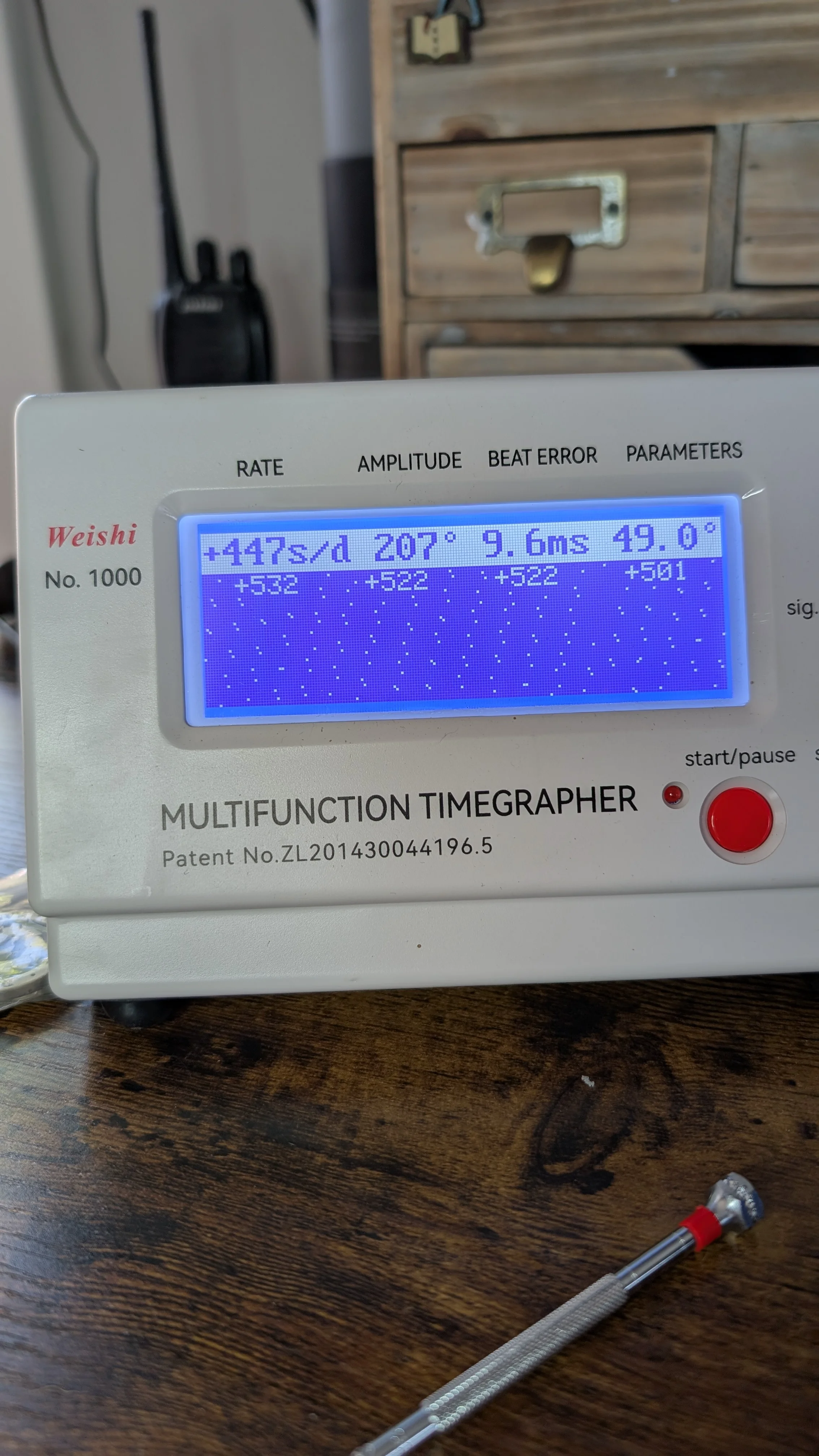

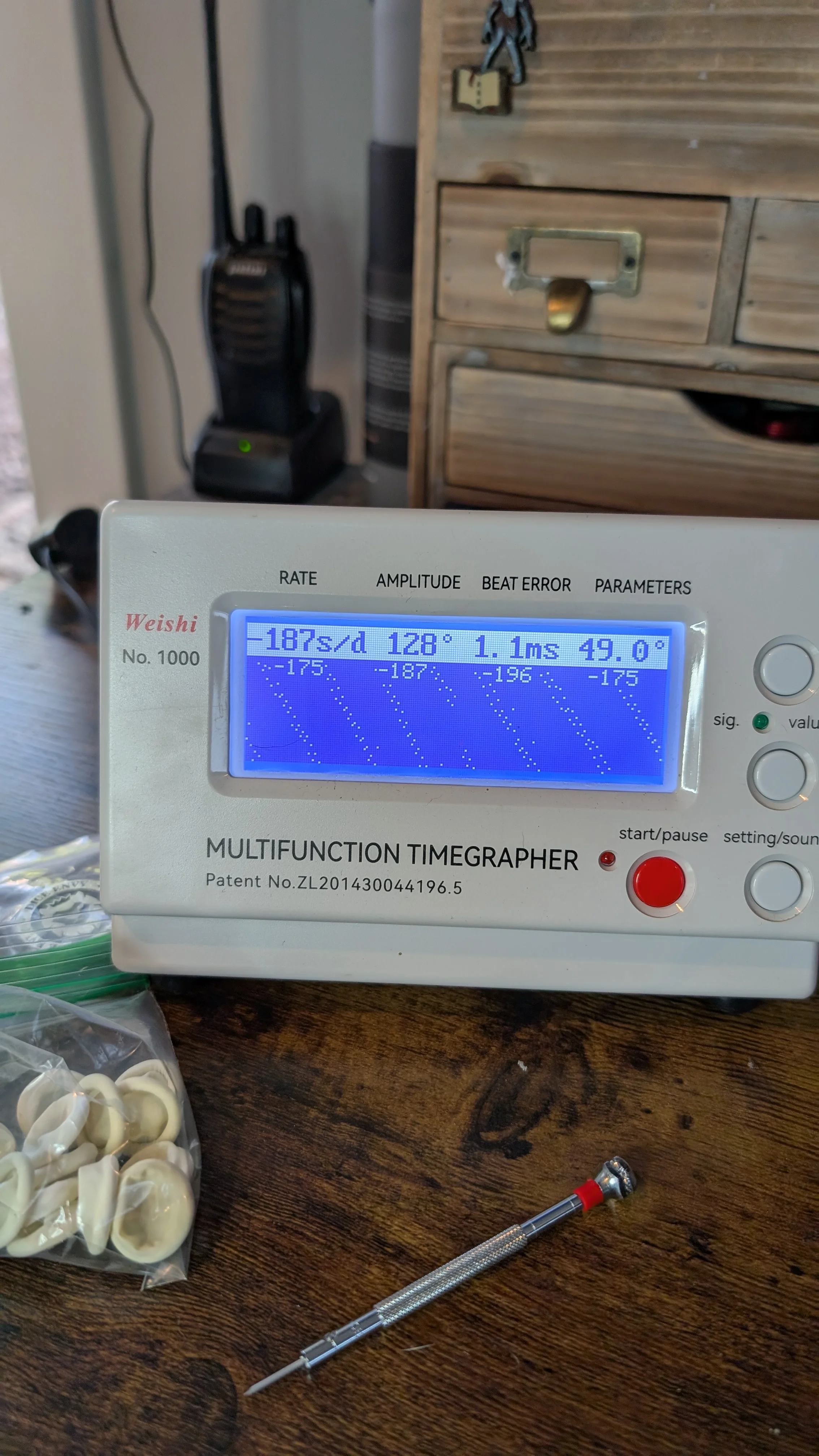

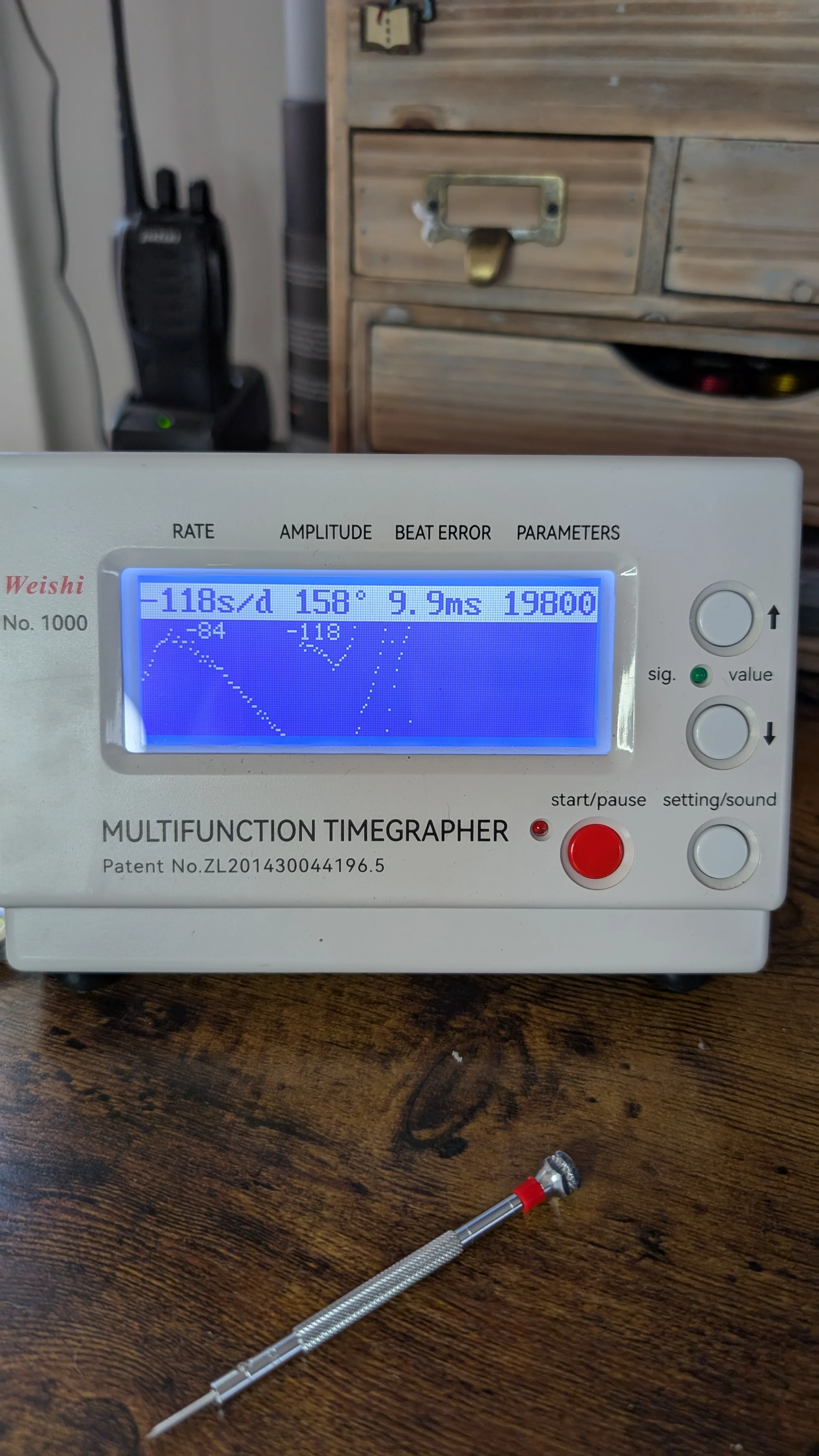

I shall watch all these. Also somone previously asked to see the numbers I get so I snapped a few pictures. Like I said I can get the best error down, but the amp is also low, and the +/- will be all over the place. I think I'll take it apart one more time. Be even more meticulous, and try again. I don't mind it, it's what I chose to do! 😂

With such erratic results on the Timegrapher, you should be able to visually identify problems with the watch. The Timegrapher will tell you when you get it right, but it won’t help you troubleshoot the problem(s)!

I have identified how to slow and speed it up if the timegrapher shows + too much or - too much, I'm just trying to figure out the best way to be methodical about adjusting. Like a good starting point or best practices. I'll watch the above threads and videos and go from there. Appreciate the input!

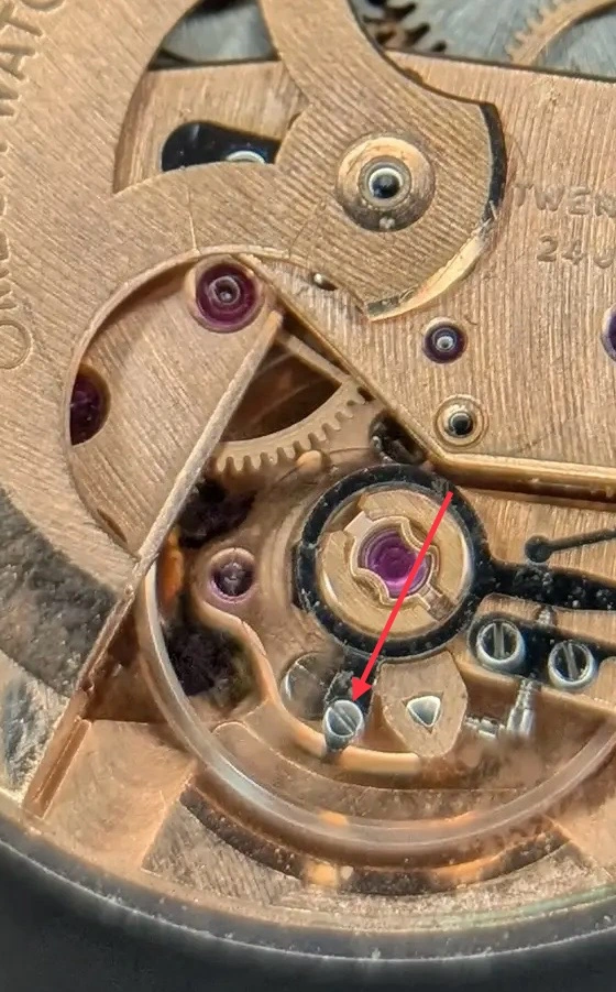

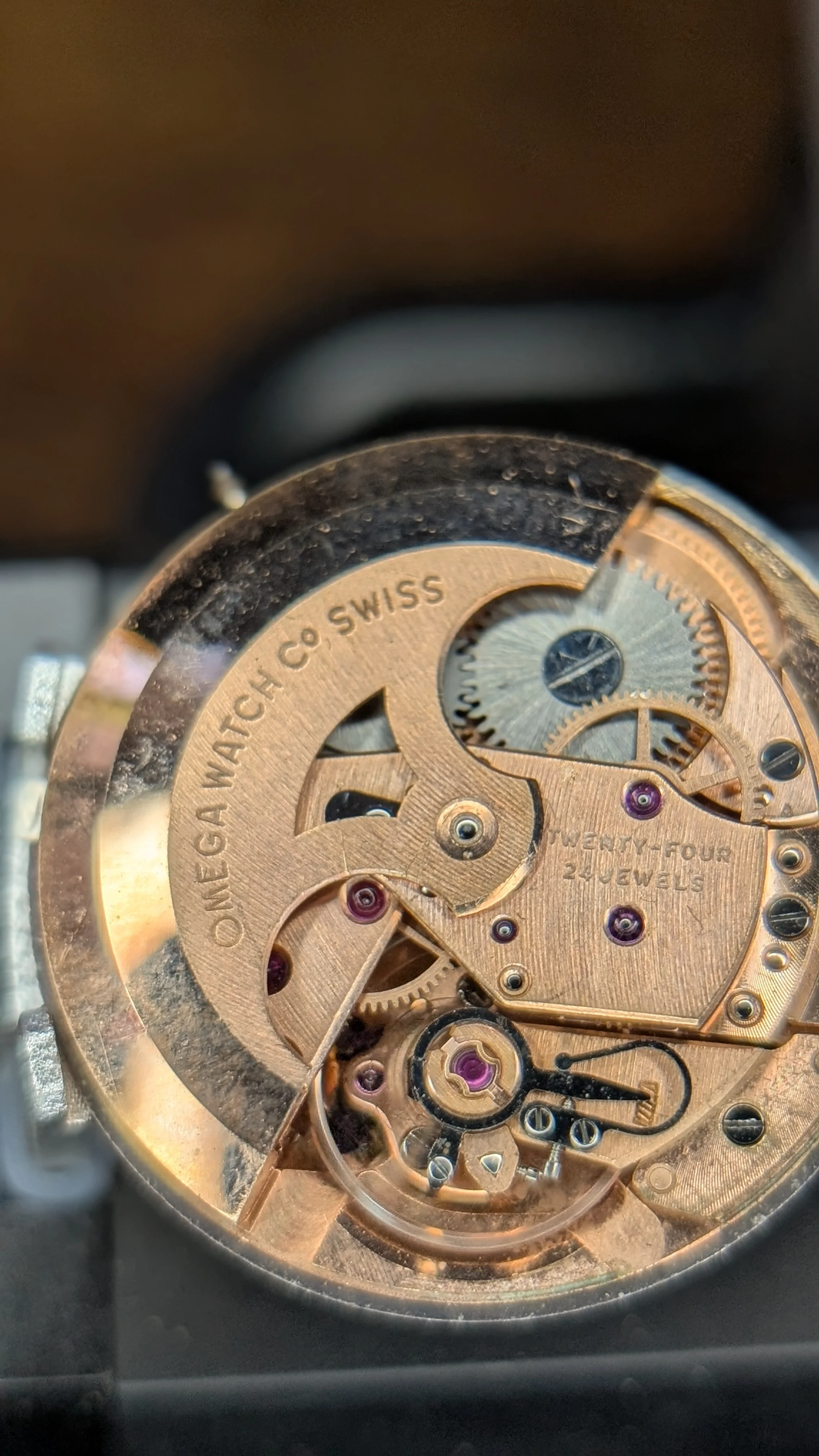

The hairspring is seriously distorted. Waaaaay off centre. My suggestion (since you are unable to see this problem), is that you really need help from someone who can troubleshoot this, and adjust it. What is this seemingly extraneous screw (see arrow) doing there?

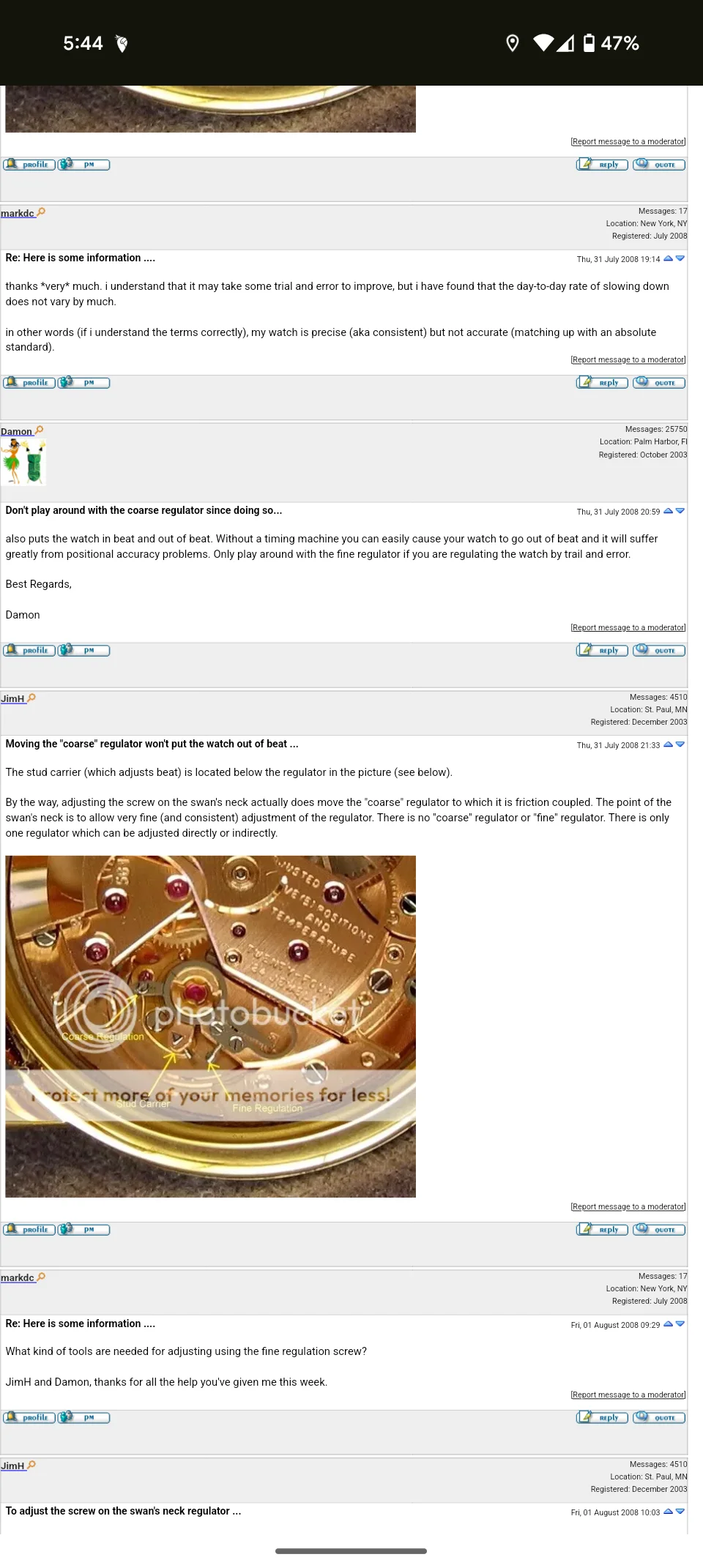

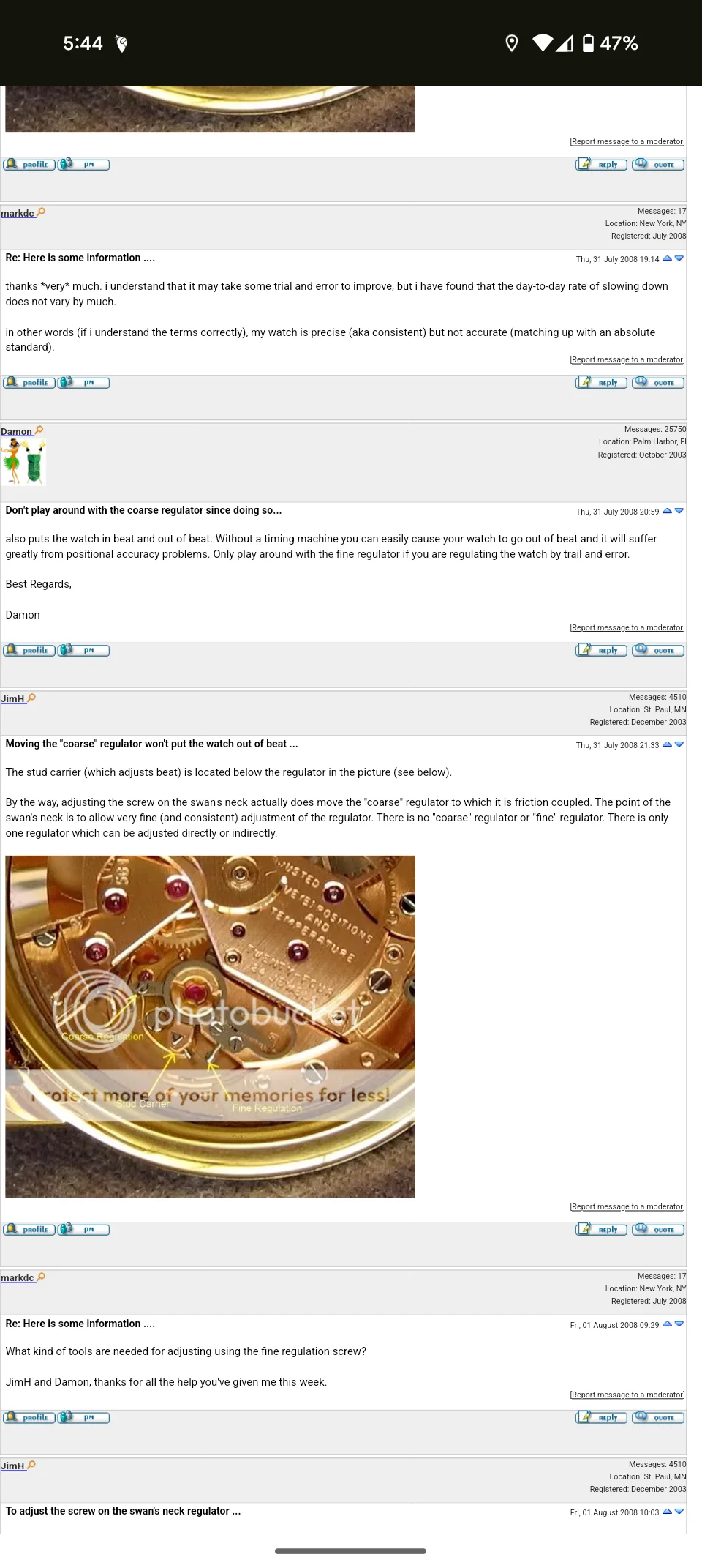

That's the screw that holds the mainspring. And that level is course hairspring adjustment.
https://forums.timezone.com/index.php?t=msg&goto=3888233&rid=0
So while I agree I need help, I'm not 100% I don't see the problem. There's 3 points of adjustment. Course adjustment which moves around the balance, the stud carrier which can also move to lengthen and shortened and the fine adjustment. So I manipulate one, let it sit, and go from there to adjust or know what to adjust next. I used the course adjustment all the way to the stud carrier as a starting point. Now am I really missing something or do I have a basic understanding? I haven't had time to watch all the videos and read the articles, ergo why I'm explaining how I understand it.

That screw holds the mainspring? You are unable to discern that the hairspring is seriously distorted? I seriously doubt that the kind of help you need can be found here! Sorry!

Sorry, misspoke, hairspring. Let me look and read the forums recommended above and the videos, I find it a little insulting you took an obvious typo and decided I am beyond help. But to each their own. Thanks anyway!

That screw is on the regulator gate, on the tail of the regulator. The regulator portion of the two-piece regulator/stud carrier is on the slow side as far as it will go! That, plus the stud carrier is so far over that it is almost interfering with the micrometer adjusting screw of the regulator. The hairspring is badly out of poise, and waaay off centre! Yet you are unable to see these things! You don’t seem to realize that you should stop where you are, and seek help! Truth often hurts!

If I stop, I won't learn. So hence, I'll say again, going to read all the articles and videos suggested and keep learning. I appreciate your input.
