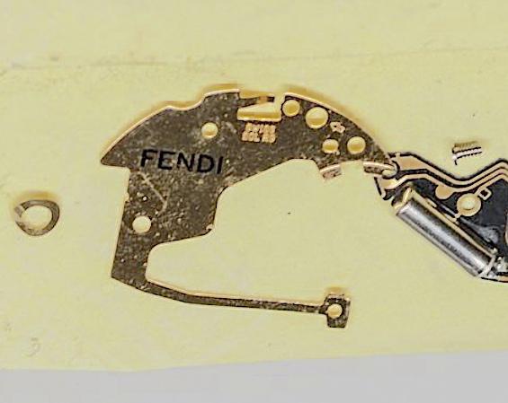

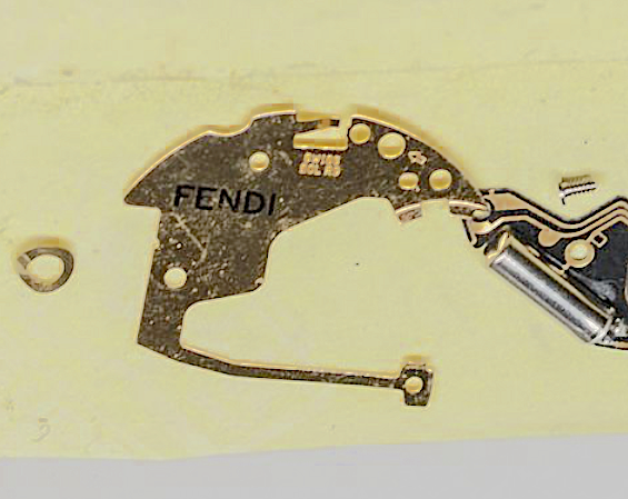

Is that a Ronda 705 in a watch that retails for over $2K?
Welcome to the world of luxury watches...
Yes, probably. But it is stamped FENDI, so it's an "in-house" movement.
馃槈
So it's ....a bespoke watch? Golly!
