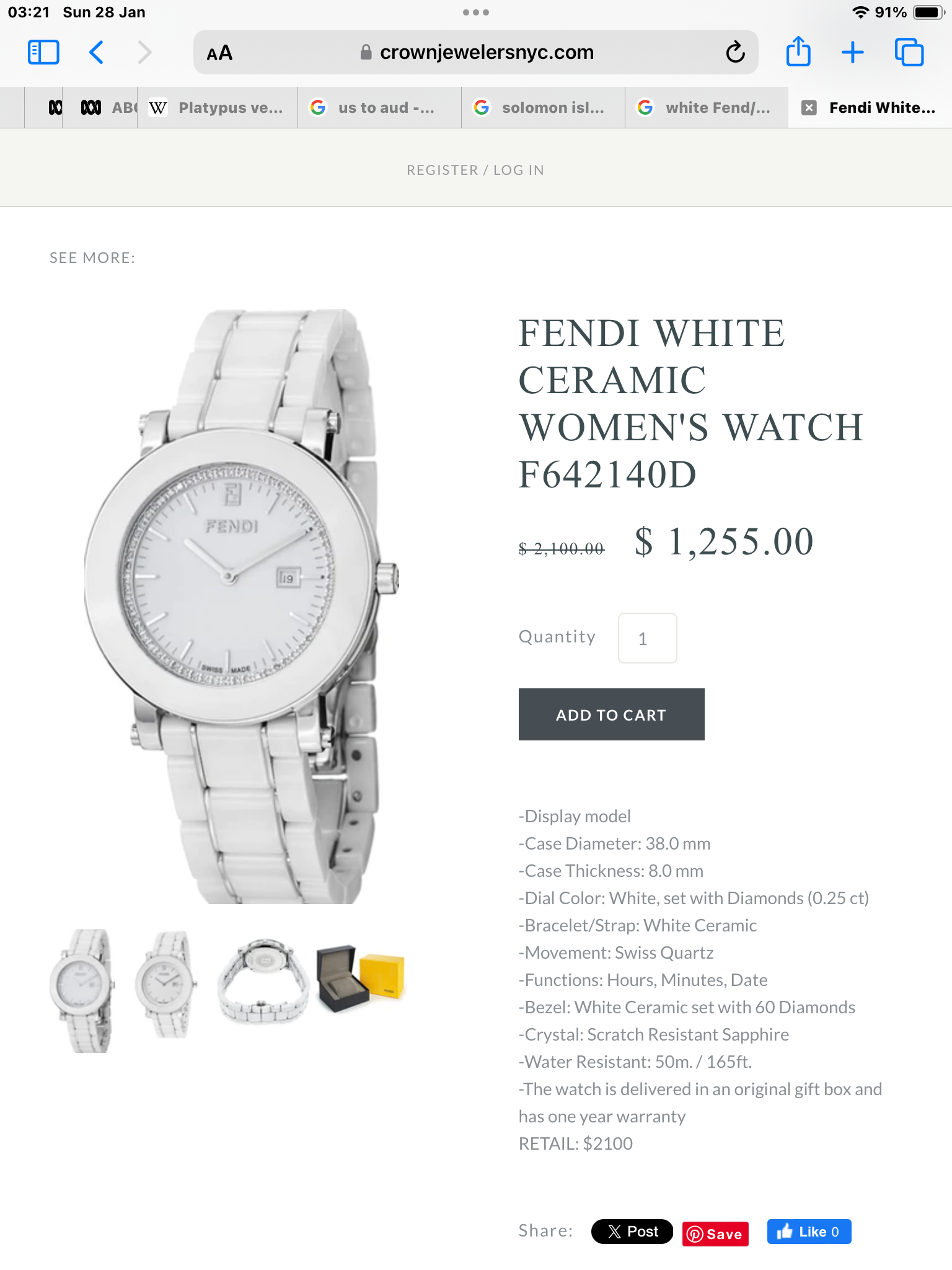

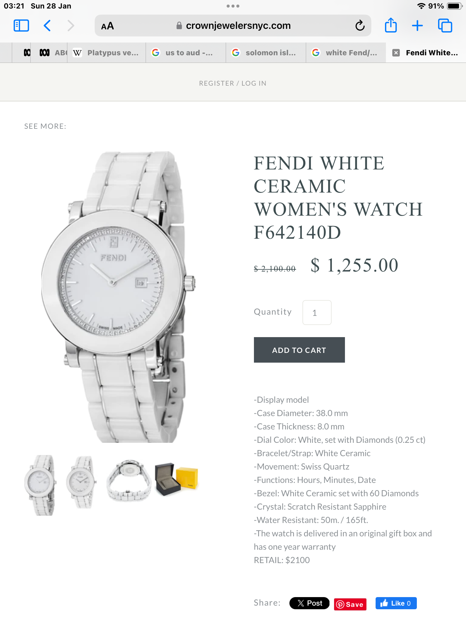

Is that a Ronda 705 in a watch that retails for over $2K?
18,847
39,197
Yes, probably. But it is stamped FENDI, so it's an "in-house" movement.
2,781
4,707
The fact that they stamped Fendi on doesn’t mean it’s an in house movement…..it means it’s an in shithouse movement!
