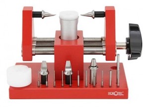

If it's a 196.0301 it has a snap on or press on caseback.
It doesn't have a split stem, you can't pull the stem and pop it off with air.
You need to look around the edge of the caseback for a very small gap, usually opposite the crown if it's been installed the right way.
If it hasn't't been put back on in the correct orientation previously the gap may be in a different position and hard to see.
Ideally you need either:
A proper caseback tool to remove it.
Or a competent watchmaker.

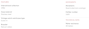

Although............
The Omega Vintage Database indicates a screw in caseback. But it's possible they've confused the bracelet ring with the caseback (the OVDB isn't always accurate).
It would help a lot if you had a photo of the caseback.

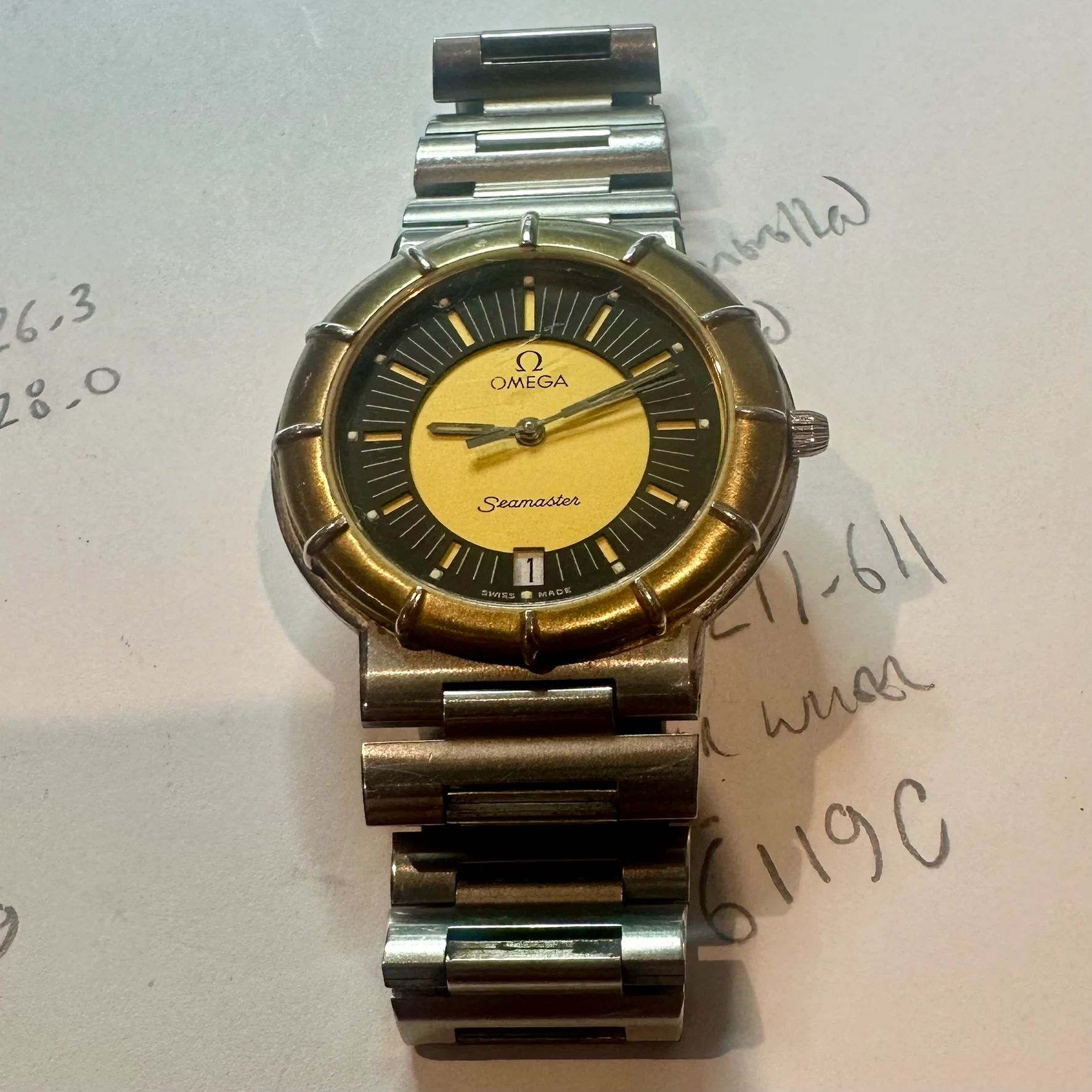

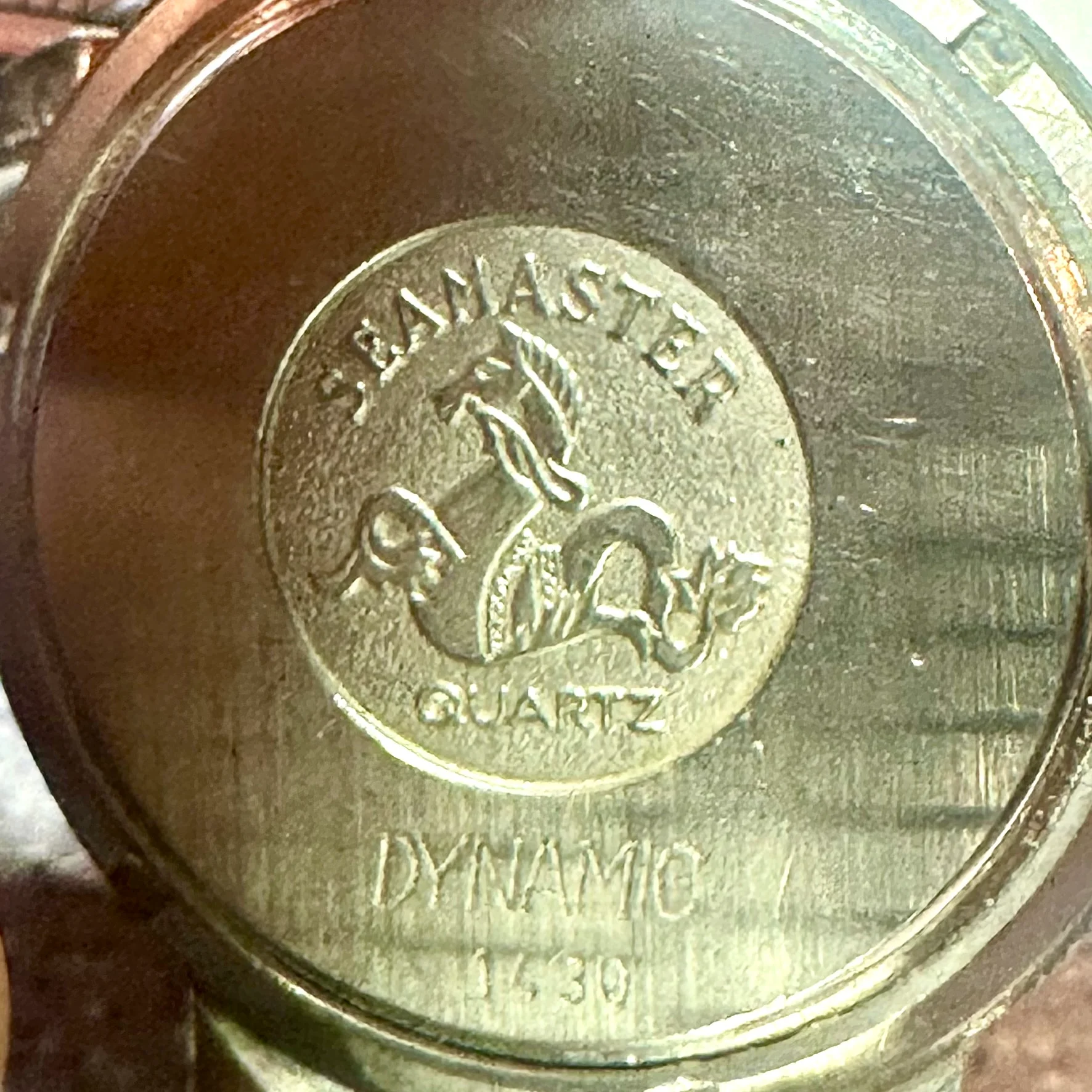

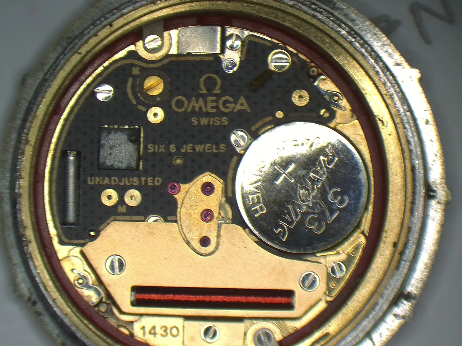

To revive an old thread in case it is useful to someone, and it will be in future as I have just spent a couple of hours trying to find the info... I have just changed the battery in a friends one of these and can confirm it is a pop off CB with the tab almost invisible directly under the 1430 text on the CB, so at the 6 o'clock position.
