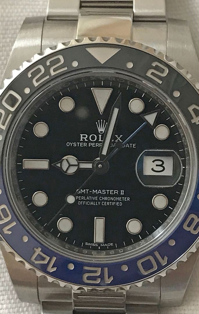

B. Central/Main Hands Alignment: using crown, place hour hand at the precise middle of a 3, 6, 9, or 12 indices and then note whether the minute hand is correspondingly in the precise middle of the 12 indices
thieving a photo from @Archer of a watch with significantly misaligned hands, in order to better explain/emphasize this particular point
