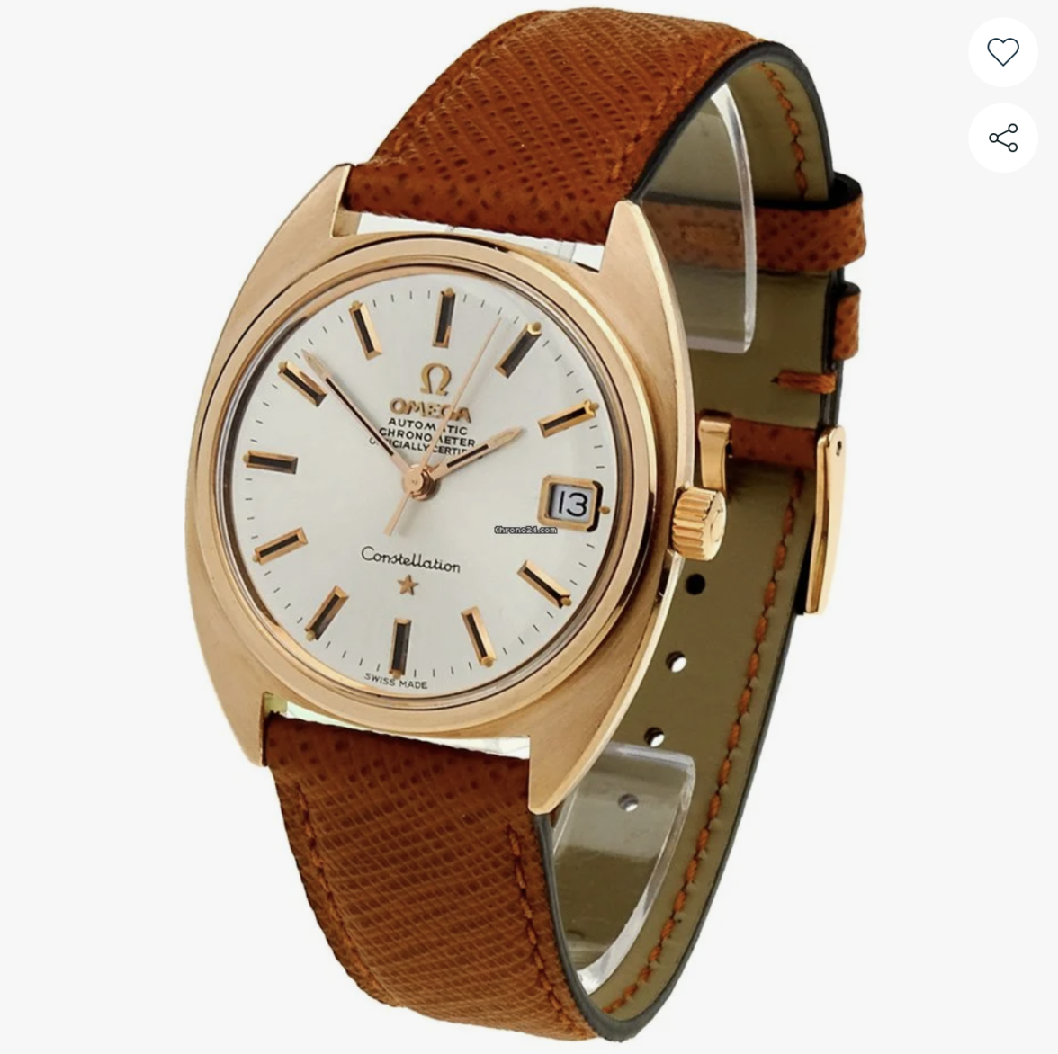

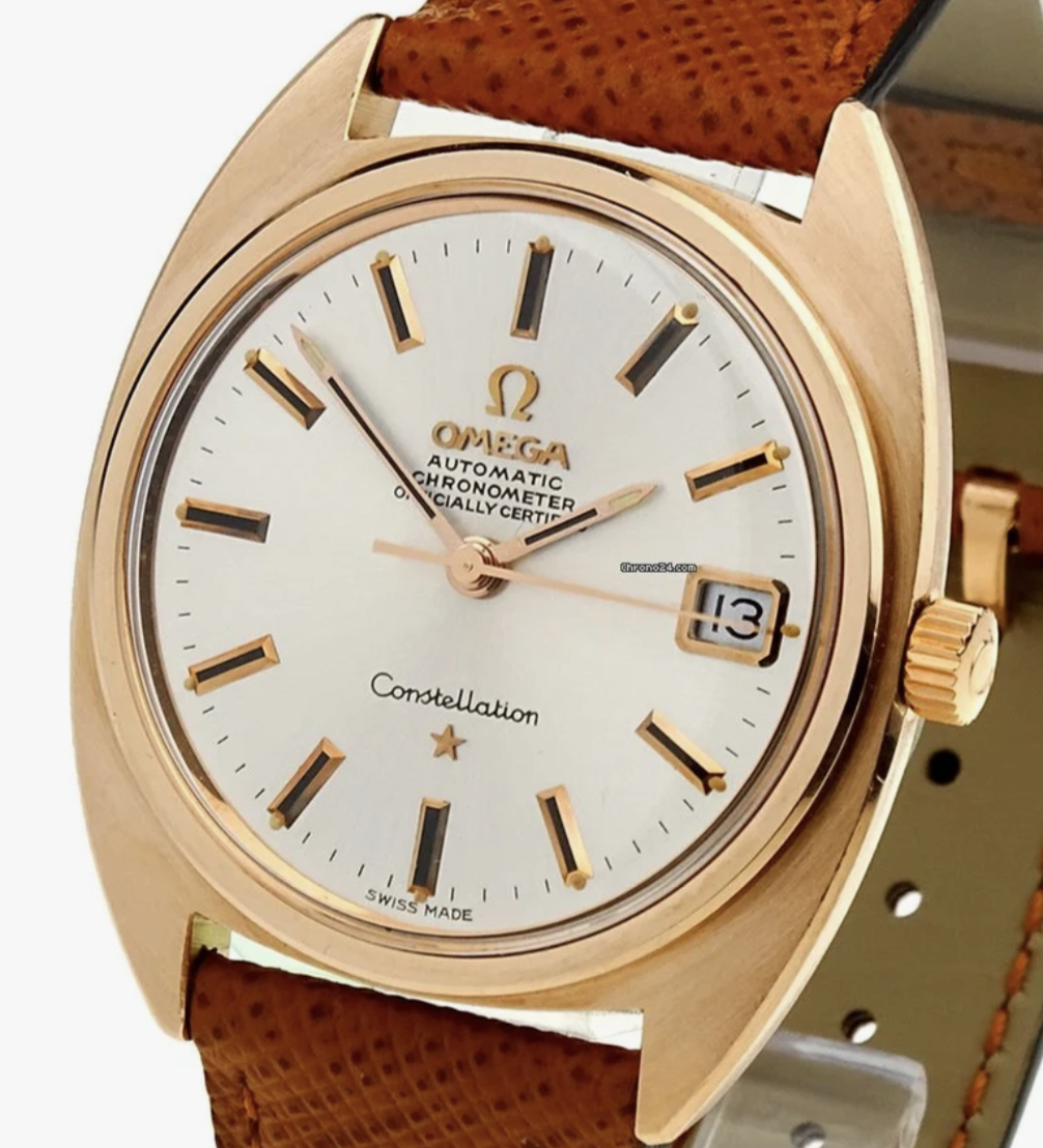

T's are a hit or miss, from the lume pips the dial looks legit to me, it also matches the good state of the case
Maybe it's a replacement dial along with that replacement crown, but doesn't really matter much, it's a good vintage dial
I'm not in a state where I make very logical decisions lately; Overall it's a nice watch with no issues, it'd be extremely shocking if that dial is a redial

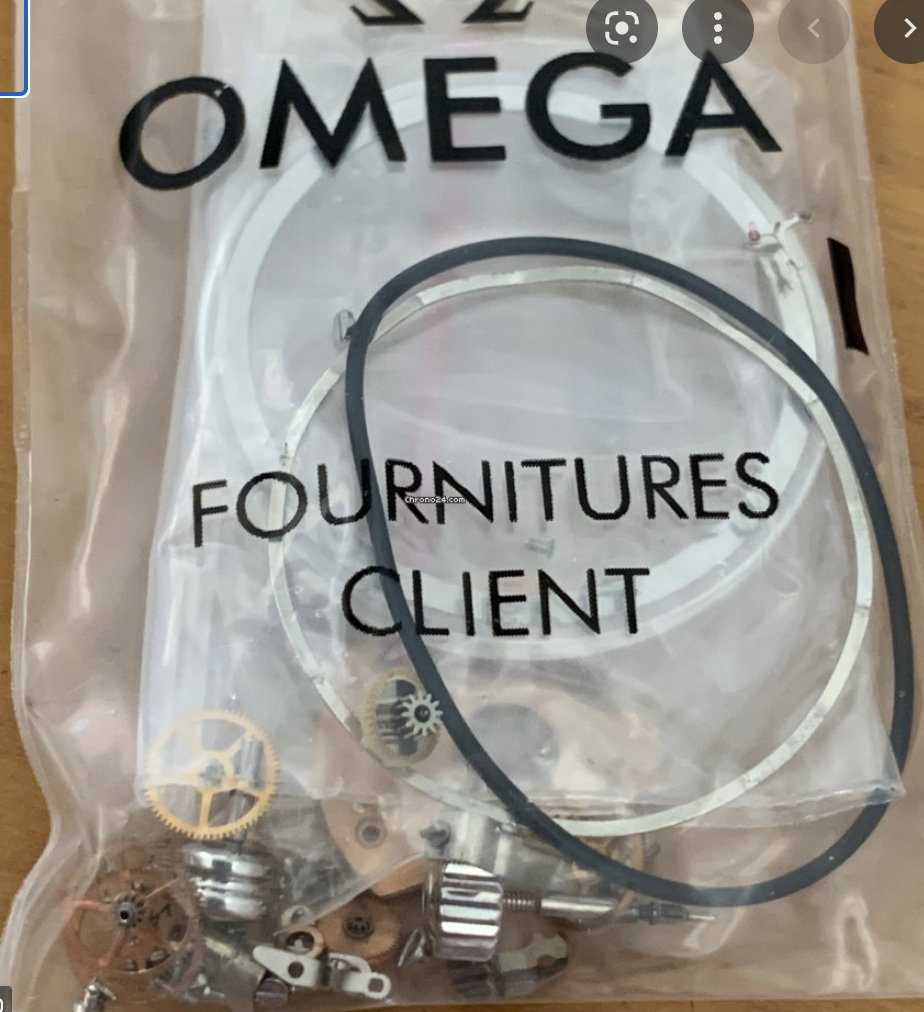

One small suggestion is asking for this pack:
They spent all that money only to replace the original crown and putting a dent in the collectability

This is a very pristine example and it's been on my Watchlist for quite some time as well, since it's a rose gold it makes the watch very rare, hard to find them in this condition
But at the same time it's just a collectors watch in my opinion, it's too expensive to wear, it's too expensive even to collect, from a collectors perspective it's better to passively buy watches of this nature from eBay for 1/3 of the price
@mmurran
Being pink gold cap, this watch is definitely uncommon ( I think there may be only one in the c-case thread) and it makes for a handsome watch.
The dial is a bit busy for my liking but whilst the heavy printing, the straight Ns, the lack of Ts and the non-existent MOY alignment are all signs to be cautious, given that c-case dials are generally all over the place, it could well be all-correct.
Personally, I don't hold with a watch being too good or too expensive to wear - watches are meant to be worn - pink gold cap c-cases aren't common but neither are they that precious that you should leave them at home.
Being picky, I'm not sure this watch is pristine - the edge facets look a little too wide and would have originally been mirror polished (and should shine like the edge of the bezel)
That is not to say it is in poor condition - far from it, as I said, it's a handsome watch
If a c-case is what you're after, £1750 (not 2950) for a very clean, uncommon watch, recently serviced by Omega, is not that far out of the ballpark from a dealer.
The service receipt has the movt. serial number (30,284,282) and it should have the movt calibre - this would be good enough for me (if it says cal 564)

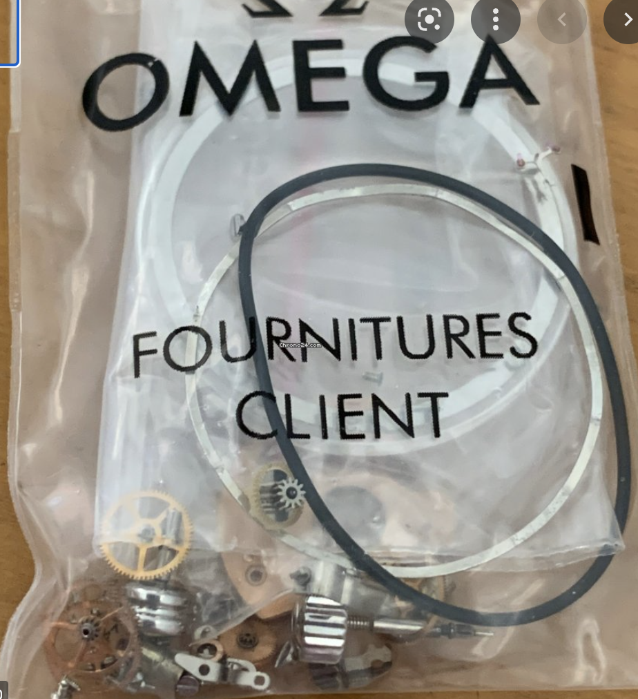

Excuse my ignorance but am I looking at a bag of original parts removed during the service process and returned along with the watch?
If so, I guess some solace that you have them and could potentially restore the collectability ?

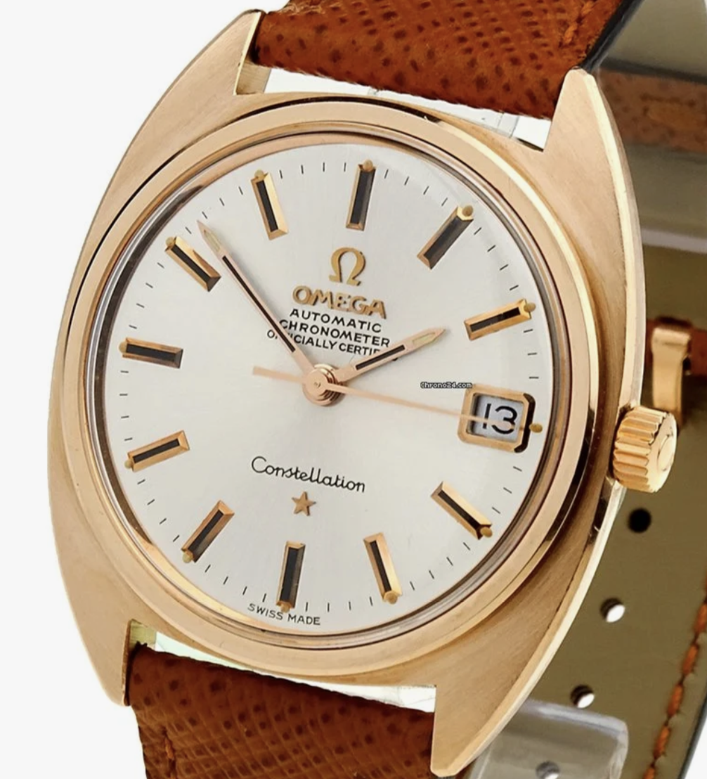

Hope that helps
