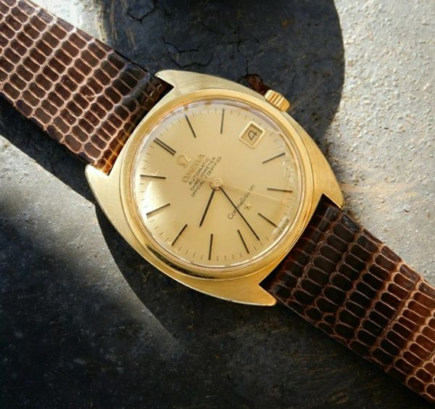

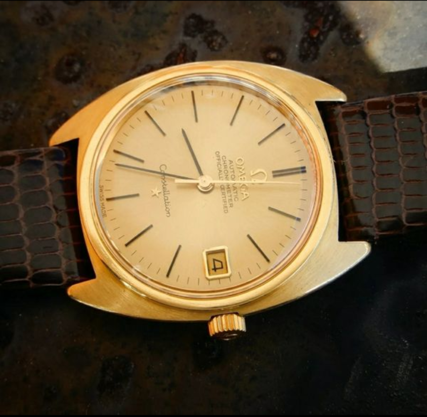

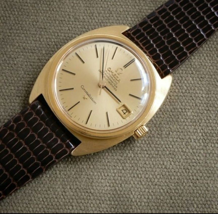

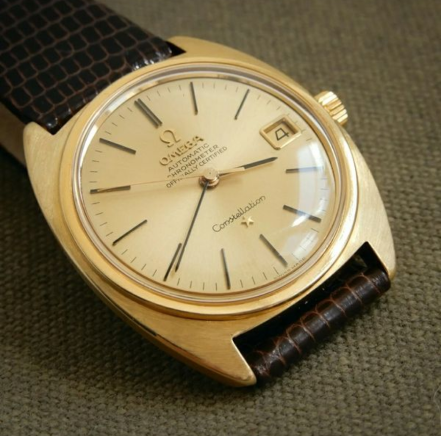

Hi

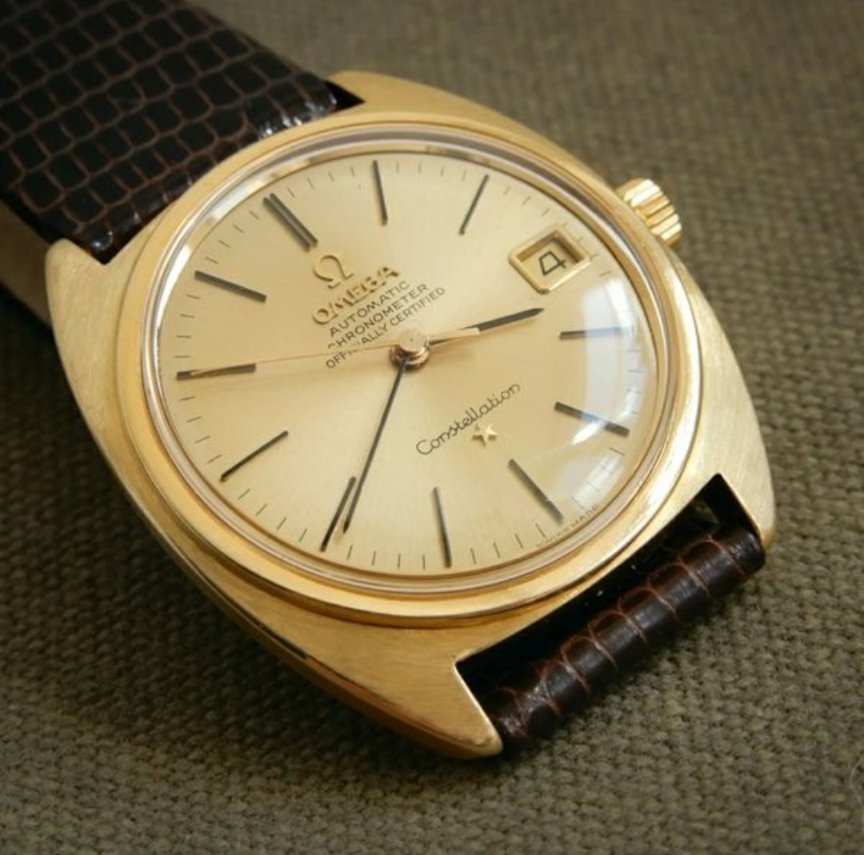

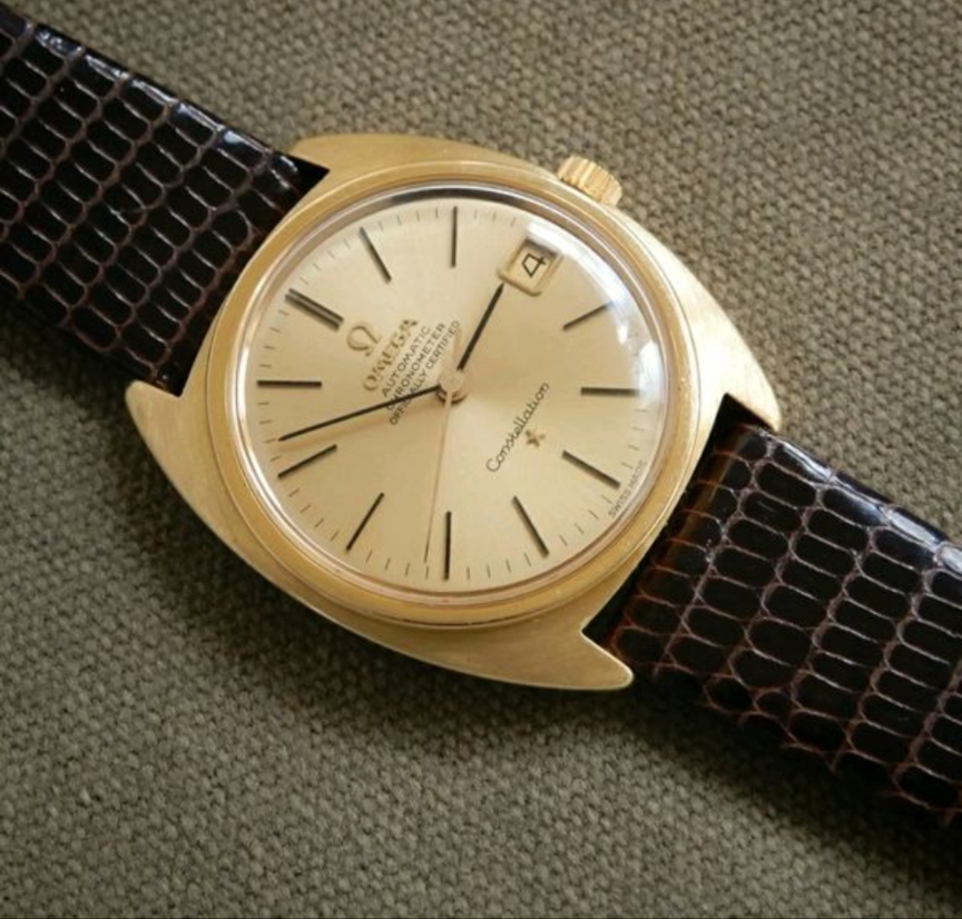

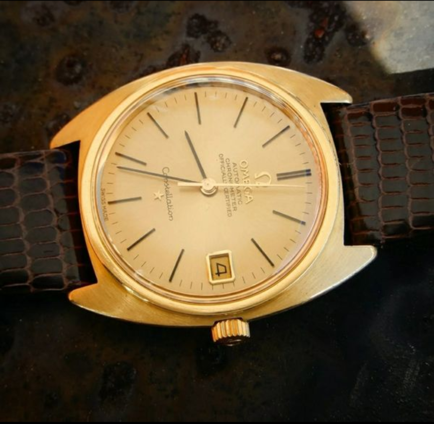

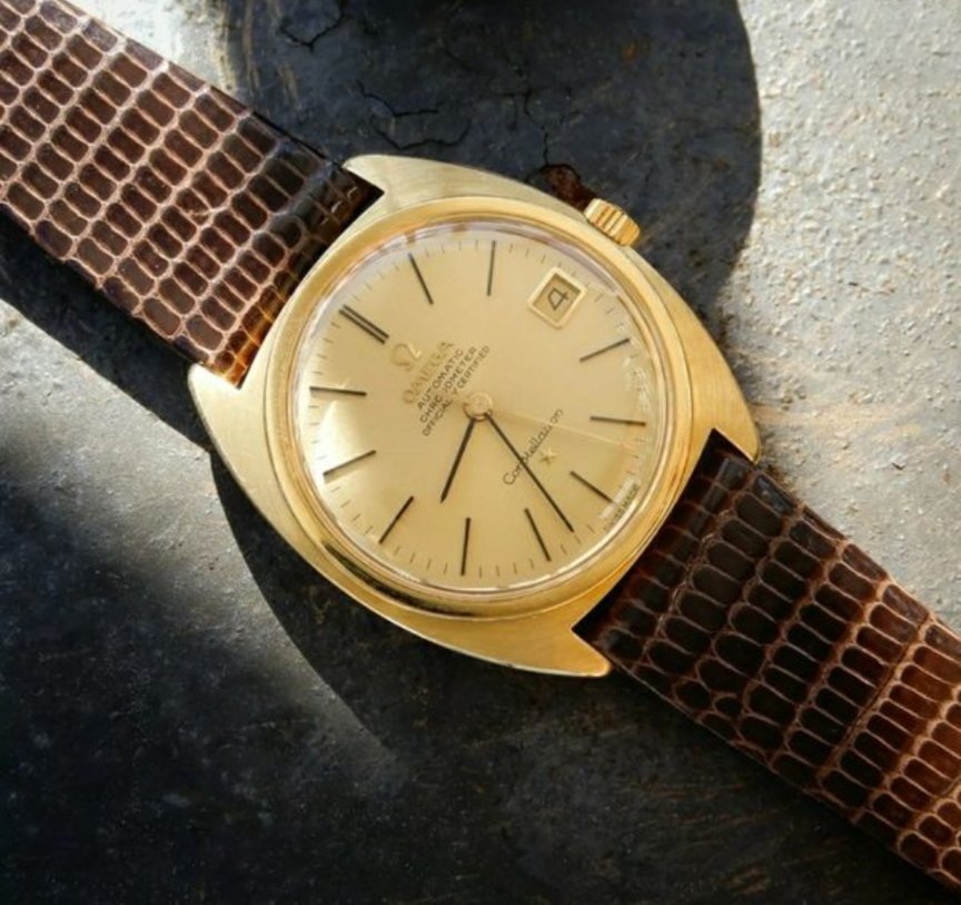

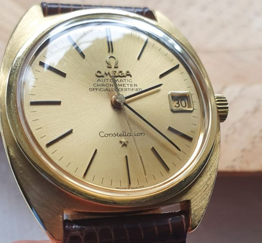

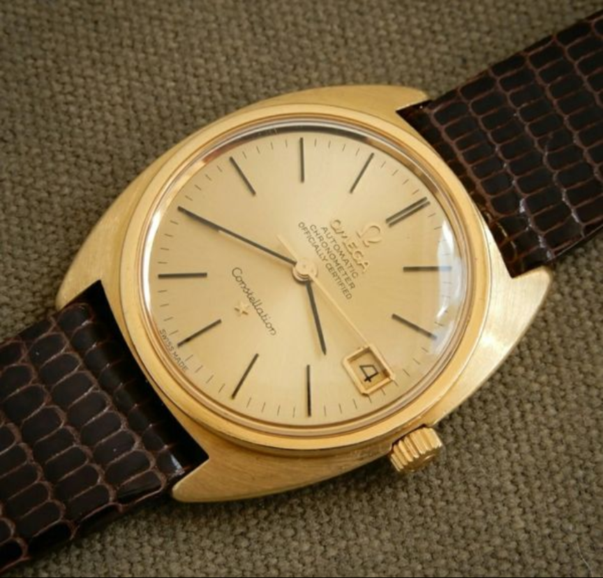

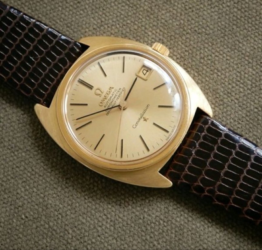

New to the forum and omegas. Have an opportunity to purchase to this 1966 Constellation for circa €3k and would like to pick the collective brains of the forum members.
Very clean example and serial number checks out. Not 100% on the dial. I see some 18k examples have OM on dail, though maybe only french versions and whether the batons are the correct (Onyx inlaid). Also not sure if the bezel would have been polished or the coin style as I have seen on a lot of Constellations. Also can't seem to confirm whether crown is original to watch though omega stamped.
Thanks I'm advance!

Welcome @mmurran
not all 18k constellations are ‘de luxe’ and have gold dials.
IIRC This c-case is called ‘jet line’
The dial looks correct.
The case has seen some polishing - the edge facets are slightly soft and the bezel is rounded.
The case may have been ‘Re-grained’ as the graining looks heavy.
Our resident c-case obsessive @kaplan will no doubt give you some greater insights.

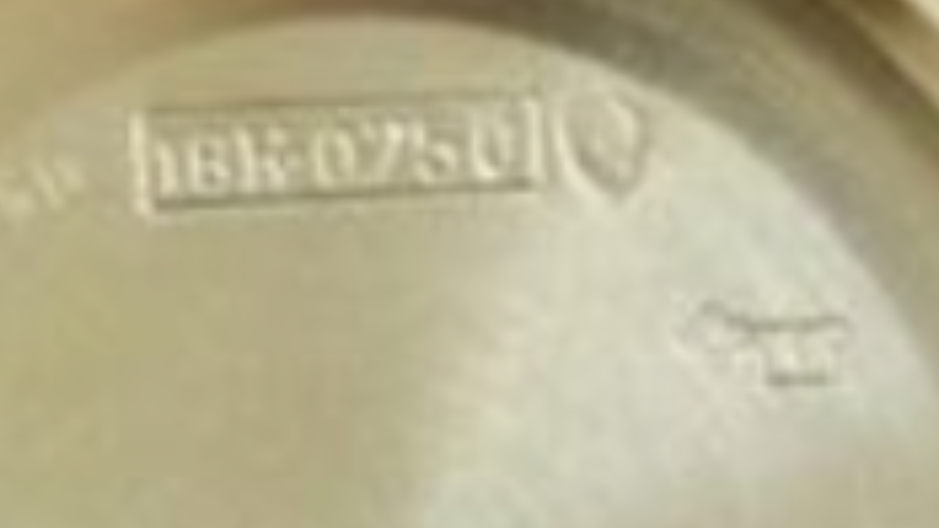

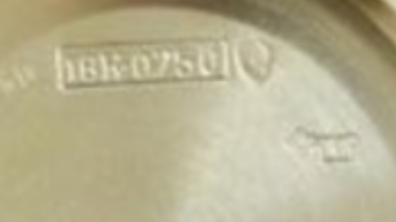

Question: how do you know its 18k gold? I can't make out any hallmarks on the back. I'm trying to learn this stuff.

Hi ! Seems to be a nice watch .. but so expensive .. no?
635
2,629
Agree with above. 3k is quite steep for C-shaped connie in my opinion.
326
1,246
Not worth 3k, could be bought for 2.4k or even less.

Thanks all for your replies so far. Exactly the kind of discussion I was hoping spark.
Working my way through Desmond's useful essays at the moment (do you know if he or anyone else have compiled these?). They are such a fantastic resource, as is this forum!

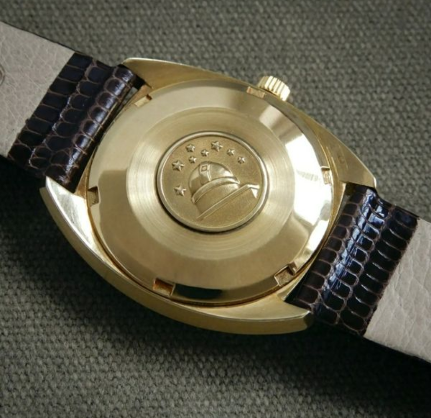

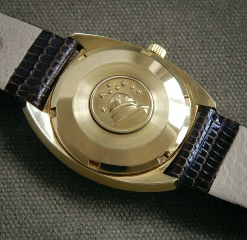

On further reflection the observatory on the case back is missing the brick work and given how defined the stars are this would suggest this
hasn't just been polished out over time.
I think this might be a case of back to the drawing board...

I think @Peemacgee covered it all
Only some later/modern solid gold C-Case's have the coin bezels, and it's a different pattern than the fine steel ones, or knurled ones, it's a in between pattern - TL;DR: The bezel is ok, it should be flat for this year
The dial is a special dial, if you look at the Omega logo, it doesn't have flat feet, it rather has curved feet, and I don't recall seeing OM on early dials, they are normally solid gold inside solid gold watches, there's really no consistency though, and no guarantee that someone didn't swap it
Basically anything goes with C-Case's, and 1966 to 1967 was a very hyper paced year, so the crown could be original as well, a side photo would tell whether it's a newer C-Case crown that could make it into the case, or just a regular Omega crown
The only thing you have to worry about is the edges as @Peemacgee pointed out, the watch was probably worn and the edges were naturally rounded, and it looks refinished, not really a bad thing, looks good, but you might want to request a photo of the side edges, they need to be shiny
Caseback looks good as well
The price is high for the current market, you might not find this specific model fast, but it's possible to pay 30% less for a solid gold C-Case, it's a very good time to buy one, good luck

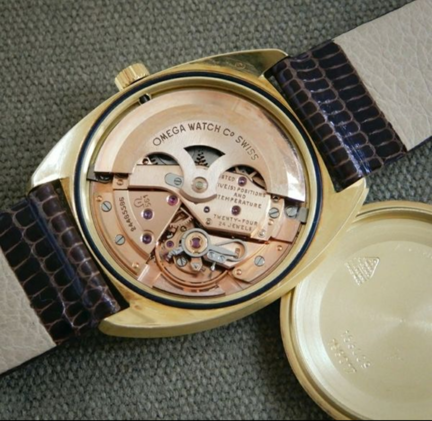

Here lies the problem though. There are no photos of the internals for the watch so I cannot check calibre and case numbers to verify authenticity. The jewellers have said that they cannot open the case back without voiding the Omega warranty.
For what it's worth it seems like a very clean example and the jewellers appear like a well-run legitimate outfit. However I do not think I can justify a purchase without doing full due diligence and can't seem to think of a way around this.

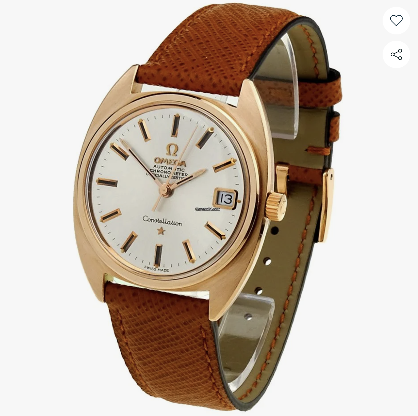

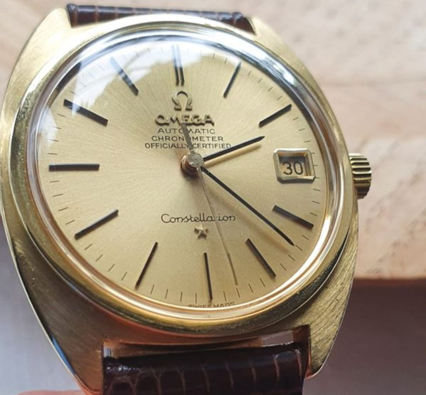

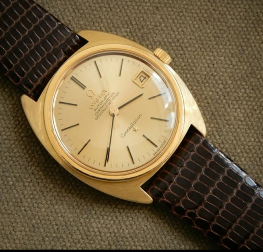

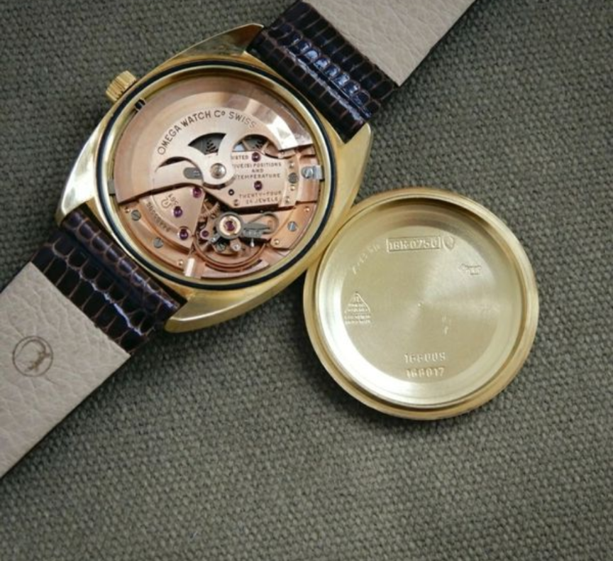

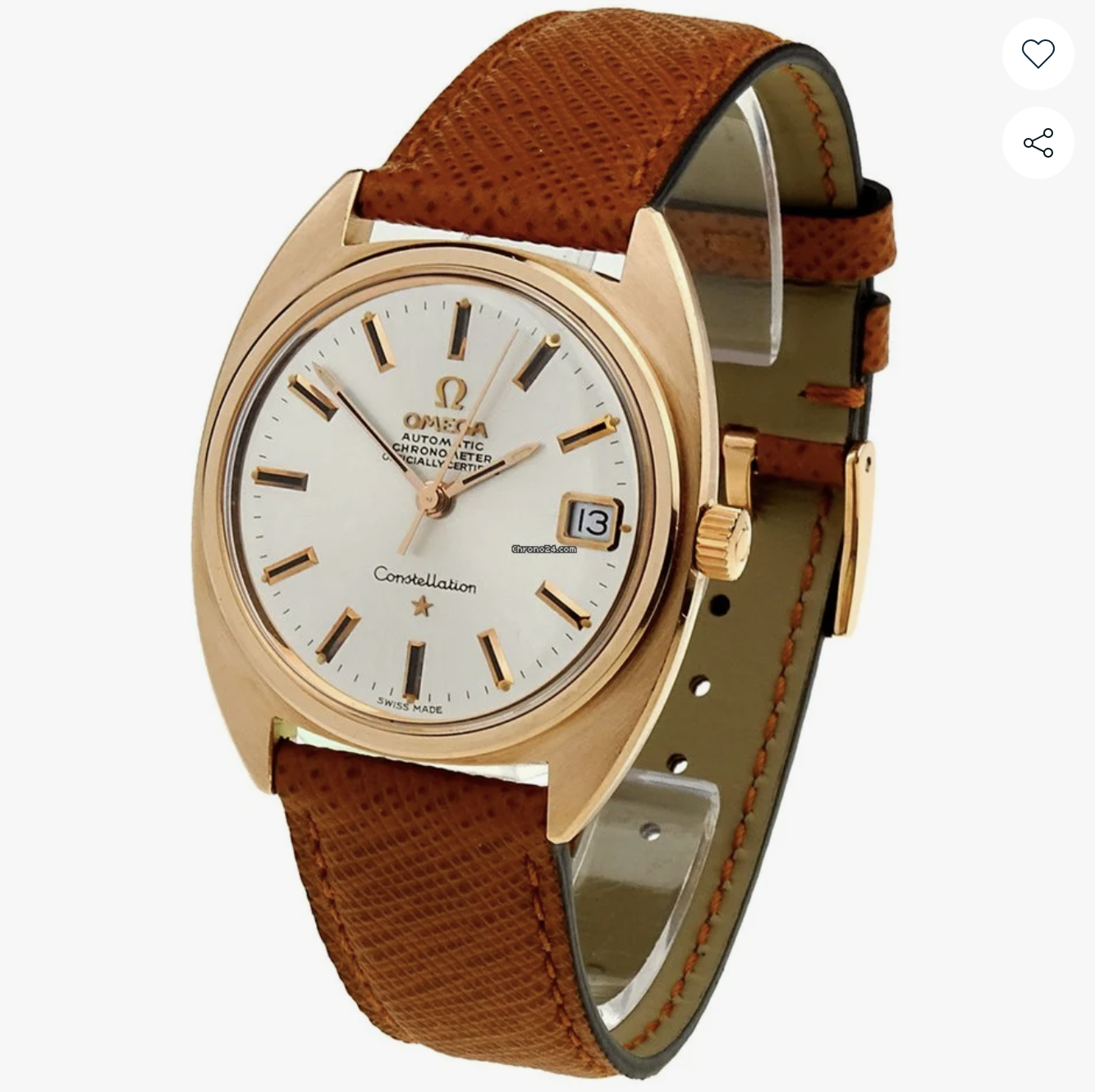

The photos were very blurry for some reason so delteted. Heres the link. https://www.chrono24.co.uk/omega/constellation-vintage-automatic--id25567017.htm
This is a very pristine example and it's been on my Watchlist for quite some time as well, since it's a rose gold it makes the watch very rare, hard to find them in this condition
But at the same time it's just a collectors watch in my opinion, it's too expensive to wear, it's too expensive even to collect, from a collectors perspective it's better to passively buy watches of this nature from eBay for 1/3 of the price
Take my feedback with a grain of salt as the lower the prices the better and if high price watches sell it lifts the market 😀
She's a beaut all right .
Do you think the dail been refinished though (as it is out of MOY) or do you think this is one of the naturally occurring variations?
And in terms of lume did Omega move away from tritium hence lack of Ts beside Swiss Made?
