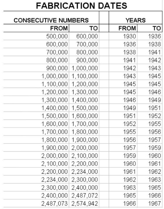

The first point I would make is that using catalogues to determine what watches were available at a point in time (surely, the very purpose of a catalogue) must be a more accurate approach than using serial numbers.
Firstly, the serial number table that we all rely upon is only based on estimated production numbers. Secondly, the serial numbers relate to the date of production and not the date of sale.

Although the "Loghi - Logotypes" page has been modified to suit someones purposes (dont ask me who), I have the original which does not have the 60s logo (it is actually the later 70s logo), the following images are pretty conclusive (found in the second thread of this forum) which details what is certain (note serial beyond 1967 are not listed) ...
