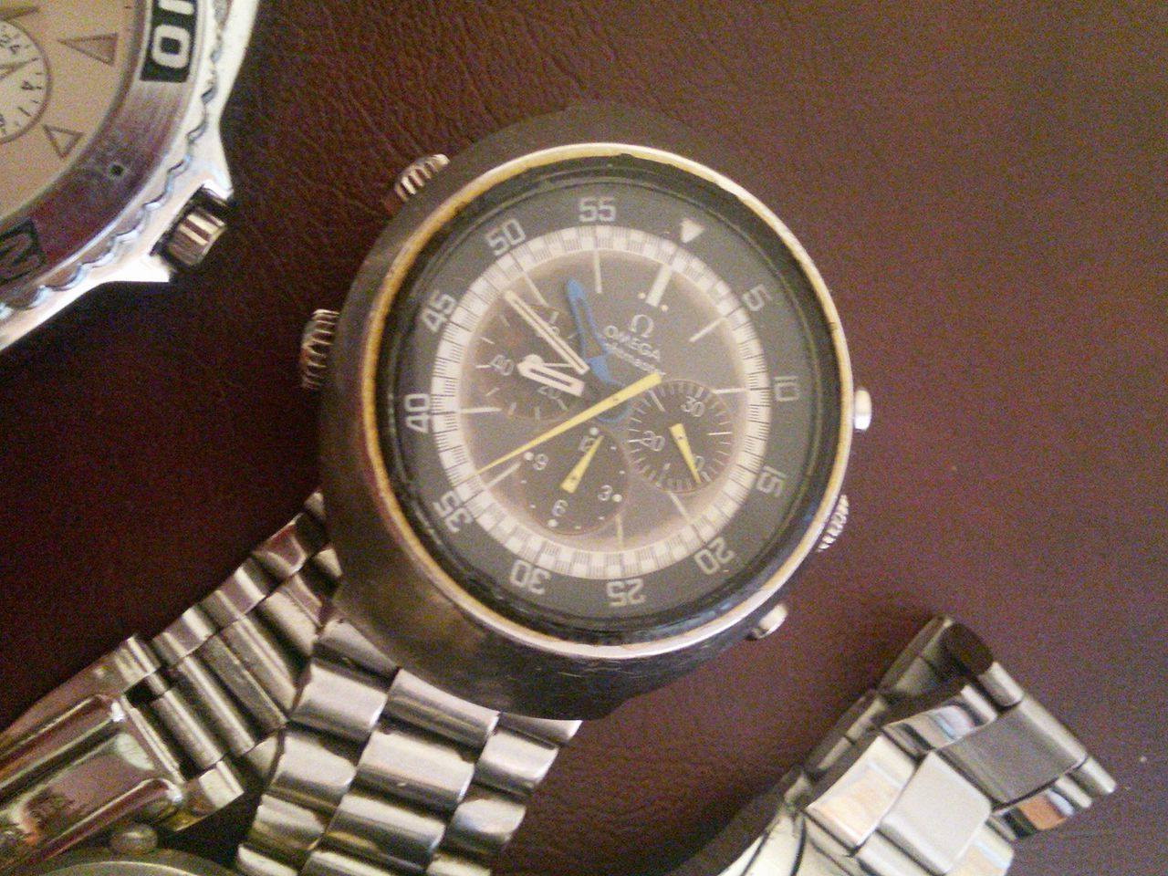

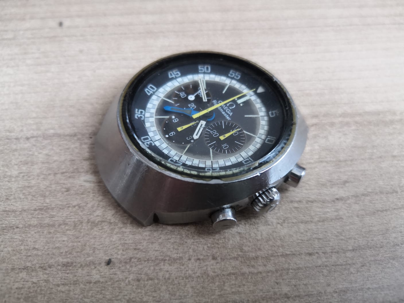

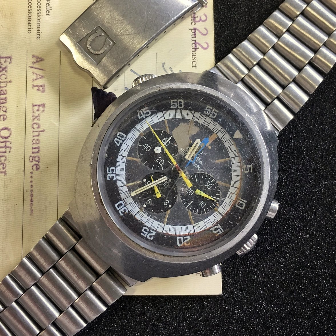

Skip the back and forth for a couple of years and I get wind of a "possibly fake old omega you should look at" and this photograph via WhatsApp :
The watch coming from a pilot of the Yugoslavian "JAT Airways" and their Airforce. It was being sold for 300€ at the time and I've bought it sight unseen with a cal. 601 Geneve...
I wait for almost two months for it to be delivered and when i get the watches I am instantly disappointed the Geneve being washed thoroughly with WD-40 and this watch being so dirty and sticky my girlfriend has a fit.
I examine the "fake chrono omega" and finally get to read the name on the dial - Flightmaster - I've only seen one in an old Omega advertisement at the local watchmaker. I'm ecstatic and at the same time worried...
The glass is held in by hot glue, the crown for the inner bezel also and the best is yet to come - I phone the seller to confirm receipt and he tells me since he bought the watch in Canada he never stopped wearing it throughout his career and never serviced it "just cleaned off the grime and stuff with alcohol and some bike oil"...

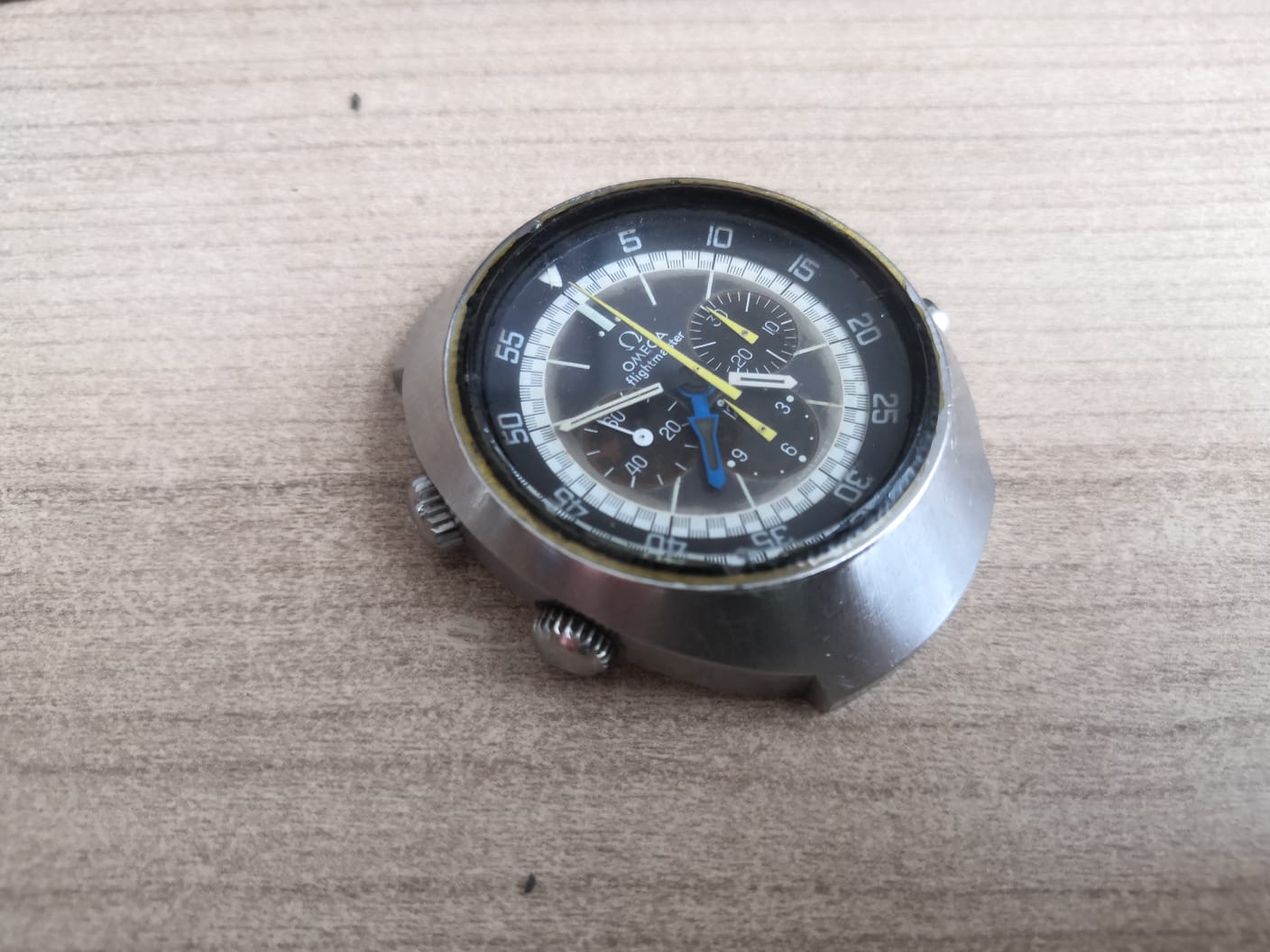

So lets see what I have received from the guy:

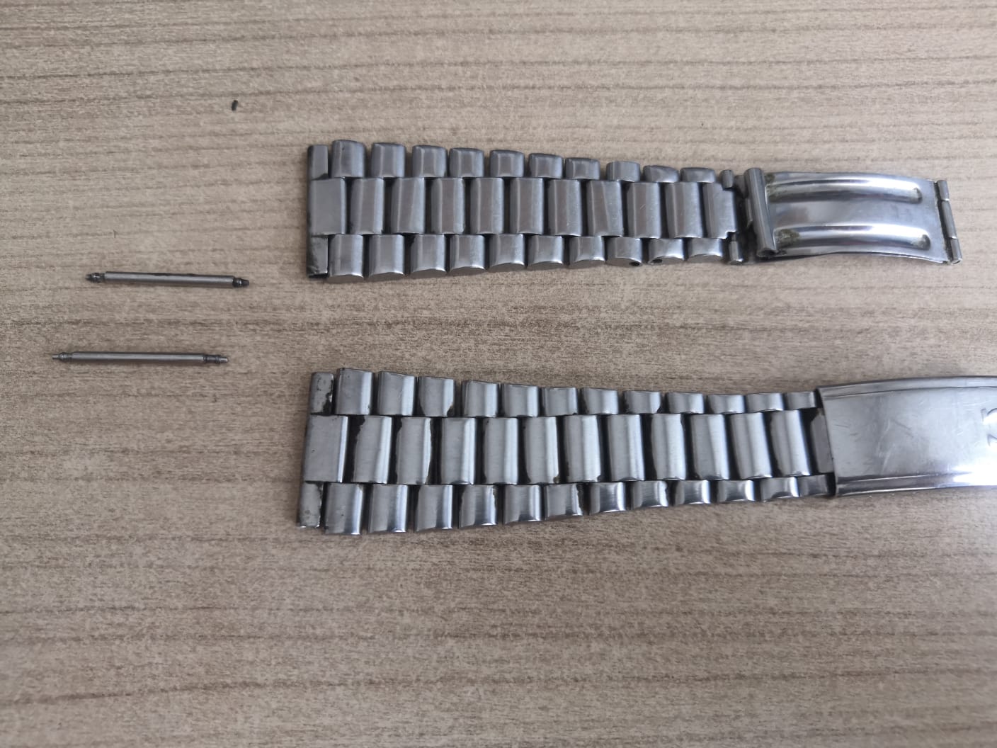

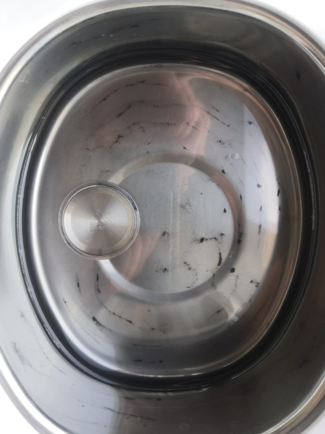

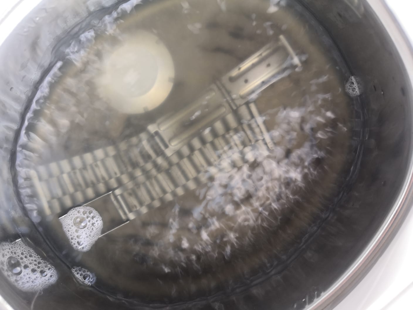

This is the third ultrasonic bath of the caseback and the bracelet ( prior water changes were not photographed as I was being yelled at for using my GFs jewelry cleaner for this):
This is the fifth take on the caseback:
Now the bracelet before going for a swim for the 5th time:

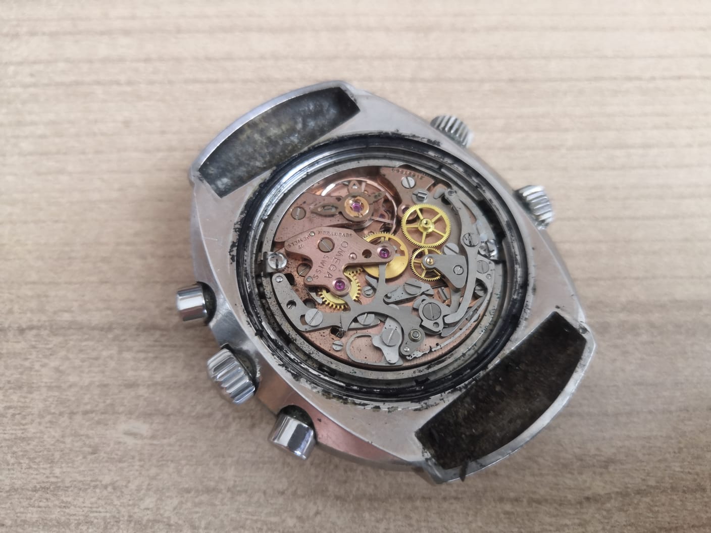

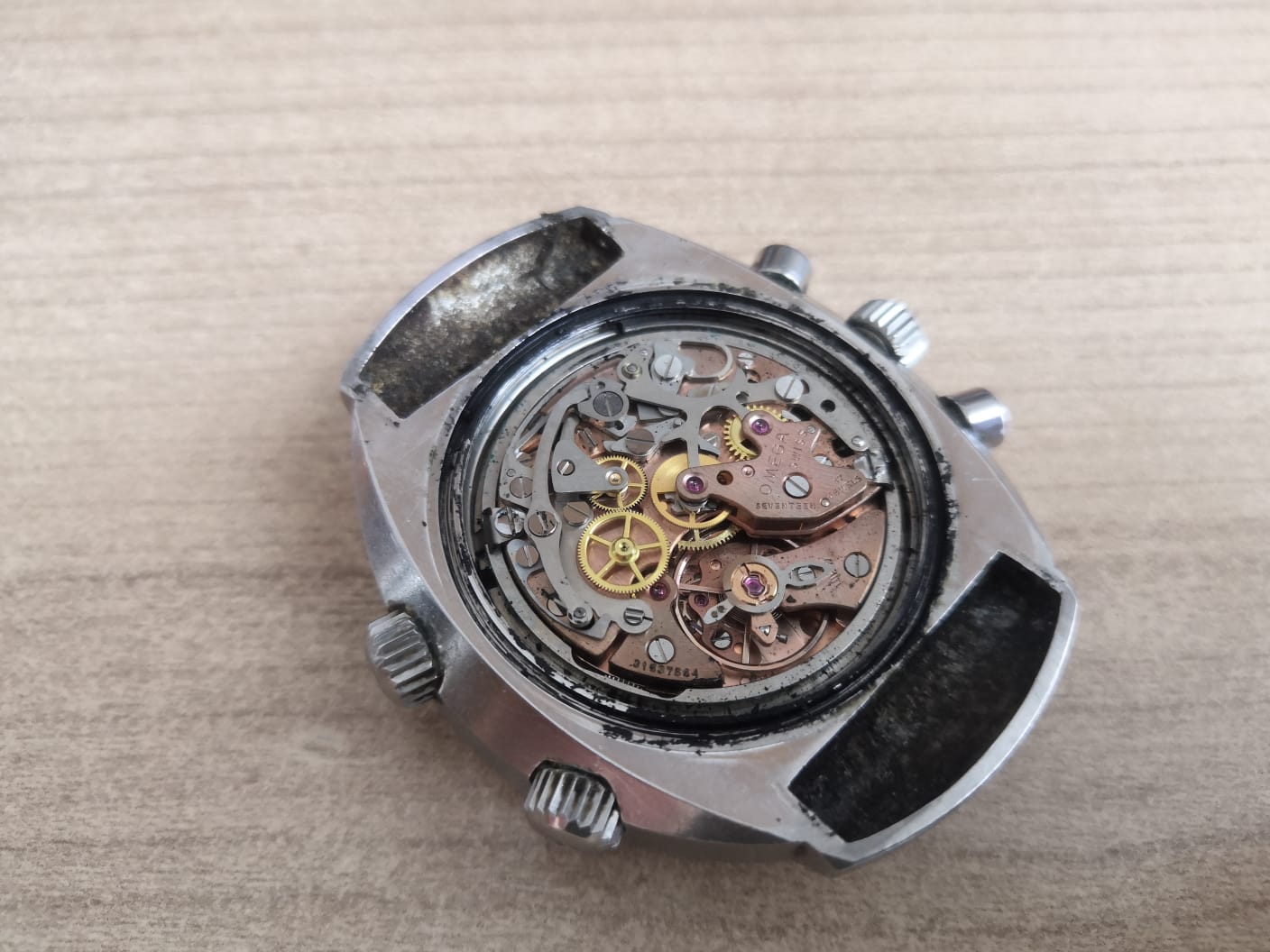

And now for you with a weak stomach it would be time to stop browsing or a parental guidance moment, I've never seen 30-40 years of crud, skin, sweat, clothes and other kind of DNA nowhere and was hitting my icky skin crawling scale right around 9 out of 10...
The gasket has melted in place, a slight aroma of something akin to petroleum permeates the watch and the air around it, worrying - yes - stopping me from winding it - no...
IT WORKS! The watch ticks, the seconds move, the gmt hand moves and the chrono resets as intended. I photograph the rest and close it all up...

What would you do if this was your watch in regard to getting it up to spec? I definitely want to get a new set of tritium hands, crowns and pushers with enamel color?
New glass or just polish the original glass ? New dial or not?

Have you put it on a timegrapher ? I wonder how it’s actually running. I’d get it serviced and running well so you can at least wear it in its raw original condition whilst you hunt for original parts... there are lists of flightmaster gurus on here (and there is a specific flightmaster thread if you search for it). All the best mate great story, made even better it was from an actual pilot!

I didn't I'm kind of going at least in my mind the route of looking and fondling it daily while sourcing the parts and then sending it of to get refinished and serviced by an Omega Service Partner in my country or somewhere within the EU depending on recommendations.
I know that this service center does laser case welding and refinishing to oem specifications but i kind of don't want to get it 100% sterile and new I'd retain some character.

The trouble is that if you do too much then you lose all the character that the watch has achieved over the years. One option is to send it to Omega and have them do all the work, they will do a fantastic job with movement service, refinishing the case, new hands, new crowns, new pushers, new glass and maybe new dial too .................so you would have a great watch but that had lost its original character.
My personal preference would be movement service, relumed hands, keep the original yellow hands and keep the original dial. New crystal and gaskets, new crowns & pushers. To get these parts will probably require an Omega authorised watch maker with an Omega account.
The movement is quite early 31xxxxxx, 145.026?, with the metal brake, the later models had this part replaced with the delrin brake as per the Speedmaster etc
You raise the same concerns I've had for the duration of the ownership... I have seen NOS parts you've mentioned on ebay there are several crystals going from 90 to 200€ currently on ebay.de as well as gaskets and the colored pushers.
I think I'll need to rebuild or get a new mechanism for the bezel, i don't want to butcher the watch locally to see the innards and do a diagnosis ( don't know how to remove the caliber on chronos or high complication watches).

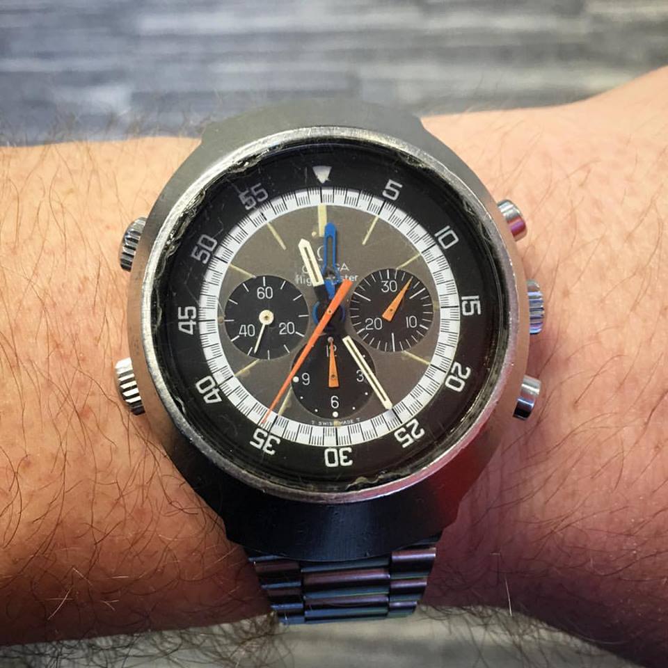

The route I've undertaken in getting two broken flightmasters back up and running, was based around being able to wear and enjoy them every day.
For me, this meant full mechanical service, new crystal, new pushers and crowns.
I have the old crowns and pushers in case someone in the distant future wants to put them back on the watches, but since I don't intend to sell them, and I want to wear and enjoy them without worrying, this is the route I took.

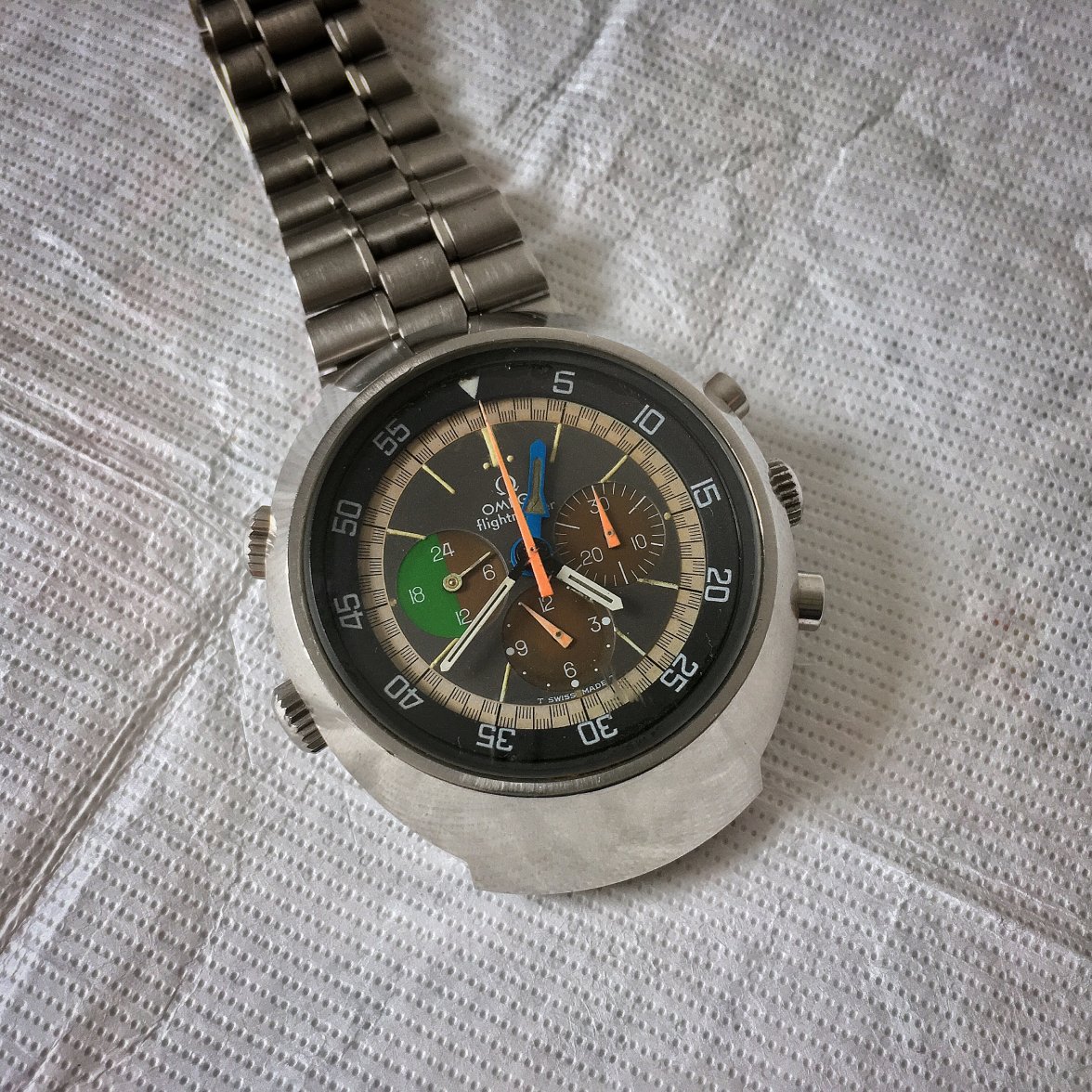

The one that's still waiting work however, I'm going new everything - because to my eye it is just too far gone with water damage:
Ultimately the decision is yours, but I wouldn't touch the hands or dial on your watch. I would get it fully cleaned and serviced, new crystal and seals, and new crowns and pushers. I'd keep the crowns and pushers just in case, and then I'd wear the heck out of it!👍
It is the 145.026 indeed.
Regarding the dial, sometimes when i look at it I wanna say it aged nicely - other days i think it's cr*p...
At the end of the day you have to live with it and enjoy the watch, so there is no easy answer on the dial.

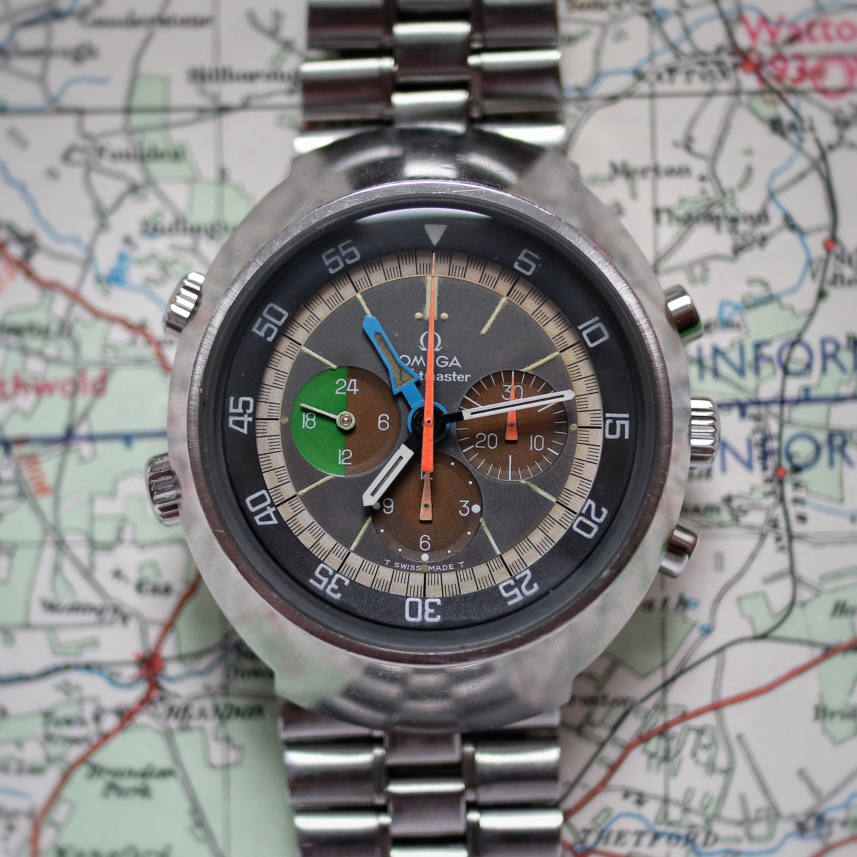

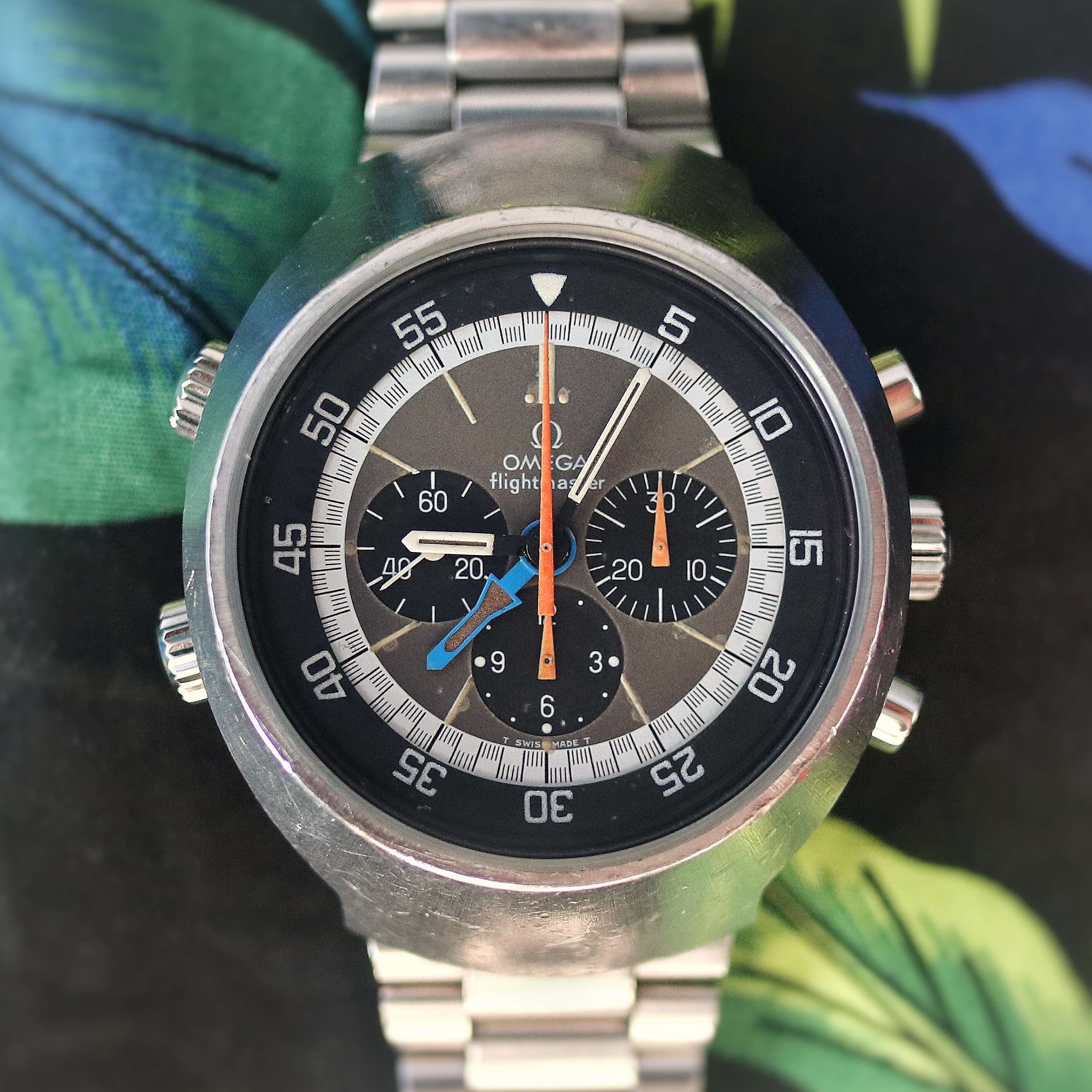

My three flightmasters. The 145.013 has a really faded dial but it has a special character which I didnt want to change.

Question about the bracelet, it has some stretch in it - is there a guide how to refurbish it? I did DIY a Jubilee a few years back so I'm thinking of tackling that myself to save some €€€.
