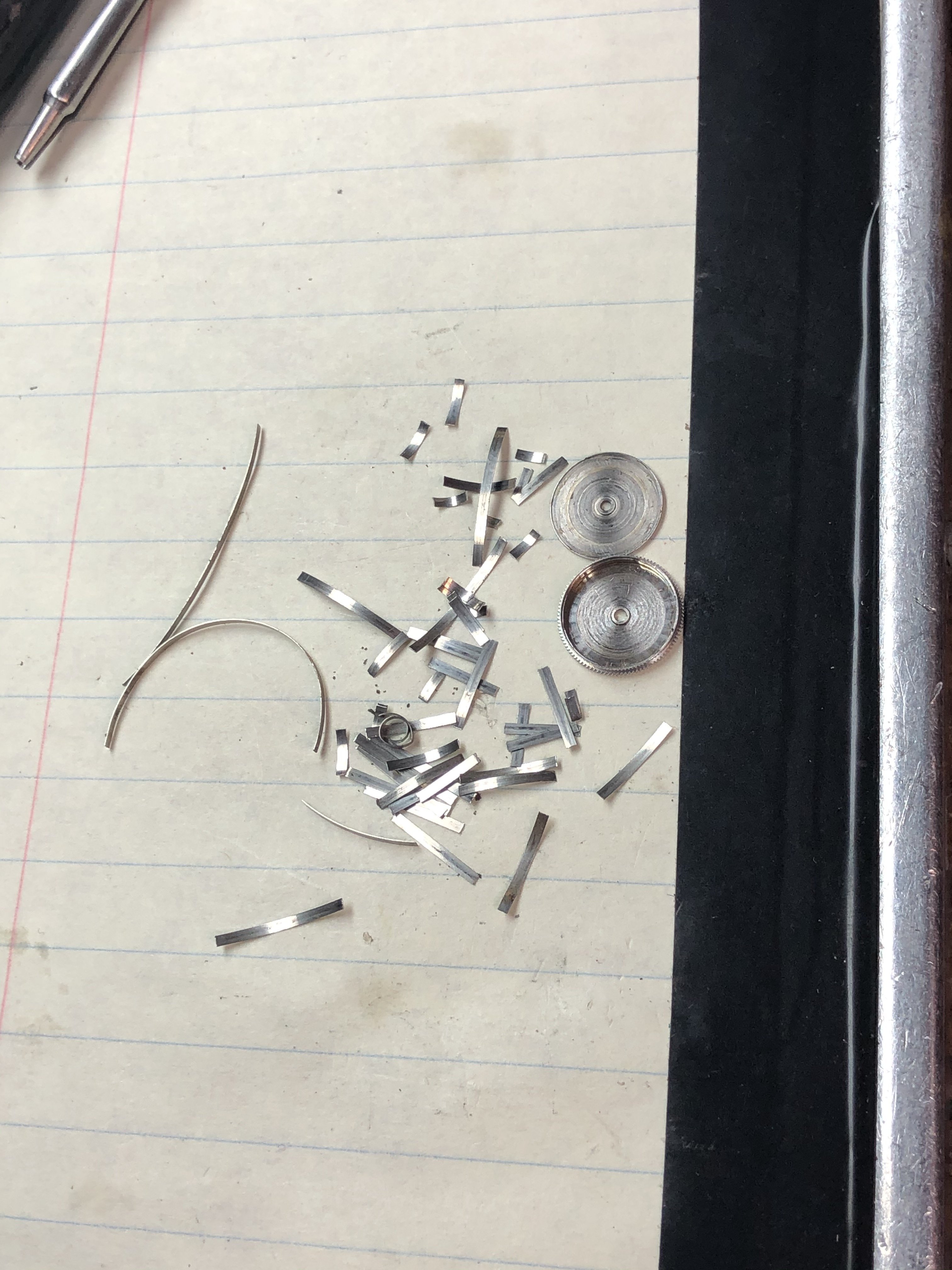

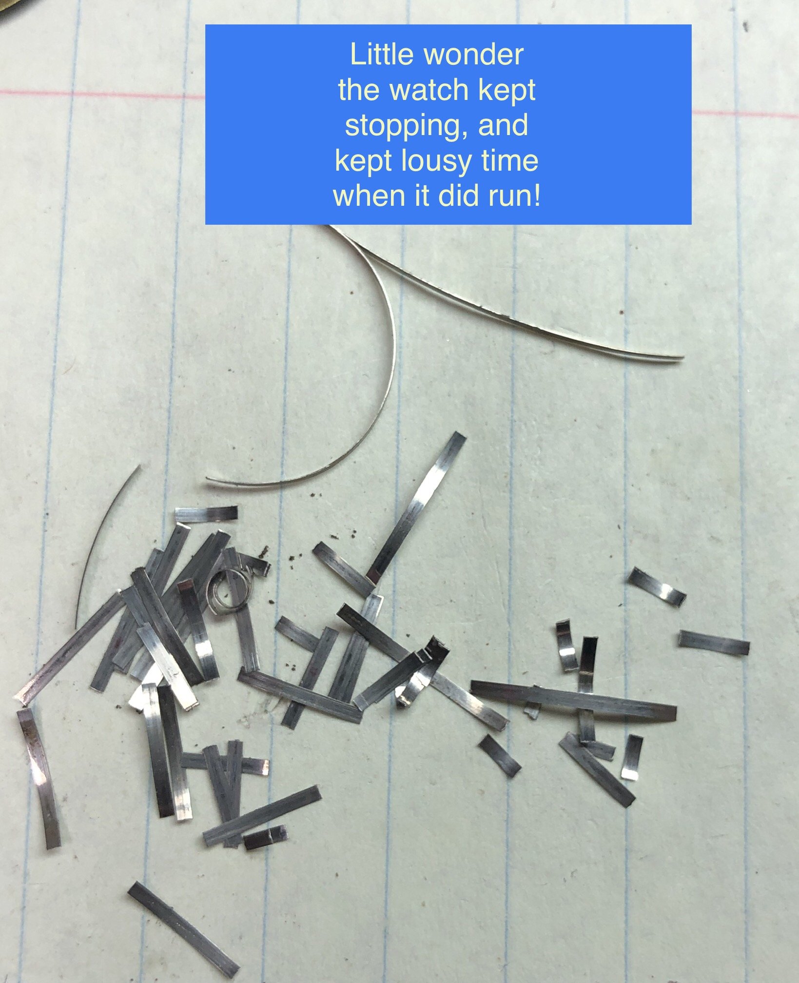

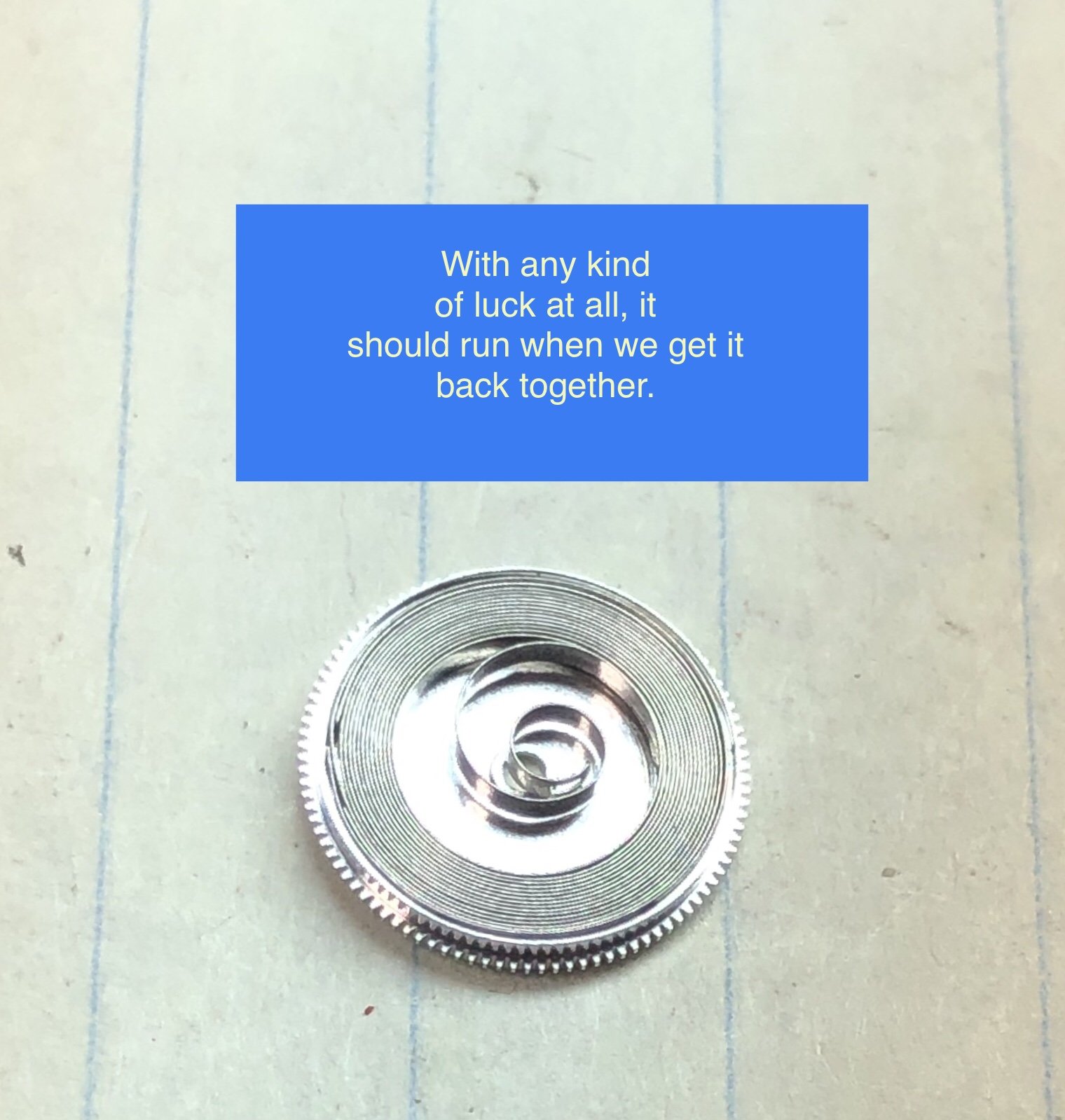

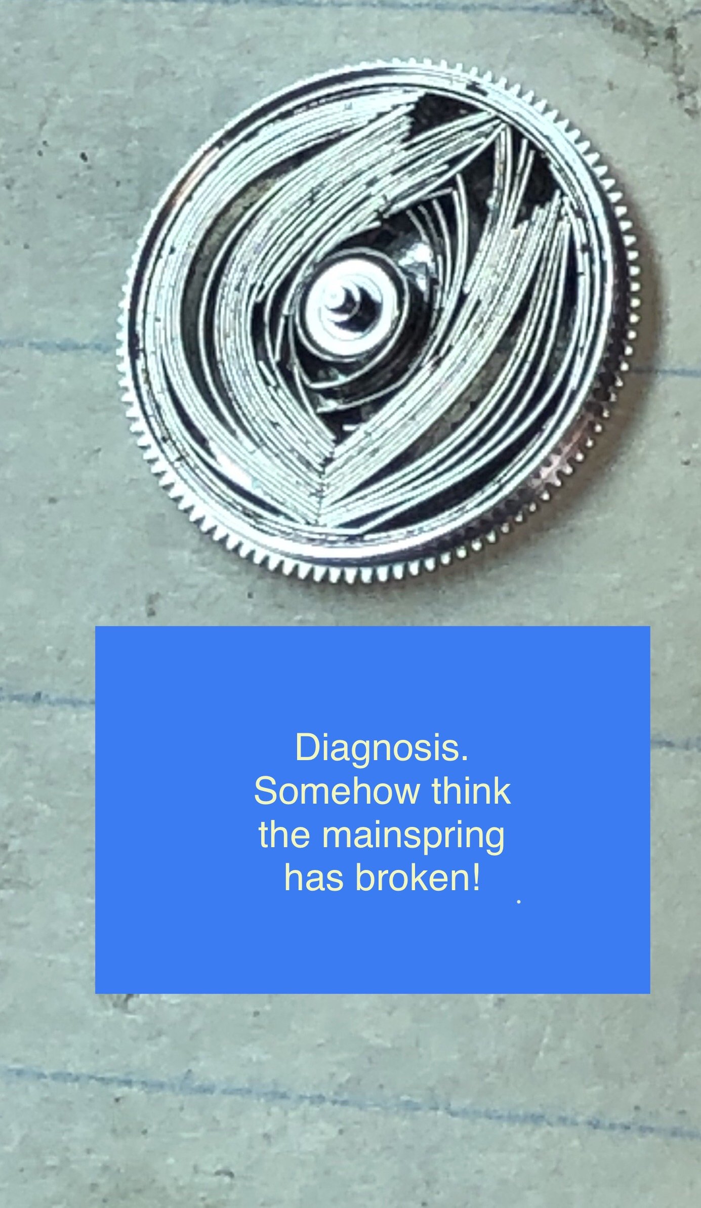

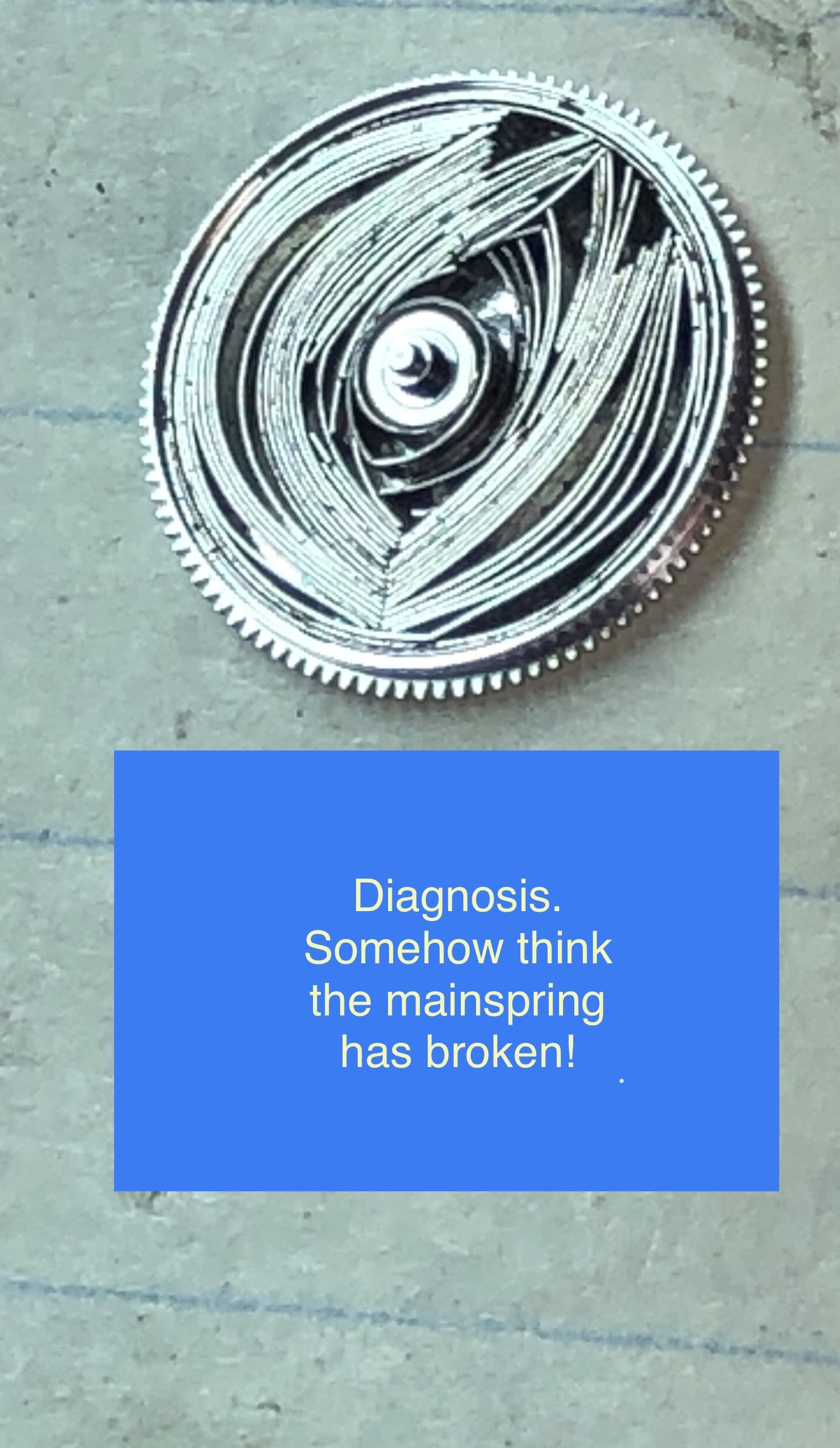

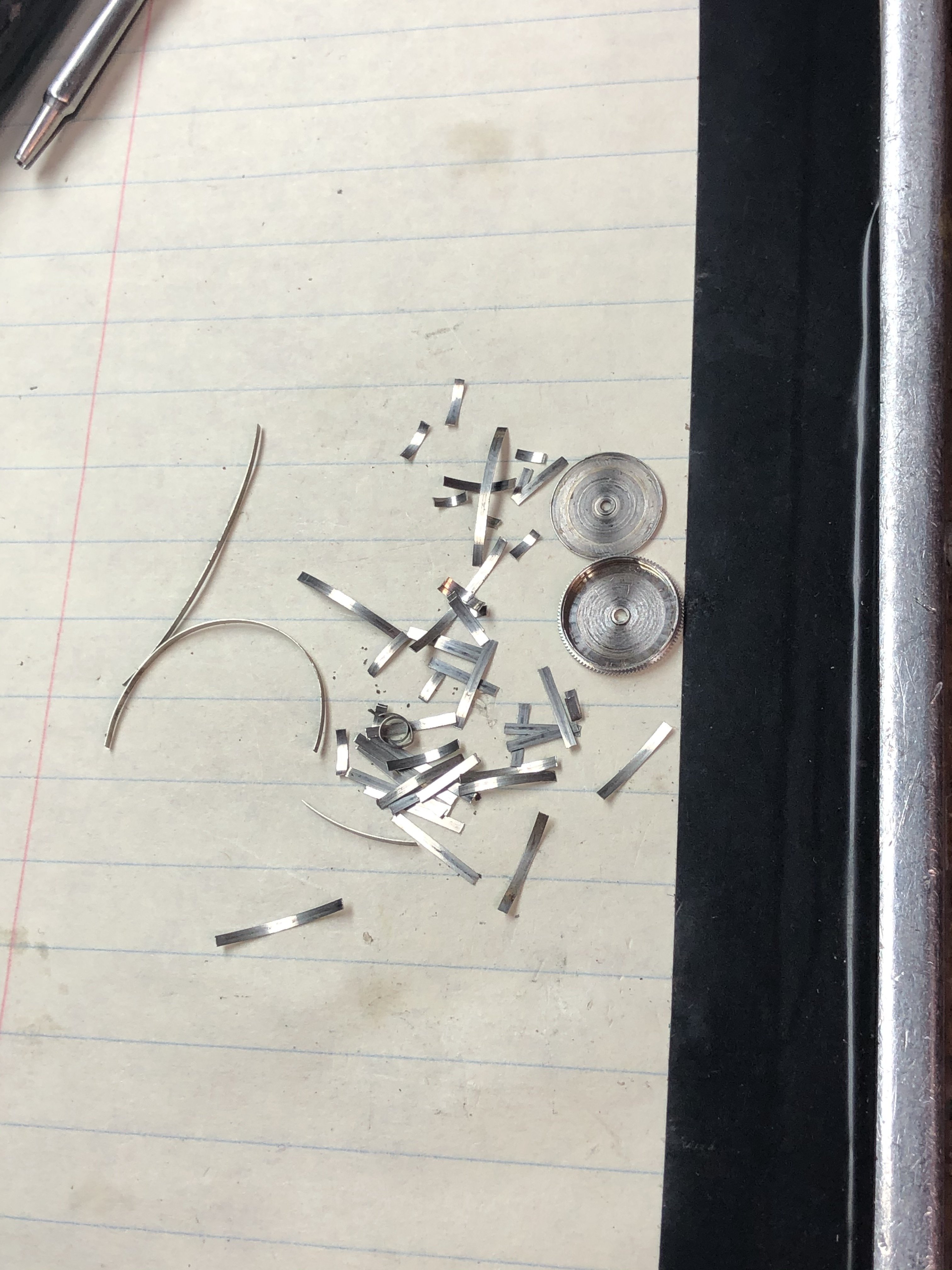

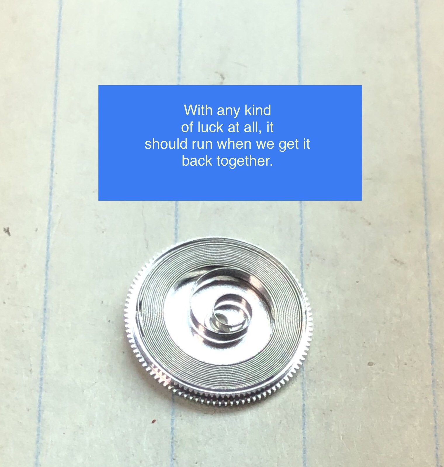

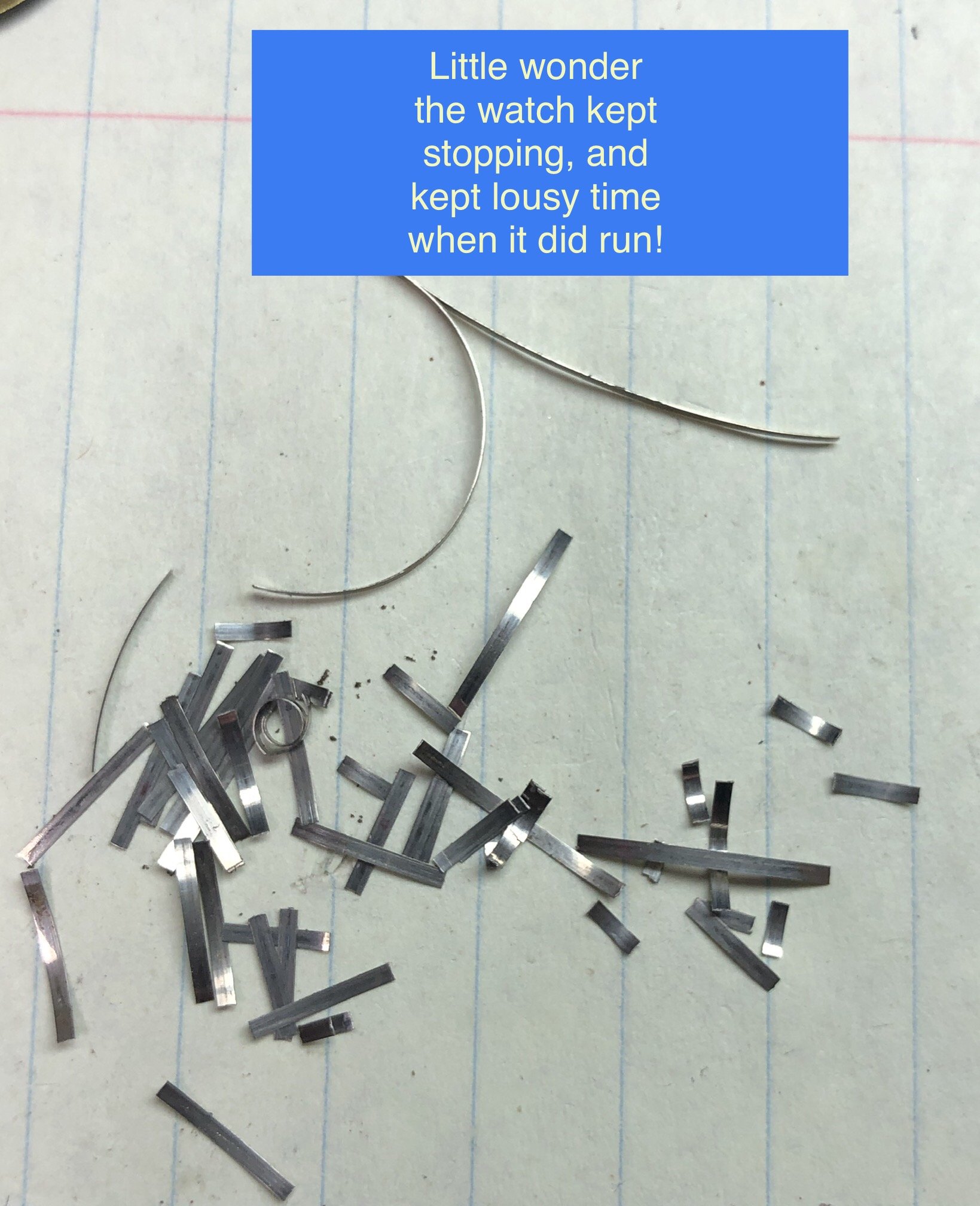

Fear that the mainspring may break if you wind the watch until the crown reaches a hard stop means there is no answer to the power reserve of your Speedmaster. Persist in this fear, and you’ll never have the answer to power reserve. Mainsprings break, it’s a fact of life, whether you wind the watch fully, or whether you don’t. I wound my Speedmaster with the calibre 863 movement in it, yesterday. The watch was run down, and it took 60 “twists” of the crown to wind it to a full stop. It has proven to run well over 50 hours from a full wind, with the chronograph functioning all the time. Here are pictures of a broken mainspring that I replaced for a friend, several years ago. This breakage had nothing to do with how he wound the watch!
