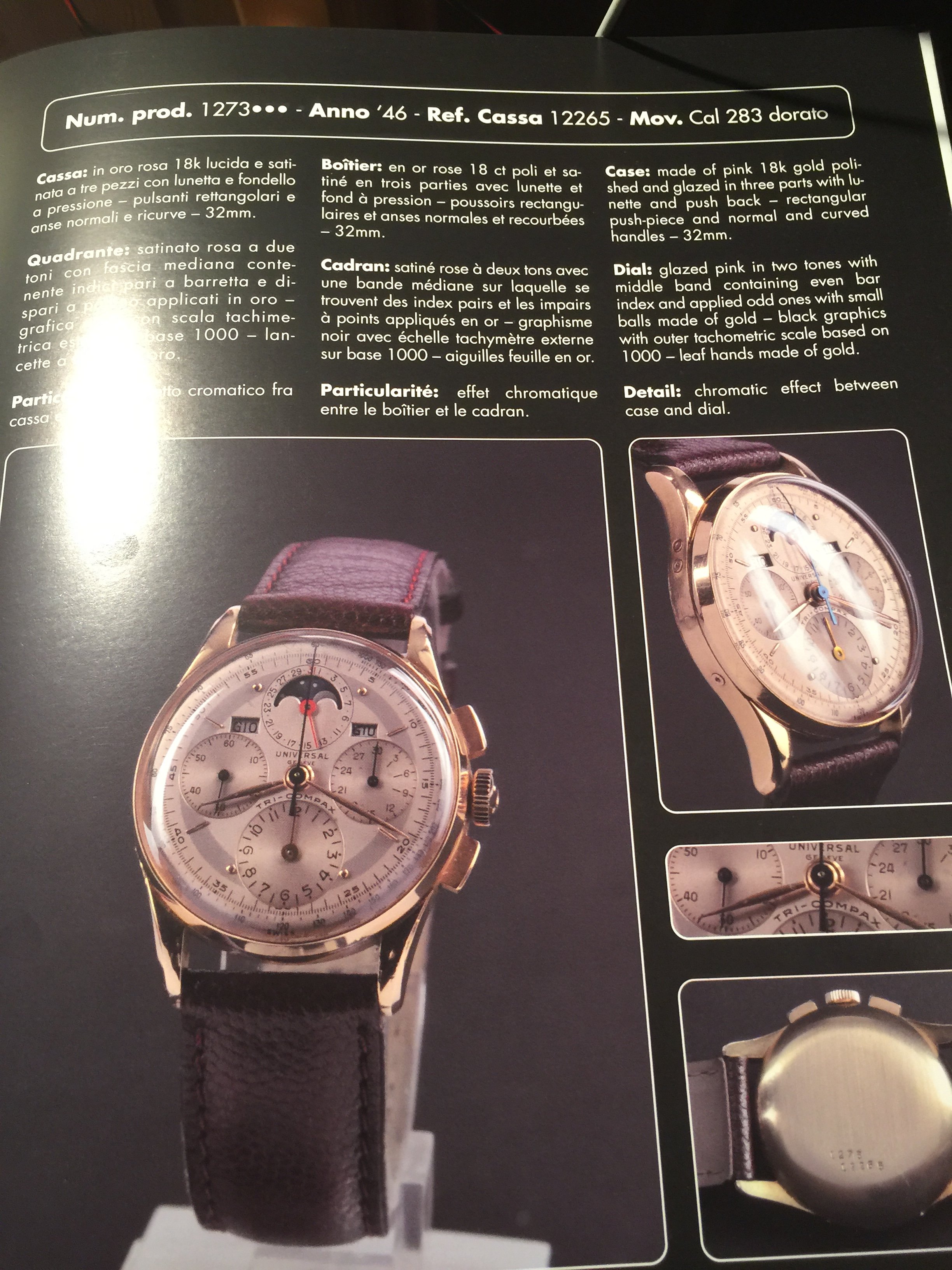

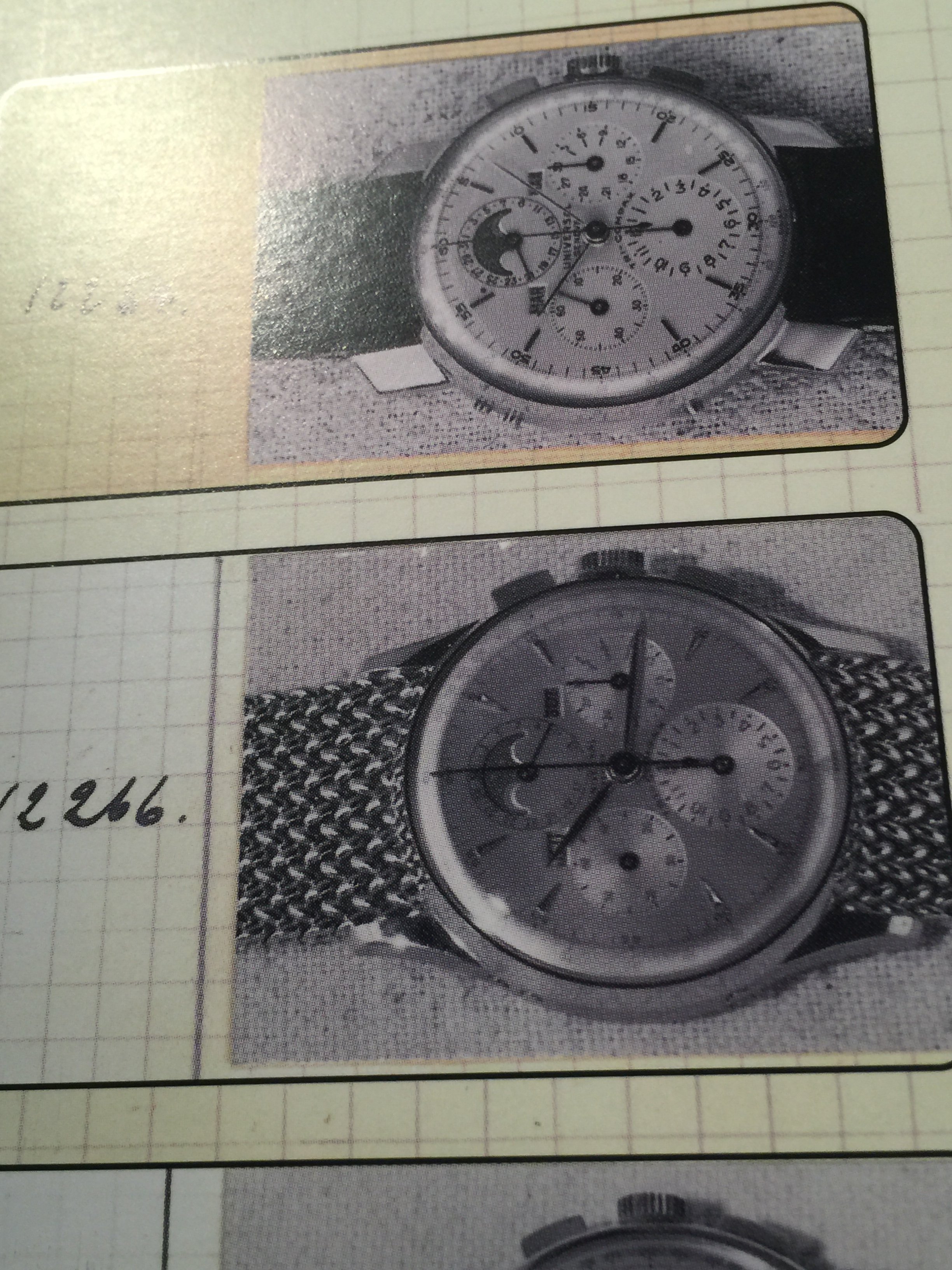

From Sala... you can see the issues with your watch.

It's 100 percent redial, I'm not sure on the compax, but they probably are all three redials.

100% redial, sorry 🤔

Now I'm wishing I hadn't posted the watch ☹️ Regardless at what I paid I'm very happy with it. The dealer says it was bought directly from original owner and wasn't touched but you are right about the Tri compax lettering on the dial vs another 12266 I found. Lessons learned I guess, it will affect the resale down the line but not really intending to sell it.

May be we should tell him more about the obvious issues of the Tri.
- No Tri-Compax on the dial
- Universal Geneve not below day sub-dial
- No Circle around the day sub-dial
- Sub-dials not centered
- Sub-dial fonts wrong
- Seconds and minute sub-dial should have simple lines, no scale
- Font of Tachy is wrong
Anything else I missed?

The ones that have dials like that in Sala had the tachy snail scale as well. Very early watch ... price reflects fact that selller knows it's a re dial. Reasonably priced repair and it's a nice daily wear.

Still waiting to hear if this can be resolved. Studying the pictures of original dial it's now blatantly obvious that several things are wrong. Missing print, Universal Gevene inside of subdial instead of below it, etc. The dealer has offered to refund if ALL 3 dealers that inspected it would state in writing that the watch has been redialed which of course they won't. Several weeks have passed since the purchase but being a noob I had no reason to be suspicious of a dealer watch. Pretty costly mistake not having it checked out immediately.
