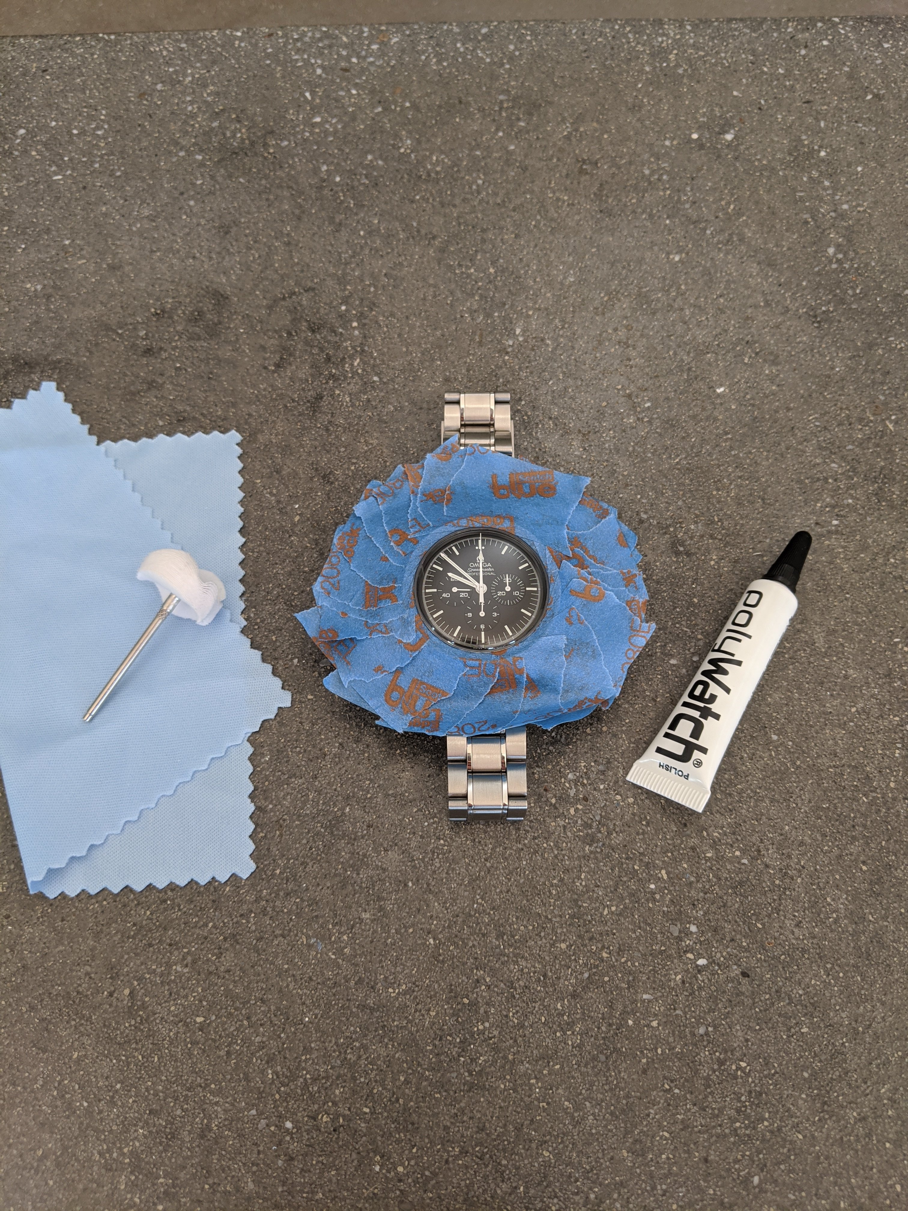

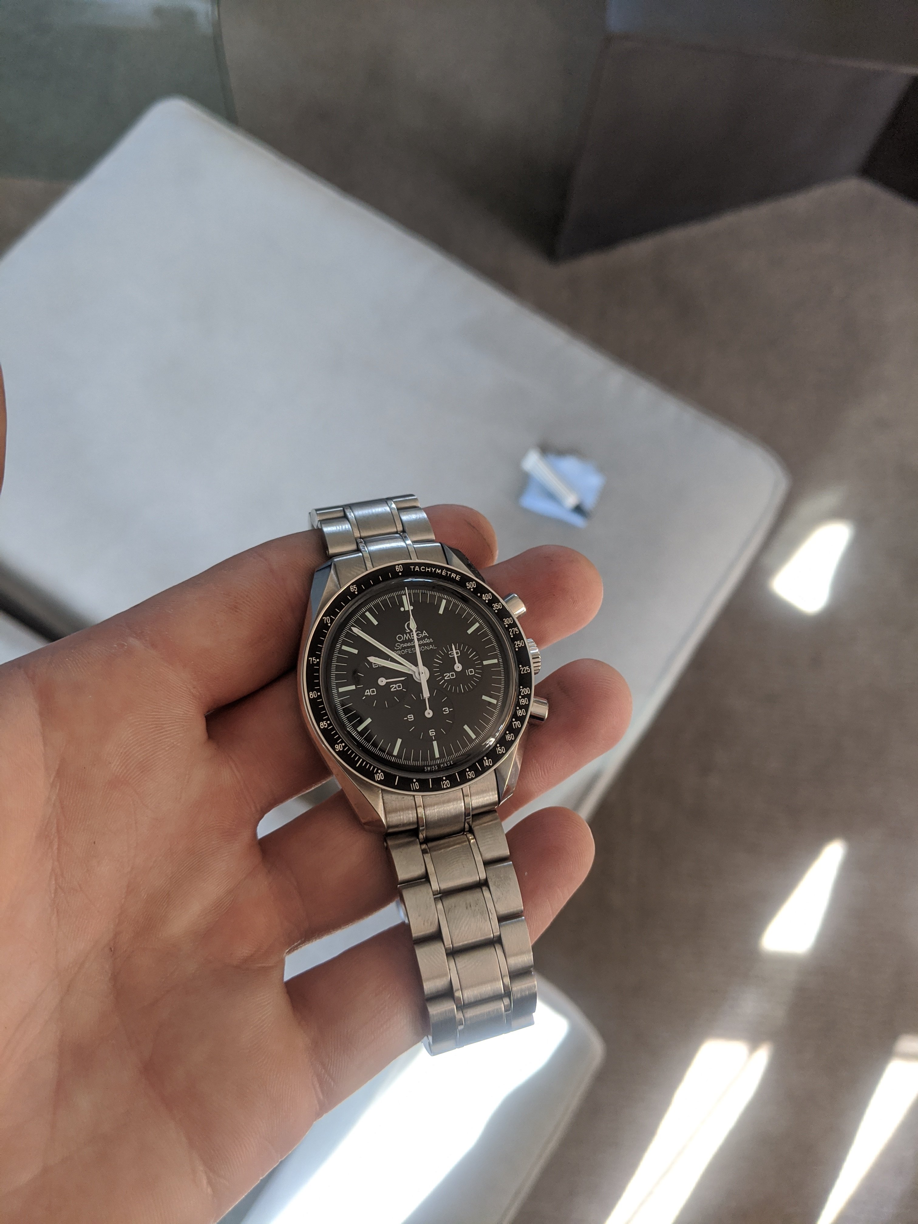

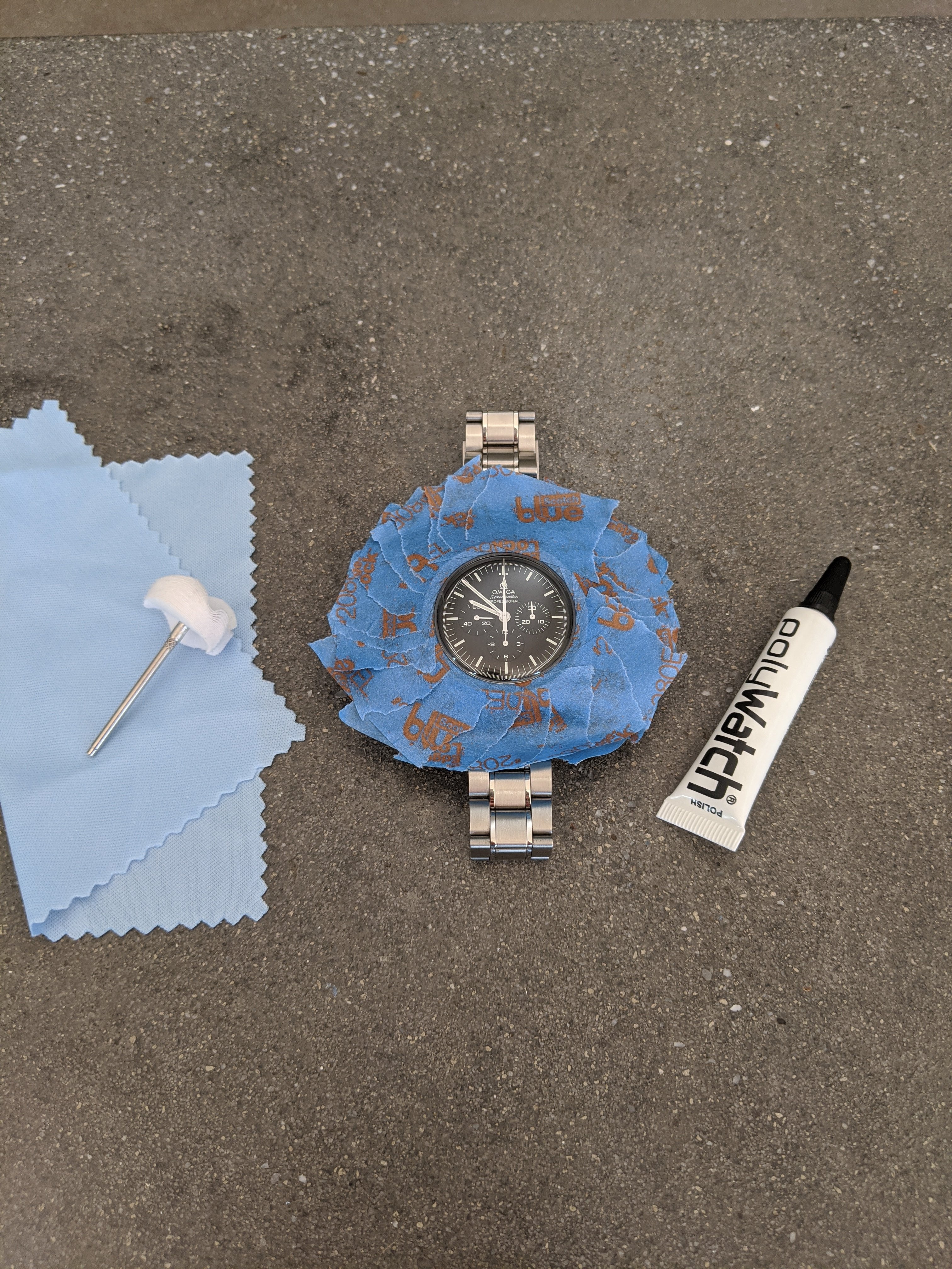

When I was deciding between getting my Speedmaster in either Sapphire or Hesalite the forum helped me decide with tales of scratches coming out with Polywatch. I've had mine for a little under a year and yesterday got my first real "oh shucks" scratch on it. I was moving my son into his apartment and we were carrying a long heavy box (unassembled bed) when my arm got pinned against the wall going around a tight corner.

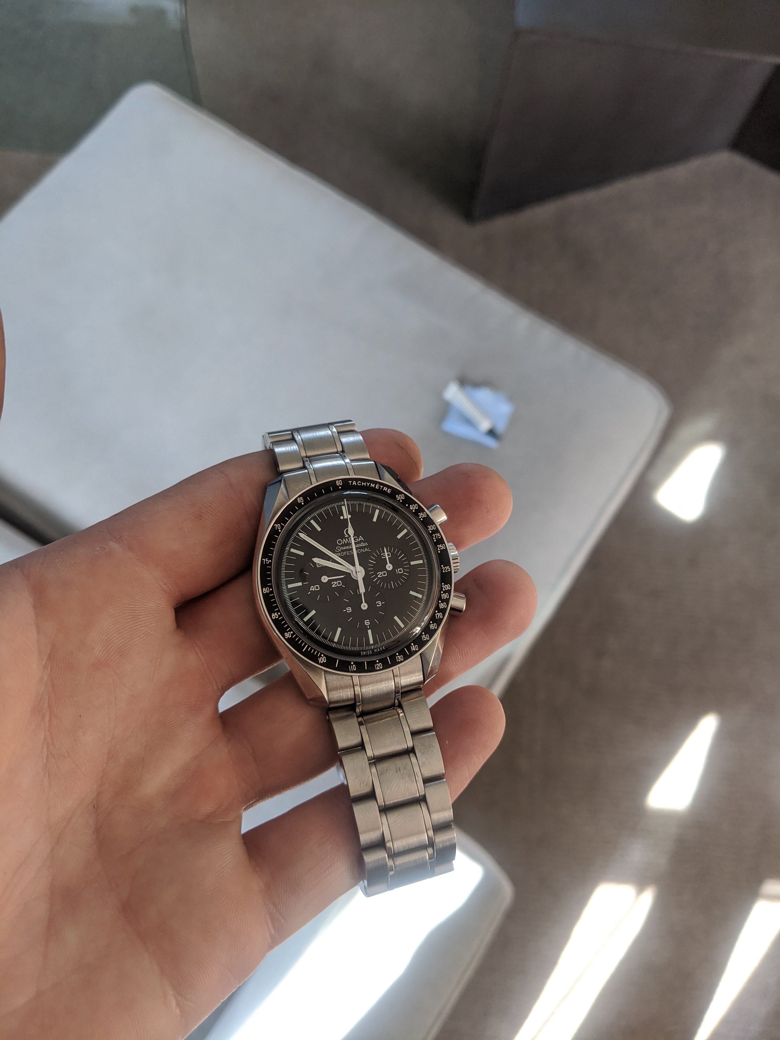

It was a pretty deep scratch (one you can feel with your nail) right at 12 o'clock. I thought "well this one isn't coming out". I got home and got out the Polywatch. 5 mins and a cotton ball and I was back in business. Thanks to everyone who shared their tale before, and this is mine.
Before
After

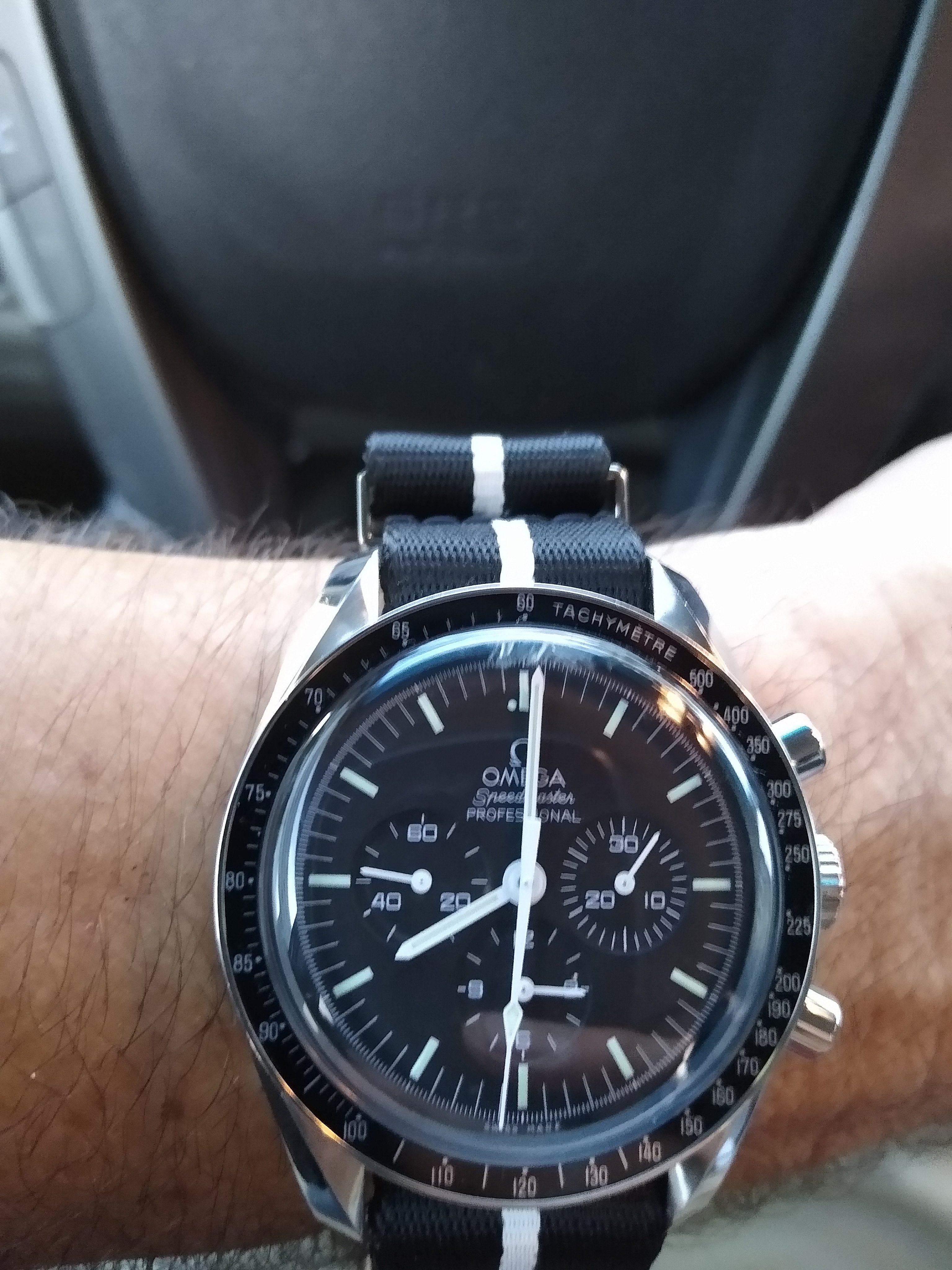

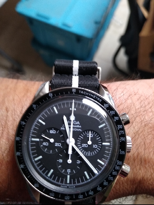

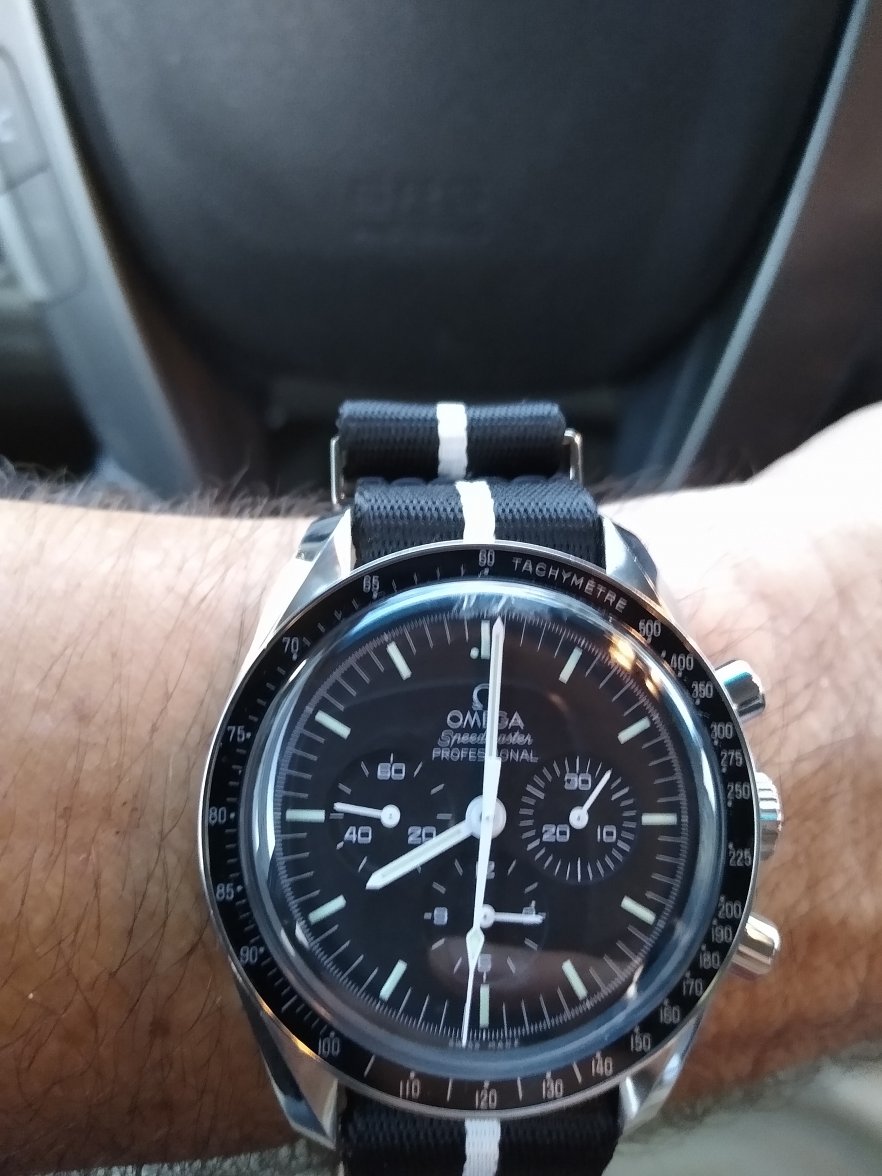

Had a similar positive experience with a Rolex GMT 1675 recently. Took it out for a walk and banged into someone鈥檚 hand (and what felt like a watch with a metal bracelet) on the street. I was left with two scratches blurring the crystal as a memento. Polywatch took them right out.

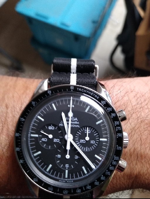

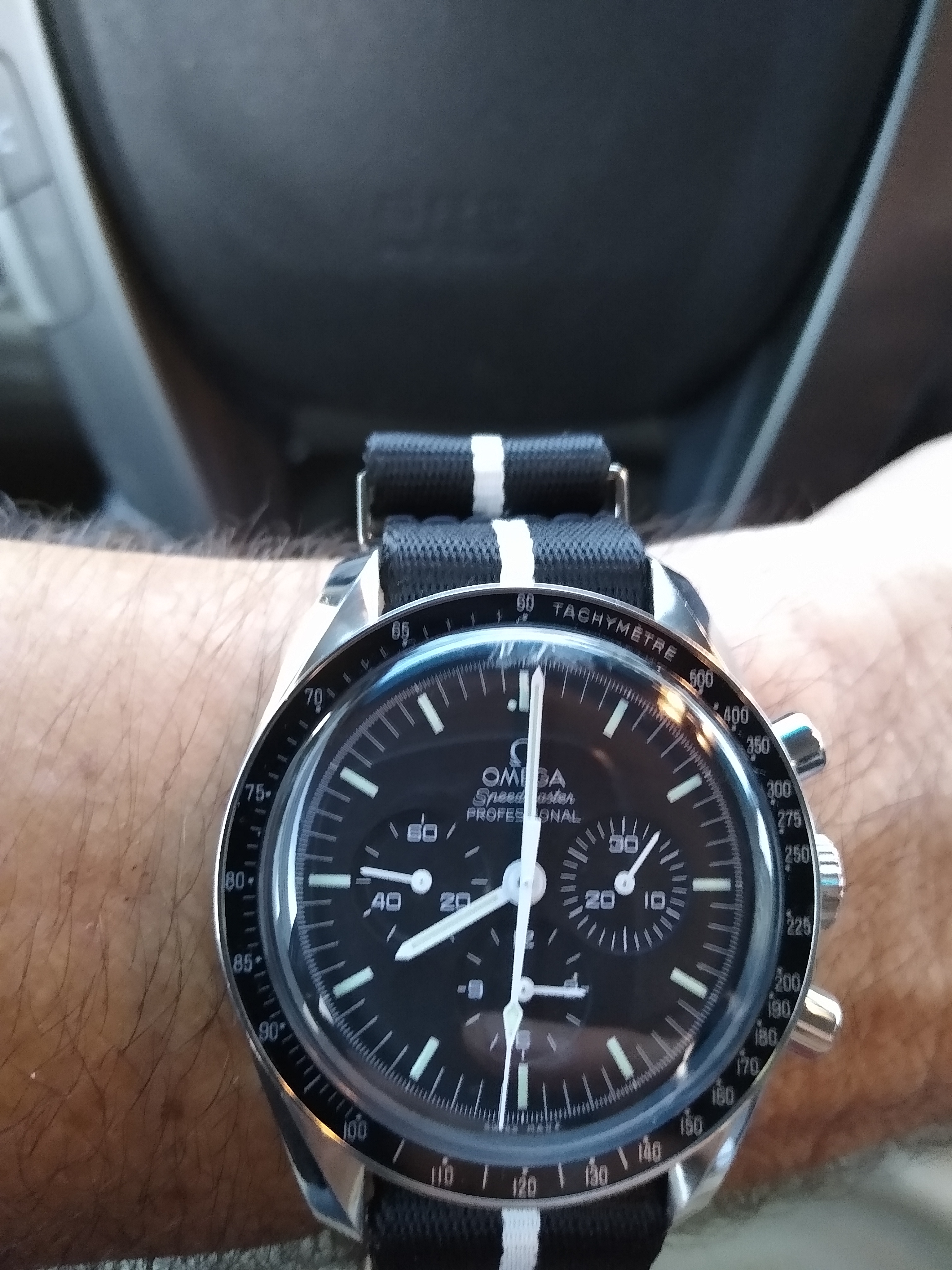

Just buffed out a couple of scratches this morning on my speedy. Didn't get them to show in a photo but the finished product looks great. I hadn't used polywatch to this point. Happy with the result.
Strange observational side note: the poly crystal on my Hamilton Field is proving to be very reluctant to scratch at all. I've worked on cars, planes, and homes with it and there's still no scratch! Just thought it was interesting.
