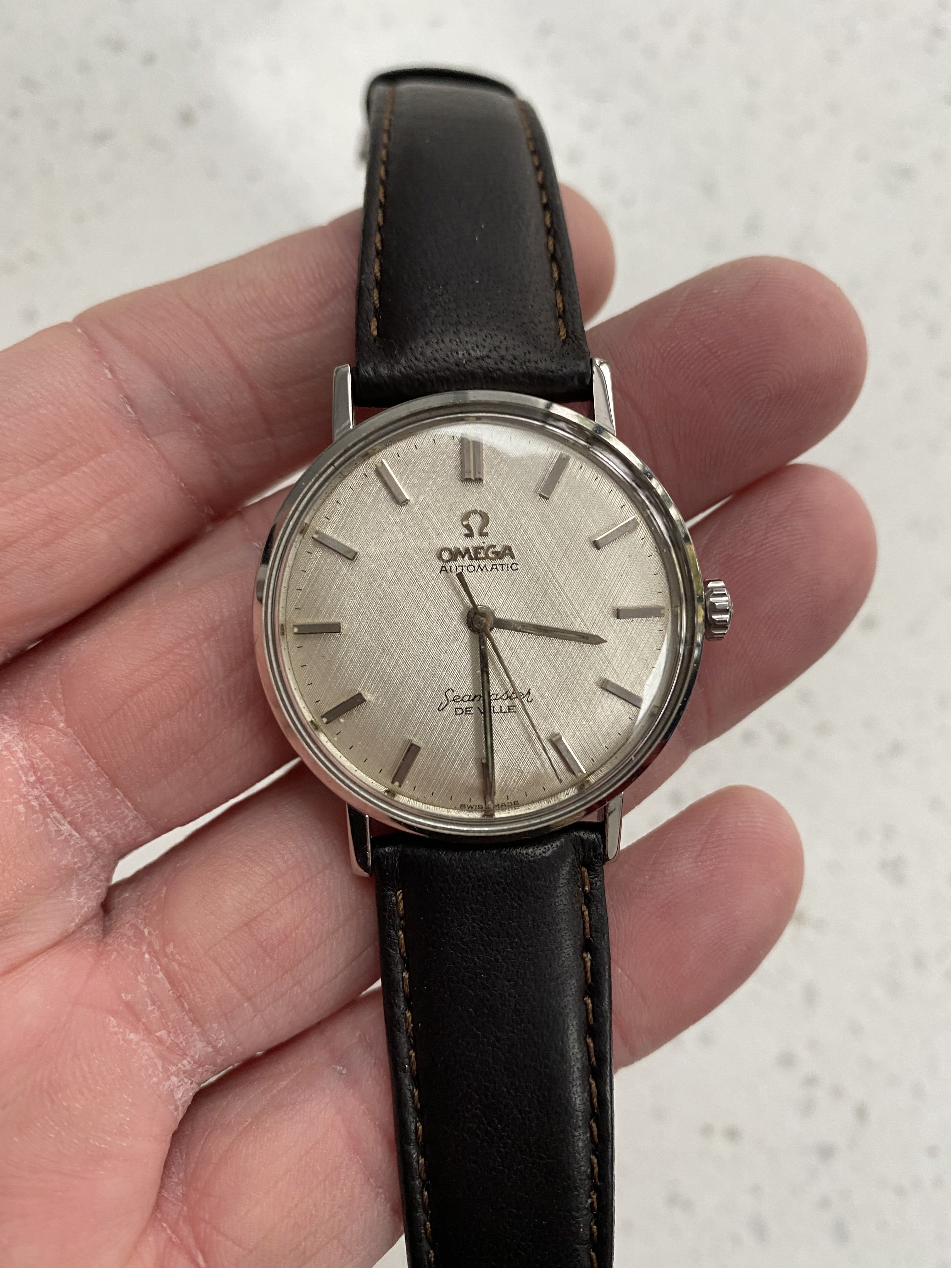

Dear all I am considering using some polywatch on the crystal that I’m hoping is hesalite or similar to buff out some very small scratches. The watch is a 1960 Seamaster De Ville. Any advice much appreciated.

She's a beauty! A drop or two of PolyWatch on the plexi, cotton pad, polish, repeat. If you like, you'll find plenty of tutorial videos on youtube, but it's really easy as pie.

Thanks ever so much was hoping it would be ok. They are tiny but just detract from the overall condition of the watch.

If they're not deep, they should polish away nicely. And I can't spot any on your picture, so it really seems like an easy job here. 😀

They are small and clearer using a loupe. Hopefully a bit of polywatch will do the trick

Thank you. There is a small crack at the 11 o’clock position near to the dial edge which I’m guessing won’t improve with polishing and I’m loathe to change crystal as it looks like the original with Omega etched symbol

It's not necessarily the original crystal, but it sounds like an authentic Omega crystal. Cracks can compromise water resistance, so keep that in mind.
