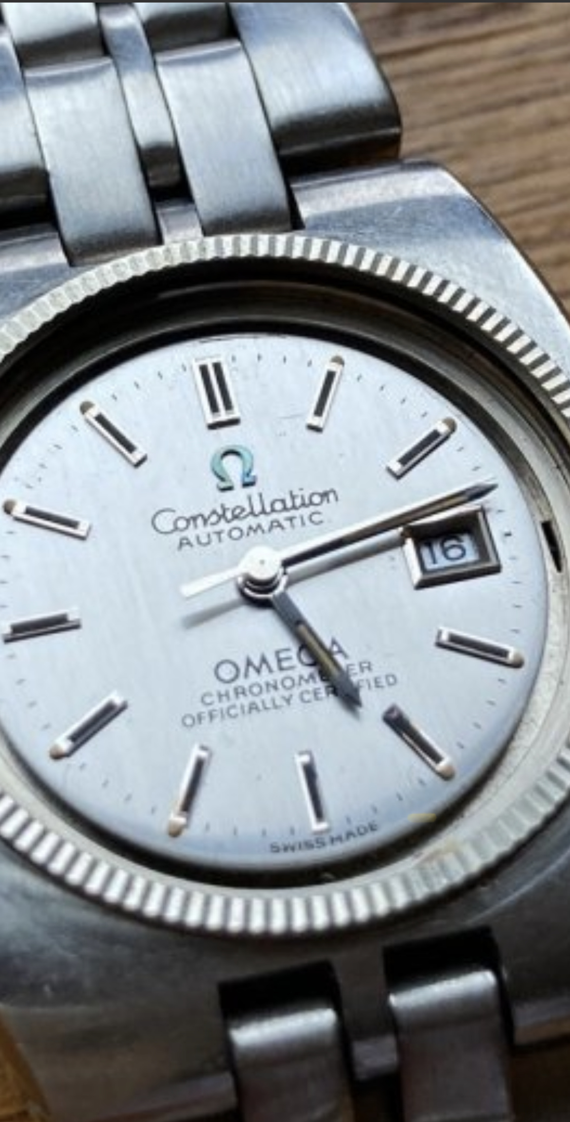

Hello OF -- Some of you may recall my flailing novice efforts to obtain a Constellation about a month ago. I narrowly escaped a frankenwatch (with your help, thanks), and finally managed to buy off eBay a very pretty 568.014 from about 1969. The seller (in Tokyo) assured me that it had been overhauled about two years ago, by the elderly watchmaker from whom he had bought it when said watchmaker went out of business. The watch arrived, it was beautiful, seemed to run fine (about 15 seconds fast/day), all well. Until now.
The first signs of trouble were that once or twice it stopped in the small hours of the morning, even though I had worn it the previous day and been reasonably active. I decided it was probably best to have it serviced, in spite of the seller's assurances, and began slowly looking around for a reliable watchmaker. Then yesterday, a truly mysterious double crisis:
1. at about 3 pm I noticed the watch had stopped at 2 pm. This was new, and with some disquiet I reset it and wound it about 10 times. It started again, but when I looked some time later, I saw that it had stopped after only a minute or so.
2. then, to my horror, I realized that the CRYSTAL WAS COMPLETELY GONE!! It had definitely been on the watch in mid-morning, and at some point between about 11 and 3 or 4, came off! I looked everywhere at home, and even went back to my office to look there, without success. Who knows, it might have come off in the street, since I walked home.
What is going on?? I can swear that the watch received no trauma whatsoever during that time, or really at any time since I received it in early August. No drops, no blows or collisions, no poking or prying or twisting, nothing. I messaged the seller, who replies that he is baffled. He claims that I must have done something like drop it on pavement, since the crystal was original to the watch. His only suggestion is that I send it back to him, so that he can take it to a watchmaker in Tokyo. This doesn't really make sense to me, as I'm assuming I would have to pay for both shipping and any repair there.
Anyway, some photos. First, the watch, the crystal, and me in happier days (about one month ago):

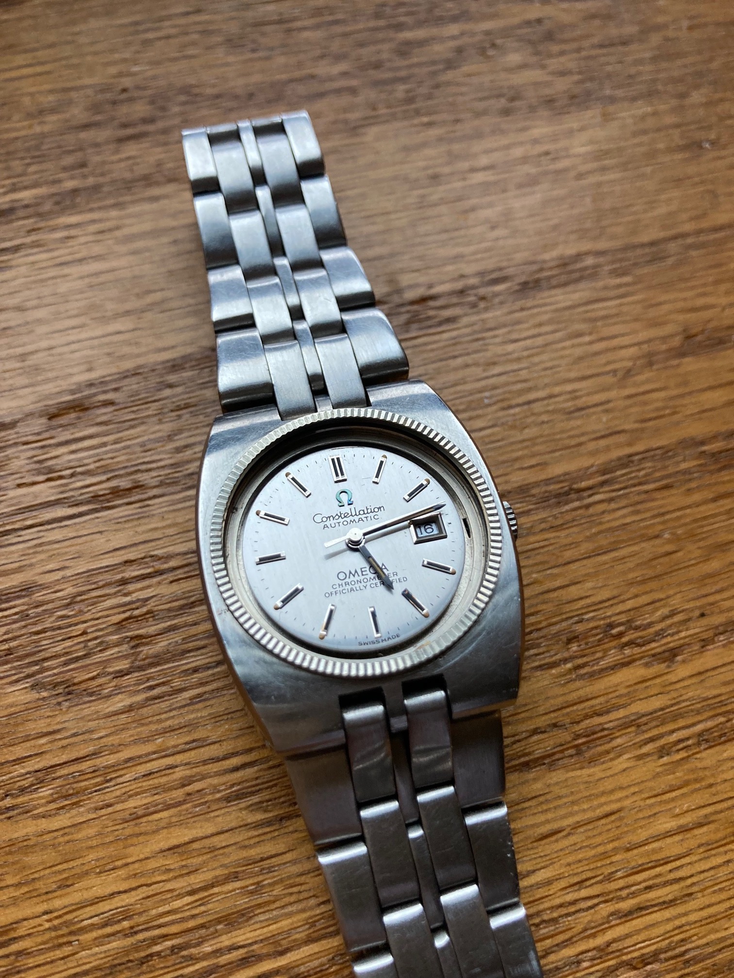

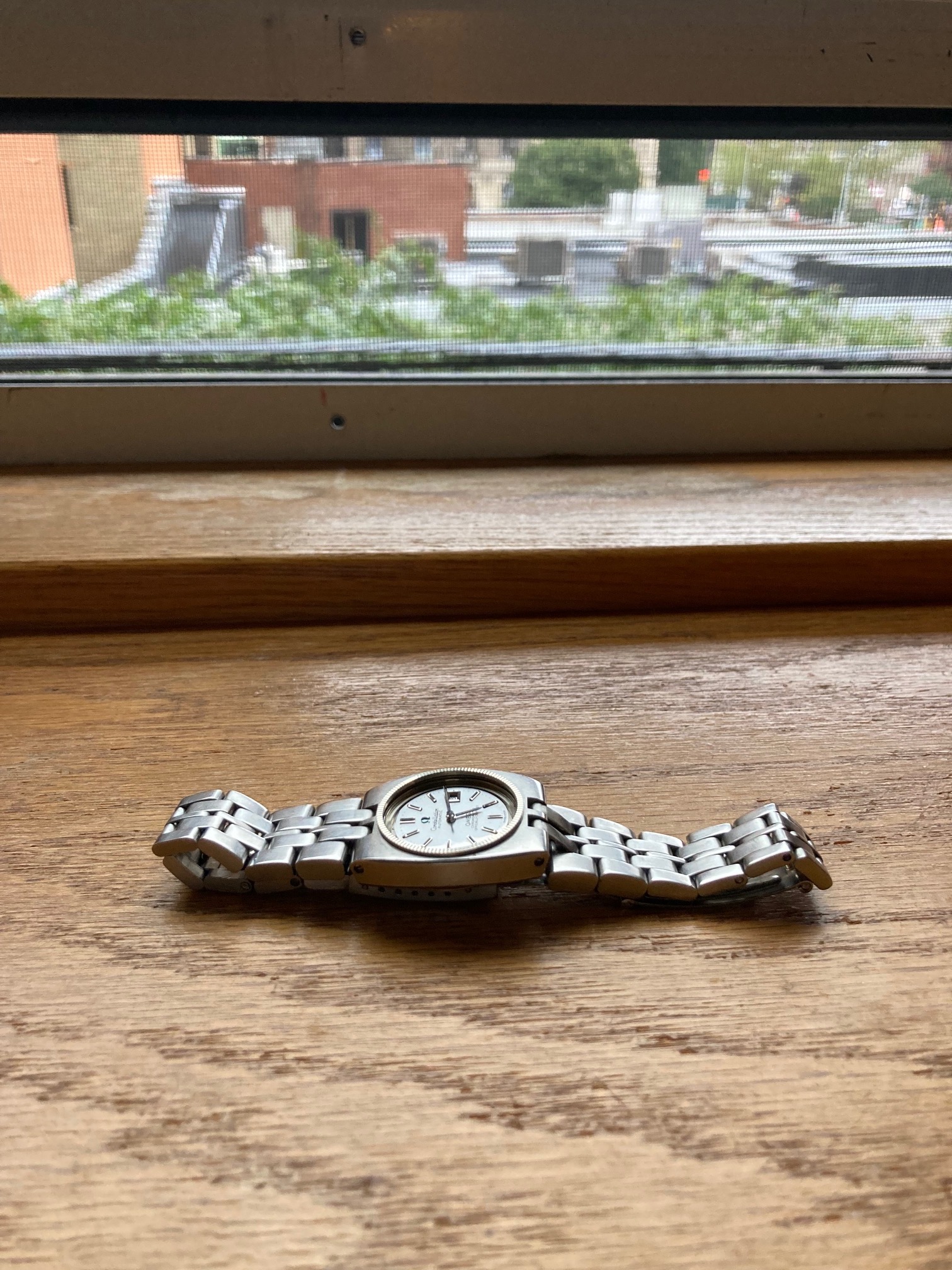

Next, the watch today, stopped and missing crystal:
Thank you for any thoughts and suggestions. I am really unhappy about this!

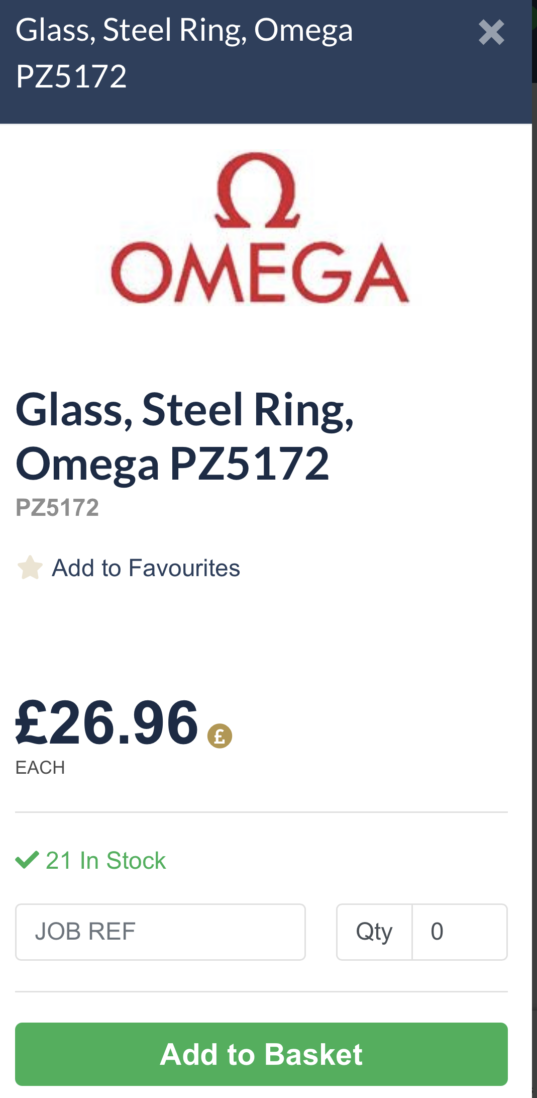

The crystal you need is part number 063PZ5172.

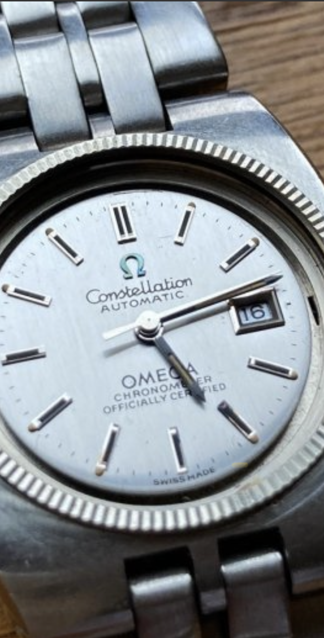

@loveslemon71, welcome to the wonderful world of vintage watches. Did a blow-up of your watch without the crystal:
Looks to me like the seconds hand is slightly bent and is catching on the minutes hand. Very easy issue for a watchmaker to fix.

Thank you @gatorcpa for the very sharp-eyed observation about the second hand. I just took the watch out of the little coffin—I mean Omega box—where it is currently laid to rest, and you are 100% correct! Amazing you were able to see that.

Looks like CousinsUK has these in stock:
With this information, you can at least find a local watchmaker and have them order it from Cousins.
