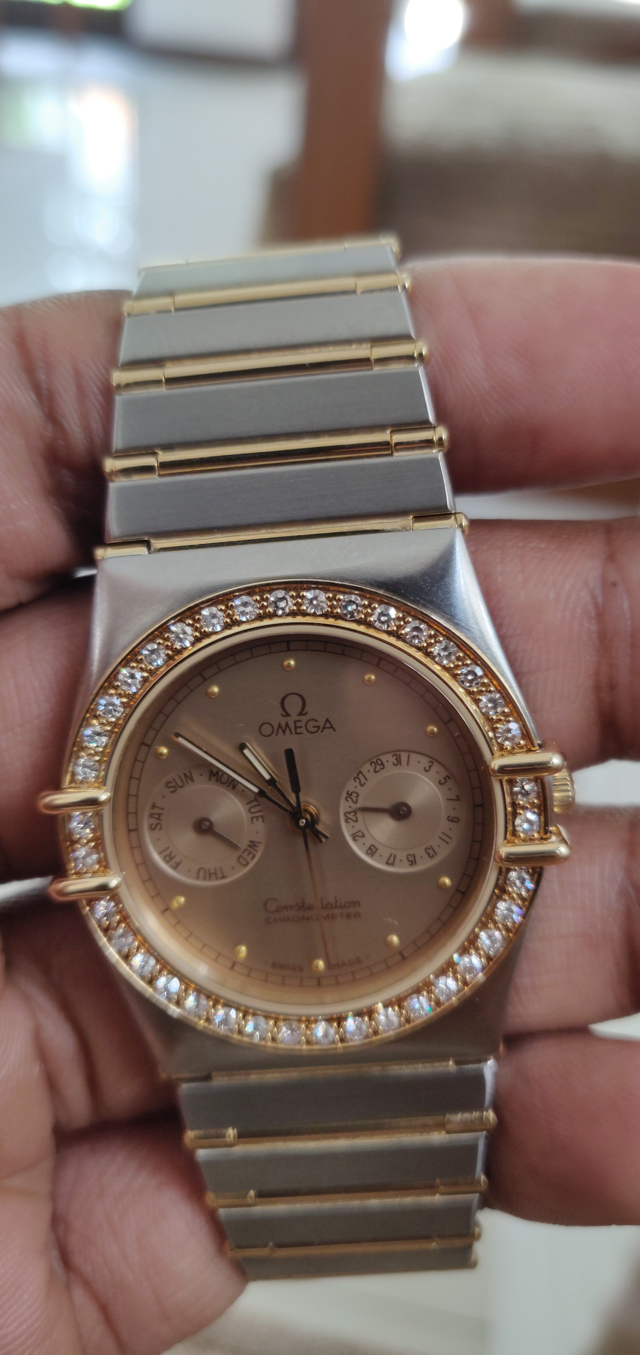

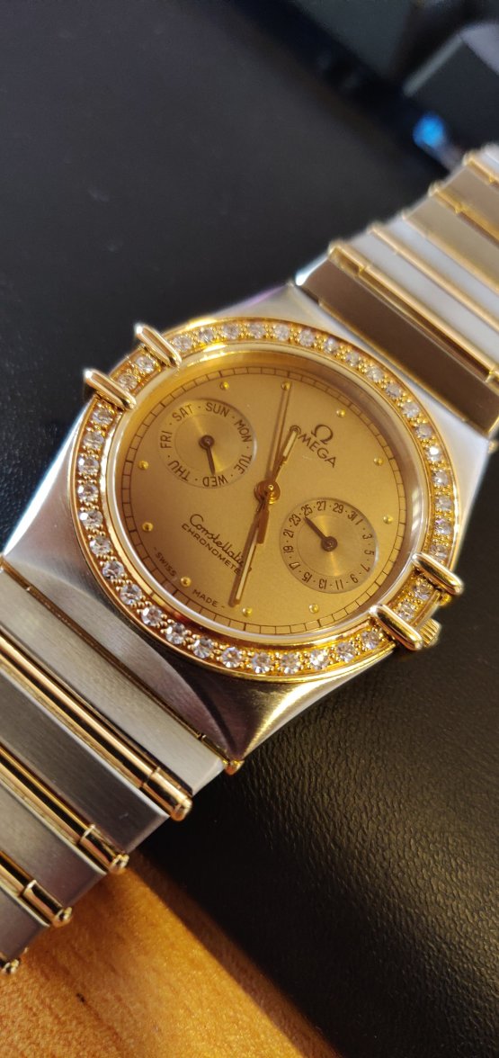

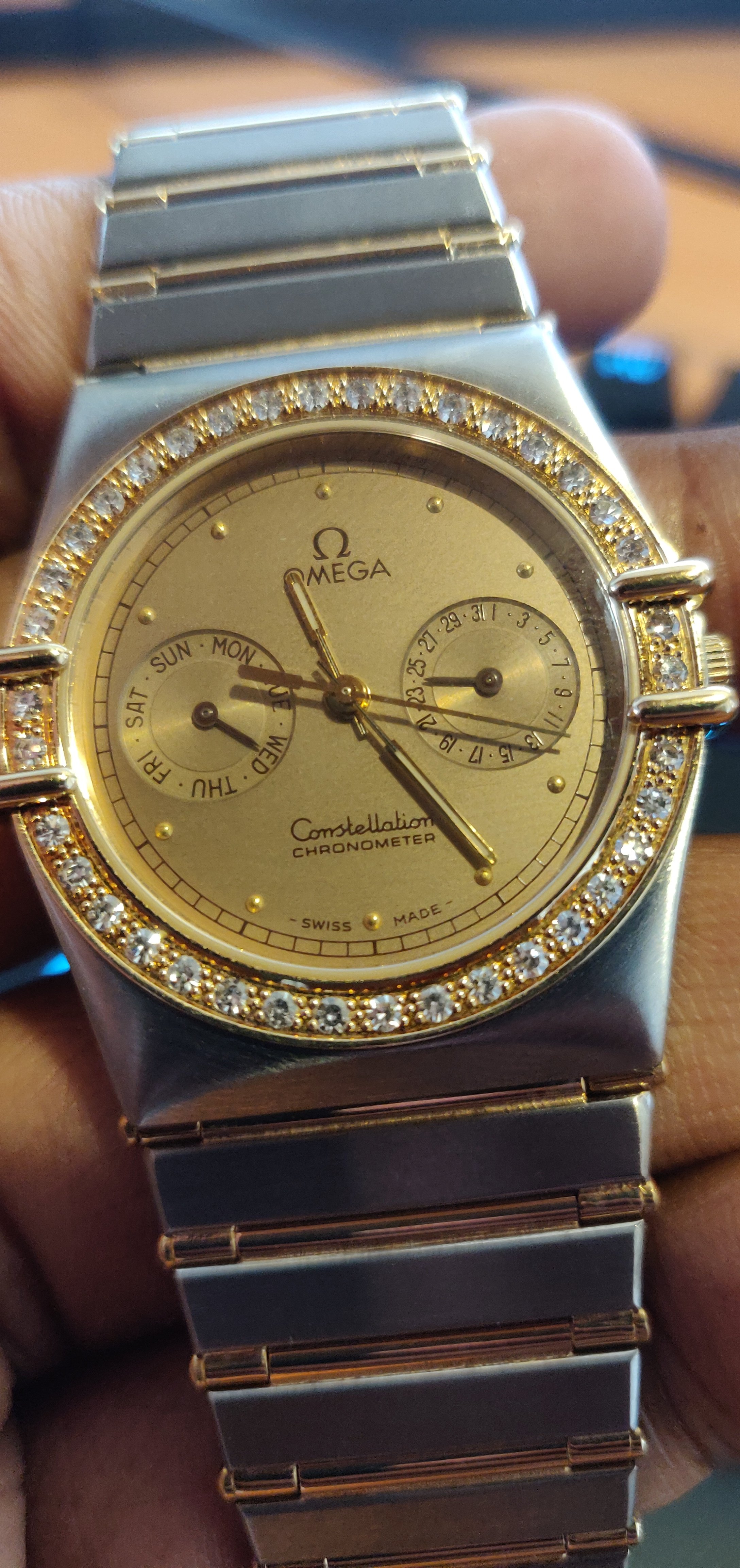

Hi guys would you please be kind enough to tell me details about this watch. Received from a long time friend from japan. It is an omega constellation watch i think made around 1980-1990. I would very much appreciate in depth details regarding this watch and how much it is worth since i cannot find any information regarding this particular watch online. Would really appreciate the effort and help to find information about this.

check ebay completed auctions for your value assessment. details wise it's an early model quartz constellation "manhattan" full-bar (meaning the gold tubes go fully across the bracelet).
4,593
10,813
oh and I should add...it's a fine example and in excellent condition. congrats on the gift 😀

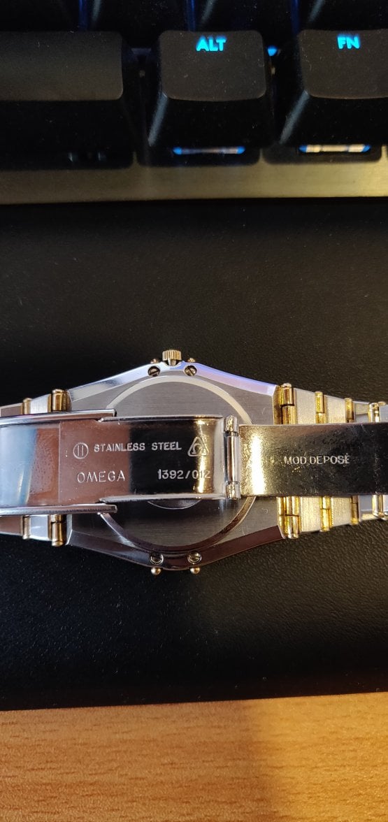

Get a watchmaker to pop the case back off, the model number is on the inside.

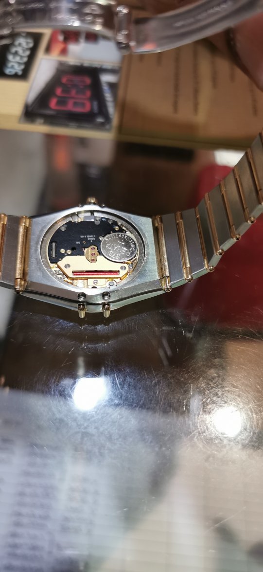

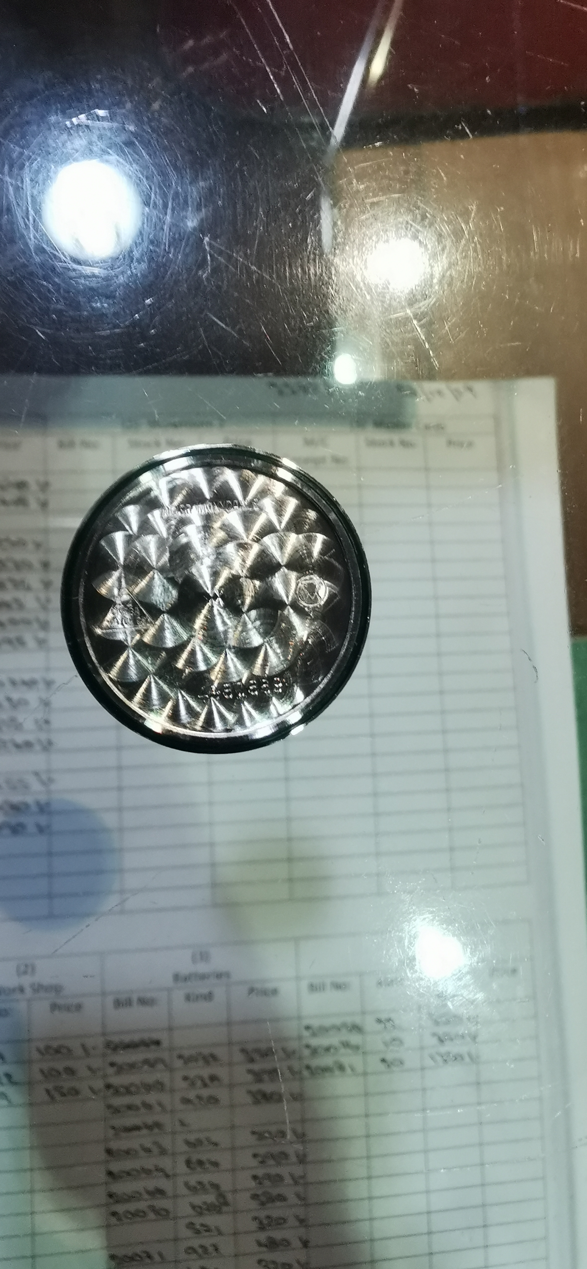

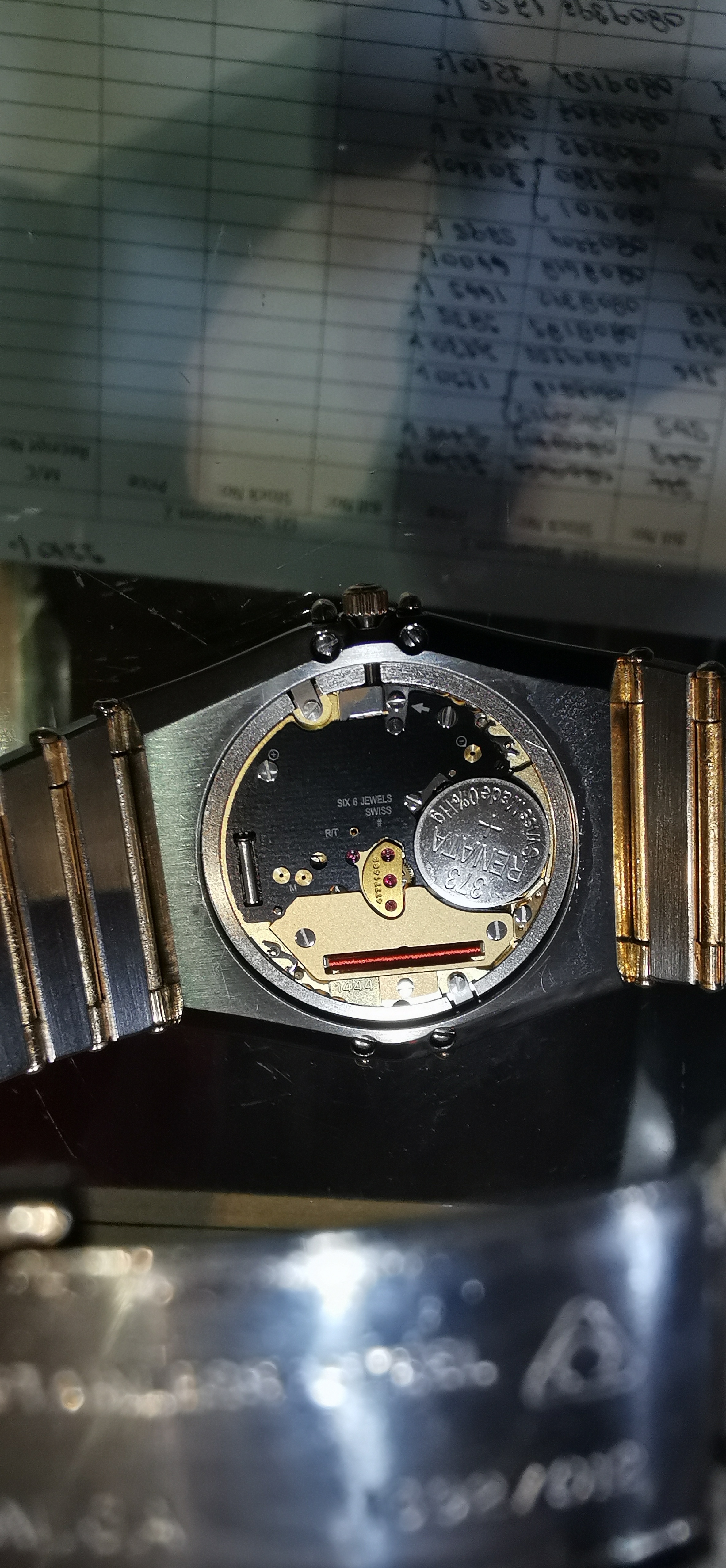

Hi guys I got the back case popped off. I'm a little concerned about the mechanism since it doesn't say omega brand inside. I got this serviced from an official omega agent present in our country. Please have a look and let me know if it authentic.
Thank you 😀
30,270
78,121
It is 498 0869
Thanks. The movement looks fine to me - often these were not marked Omega anywhere on them at the time this was made, but the cover over the coil has the correct movement version on it (1444), and the wheel train bridge has the serial number on it. Using that serial number, you could get an extract showing when it was made, where it was delivered to, etc. if you wanted to pay for that.
The gold bits on this watch are solid 18k gold. The diamonds in the bezel are listed as:
Clarity : IF-VVS
Colour : TW(G)
Diameter : 1.500 mm
Shape and cut : 32 / 24
Weight ( Ct ) : 0.0121 each (x38)
Value on something like this is difficult, partly because it's quartz, partly because these Constellations are not collected like older mechanical versions are, and partly because it has those diamonds. The style is somewhat polarizing with people, at least from what I've seen, so if you are thinking of selling it, you would have to find the right person I think.
If you need a value for insurance purposes, then the information I've given you should help get an accurate appraisal from a jeweler.
Cheers, Al
