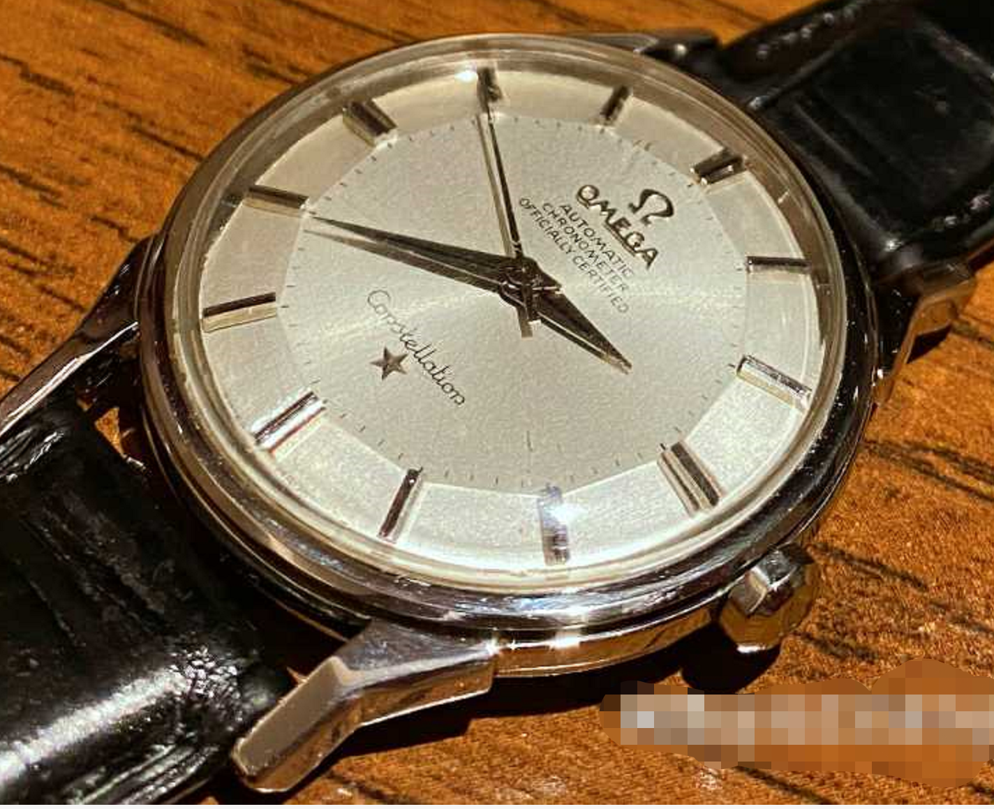

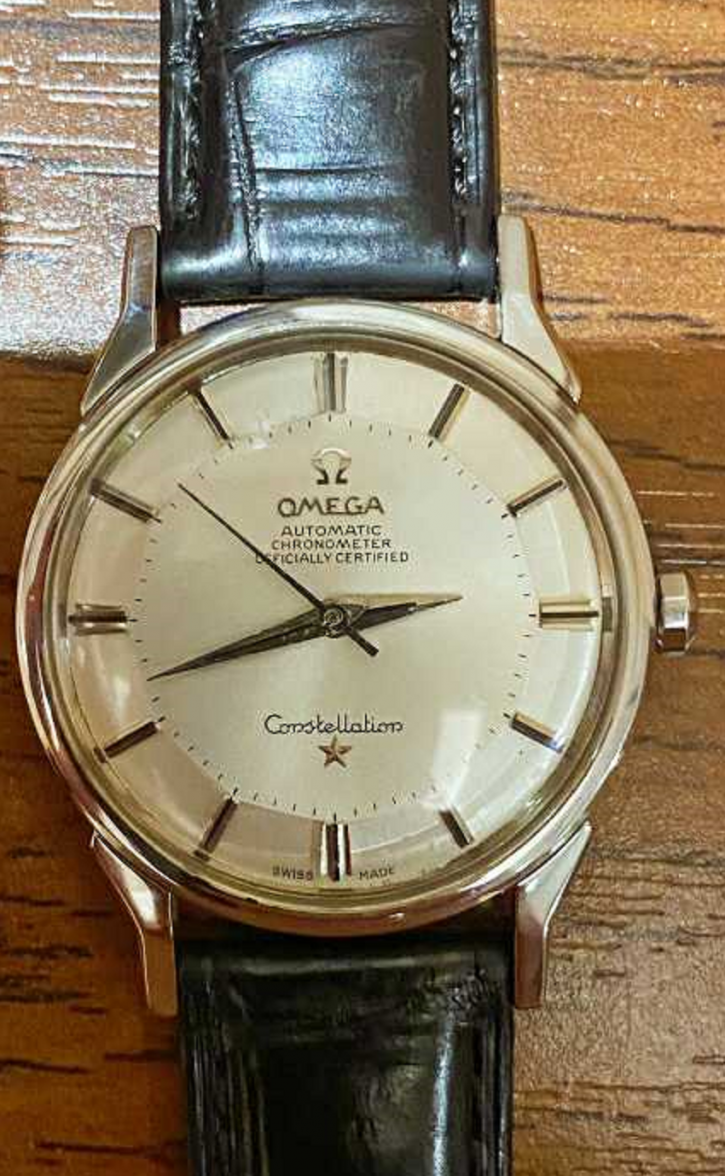

Help,how about this constellation? 167005

A Chronometer marked watch with a non-chronometer rated movement? Not a good sign I would say. Should be a 551.
13,674
19,043
Frankenwatch warning! Some parts have likely been replaced.
Not loving the shape of the star on the dial either.
I’d back away slowly from this watch.
but, but, it says adjusted 5 positions on the bridge......😒
Apart from the movt being the wrong calibre - if the serial is 18,1xxx, then it’s also most likely a year or two too early for a 167.005.
Double bubble trouble.

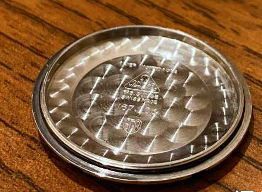

I'd like to see the case back, I have some doubts.

A sure pass for me. There are many other examples out there just be patient.
1,441
3,809
At least a redial and incorrect movement but not sure of the authenticity of the case. No reason to pursue this watch further
