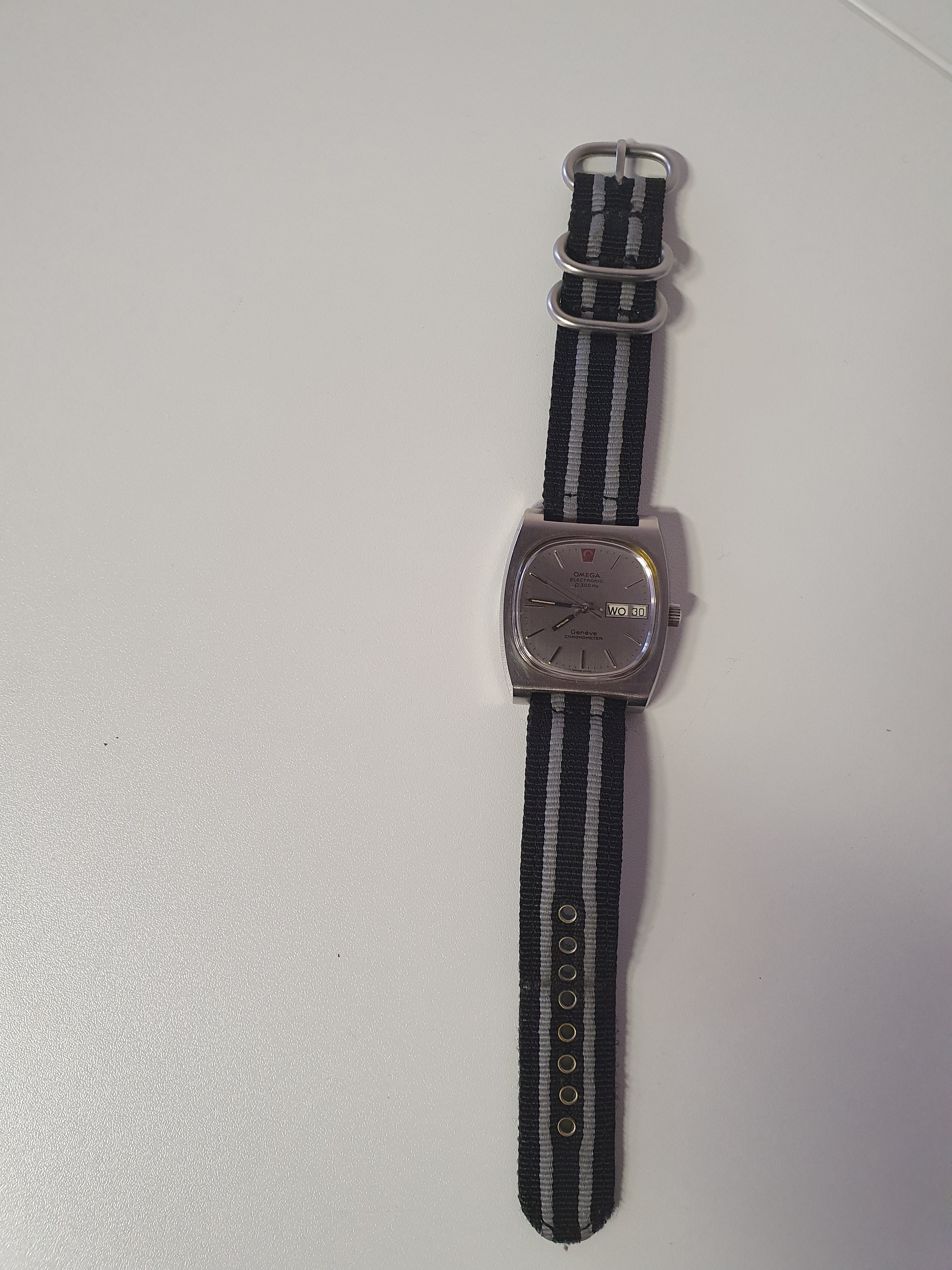

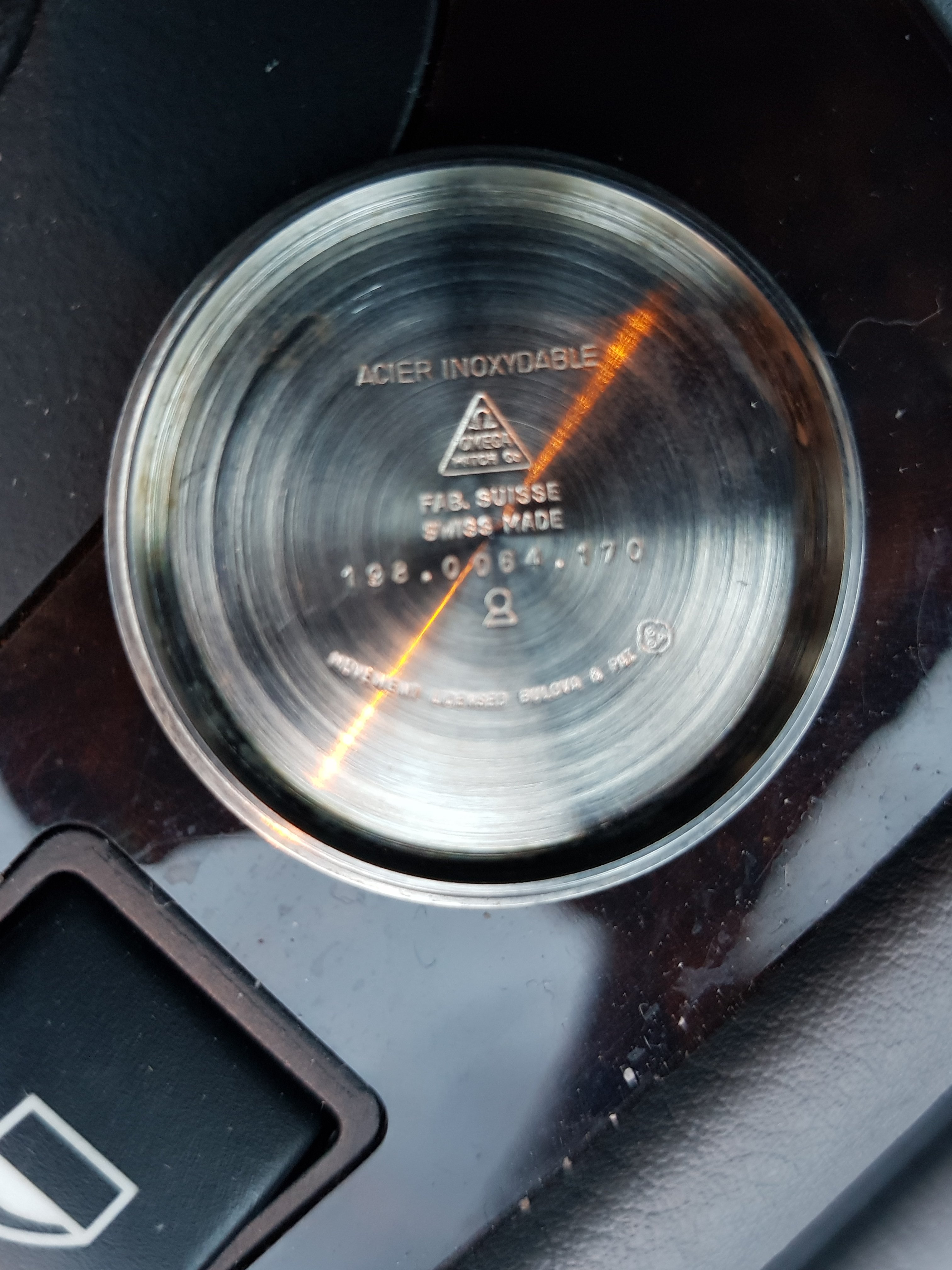

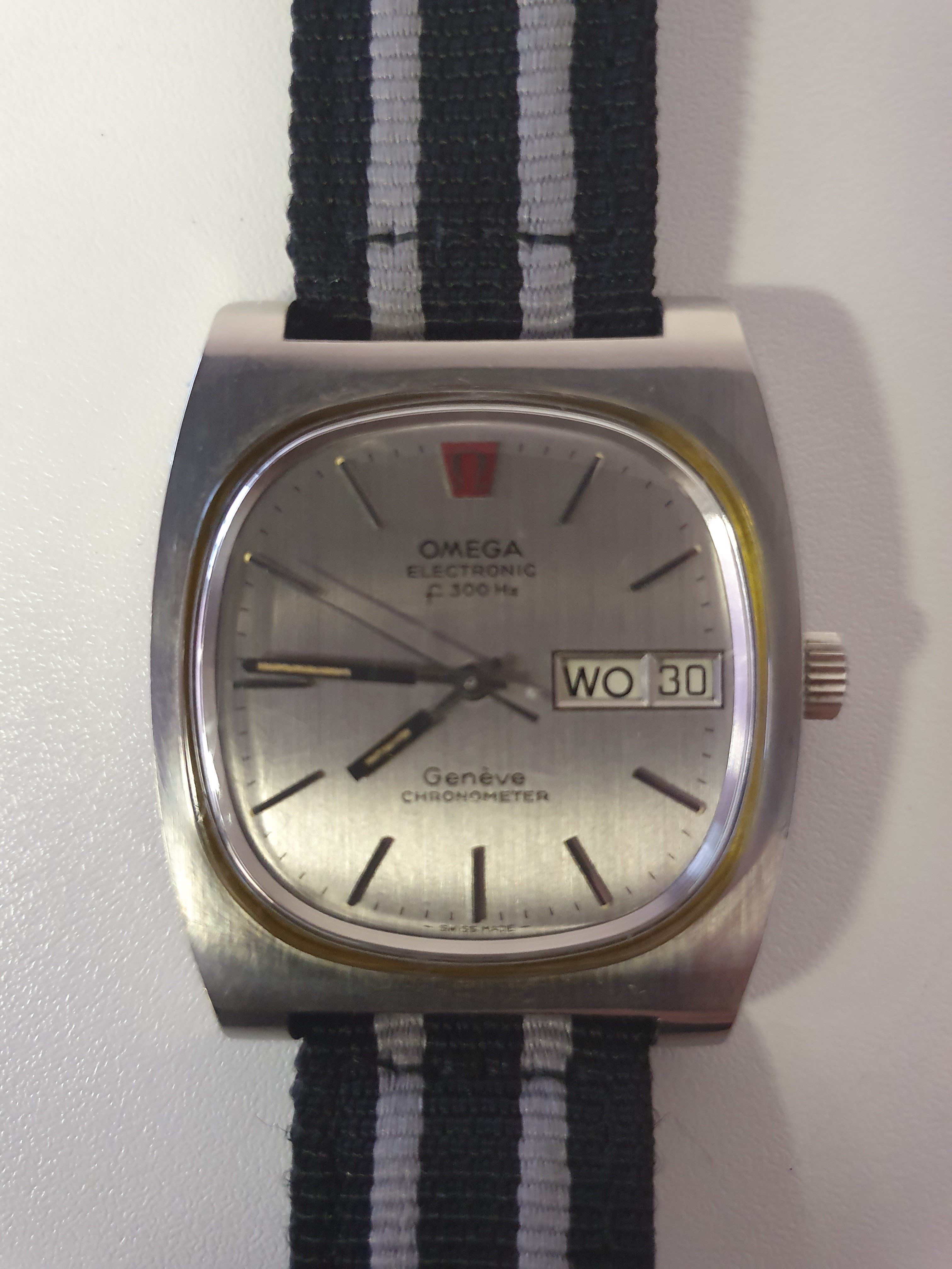

I am beyond a novice when it comes to Omega watches so I thought it would be best to ask the experts. I own an old Omega and from the basic searching I could do I believe it may be a 1973 but I was really hoping you guys could give me more detail. I was wondering ...
a) From the pics do you feel it looks genuine and not a replica?
b) Do you have any idea on the year of manufacture?
c) Do you have any idea what the original strap would have looked like?
d) What do you think the approximate value of the watch would be?
e) Is it a rare model?
f) Is it a collectable model?
g) What would be your best advice for me in connection with care, cleaning, storage etc.
Thanks so much

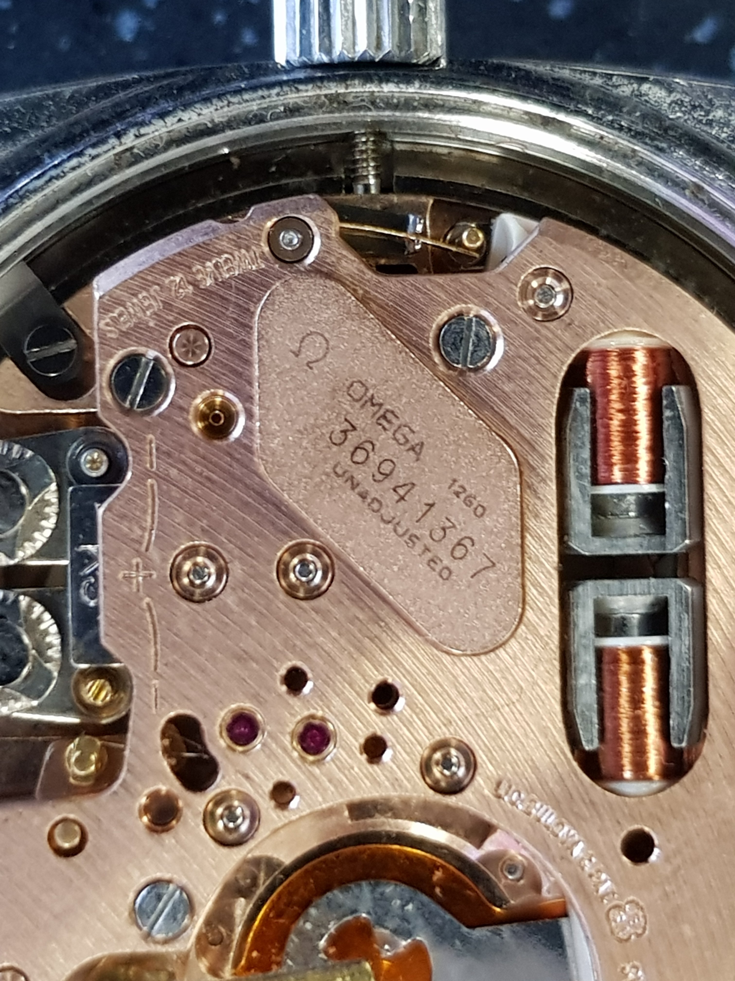

What are your thoughts on the chrono dial and unadjusted on the movement.
I’m not up on hummers, so it may not be an issue.

I'll answer what I can...
Genuine
Looks to be around 1973
If it hasn't been serviced, it likely needs to be. Not all watchmakers work on tuning fork movements, so there are a number of specialists that do that I'm sure some here can direct you to.
I don't think it is a problem. The dial is correct for this reference - the dial shown on the Omega Extranet for this is marked as a chronometer. These movements really didn't have "adjustments" in the traditional sense, so I can see that both could be true at the same time.

Most of your questions have been answered, all I can add is that the watch would have originally come with a plain black leather strap.
The buyer would have been offered the option to purchase a bracelet at the time but may not have as I would expect a bracelet to outlast a strap.

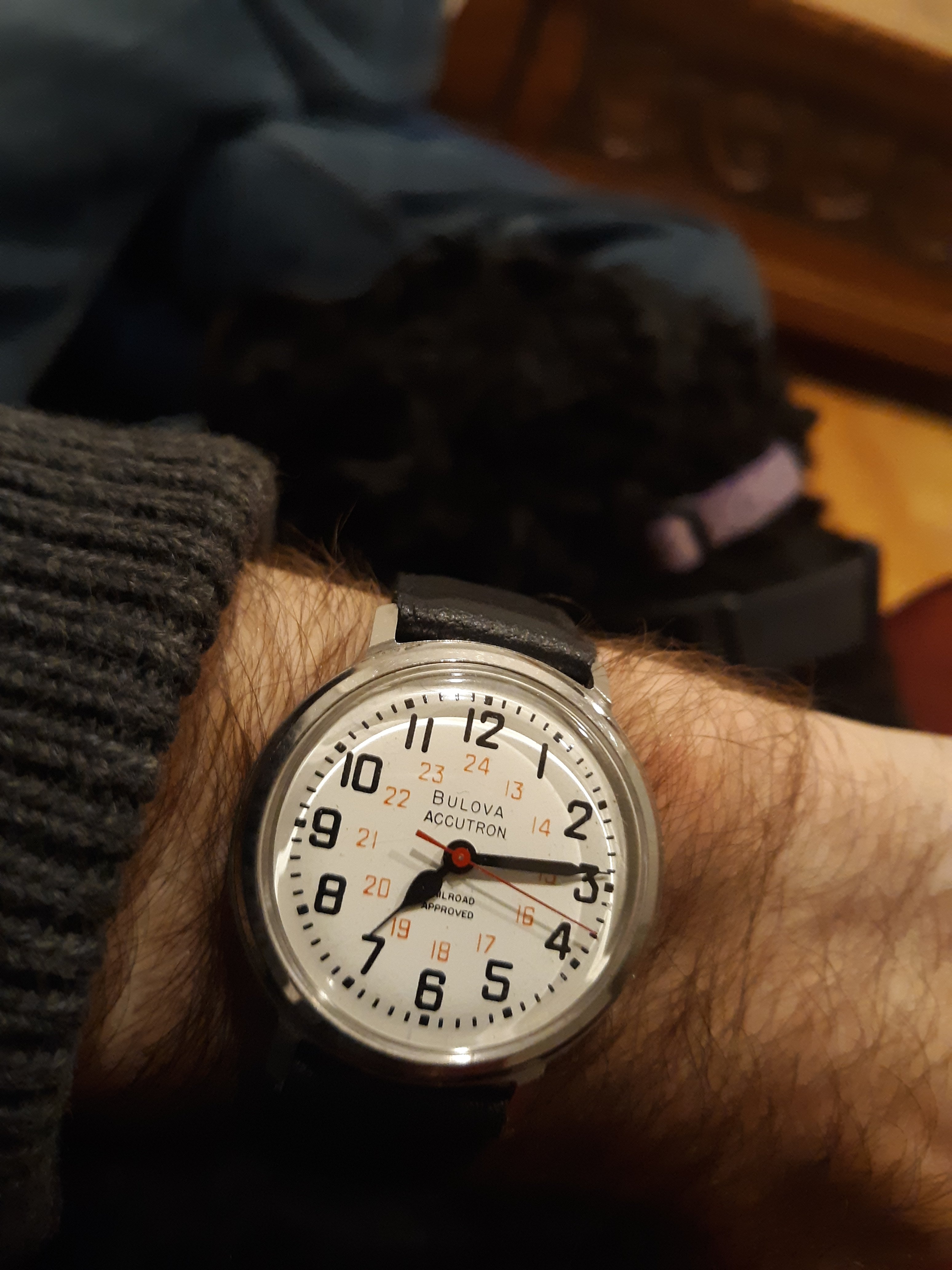

The Electric Watch page @STANDY gave you is a great resource. What you have is an Omega f300 tuning fork watch. The first successful battery powered watches used tuning forks driven by battery. Your watch vibrates 300 times per second and turns a gear with 300 tiny delicate teeth. The first tuning fork watches were made by Bulova and called Accutron. The Omega watch you have came later, but licenced tech from Bulova. Here is the watch I am currently wearing.
You have a cool piece of history worth preserving. Let us know what part of the world you live in and we can recommend where to get your watch serviced.
