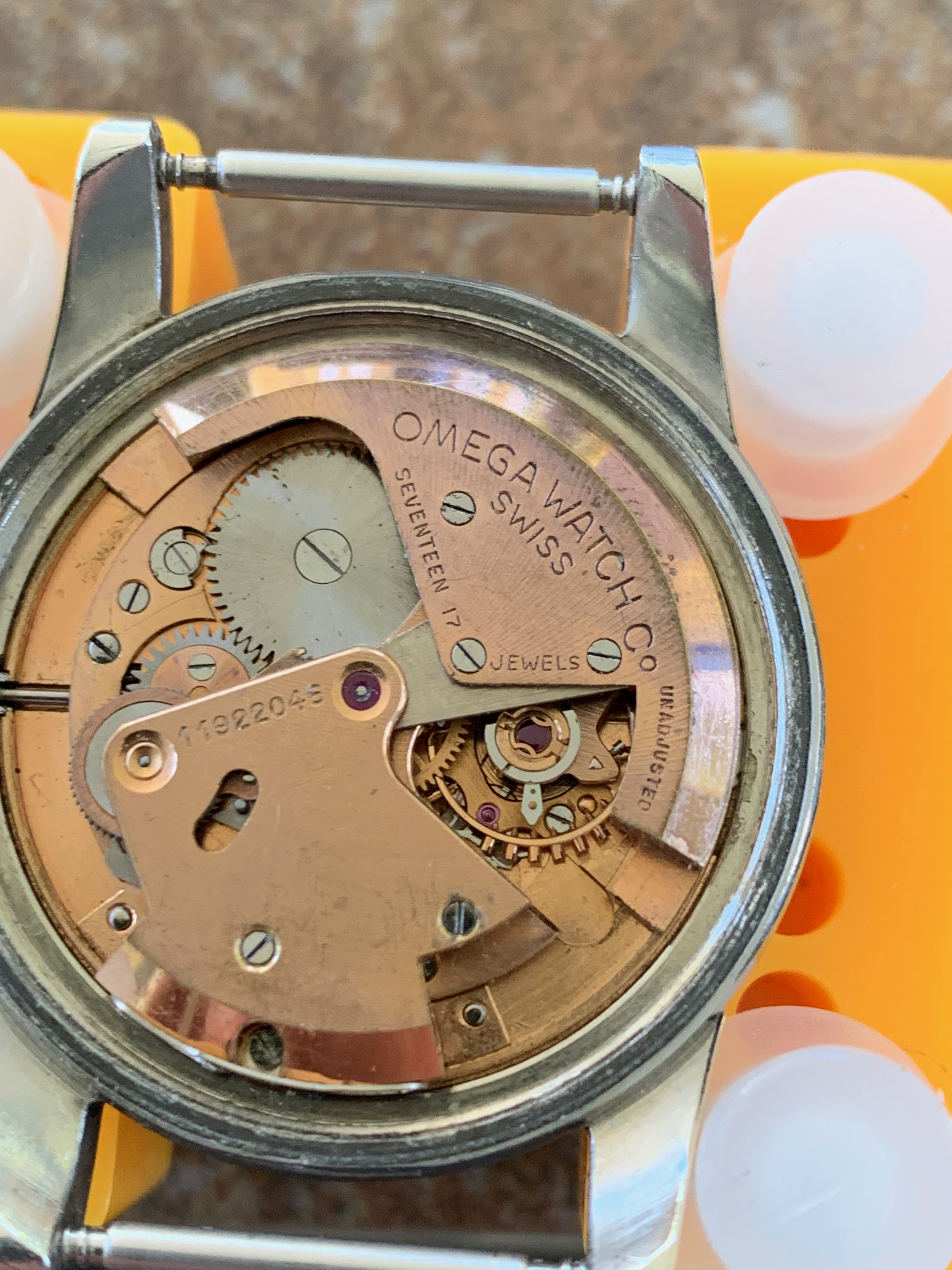

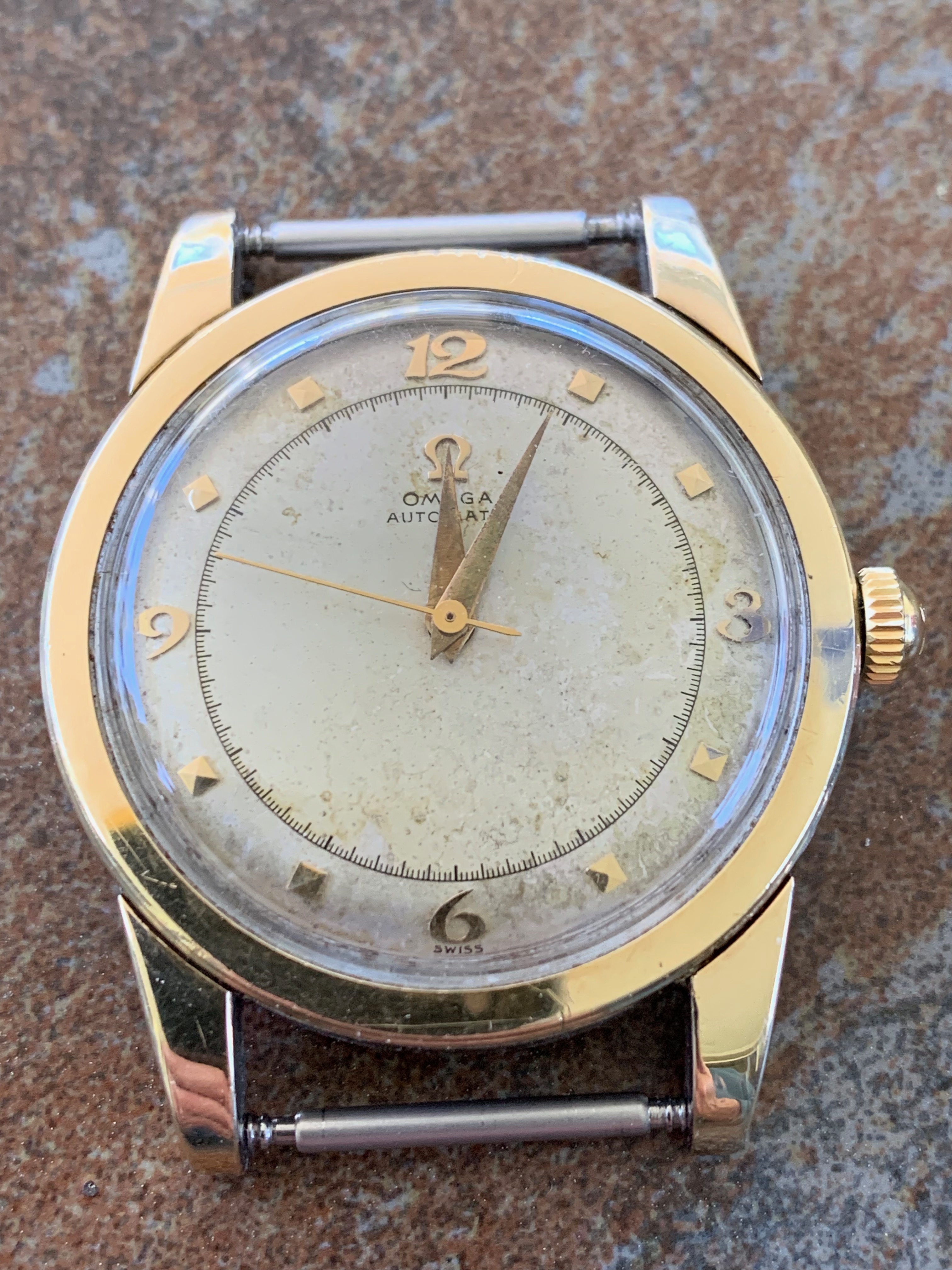

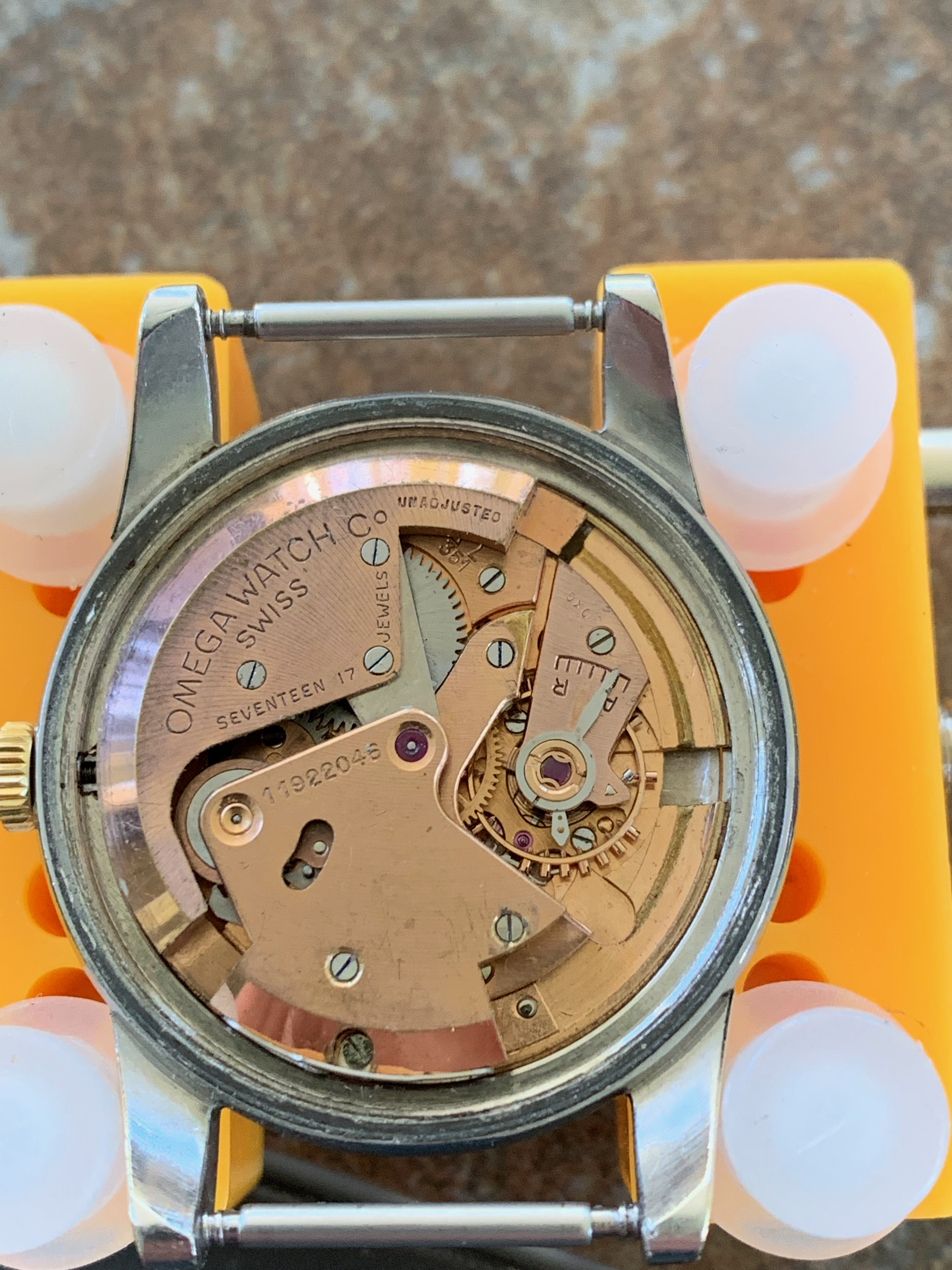

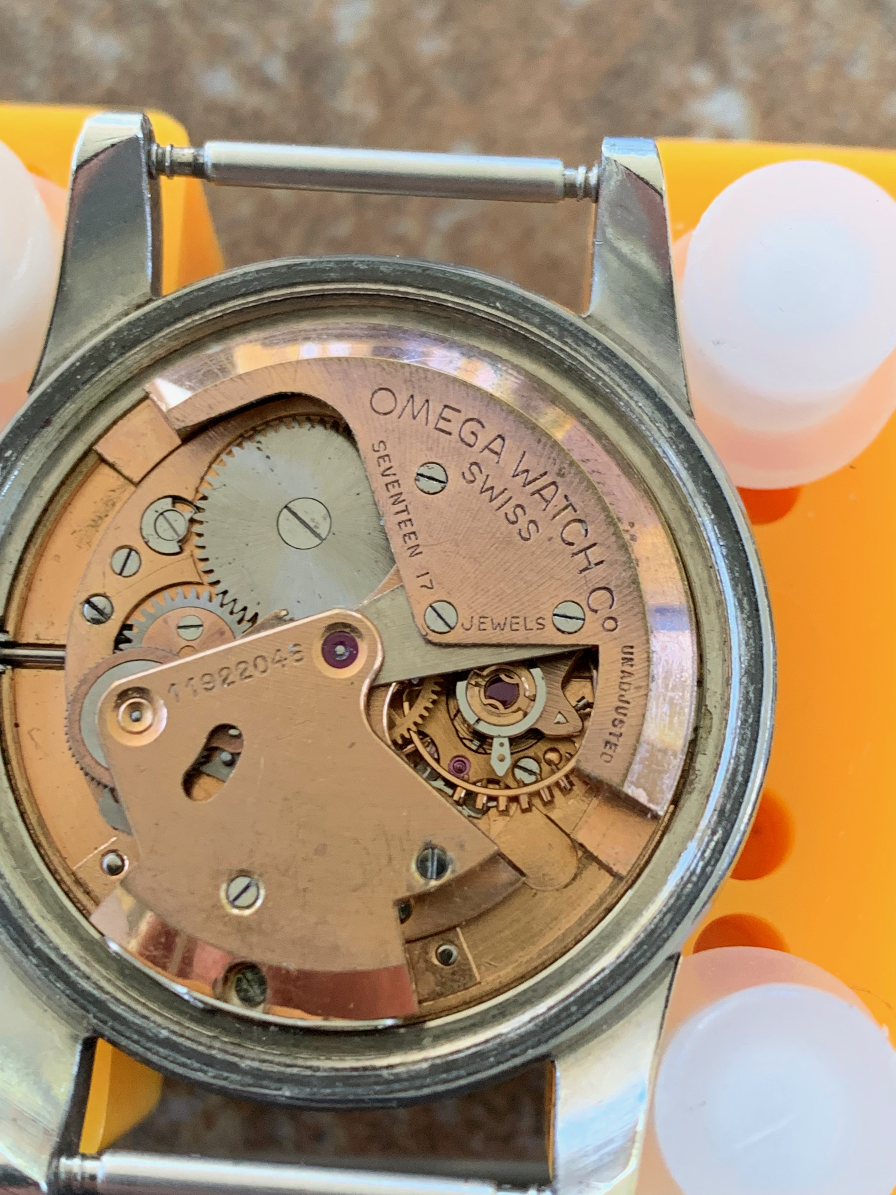

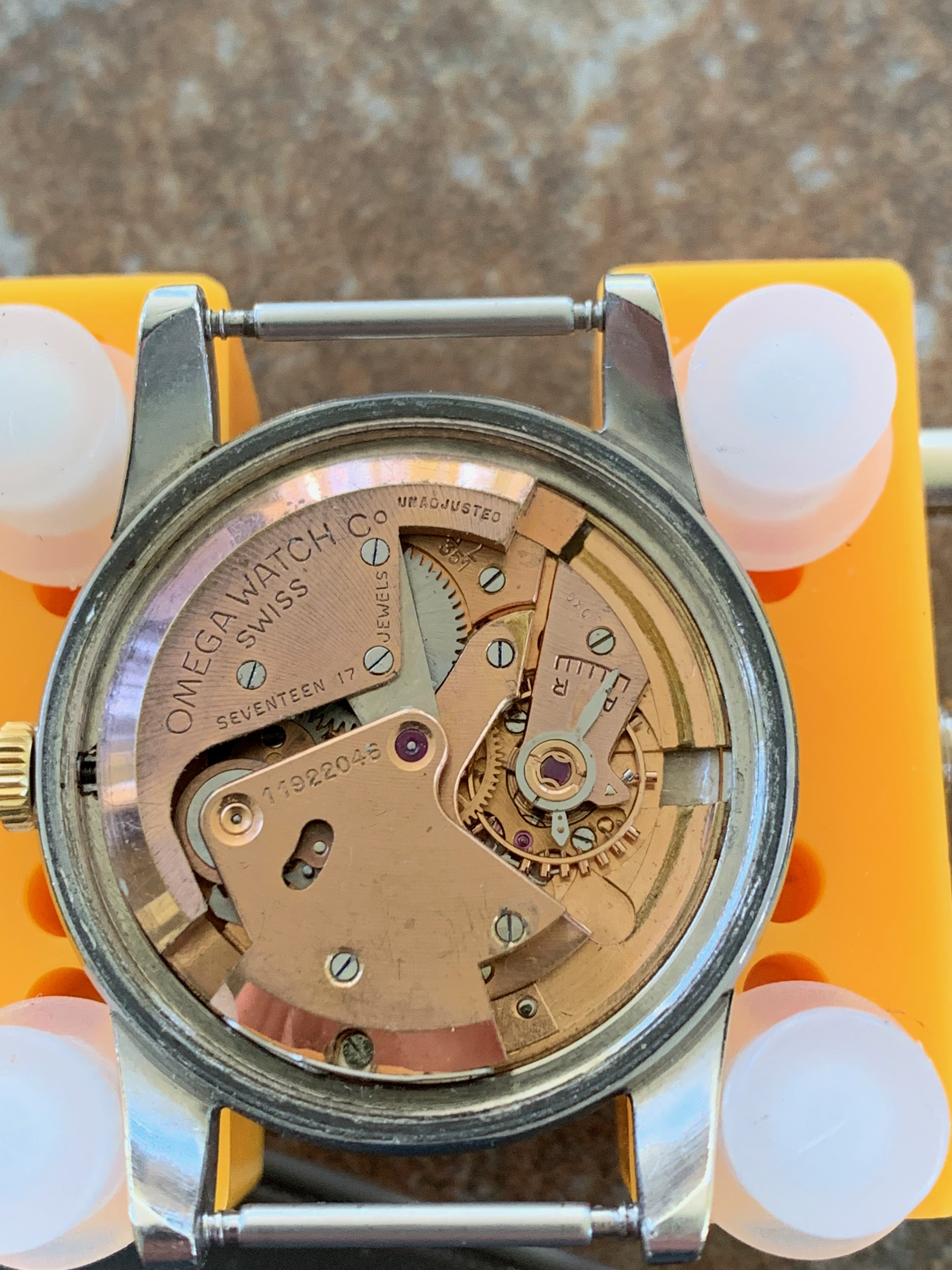

Hi Everyone:
I have a 1949 Omega bumper watch that was my dad's. A couple of years ago I had it serviced, and it ran well for a year. Then it stopped holding a wind. The watchmaker said he couldn't find the parts and identified them as the two parts that hold the bumper, not the bumper itself. I found parts diagrams online, including one from Otto Frei in Los Angeles. I spoke with them today and they could not identify the part numbers needed. The guy there tried to help and told me the 351 is based on the 330 and has many of the same parts. Here's a link to the parts diagram and list on their site, which isn't https, so my browser says it's not secure. It is the actual company, though.
http://www.ofrei.com/page1457.html
Here are photos of my watch, which I sent to Swatch / Omega to see if they could repair just what was needed. They quoted $650 plus tax and shipping and only offered to restore or replace everything that was worn. I want to keep the patina on the face and everything else had been working, so no thanks!
30,280
78,140
Not sure what your watchmaker means when he says “the two peta that hold the bumper”?
If you fully wind the watch by the crown, how long does it run for?
24,836
55,255

There are 3 parts in regards to the rotor. The top bridge (with serial number), the rotor arm (attached to the rotor) and the underside rotor bridge (not seen in the Otto Frei parts image)
Parts - 1009, 1013 and 1403 Two parts that hold the rotor arm pins are the first two
Crown not original. Omega, but not the right design. Leave it.
10:00 index is loose and not positioned properly
Parts not that rare and should be easy to find. Do an Ebay search on the numbers

I didn't understand this: "10:00 index is loose and not positioned properly." I don't know if it can be explained in the way that a non-watchmaker like me would understand, though.

Just look closely at the applied 10 o'clock marker and you will see that it is not oriented correctly.
You have a good eye! Is something like that fixable?

It runs for about two minutes. BTW it didn't break by winding it too forcefully. I was winding as I had for the prior year.

Then I suspect the problem isn't related to the automatic winding - there's something else wrong with the movement.
