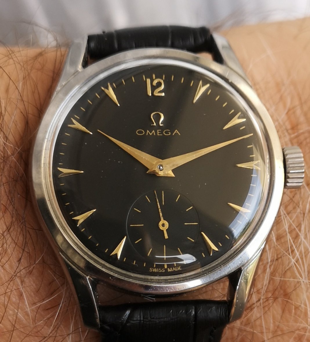

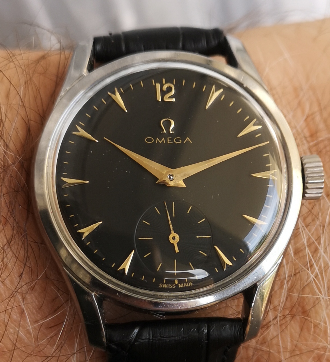

Posts 15 Likes 31 szab.g.i ·May 11, 2020 Hi everyone! Seems redial for me but what do you think? Thank you!
Posts 10,804 Likes 16,814 padders ·May 11, 2020·Oooo subtitles! Deffo redial. Font is wrong, has lume wells but no lume (or lume on hands) min ring is misaligned with the 10 index and lastly is has a clean black dial, which is always suspect. Edited: May 11, 2020
N Posts 1,120 Likes 1,792 Noddyman ·May 11, 2020 szab.g.i Seems redial for me but what do you think? Correct
