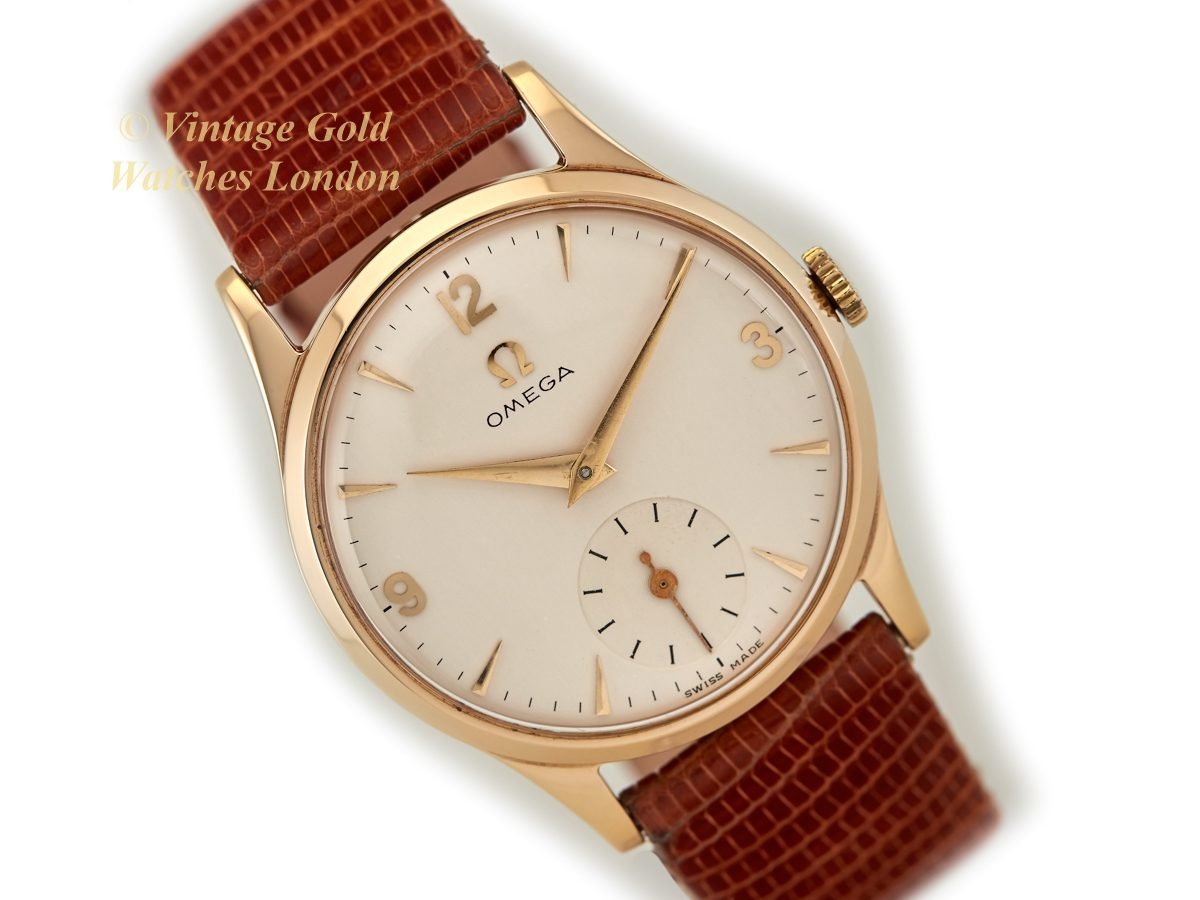

For comparison here is a reference photo of an Omega 266 which I've found for sale online offering this watch with an authenticity guarentee.

The dial looks attractive in my opinion. The other one you show on the picture below has quite bold subdial markers, so not sure it’s 100% genuine. If you want to compare best, search the reference on omegaforum and there might be sales posts you can refer to.
