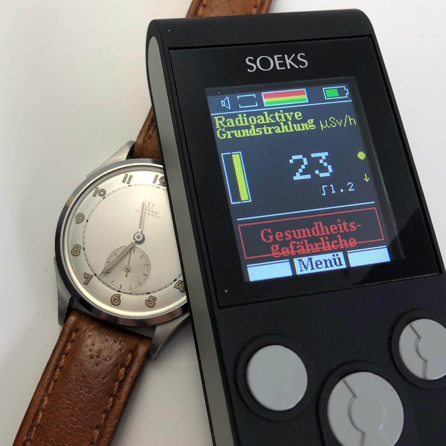

Playing with a Geiger Counter and 2998’s

A little wrong usage as it makes 10 counting cycles and then presents the results.
Values measured are on the low side. One sm300 of a friend shoots up to 37 and i use exactly same counter
10? There will be very little change after three or four cycles. And 17/19 are not "low" readings.
I am not suggesting that they are dangerous, but plenty of radium watches test in the single digits.

i don't argue how to use it correctly
as shown it doesn't make sense from 2nd watch on as u have to start a new cycle for every watch .... period
i can only tell what i measured over time and a 2998 foll radium dial and hands shouls have at least 17 ....
Relax.
It’s not intended as a serious test for peer review.
Just a bit of fun for those unfamiliar with Geiger’s and Speedmasters.
A full test as you rightly point out would have a different methodology and results

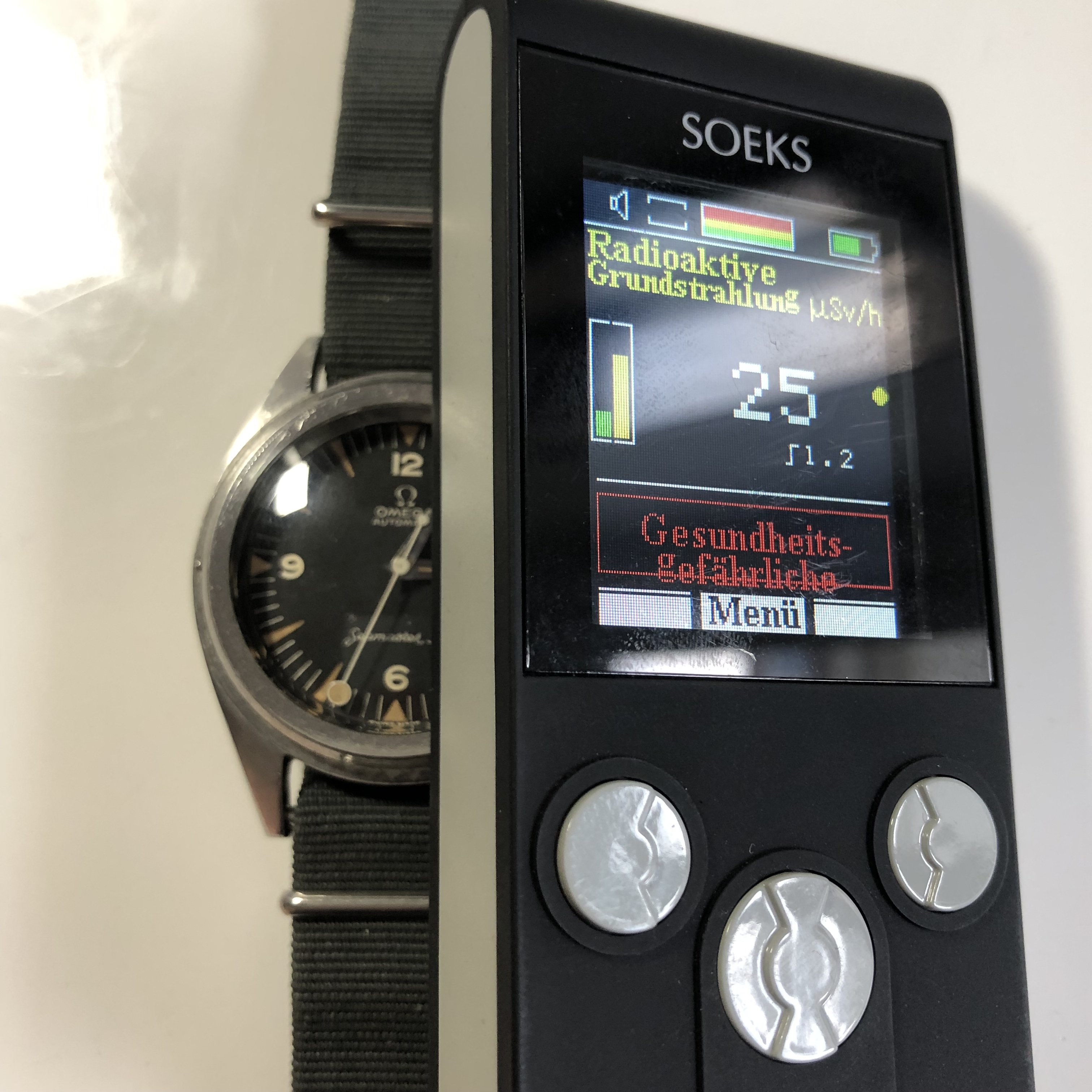

Note that many Geiger counters and dosimeters (including the Soeks shown in this thread and the Radex I own) don’t detect alpha radiation at all. And even those that can often are unable to distinguish between alpha, beta, or gamma particles.
Since these instruments are used to measure radiation doses and rates, not the damage caused by someone ingesting an alpha emitter, the extremely short life and penetration power of alpha particles makes them irrelevant, and therefore also irrelevant when handling a non-disassembled watch, not to mention stopped by the plastic case of the instrument before they can reach the detector tube at all.
That said, my 2914-3 Railmaster measures 28uSv/h from the front and 2uSv/h from the back.
