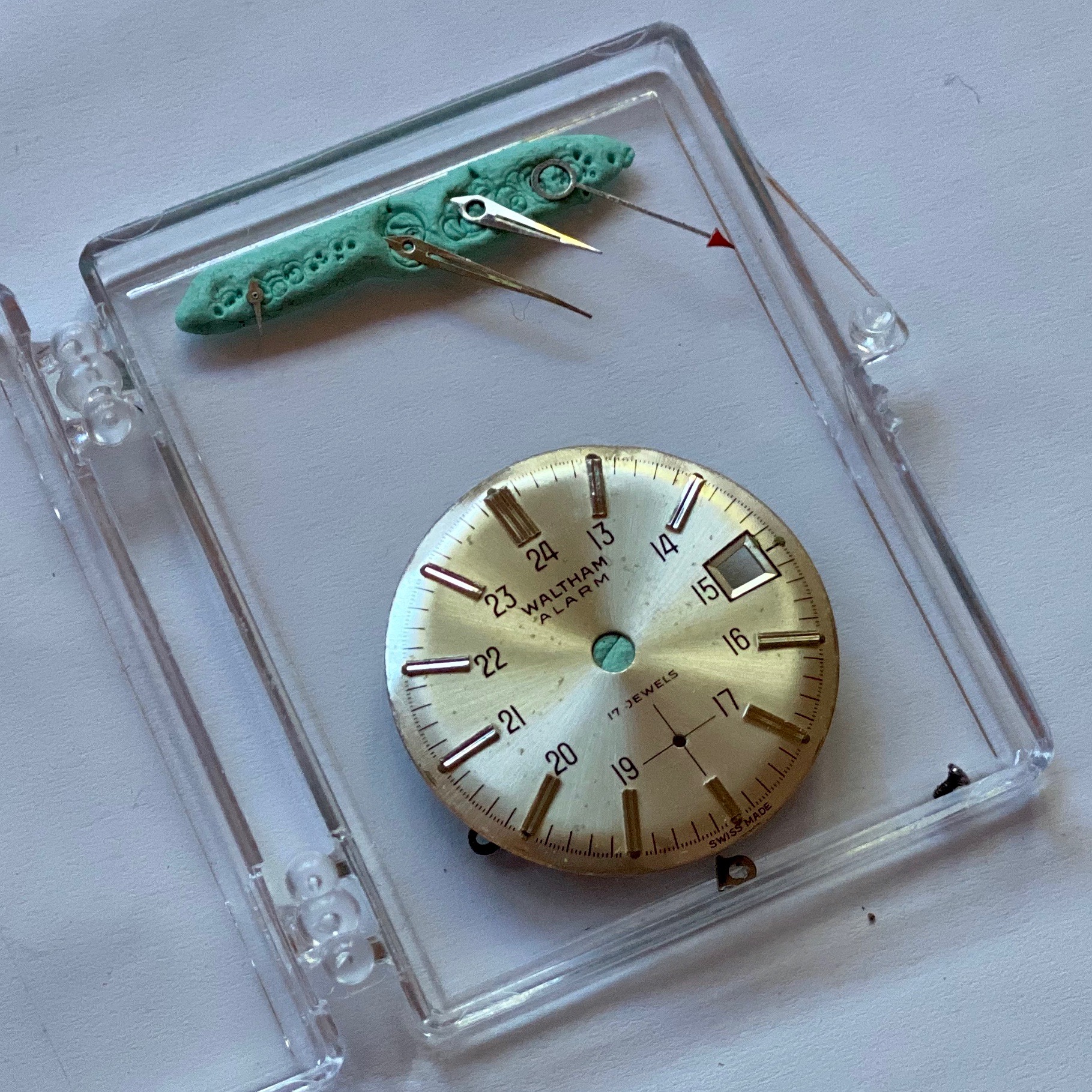

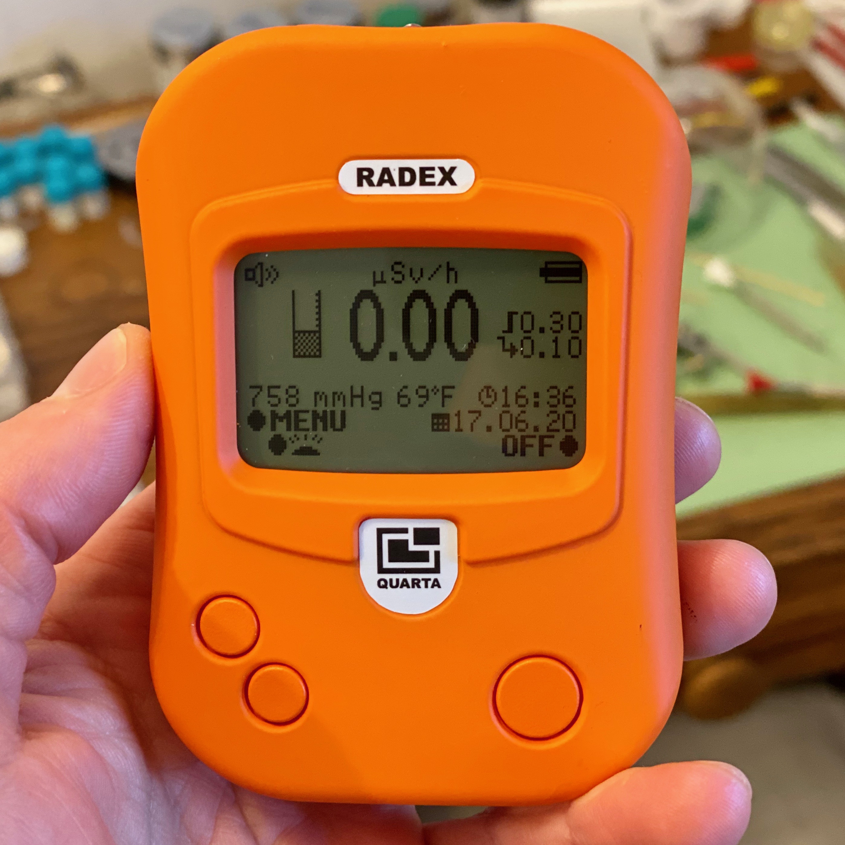

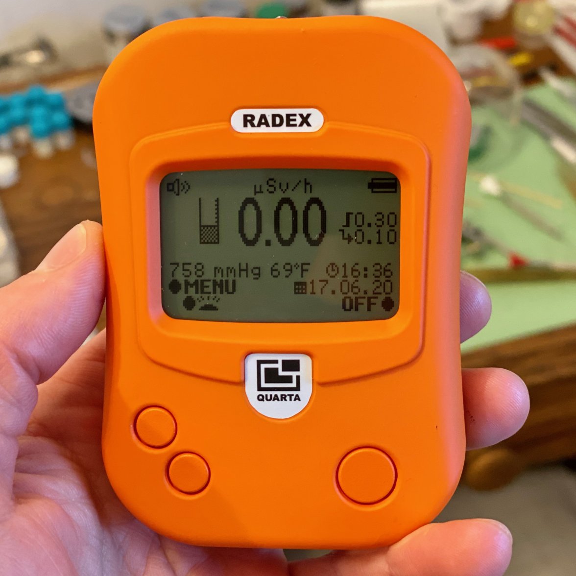

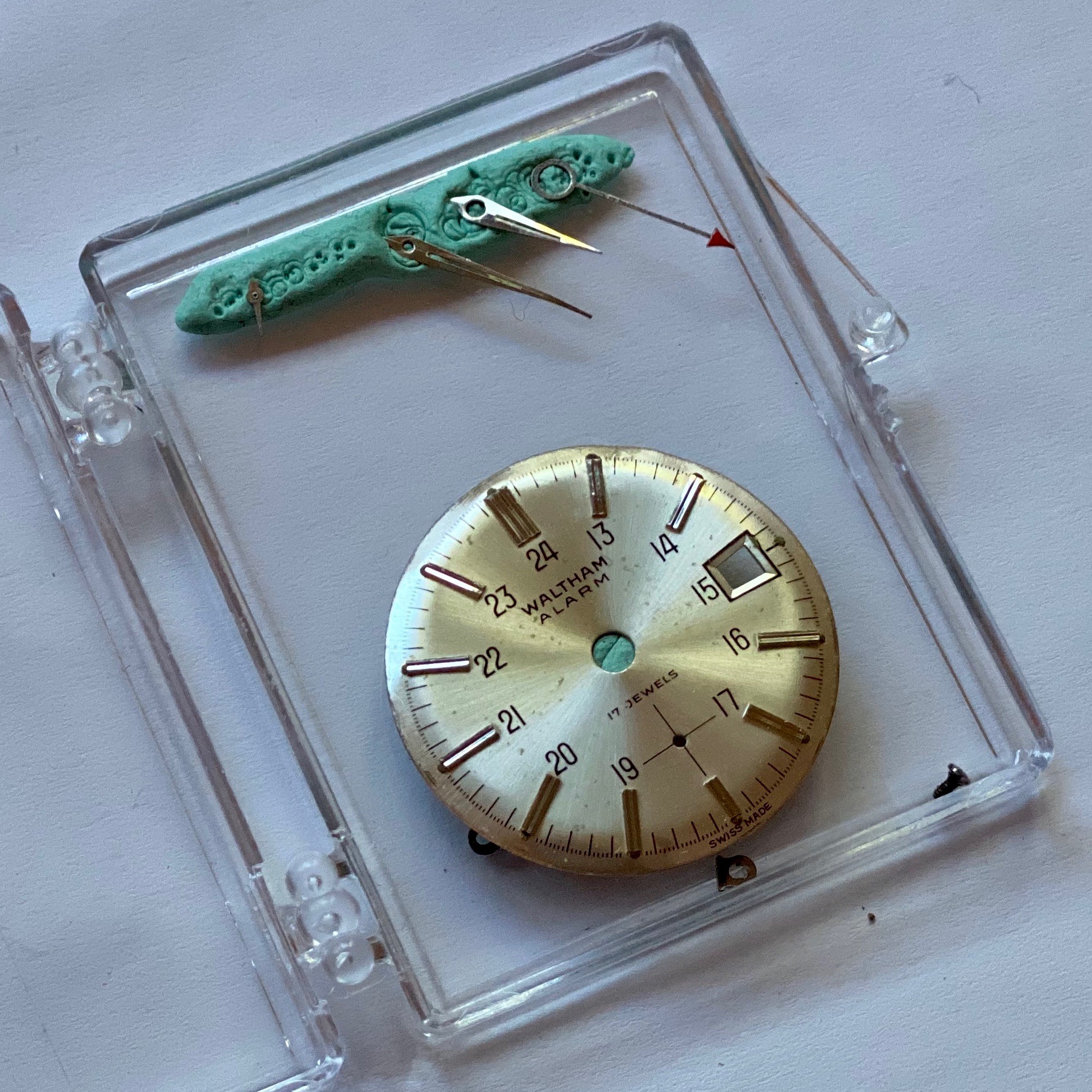

Well I got the Radex RD1212-BT Outdoor edition - obviously so I can take it off roading in a hurricane. Actually it was nominally more expensive than the base model but offered with next day Amazon Prime delivery.
Fired it up and tested it on my suspect dial...nothing. Nothing at all. Well, it did indicate 0.10 background radiation. I suppose that's good but part of me was hoping it would indicate Radium just so I could see it work.
But this poses a question for me - this particular device only detects Beta, Gamma, and X-Ray. NOT Alpha. I'm no nuclear scientist so here comes my dumb question: do I need a geiger counter that detects Alpha particles to determine if I have a Radium dial?

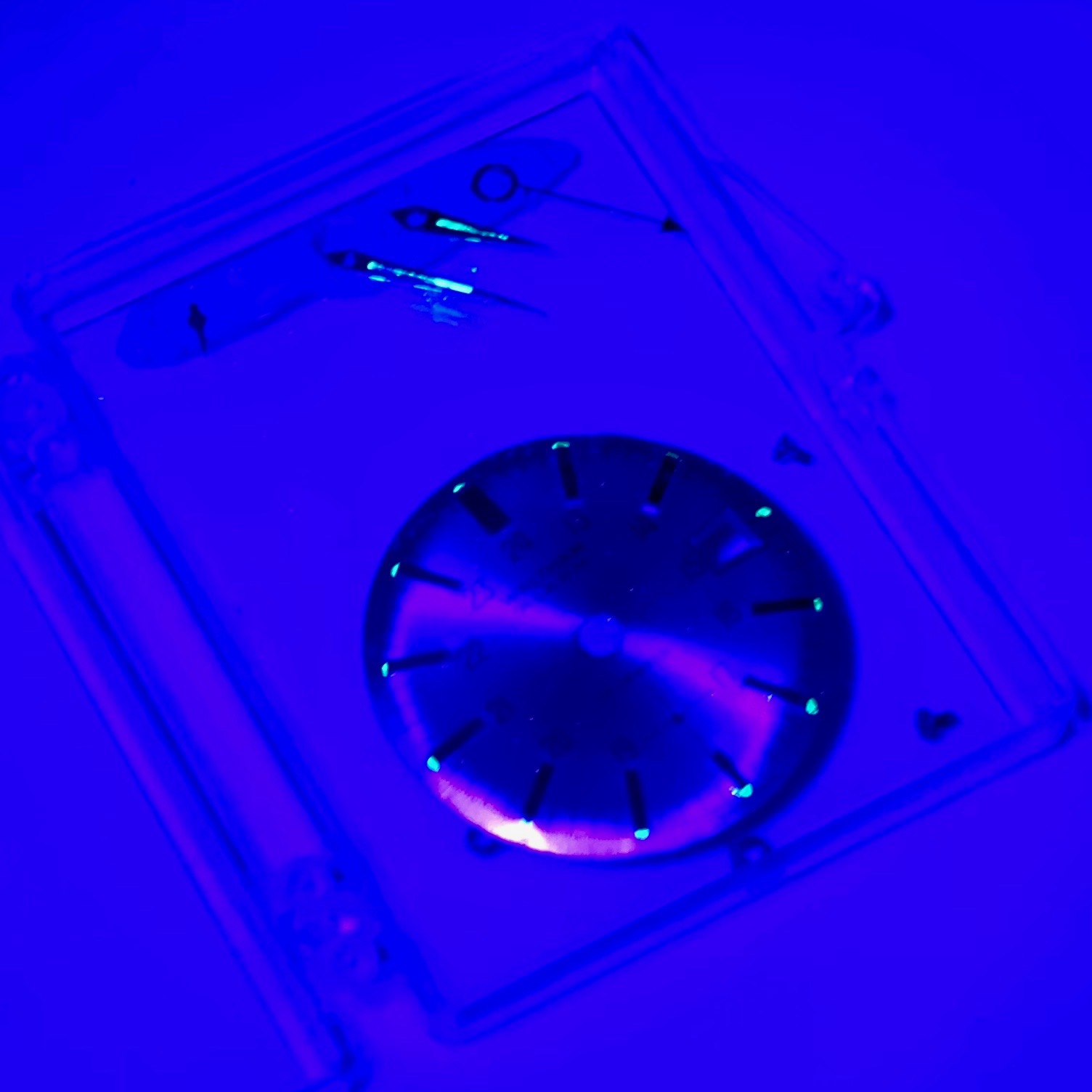

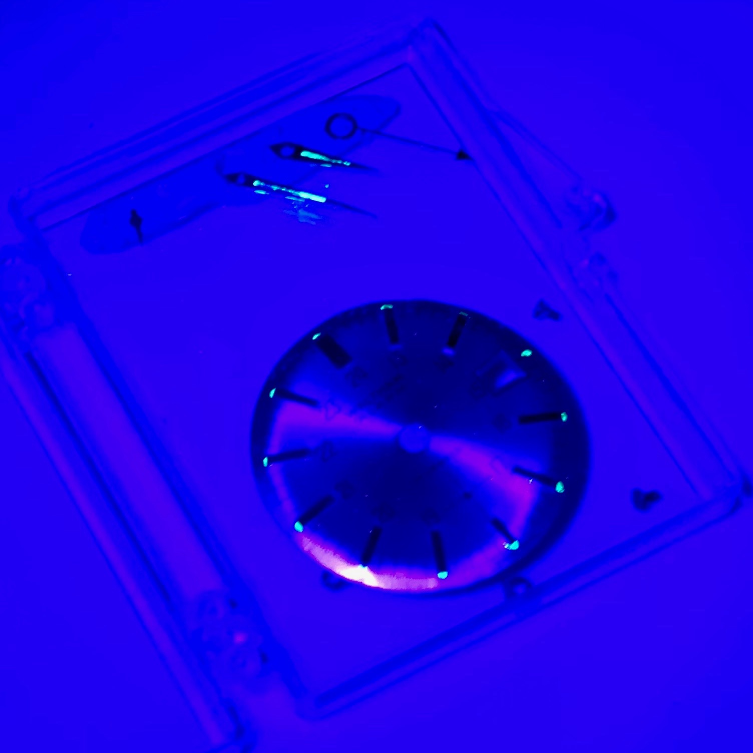

It looks like the Waltham dial is lighting up under a UV light. To me, the lume is from tritium which will quickly fade when then UV withdrawn. None of my radium watches light up to UV.
