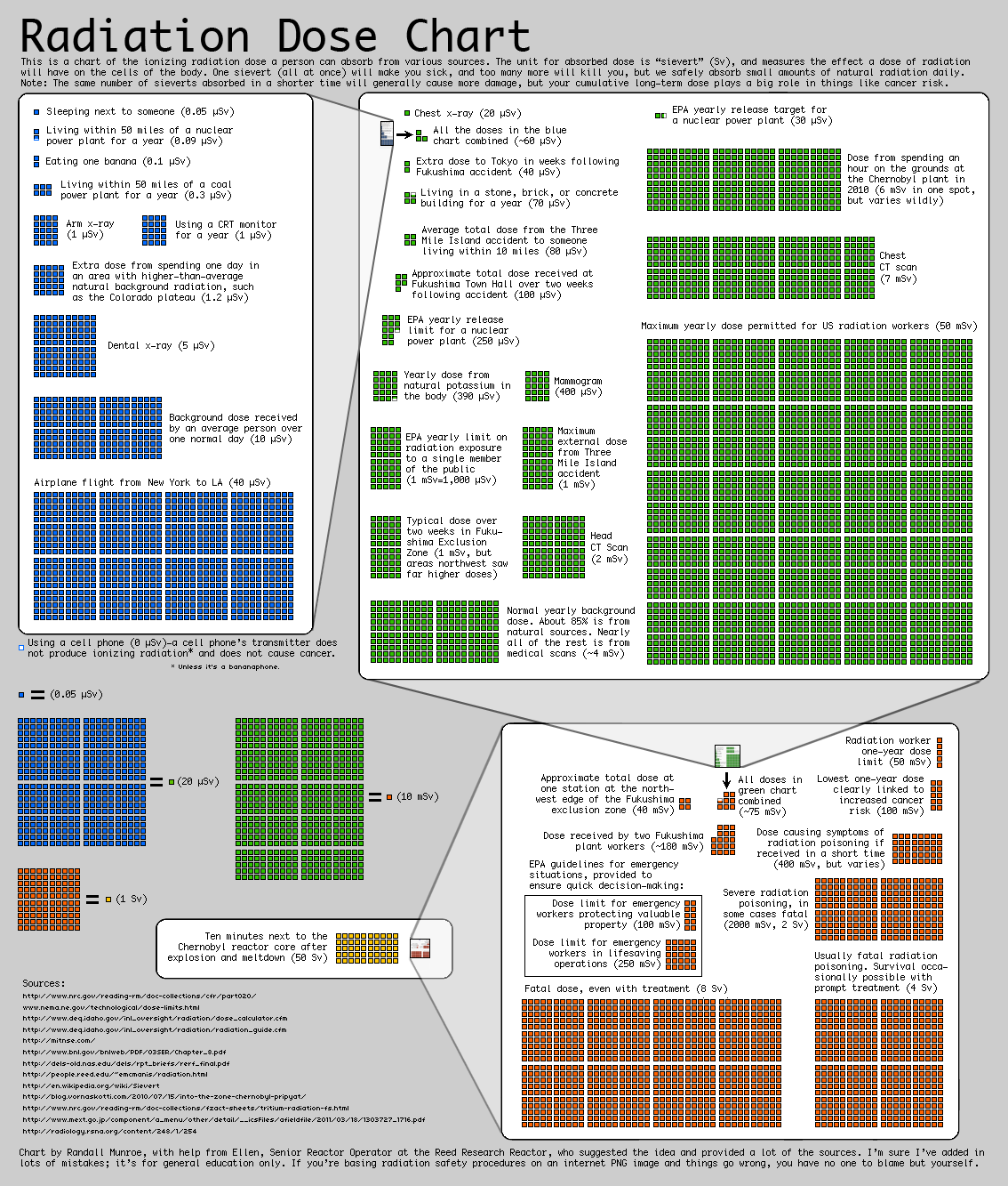

The readings on the watch are the rate in μSv per hour vs the chart which is total dose in mSv. This is handy

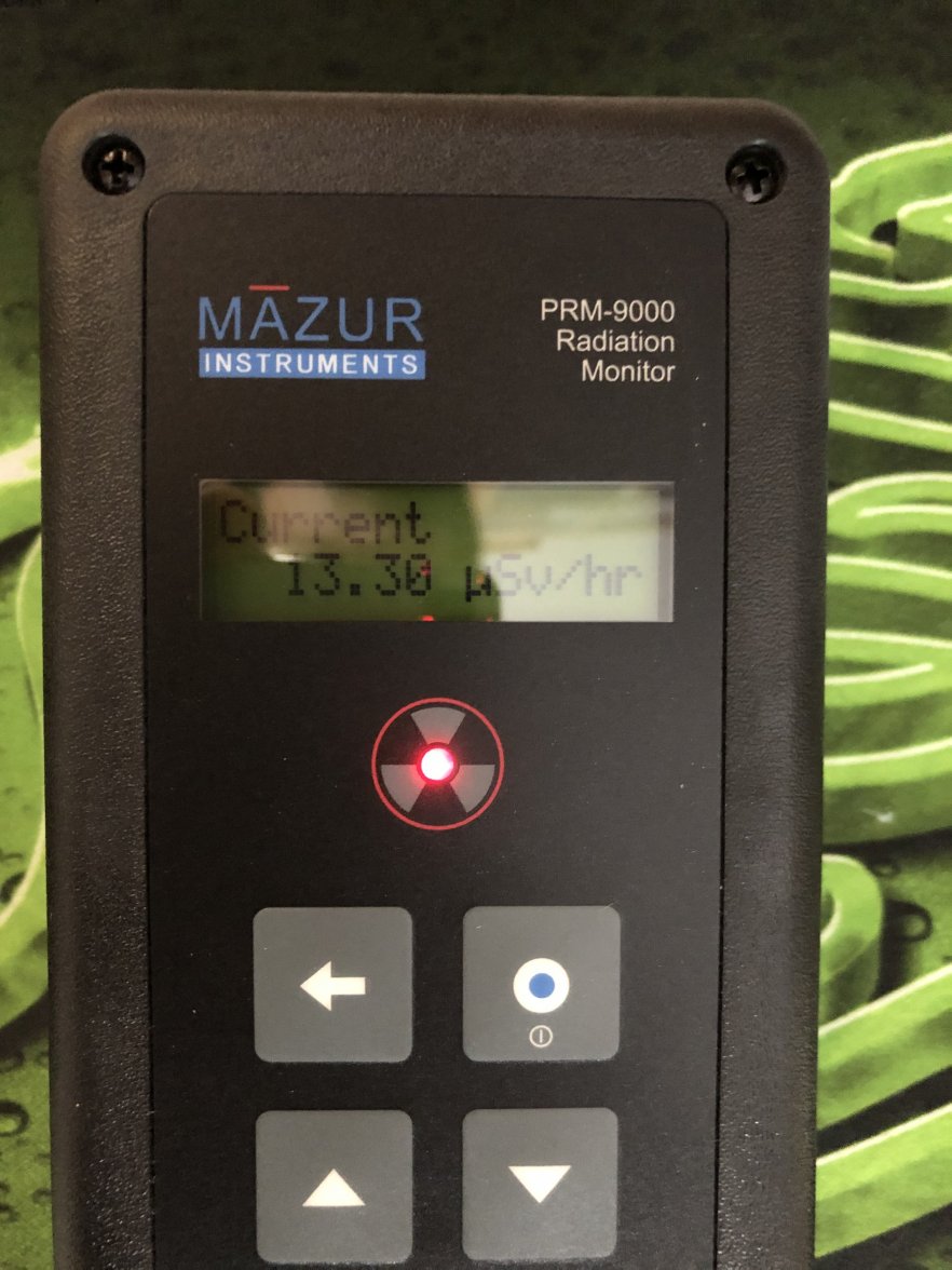

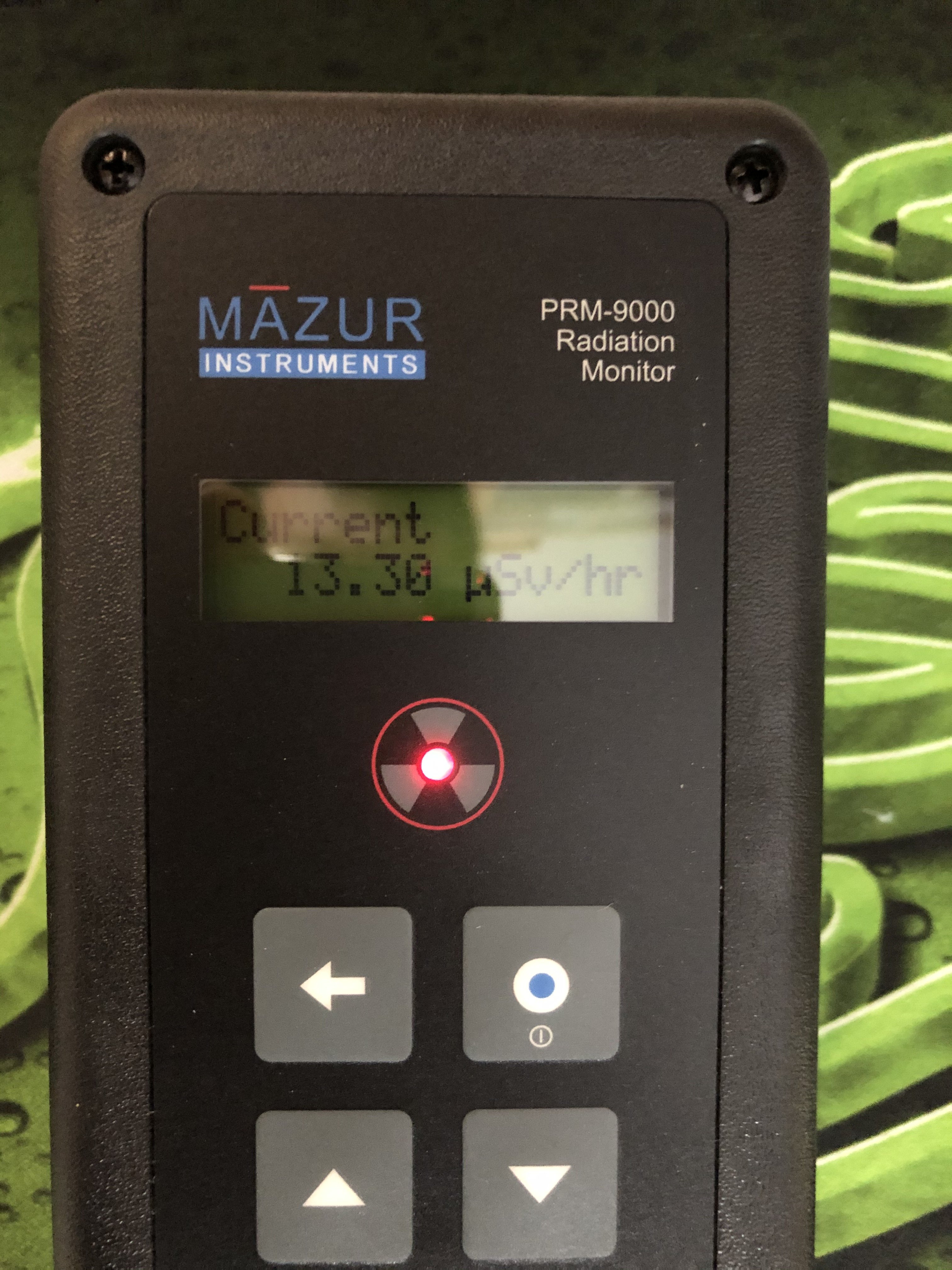

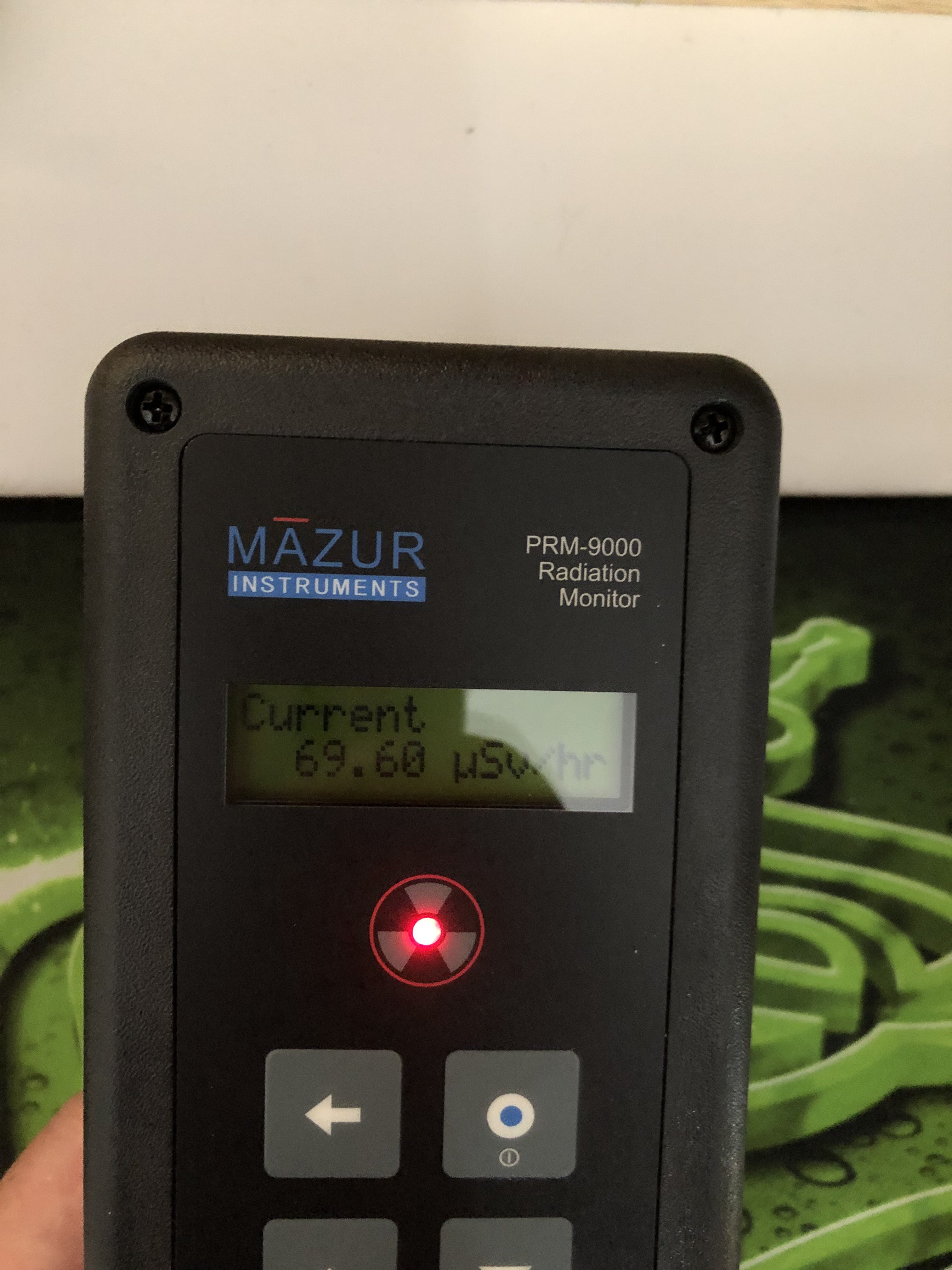

Here're my 2915-1 and 2998-1. The latter being way more active (and having the nicer lume...).
This is the best ive ever seen on the matter
Seems like 20-30 sv/hr is ok a few times a month to qear a special watch vis a vis the radiation incurred flying
That said 50+ would not feel safe to me...
Shouldn't radium be much more radioactive than 13.30 uSv/hr?

@Caliber561 Yes, but this one has lost quite a bit of lume already while the 2998 is pretty complete.
