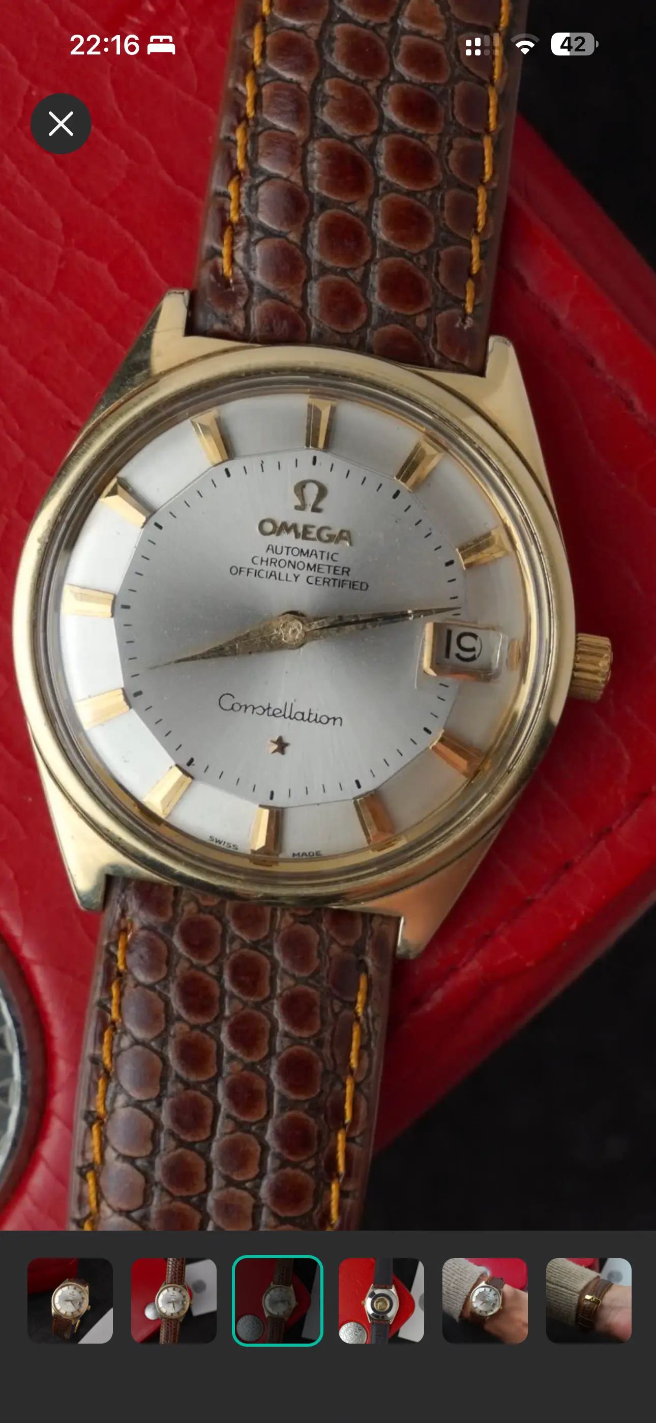

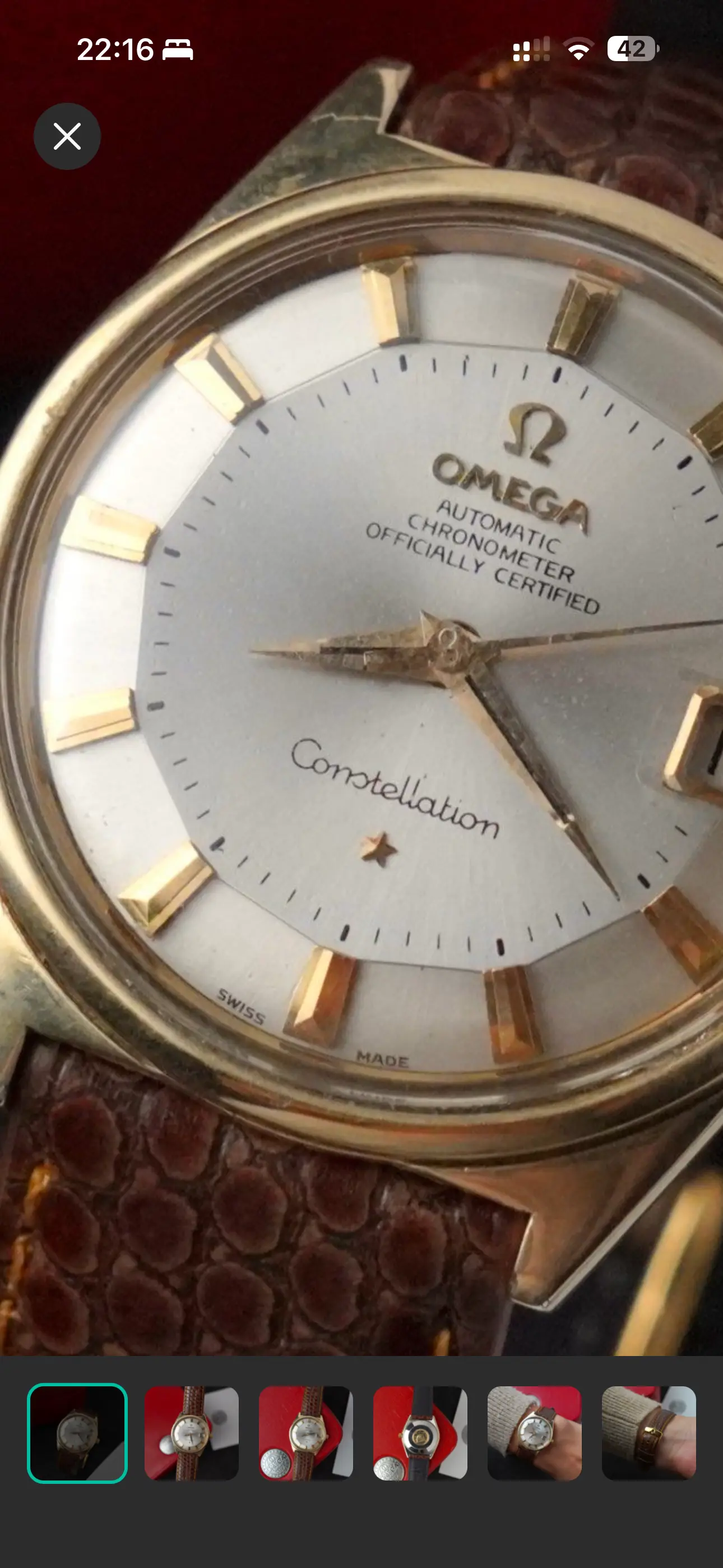

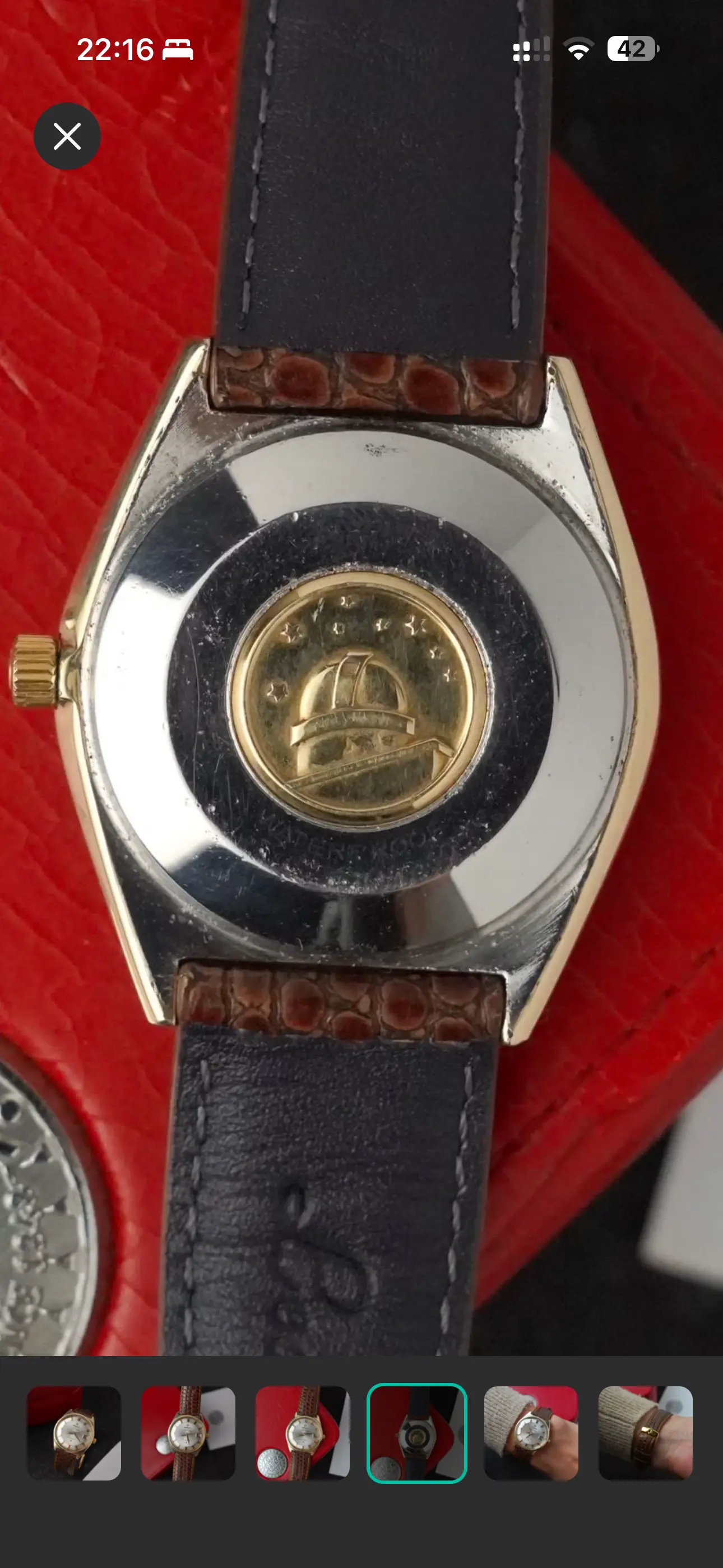

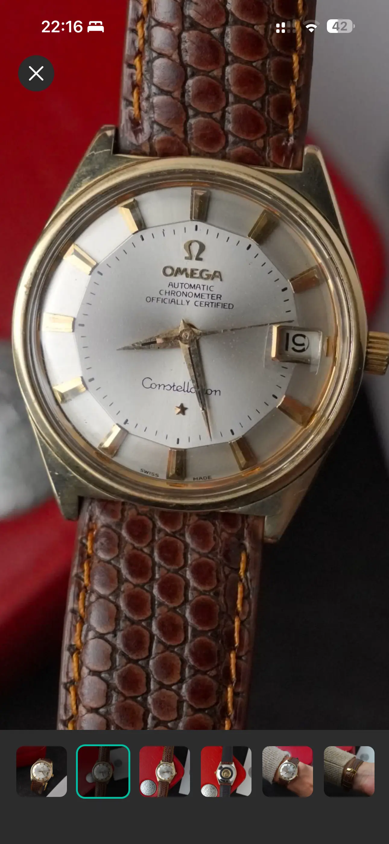

Hi There! Hoping someone might be quite well versed in Omega Pie Pans? Picked this up and first glance looked ok but now questioning authenticity.

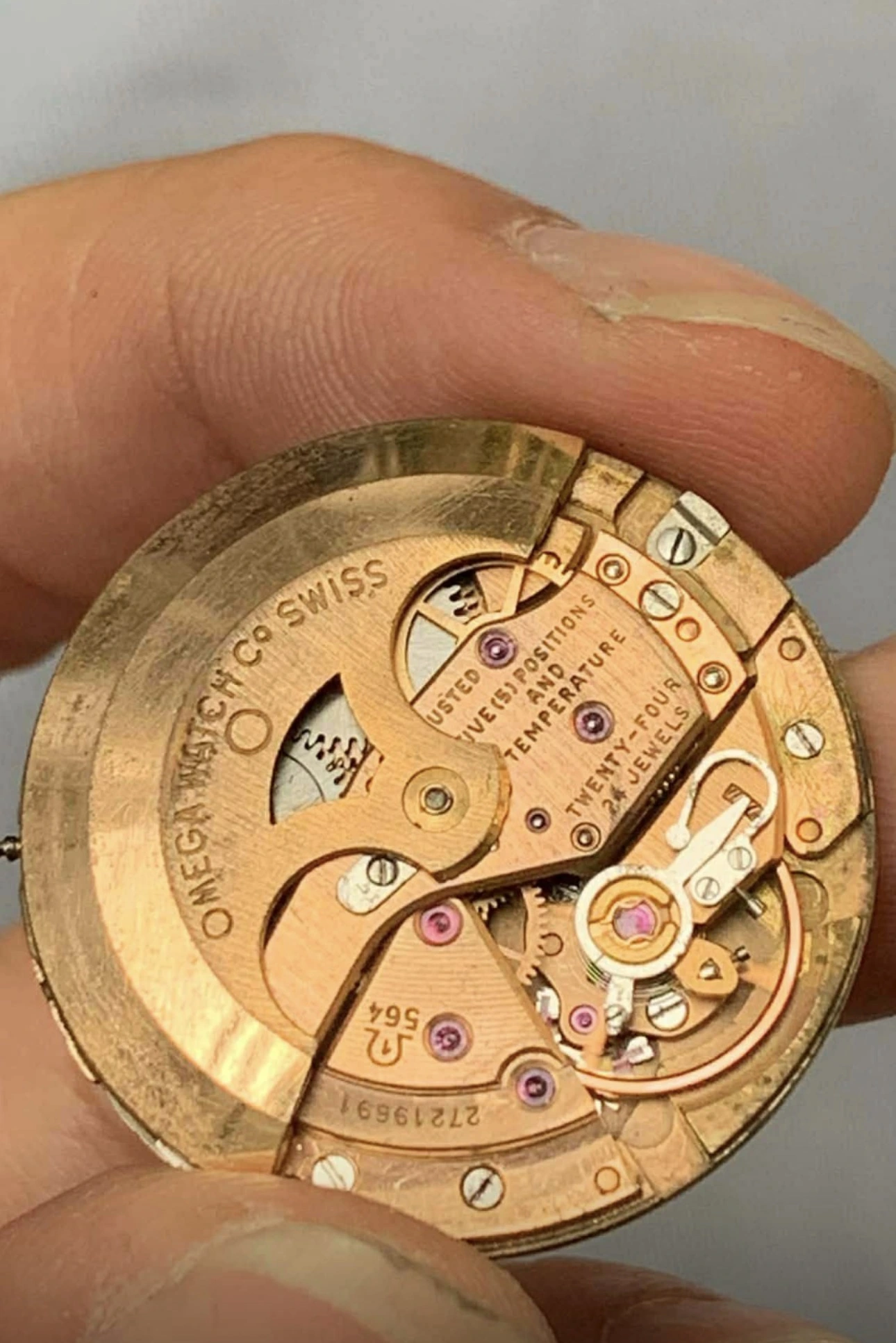

These are some photos and the movement was sent by the seller before purchasing (But haven’t opened the case back).
Biggest thing that stands out to me is the ‘n’ in constellation…
Cost around $2K SGD.
Not sure if ok or should try to get refunded if I have any luck..

You would have a hard job getting the back of - it’s a front loader.
Very basic redial.
Polished case front and back.
Top tip - if you see a seller holding a movt with their bare hands - run a mile.
$1500 US should get you a very decent., correct, version of this reference.
If it was described as original you should return it if you can.
Hope that helps.
1,646
8,283
Poor redial. And not loving those hands either. Ask first and buy second.
