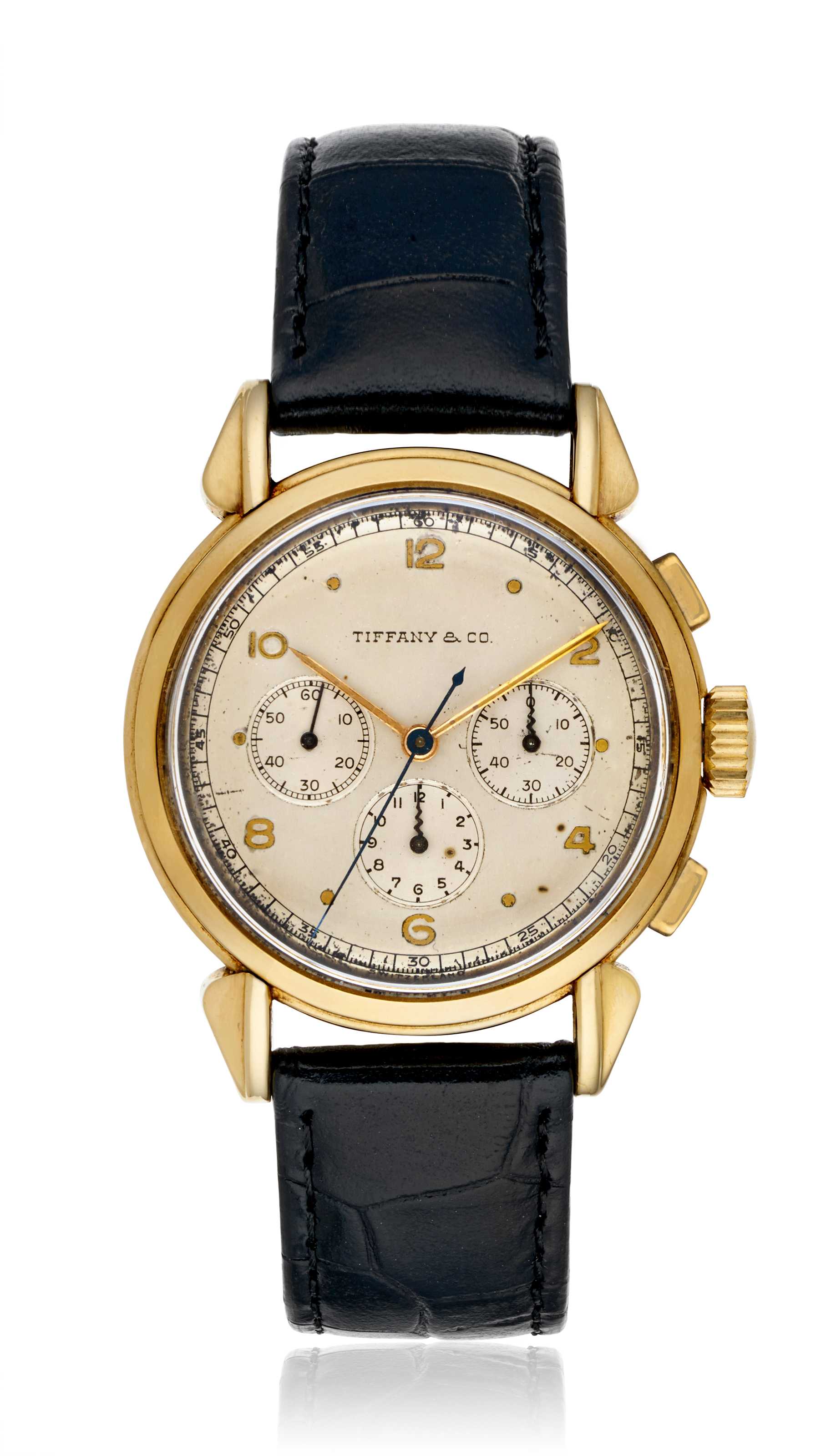

I think that what Achim meant was that it has been redialed. Most likely not originally a Tiffany signed dial.

without opining about the specific watches mentioned here. . i am certain that Tiffany used multiple signatures and some were indeed "hand stamped"
this watch was auctioned at Christies's and I believe it is genuine and was hand stamped. i have seen another Movado example with similar printing and it was not 100% level due to the hand stamping
i dont find it that attractive but believe it is genuine
https://onlineonly.christies.com/s/...ne-time-summer/chronograph-ref-49029-76/29792

Don't like that dial. Kind regards. Achim
A simple extract will clear it up.

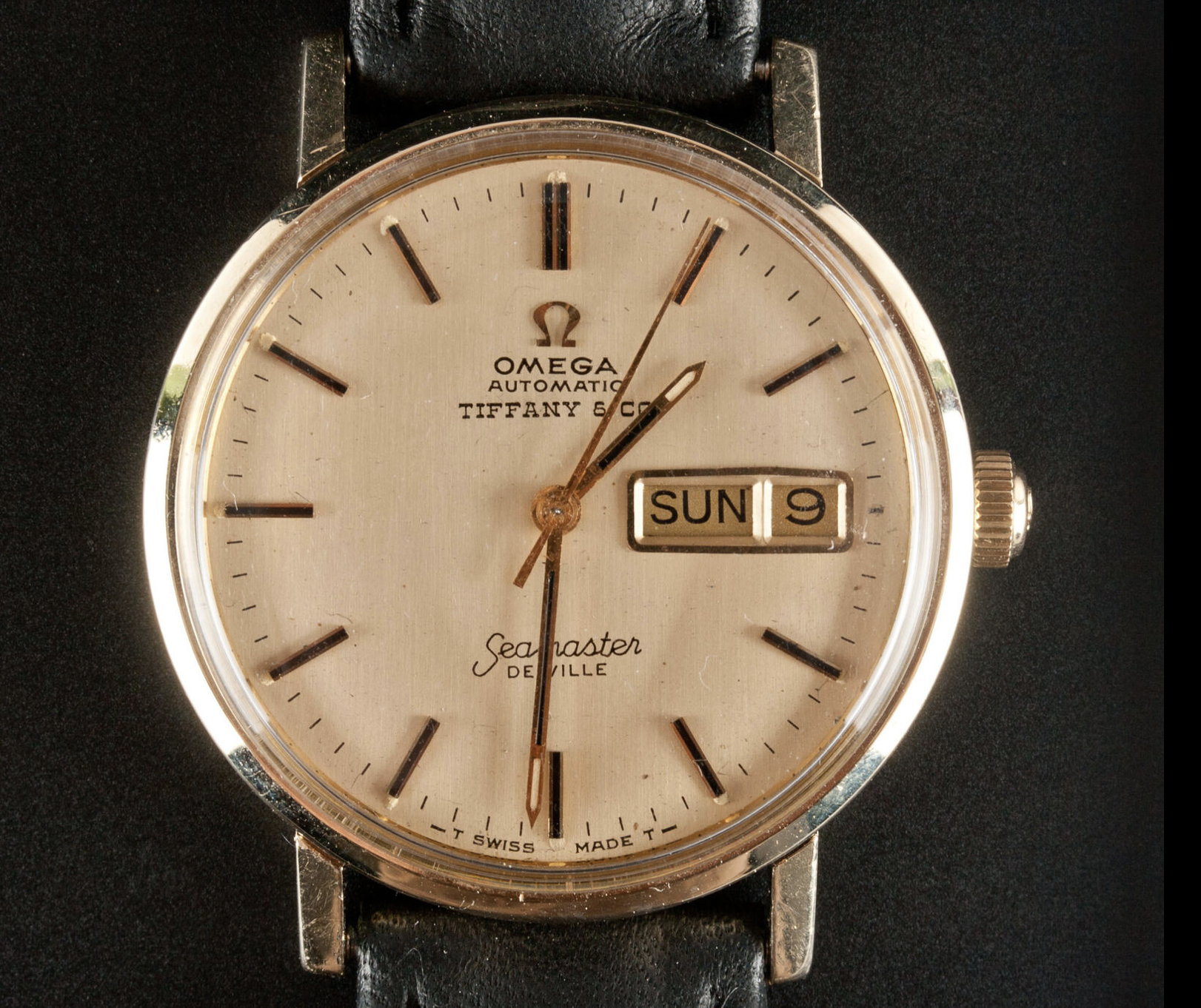

this font reminds me of all the omega Tiffany devilles
it looks. . identical to the movado
Yep plenty of those in the NYC area. Usually at least one is offered at the weekend markets. Very common and legit examples. 馃憤
