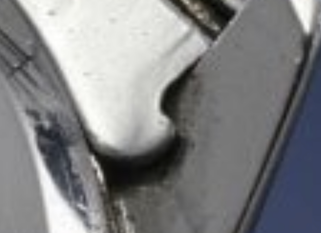

Endlinks are definitely not correct (ok I’ll edit this to say I’m 99% sure they’re not correct).

Yeah you may well be right. I see some characteristics that are supportive of original but the top and bottom of the circle looked a bit to fat for my liking. If they’re are repros they’re the only close ones I’ve ever seen.

As to the end links:
I feel they are in a very different condition to the rest of the bracelet, indeed watch. They are perfectly flat across the width of the back, and that is an unusual condition.
I would have also been ready to see single notch links on a watch this early but I am not certain
2,844
2,440
Now that you've called our attention to it, these sure look damn near new.

One of the end links looks worn but to be fair I wouldn’t let end links put me off a watch.
Considering the value of the watch itself the end pieces seem like a consumable that can be later changed if you don’t like them.
