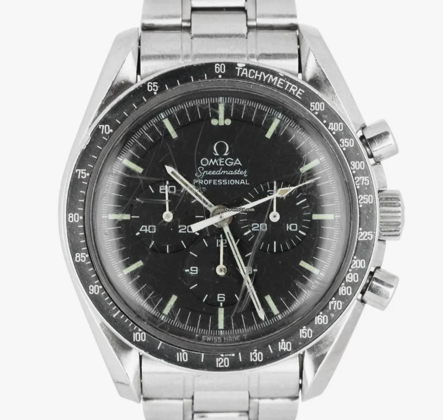

For comparison this is on C24 at USD 4,500 and is possibly more correct. I consider C24 prices up to 20-30% optimistic.
Couple of points to bear in mind - the lume on this is greenish. I think the crystal of this C24 watch may be comparable to the Bonhams one, but the different focus systems make a big difference. The C24 hands are also worse. And we don't know if the movement is extractabel.
That said, this Bonhams watch is in the "RUN AWAY" department. Unless that is Bonhams have miss read the movement number. There is no extract and the number 28088628 does not fall near any known speedmasters.
