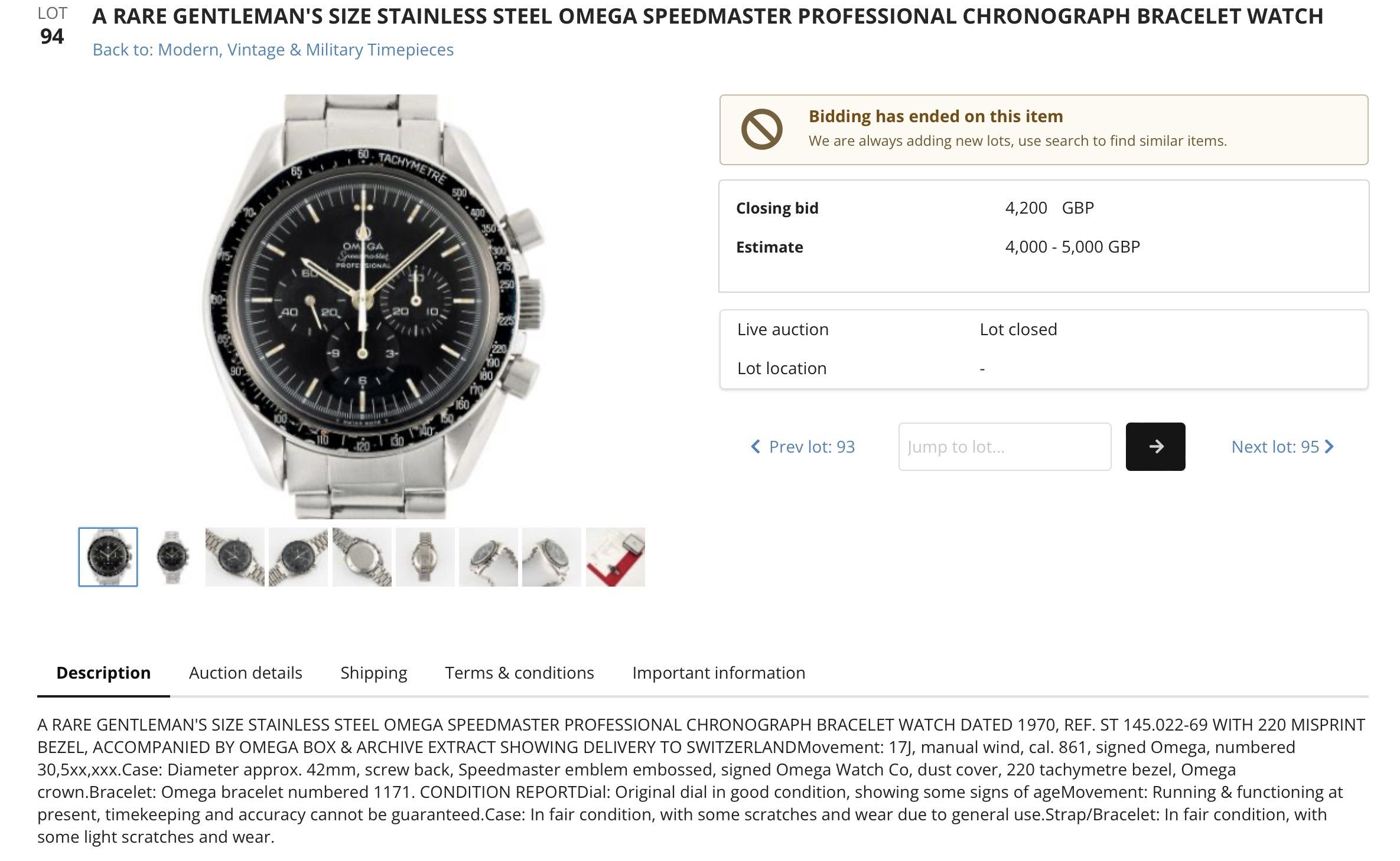

Watches of Knightsbridge had this sole Speedmaster offering on 18th November.
It is a later 145.022-69 with the 220 bezel. While sellers will often tout this as added value, it seems the market only adds value if the condition is fine. In this case it’s not fine enough for the 220 to come into play for the value. I could be wrong on that as the price exceeded my expectations.
The final bid was £4,200. If we add 26.4% we get £5308 or approximately $6,675.

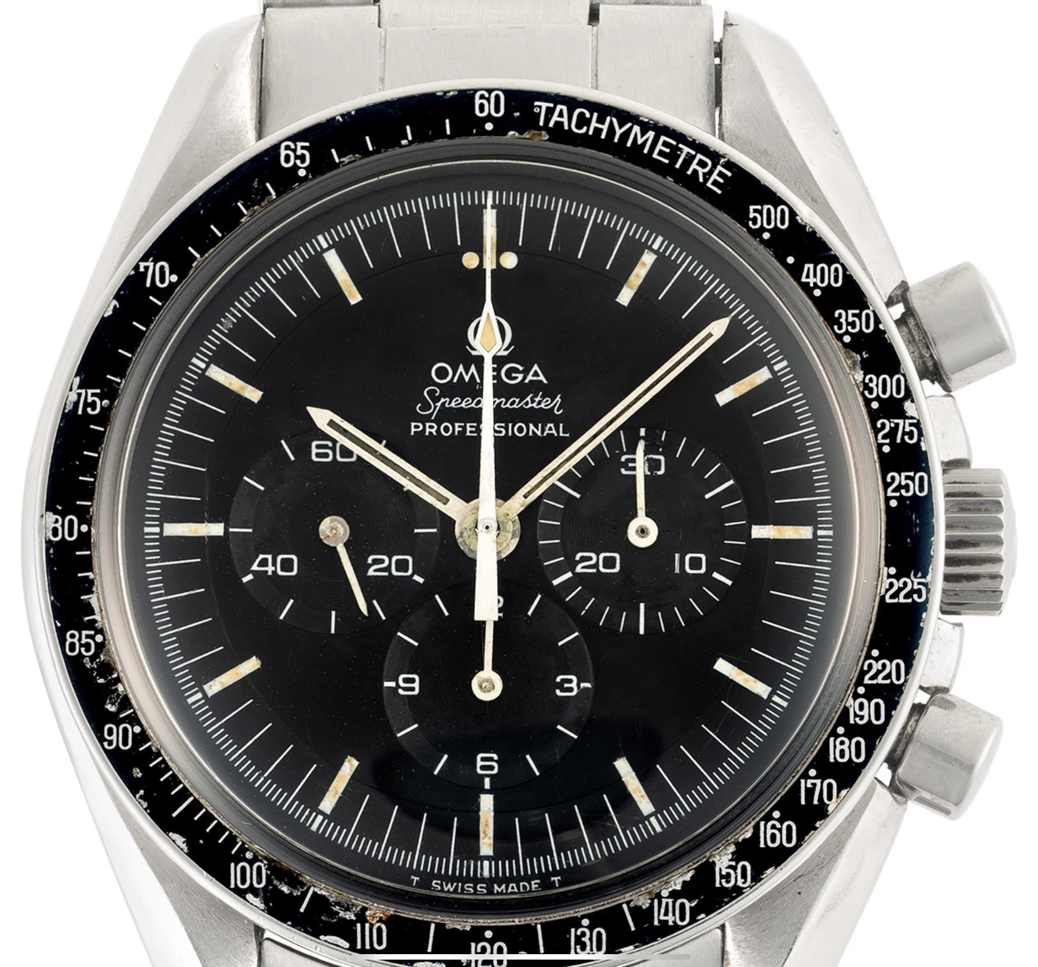

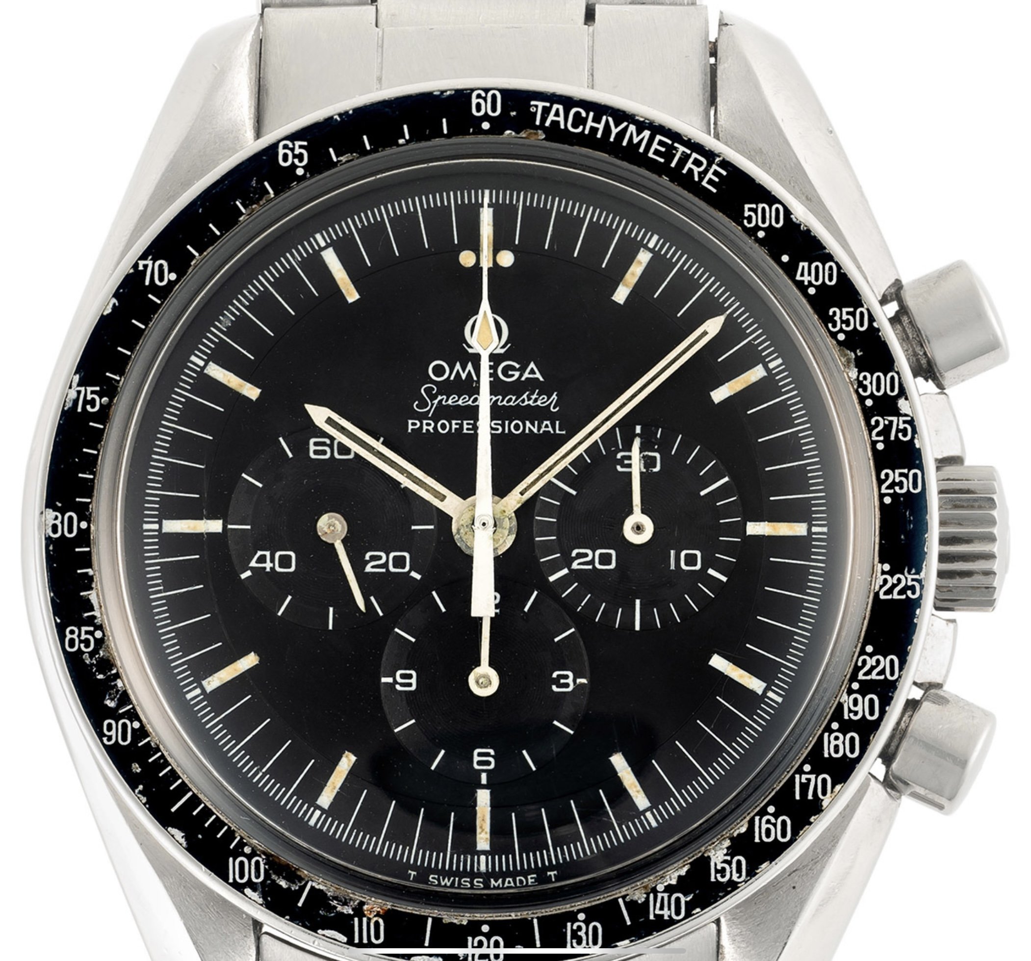

The condition of the dial is shown quite well in these focused photos. The character of the dial is harder to divine as it is a light box photo, perhaps manipulated and so I find it hard. The dial is correct, being stepped.
The body of the dial (the thing I find hardest to judge) appears black, and without serious damage, or blotches. Unfortunately this kind of photo can disguise these, but I will assume it’s solid. The print is intact. The markers are poorly covered and missing tritium all over.

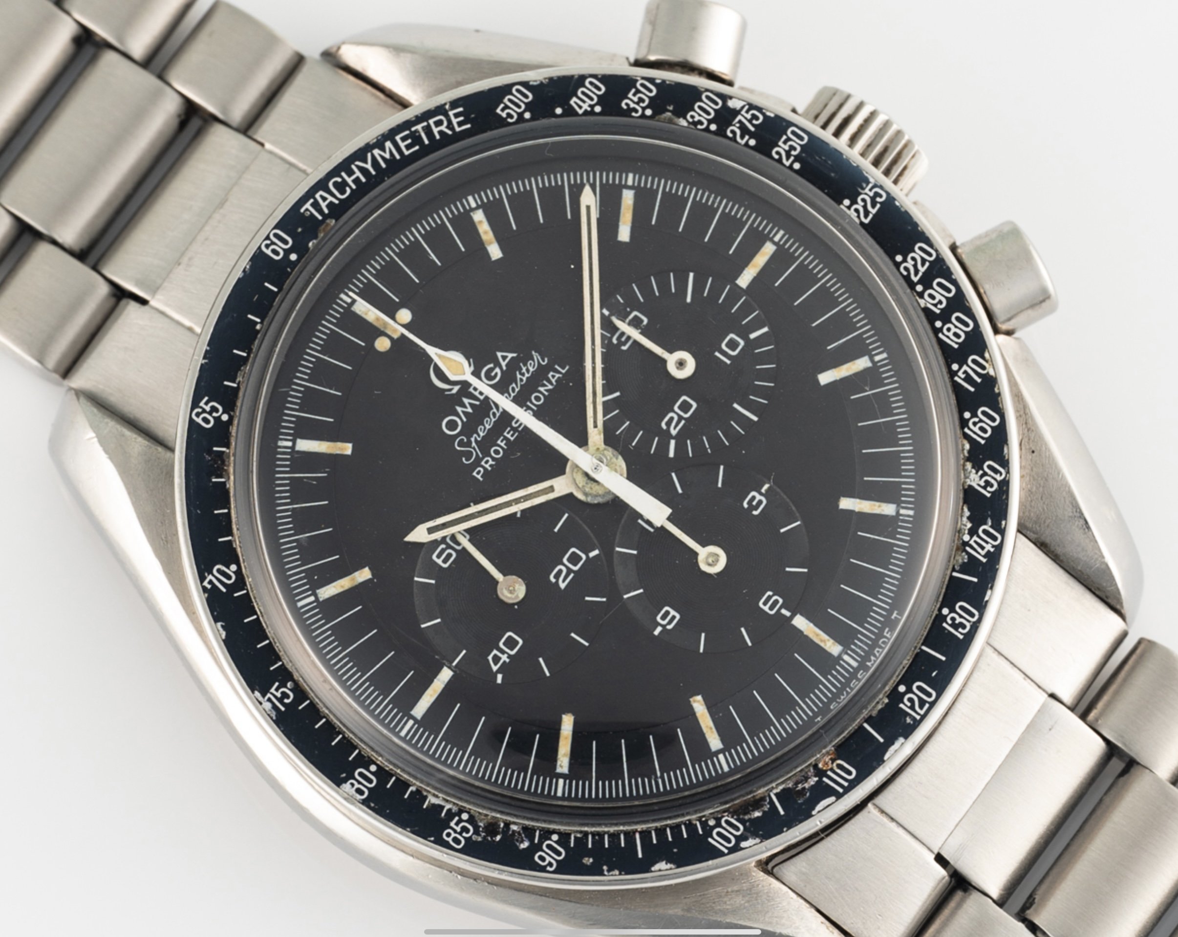

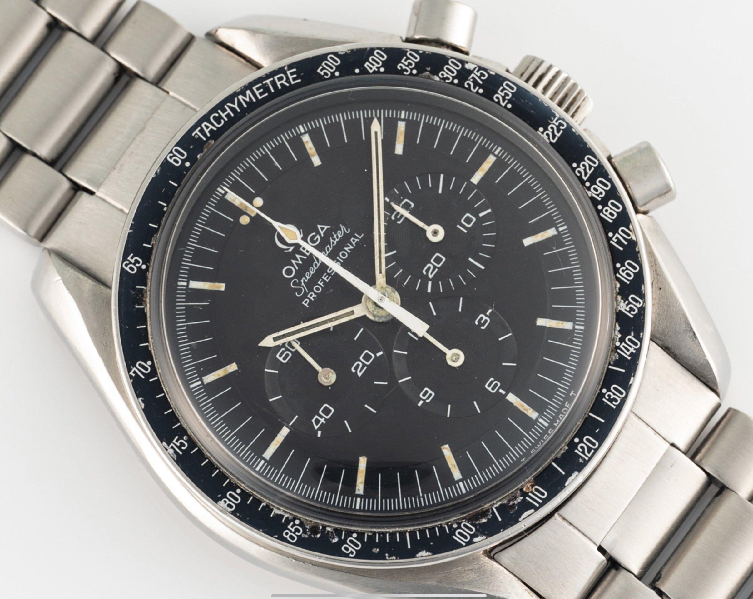

The bezel is the 220 misprint, and in fair condition. it falls into the correct serial range. It is quite heavily damaged.

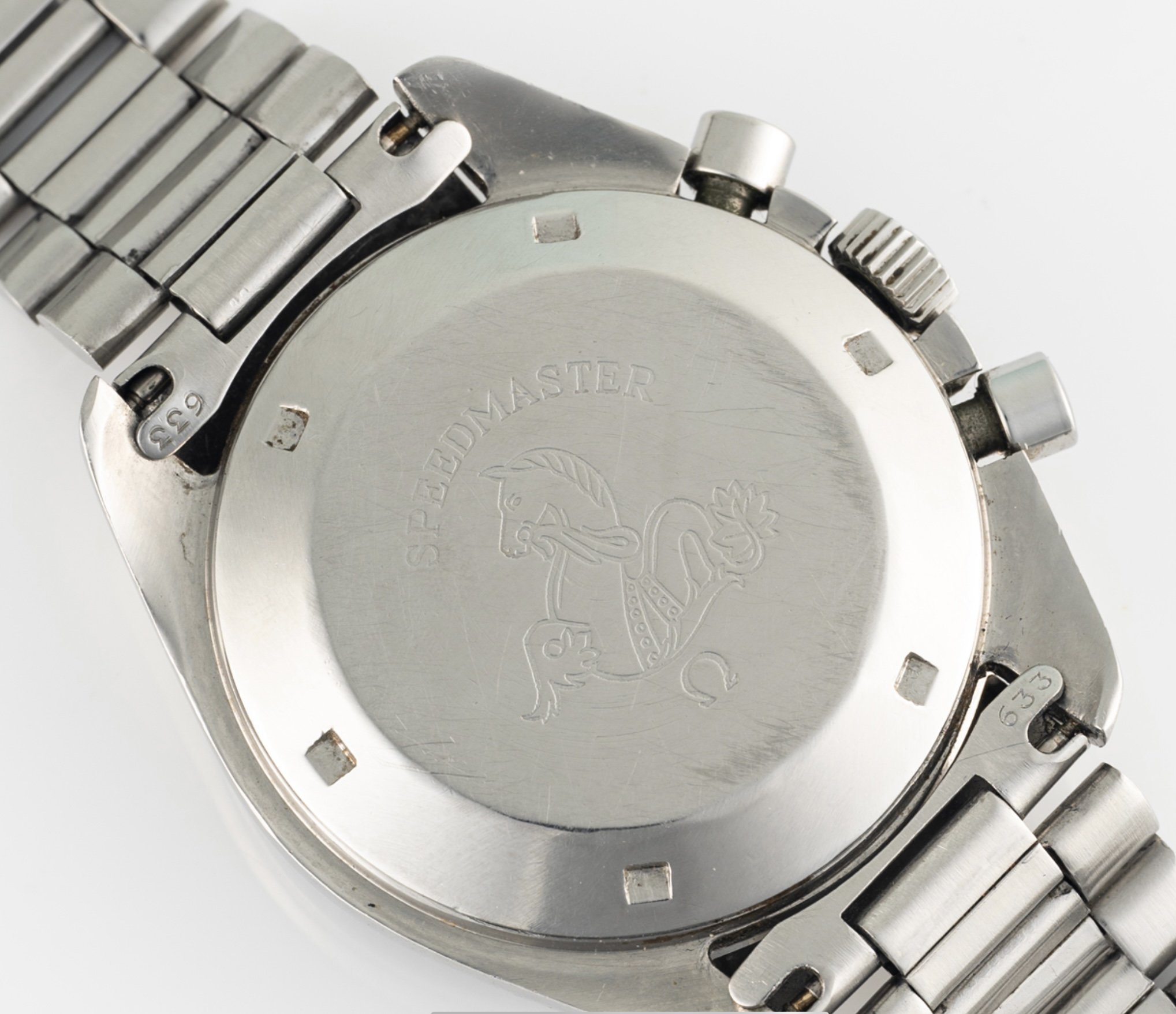

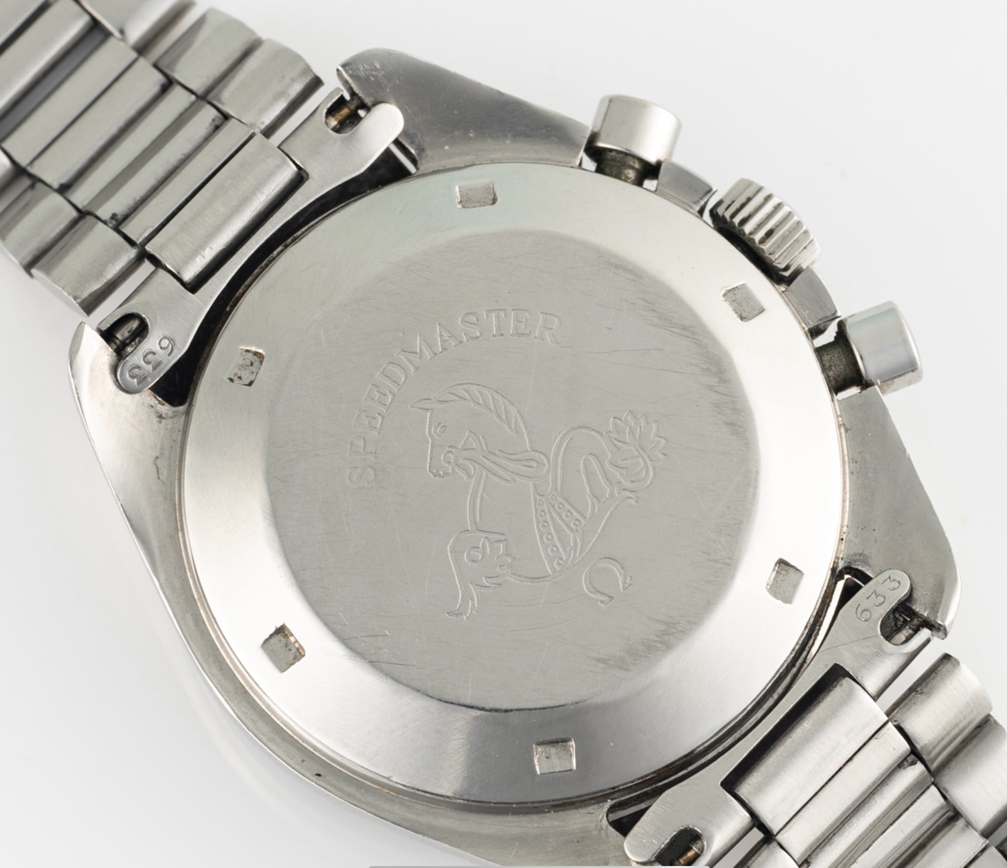

The case shows signs of polishing and has lost some definition. This is more obvious on the case back, check the slots. I don’t like the case condition and I would allocate Fair.

The chrono hand has been replaced, and this is evidenced by the different colour and condition.

Just an unappealing example overall, IMO. Given the condition of the lume, I feel that your GOOD rating of the dial is generous.

There are obviously subjective ways to interpret your (excellent) price chart, but I’d have a hard time grading this as anything higher than Fair+.
Totally agree. The lume leaves a lot to be desired. In addition, the case also seems pretty soft and quite polished.

Spot on with the Fair assessment, there's just too much that needs improvement and the dial is, as often, a mystery. I would argue that the 220 bezel is the source of the uplift though. Many Speedy collectors are going to want the oddities like the 220 but won't have the funds to reach the better examples - and this is still passable if you've got an old chrono hand sitting around that matches. Added to that the market we're in - I'm not seeing many low-end or mid-sector Omega's selling at all well, and add to that anything with "issues", but the high-end and rare editions are doing well if they are perfect - then it gives a collector to the chance to get a deal on a bezel oddity that would normally be higher if perfect. Make any sense?
