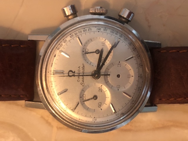

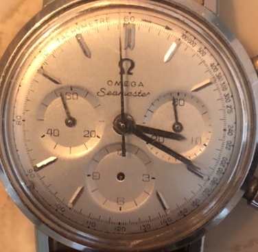

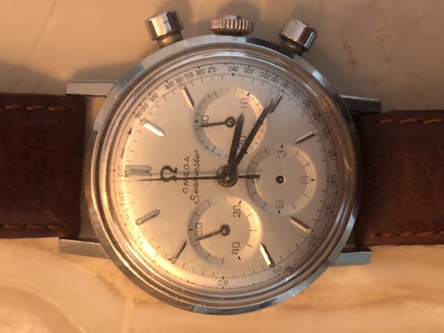

Looking for advice on where to source an Omega crown and crystal for a Seamaster. I want to get it in good shape to give my son as a wedding present. He was never into watches until after I gave him a vintage Chronostop when he graduated from pharmacy school. Now he loves everything Omega, particularly vintage. I’ve had this Seamaster for years; picked it up non-working from a friend who inherited it from his dad. Wore it for several years, then let my daughter wear it for a couple more. It was serviced along the way and unfortunately the original crown and crystal were replaced. It’s been sitting unused for several years now due to a cracked crystal and dislodged hand, and I want to take it back to more original condition and get it serviced so I can pass it along to my son on his big day.

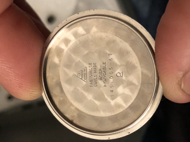

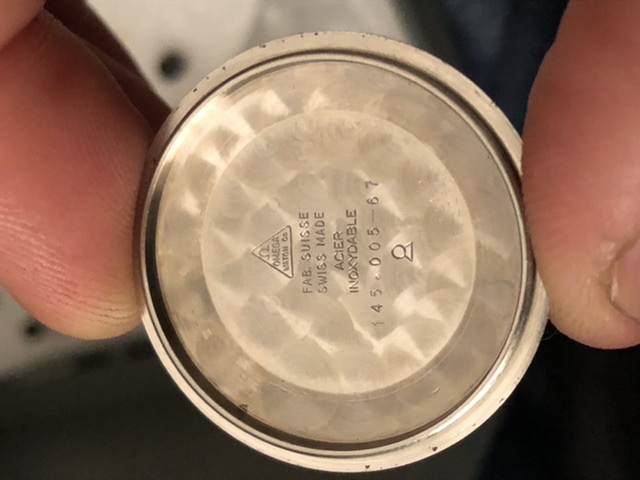

I’ve tried several sources for a crystal but haven’t had any success. I’m hoping someone may have one they are looking to sell, or can point me in the right direction. Case is marked 145.005-67 as shown below.
I am not sure on the appropriate crown. Can someone tell me what fits this specific model? Also, any recommendations for sources would be much appreciated. Here’s a picture of the watch. What a great design!

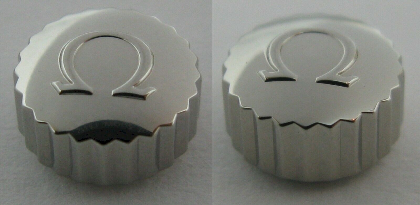

On the Crown: Genuine Omega Crown Yellow Bestfit 8100/1074 http://www.ofrei.com/page_147.html
This is the current replacement crown. It may differ from the original.

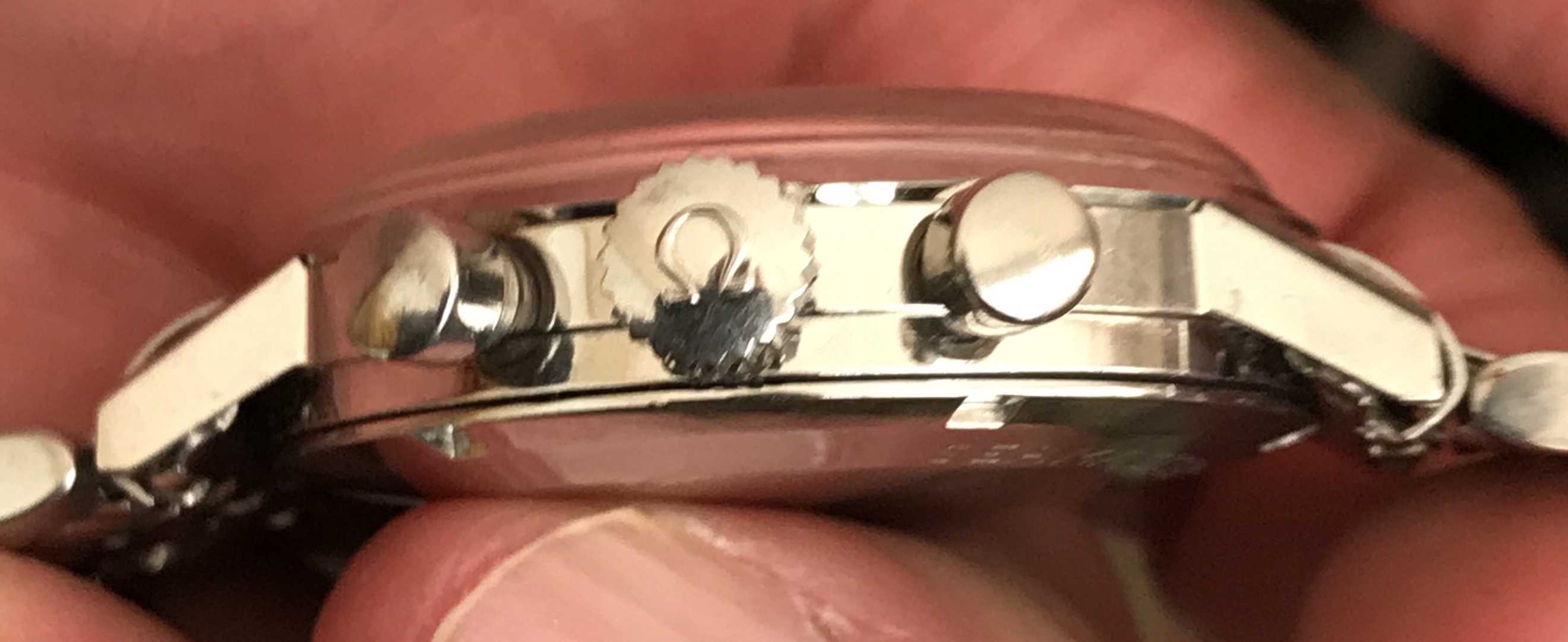

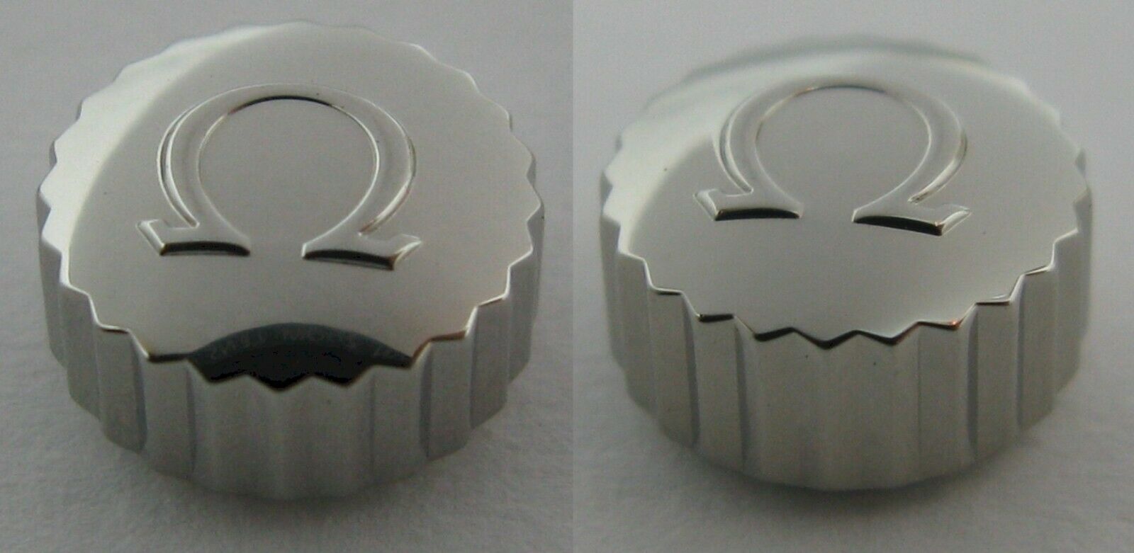

The crown should look like this:

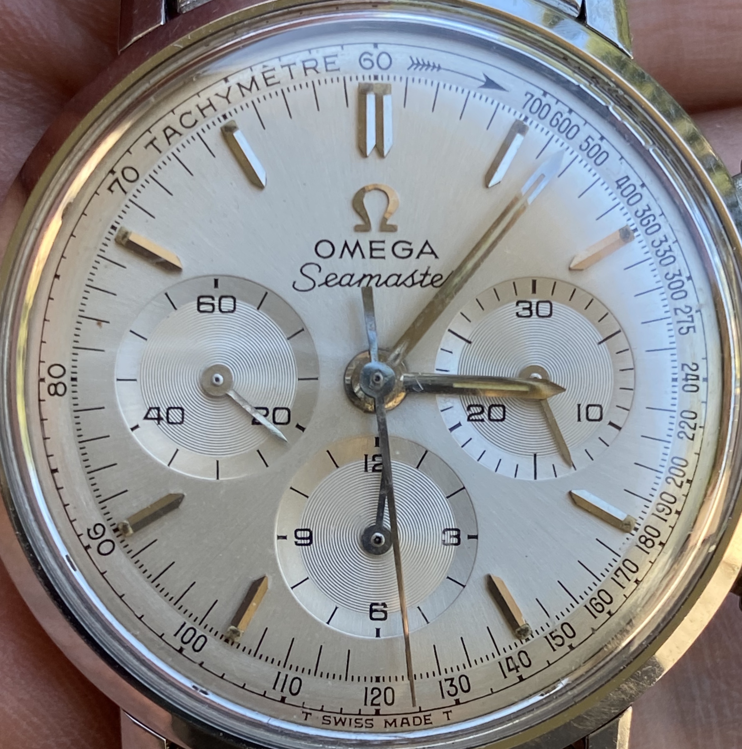

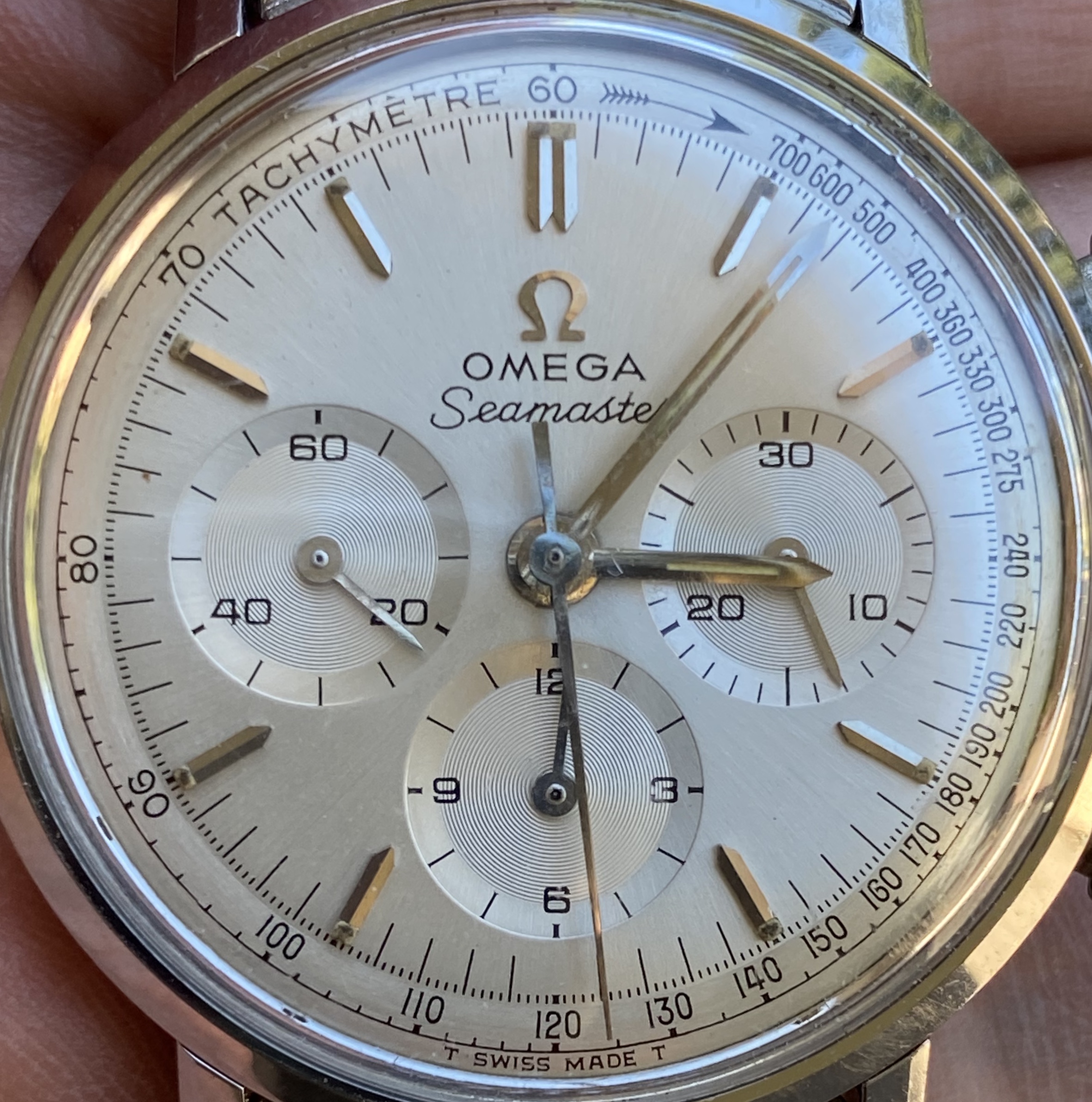

The crystal should have a silver rehaute to be correct.
And, unfortunately, the dial on your watch is not original.

Give them the case reference number which is on the inside caseback

The original part number is 43069, or 069ST43069.

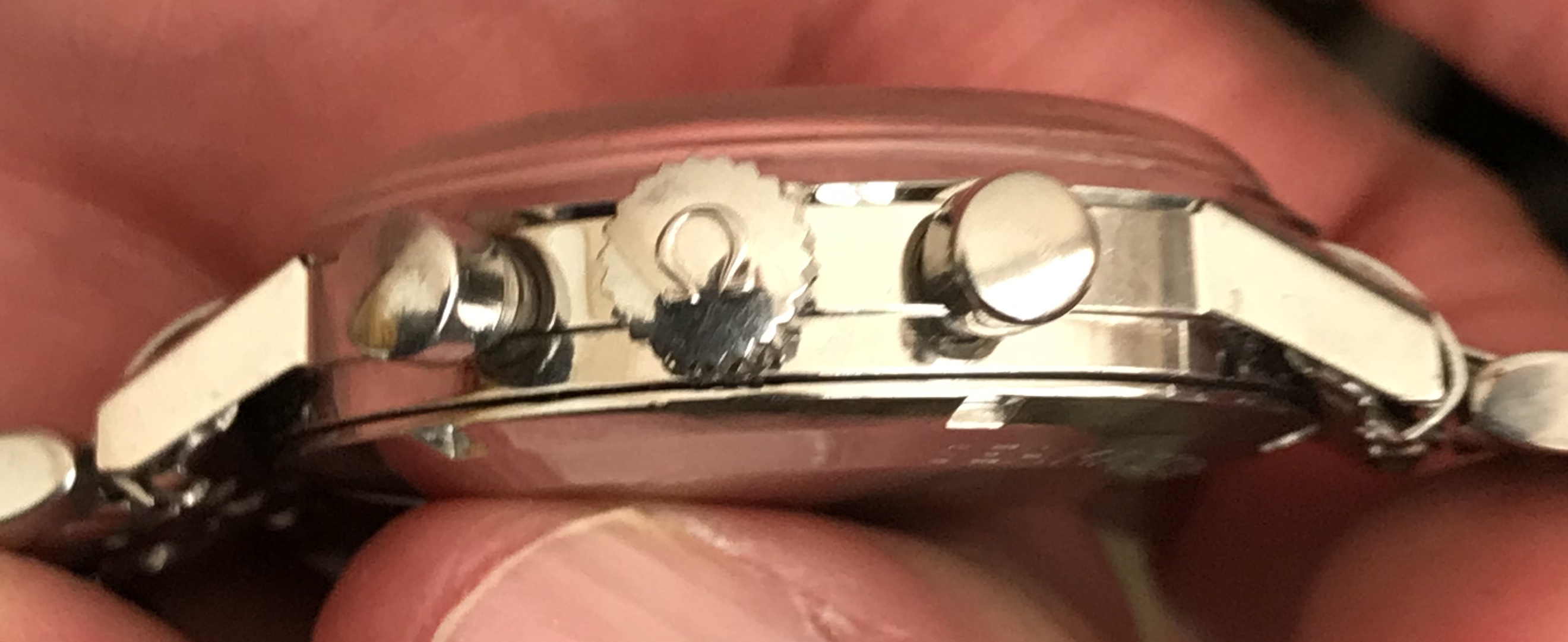

The 069ST43069 is the regular Speedmaster Pro crown. The crown Omega calls out for case 1450005 is 069ST43008.
The crystal is 063PZ5043, and the pushers were 086ST0021, but are discontinued, and replacements are 086ST0088.
