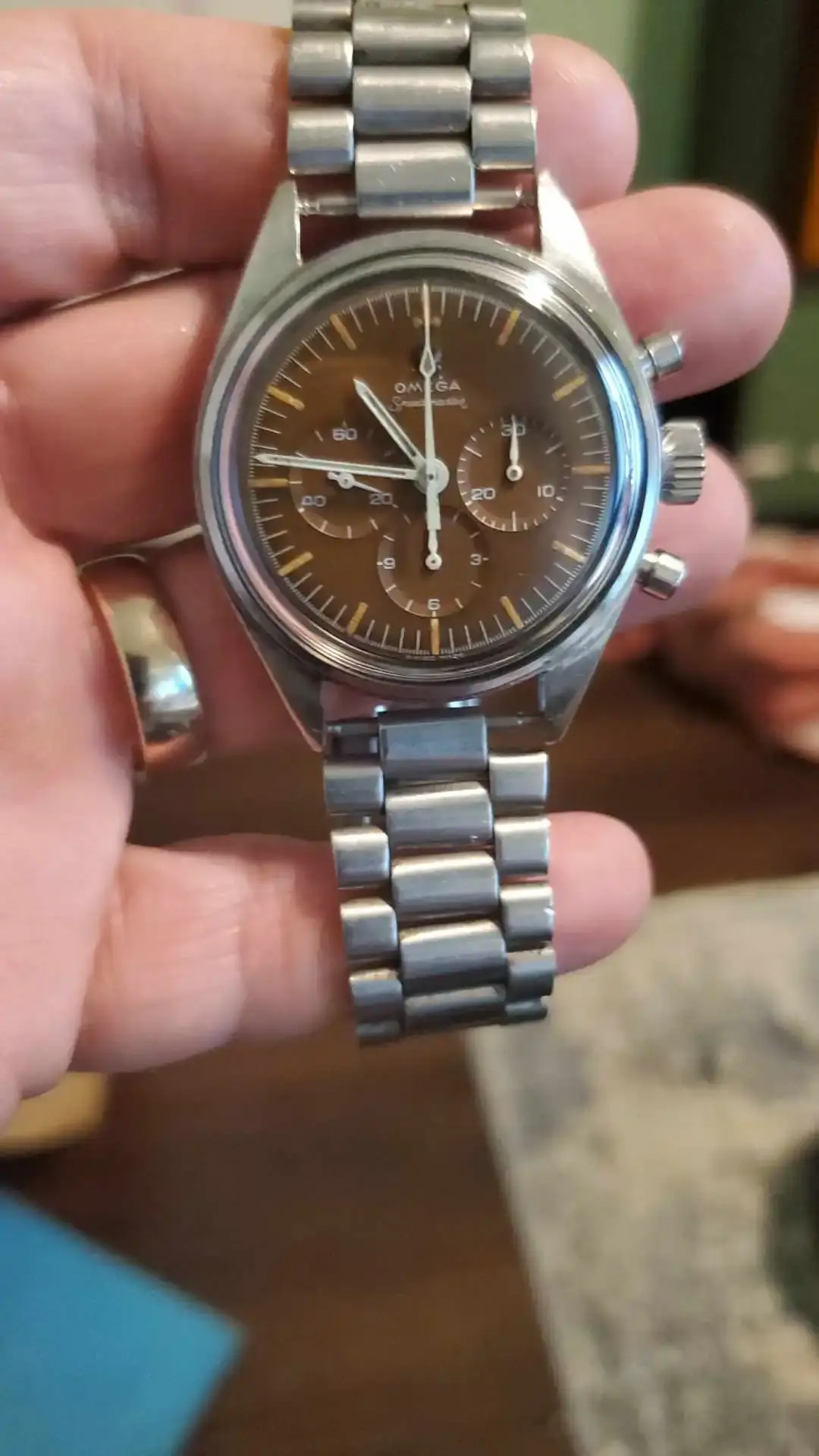

A friend inherited this original CK2998 Speedmaster from his father and is interested in getting it restored. The exact variant of CK2998 is unknown, as there are things that don't correlate exactly with what I've read about the CK2998 in Moonwatch Only. He definitely doesn't want to go to Omega directly since they would likely modernize anything and everything they need to, but I can't find any current recommendations for 3rd party options either. Period correct parts will likely be an issue, with the missing bezel and non-original bracelet, along with anything else that needs replacement. I'm hoping the community here can help him out. Thanks!

Welcome. Does your friend want to research the watch and figure out what it is and what it needs? Or is he just looking to send it to someone to do a soup-to-nuts restoration ... price is no object?
If the former, I think it would be helpful to provide a lot more information upfront. More photos, better photos. The inside of the case-back and the movement serial number. The restoration cost and difficulty will depend greatly on certain details. Even if he is looking for someone to do a restoration for him, it might be helpful for him to know if it's going to be $10k or $50k.

I think this picture may be all he's got at the moment. I don't think he's comfortable letting just anyone opening up the caseback in order to get photos of the movement given the likely value of the watch, unless it's a trusted watchmaker. But at that point he's should have the resource he needs to give him a decent estimate. Beyond that, in your opinion are era-appropriate parts, mainly the bezel and bracelet, still available? Not necessarily NOS, but something "good enough?"

Yes, parts are available, but some are very dear, e.g. if it needs a Base-1000 bezel. So just to be clear, you're not looking for information about the watch, just a referral. Because to get decent information, you'd want to post photos.

So if he knows what he's got, is he willing to share what type of 2998 it is? Which sub-reference?

The dome dial would have to be a -2 or earlier, really nice colour to it too

That's one detail he doesn't know exactly but isn't too concerned to learn more about at this time. He did tell me it's a CK2998-2 from 1959. When I told him that combination is mutually exclusive based on what I gleaned from my copy of Moonwatch Only he was thankful for the info but didn't really ask for more. From my own research, the only brown-dial CK2998 I could find in Moonwatch Only is the CK2998-2 Pulsometer variant, but the hands are different - they should be "Alpha Variant 1," to use the book's terminology. However, from the photo you can see a combination of baton hour and minute hands, a flat counterweight chrono-seconds, and two different small hands - Alpha on the minute and hour counters, and some unknown counterweighted hand on the small seconds. Geting to the bottom of it all will indeed require the serial/movement number. I'll let him know, and we'll see if we can dig ourselves out of this rabbit hole.

The hands are later replacements from 67 onwards, not uncommon to see them fitted to an earlier watch due to a past service, it really just needs a a set of correct alpha hands, a bezel of some sort, and a service without polishing

2998-2 is finally the answer to the question I was asking, thank you.
The rest of your response is just confusion. The dial was not originally brown, this happens due to environmental conditions and cannot be used to identify the watch. The bezel is missing and the hands have been replaced.

If your friend is looking to cash in. He would be better off putting this up for sale at a reputable auction house. The folks who collect these have the parts in case a watch like this pops up. They are not going to sell them and even if, they will not be cheap. I’m sure your e mail is already filling up. We have a 200 post rule here for selling.

I was able to get some more details off of the Omega archive extract my friend obtained a few years ago:
Reference CK 2998
Movement 17301XXX
Production March 11, 1960
What details can be deduced from this info?

You've got everything info wise now, its a CK2998-2 from 1960, there aren't any more specifics than that, but yep cool watch and worth getting it back to looking the way it should with alpha hands and a bezel.

My retired Watchmaker has one Set Alpha Minute and Hour hand. Slightly scratched from Storage... No center second hand.
